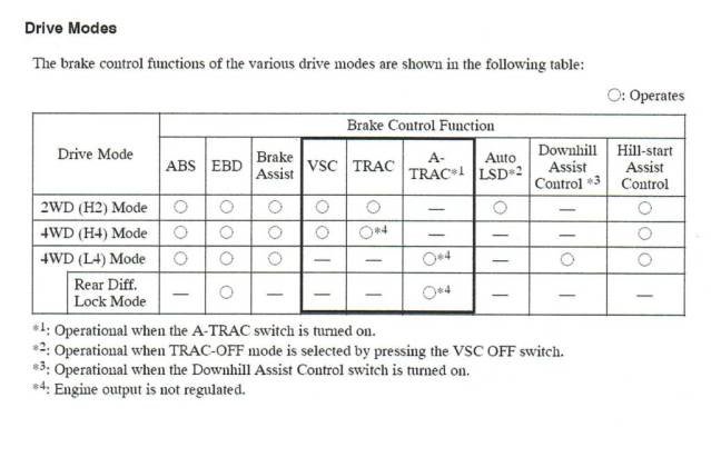

    These two charts (orig. posted elsewhere on TW) may also be of some help:

    I am happy to put stuff down in a way we can understand... Here is another way that may help to see the nine modes as being different:
    Basically, we have:
    1) 2WD with 'mild' LSD (Limited Slip Differntial called 'TRAC'),
    2) 2WD with 'strong' LSD called "AUTO LSD", in the TRAC Off mode), and
    3) 2WD with open differentials (VSC Off mode, for both TRAC and VSC off).
    We have:
    4) H4 with 'medium' LSD (TRAC with no engine output regulation), and
    5) H4 with open differentials (VSC Off mode)
    We have:
    6) L4 with open differentials,
    7) L4 with 'strong' LSD (A-TRAC)
    8) L4 with rear locker and open front differential, and
    9) L4 with rear locker and strong front LSD (A-TRAC).
    As for when you use those 9 modes... well, whenever you need to! Seriously, the standard setting in H2 and H4 will work. I have never needed AUTO LSD because I have 4WD, so why put your truck through any stress?
    H4 with TRAC is fantastic for most 4WD applications... I was amazed on how it took me over deep beach and arroyo sand without deflating the tires (as always necessary before).
    L4... well this is the one mode that I say to push a button for, the A-TRAC button, and leave it that way. L4 is for slow crawling up and down grades or through deep snow/ mud... or if you do get stuck in sand. Amazing technology makes our Tacomas tractors (almost)!
    Locking rear differential: Well, with A-TRAC I just don't know if this is important anymore. Better to have it and not need it, then to need it and not have it! Before A-TRAC, I used the locker many times for steep hill climbing... and it worked. Try a steep climb and if you are halted before you get to the top... try the locker and see if you get any further. My testing at Ocotillo Wells, didn't do anything more than wher A-TRAC got me... There is more 'testing' to do, however!
    OPEN DIFFERENTALS? We have the option of making the differntial(s) open in all three drives (H2, H4, L4)... if you just gotta play in the snow or mud with one tire per drive axle spinning away, and the other doing nothing... like on the pre-2009 Tacomas.
    So, you have traction opens galore! However, the standard mode in H2 and H4 will take care of you... and push the A-TRAC button once in L4 and leave it that way... making it the 'normal' mode in L4, will be the way to go IMO!
    Have Fun Everyone!

    Since I don't have your owner's manual or truck to look at, I am going to take a stab at what you have...
    Press the button in 2WD and that turns ON the AUTO LSD, which is a stronger LSD than TRAC in 2WD. Hold the button down for 3+ seconds, while stopped, in H2 or H4 and you turn off everything for open differential(s).
    In H4, you are normally in TRAC mode. In L4, you are normally in open differential mode.
    SR5, but not a TRD 4WD...
    Right, the Active Traction Control (A-TRAC) is only on the Off Road TRDs... which means you should have enhanced traction control with AUTO LSD in H2 (quick press of switch) and with TRAC in H4 (nothing to press).
    To have open differentials in H2 and H4 you hold down the switch for 3+ seconds while stopped. In L4 you only have open differentials and no other modes from Toyota.
    H4 with TRAC will get you most anywhere... and L4 is for crawling up grades or through mud. Toyota should have made TRAC standard in L4 for enhanced traction while crawling. It isn't as strong as A-TRAC, but having TRAC in L4 is a great improvement, and there is a mod to give you TRAC in L4 ... see this thread: http://www.tacomaworld.com/forum/technical-chat/51946-4low-trac.html
