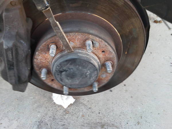

first take the wheel off and the hub cover i used a chisel and hammer

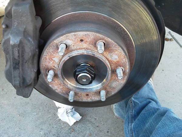

then remove the 35 mm axle nut I went and rented some sockets

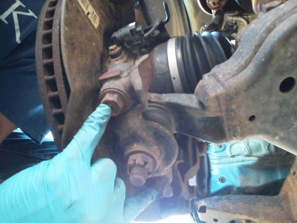

then remove the two 19 mm ball joint bolts

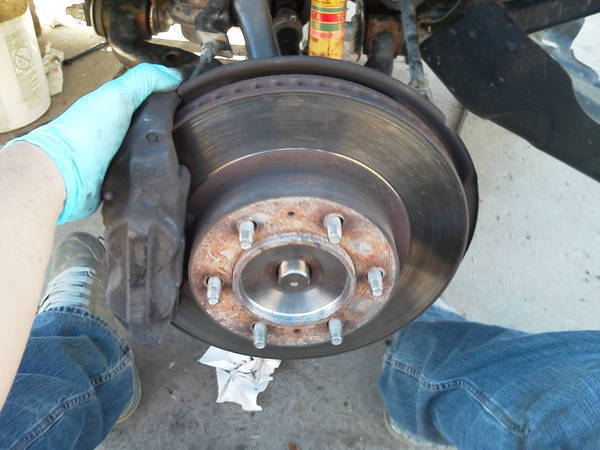

then pull on the rotor brake assemble push the axle out of the way and work it out with a pry bar
I did this by myself so it is doable but would have gone quicker with a second set of hands. hope this helped out there is another informative thread on this as well
