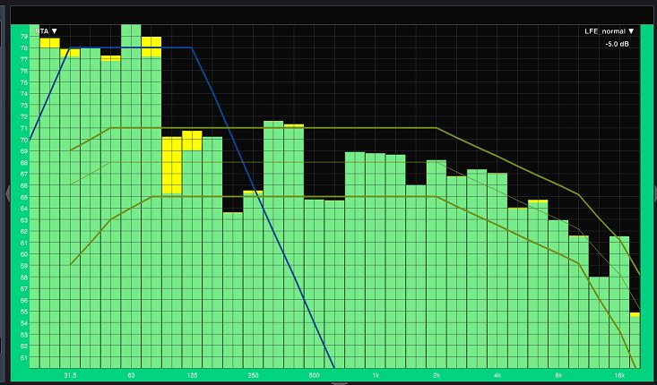

      This shows a dip that was corrected by reversing polarity on the subwoofer. Green is normal polarity, yellow is reverse.
