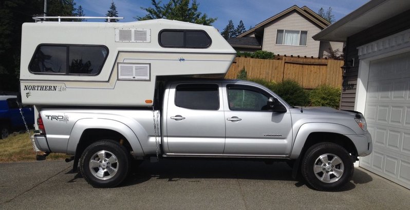

2013 Tacoma / 91 Northern Lite 6'10"
OME NitroChargers, 884's, Dakars with 3 deg shim. Trailer weighs approx 700 lbs.

      this looks great, did you put anything in to help with the weight of your camper?
      roughly whats the weight?
    • neverstuck
      @steeds Thanks.
      In this pic the Dakar leaf packs are holding it at about 2" above stock height. I also have Timbren bumpstops mounted but they aren't engaged because the Dakars hold the weight of the camper on their own. The camper is about 700 lbs empty but all in, there's probably 900 lbs in the back of the truck here.
      I used to use only the Timbrens on the stock leaf pack and the weight of the camper had the Timbrens constantly crushed.
