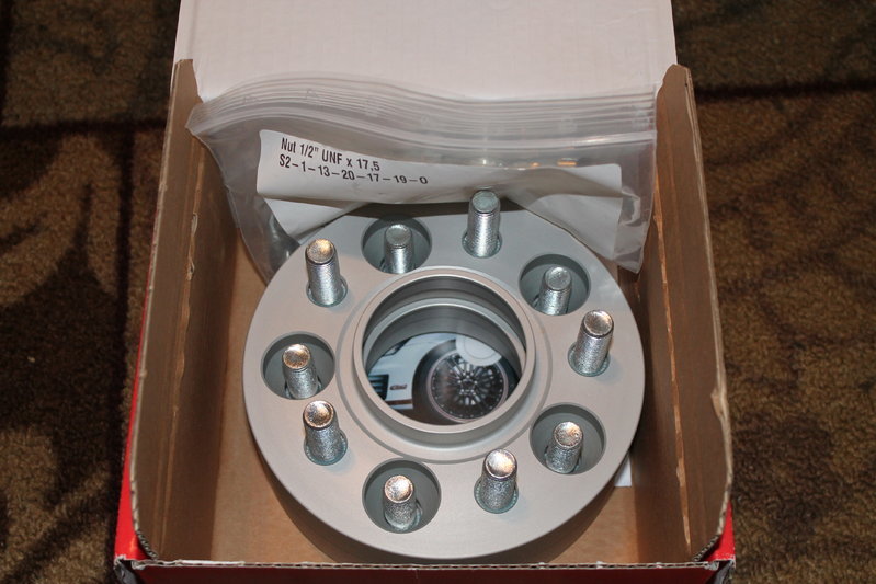

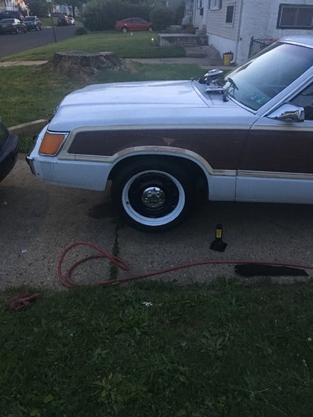

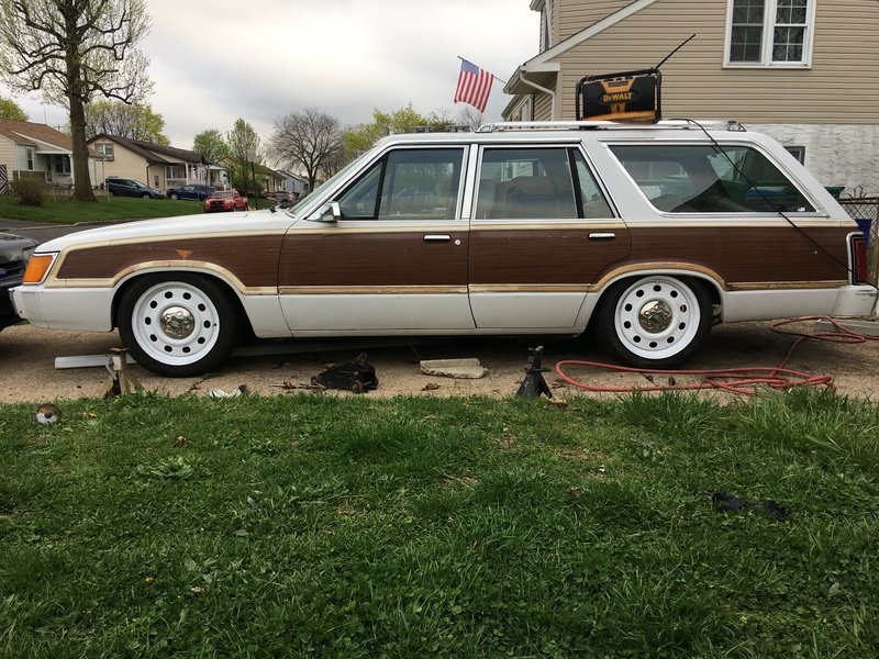

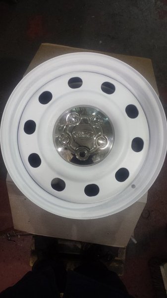

      Brakes are done! Cobra R Brembos behind 17x7.5 Crown Vic steel wheels. Clearance provided by longer ARP wheel studs and Eibach 25mm spacers. The Eibachs were adapter style spacers with studs built into them. I knocked the studs out of them to use them as basic spacers. Voila!
