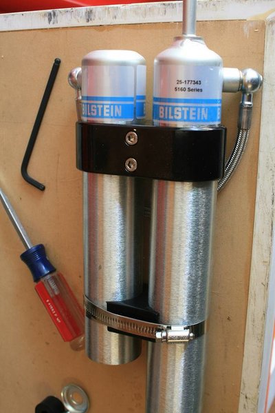

My first attempt at aligning the reservoir with the shock body. While it looks nice, this IS NOT how you want to set things up. Slide the black mount all the way up onto the shock body and the reservoir. Slide the lower spacer between the body and reservoir, then slide the screw-clamp into place immediately over the spacer. Tighten screws on the mount and the clamp just enough to hold things in place and then hold them in place against the truck's shock mount to get the vertical alignment correct. You want just enough space between the reservoir and frame/mount to keep things from rubbing. Mark them and then take the assembly back to the bench and tighten everything down snugly. Bolt into place, making sure the torque numbers are right and you are good to go.
