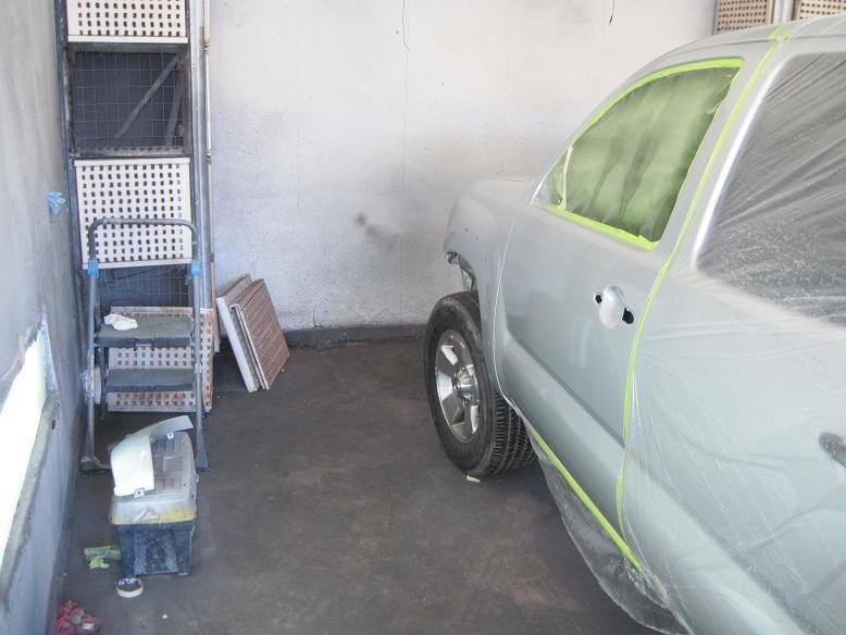

Cramped paint booth
Booth was small and grundgy. It was not my shop so there wasn't much I could do about it. Dirt had to be wet sanded and buffed out the next day. Choice of clear was European style Amtech Pro-Spray PSC-9100-S Glamour clear. It's an overall booth clear that is water clear and flows out beautifully. Easy to sand and buff the next day!
