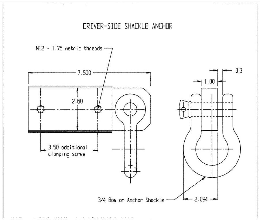

Driver-side Shackle Mount
Bars are 6061 T-6 forged aluminum - 36,000 psi yield strength - equal to mild steel. Milled to "just fit" into the frame pockets fore and aft. Hardware is M12 x1.75 flanged head screws - 10.9 material strength (same as SAE Gr8)..
