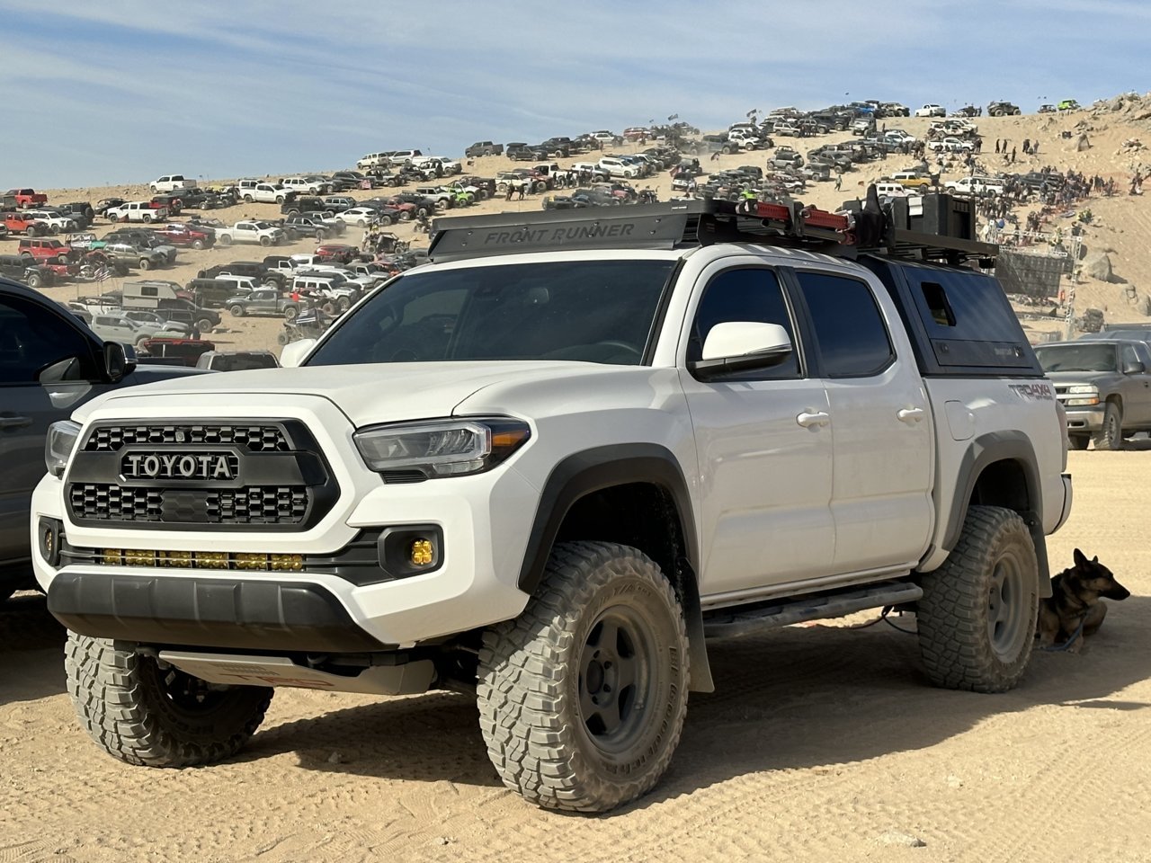

      Whats the wheel size/ is there a lift? Looks like you got the gunmetal f5's 0 offset! I have a stock 23 white OR and looking to get a similar rig!
    • Martian__
      @tbeck17
      Yes that’s the exact wheel I had in this pic. 16 inch with 0 offset. I forget the width but it’s the only 0 offset size. I ran 285/75 mud terrain tires KM3. The lift is bilstien 6112 and 5160 at max lift with arb emu heavy duty leaf springs. Stock upper control arms and no trimming. Just removed the stock mud flaps in the front. I replaced them with the rockblokz ones.
      I run the gen5 wheels in 17 inch with -10 offset now. Minor trimming required.
