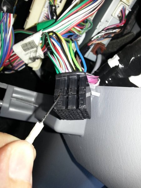

First lock
Pop up the primary lock with a small screwdriver
First lock

      Pop up this first lock, be careful, it only comes up a little bit. It is in the UP or "Unlocked" position here.
