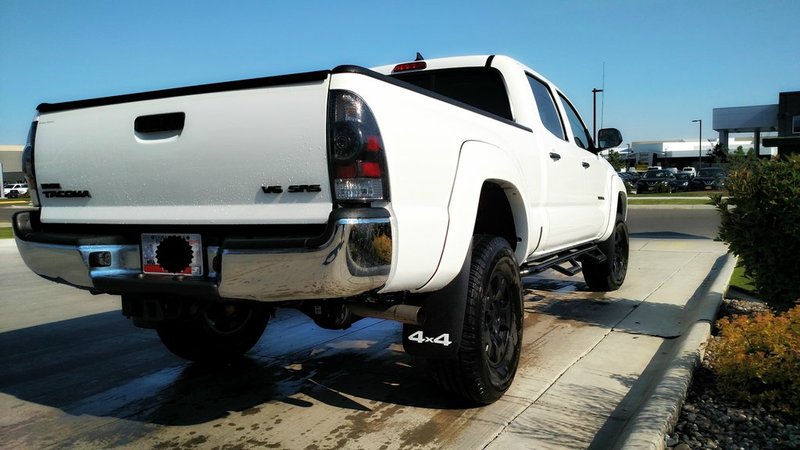

      What lift is that?
      how high?
    • Kyitty
      @mahaloTaco It's an Old Man Emu System front to back.
      887 Coils up front w/ Nitrocharger Shocks
      Nitrocharger Shocks in rear with full Dakar Leaf Pack
      My very crude measurements put me at 2.5 - 2.75" lift up front. Rear is about 3".
      I didn't get the same measurements on driver vs pass side on front or rear. So I may let it settle for a few days and measure again.
    • mahaloTaco
      Can you fit 35" tires now? :drool:
      so the front is lower than the back?
