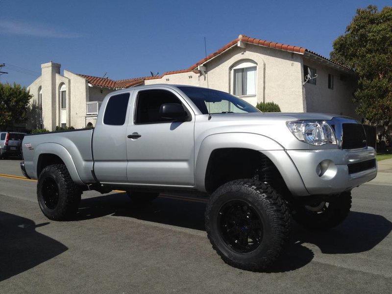

this is what happens when you install a 4" spindle with the toytec 3" lift coilover ( as it came shipped ) now i have to compress the spring and re adjust the coil to max travel and lower it back down.
