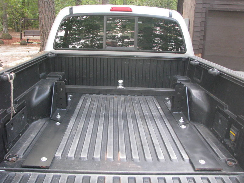

A couple of shots of the hitch I fabbed for our 19' Scamp and the working version taken on the Hatteras to Ocracoke ferry on the NC Outer Banks. I couldn't find anything available in the aftermarket so this came from parts laying around the shop. The uprights bolt to the 3/8" x 6" x 60" flatstock and the flatstock to the bed using the six stock bed bolts. The cross bar is 3" channel. The camper grosses around 3200 with 400 or so on the goosneck. 10K+ with trips to Big Bend NP (TX), the Keys and the Smokies with nary a problem. Just upgraded the 05 (200K+) shown here to a 12 and transferred the hitch in less than fifteen minutes.

      Your giving me hope! I bought a Thor Prizm and have had mixed messages whether I can haul it with my 02 4cyl Tacoma
