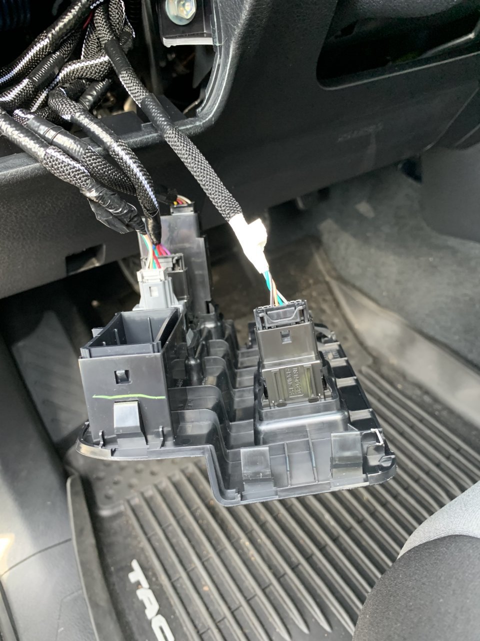

Panel Removed
here is the panel removed with the stock plug that needs to come out. note the detent above the yellow line push in on those (2) and pull out the plug carefully. Mine was tight as hell!! the plastic of the panel is less robust than the plug so you might want to cut off the tabs on the blank...
Panel Removed
