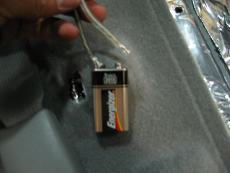

After you've ran all you wires to your connection point, connect one end of your speaker wires to the speakers, then use a 9volt battery. connect one end of the wire,and quickly pop the other end of the wire to the battery. you'll hear a slight pop in a speaker.
