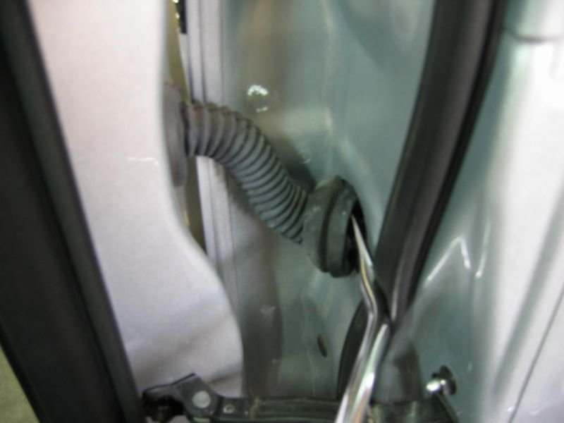

Pop the rubber boot out from the door for easier flexibility of the tool to go through. Be careful so as not to rip the rubber boot. Putting it back is simple, just make sure the grommet is in the hole after you're done. Place it in the hole at the farthest point away from you, then work it towards the front of your view.
