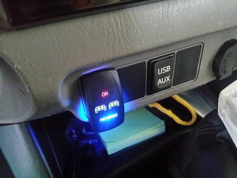

SR20 and OTRATTW reverse switch
deeezy, Dec 13, 2014
    • BigE
      how much trimming did you have to do to fit that switch there?
    • deeezy
      Not much. You'll when you take the blank out. I just took a little by little out until the switch could push in. You don't want to take to much out or the switch will be loose and might not sit straight. I used a dremell, the cylinder sanding thing. Make sure the switch has resistance going in. If it goes in really easy, chances are it'll be too loose.
