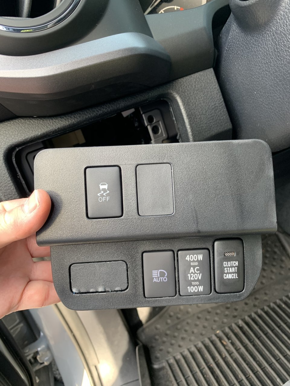

removed switch panel, just slide a plastic thing in the side to get leverage and pull straight out there are like 6 clips around the outside.
