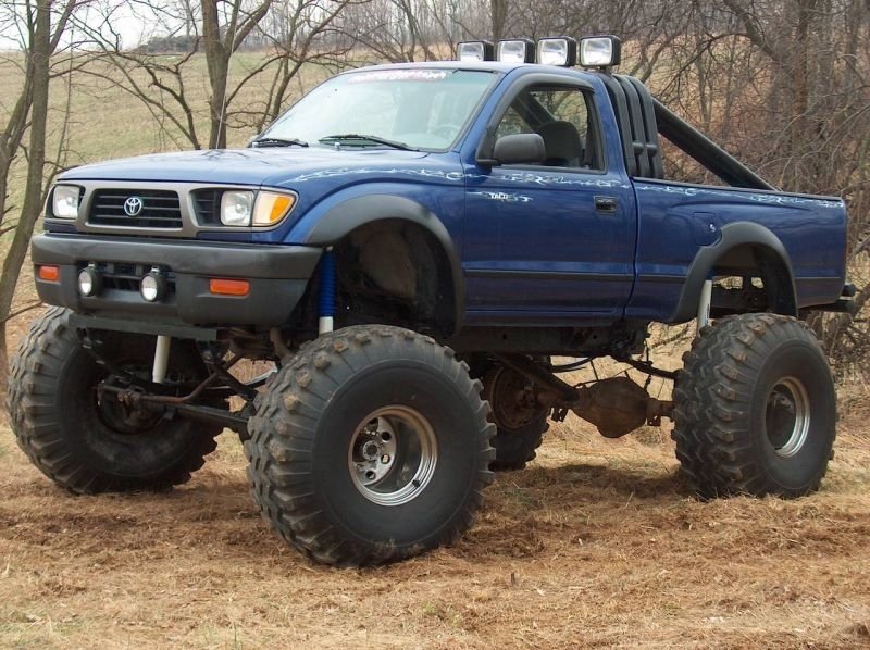

    • 350TacoZilla
      lol lift is kinda simple kinda not...made all the mounting points myself so i lowered them down a bit..springs are 4.5 inch springs for jeep wagoneer then spring over axled for another 6" lift... 3 " body lift...parked beside a stock taco with my stocks on and it sat 25" higher than stock so I figured my stock 1 ton tires added about 2" of the lift...so 23" is what i would say is the size of it
    • The_Hodge
      u definately have to bring this puppy down for the meet!!
    • georgiajake91
      what kind of motor do you have in there? hopefully not the original toyota motor. i have the 3.4L v6 and i got 35's and the motor struggles to pull those expecially at speeds over 60 mph!
    • 350TacoZilla
      it first went to a chevy 350 hence 350tacozilla then went to 450hp 383 stroker
