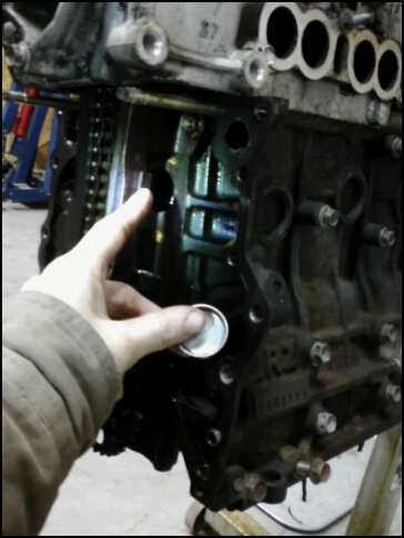

The whole problem- a Freeze Plug
May have just saved myself a couple hundred bucks- found a freeze plug in the oil pan when I took it off, and later found where it came from. This is the whole reason there was water in the oil- from here, it drained directly into the pan.
