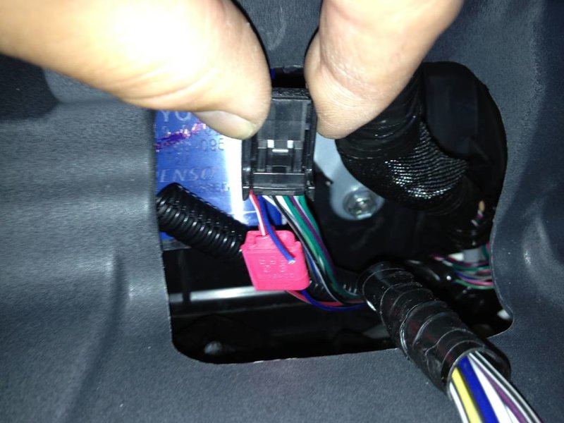

removed tape, pulled wire out of plastic protector, cut solid blue wire, taped end coming from plug, attached blue line going to harness in inline to the red/white wire, plugged back in to tpms, done.

      Ok so I grew a set cause I didn't want to take my dash apart, but I did the exactly the way you stated that worked for you and it worked on my 2015 Tacoma. Thanks so much for your time and all the input by everyone else. If your having trouble getting the plug back in take out one of the blanks below and it can help guide it in from two spots. It actually went in really easy. So any one that has a late 2nd Gen this WILL WORK for that dreaded tpms light.
