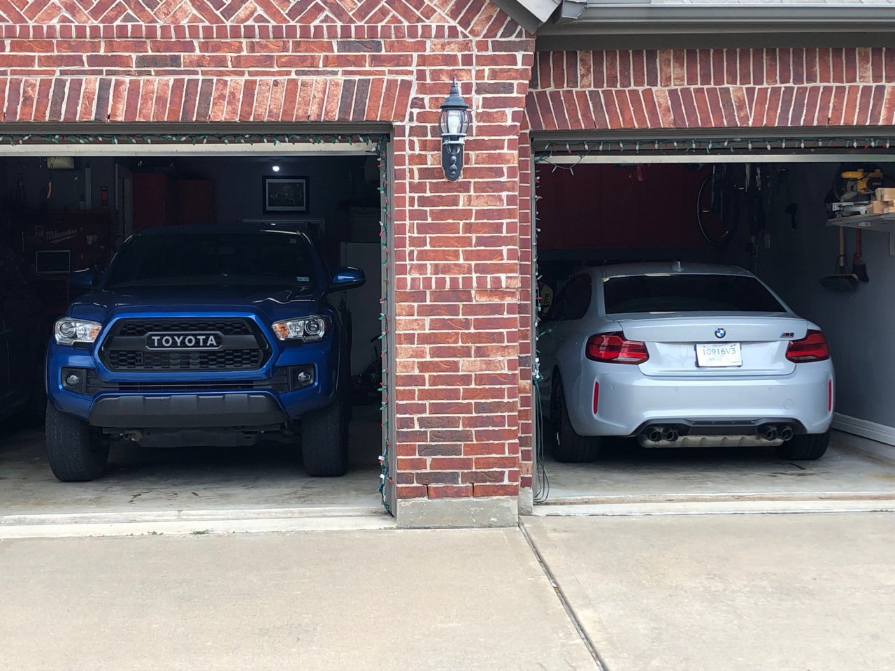

    Thanks folks. I'll run into the dealer next week. Here's a shot of the truck and my new ride (M2 competition), which I won't be disappointed to run around in while the truck gets checked out.
