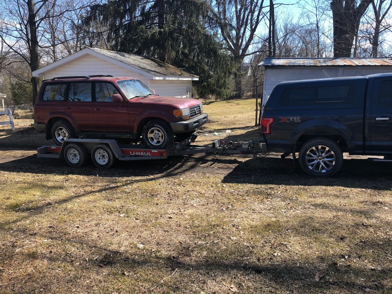

    A few months ago I spotted and land cruiser sitting behind a funeral home in a nearby town. After a quick phone call and looking over the vehicle I was quickly the new owner. What I ended up with is this 1995, one owner, triple locked FJ80 with 98k miles. I still need to take the vin to the local Toyota dealer to see if they have any service records.
    The story they gave me is that the sunroof leaked somewhere around 2008, and instead of cleaning the interior and clearing out the drain holes they parked the vehicle and bought a new suburban.84653254-E322-4D63-9FD5-3C89DC0AF362.jpg

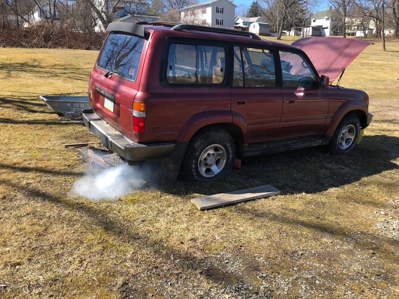

    First order was to see if it would run. I pulled the plugs, spayed the cylinders with wd-40, and let it soak for a few days. Changed the oil, rolled the motor with a breaker bar, put in a new battery and fired it up on some starting fluid.
    I disconnected the fuel filter and tried to cycle the fuel pump but no gas came through. Quick trip to the parts store and they had a fuel pump the next day. 28993FBD-F89E-42EB-89AA-9EA9A1FA4500.jpg
    After a week of fussing with it in funeral home parking lot yard I finally had it running, and the wife started to calm down. Now the fun starts, haul it home, get it road legal, clean the interior , and put some miles on it.30C13B2D-E1E6-41A1-B322-A0E55E907A59.jpg

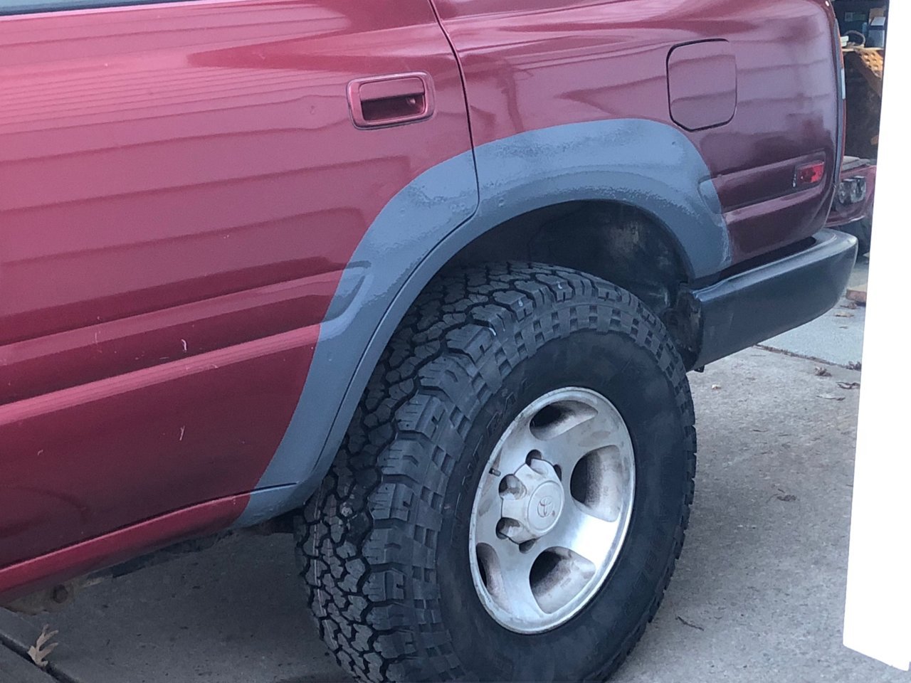

    I immediately pulled the running boards as they were rusted through, and in the process got a little zealous and pulled the fender flares too.

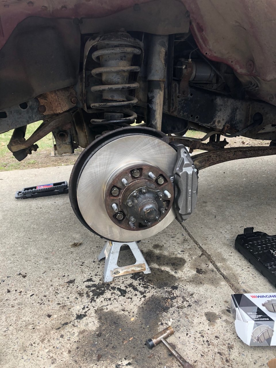

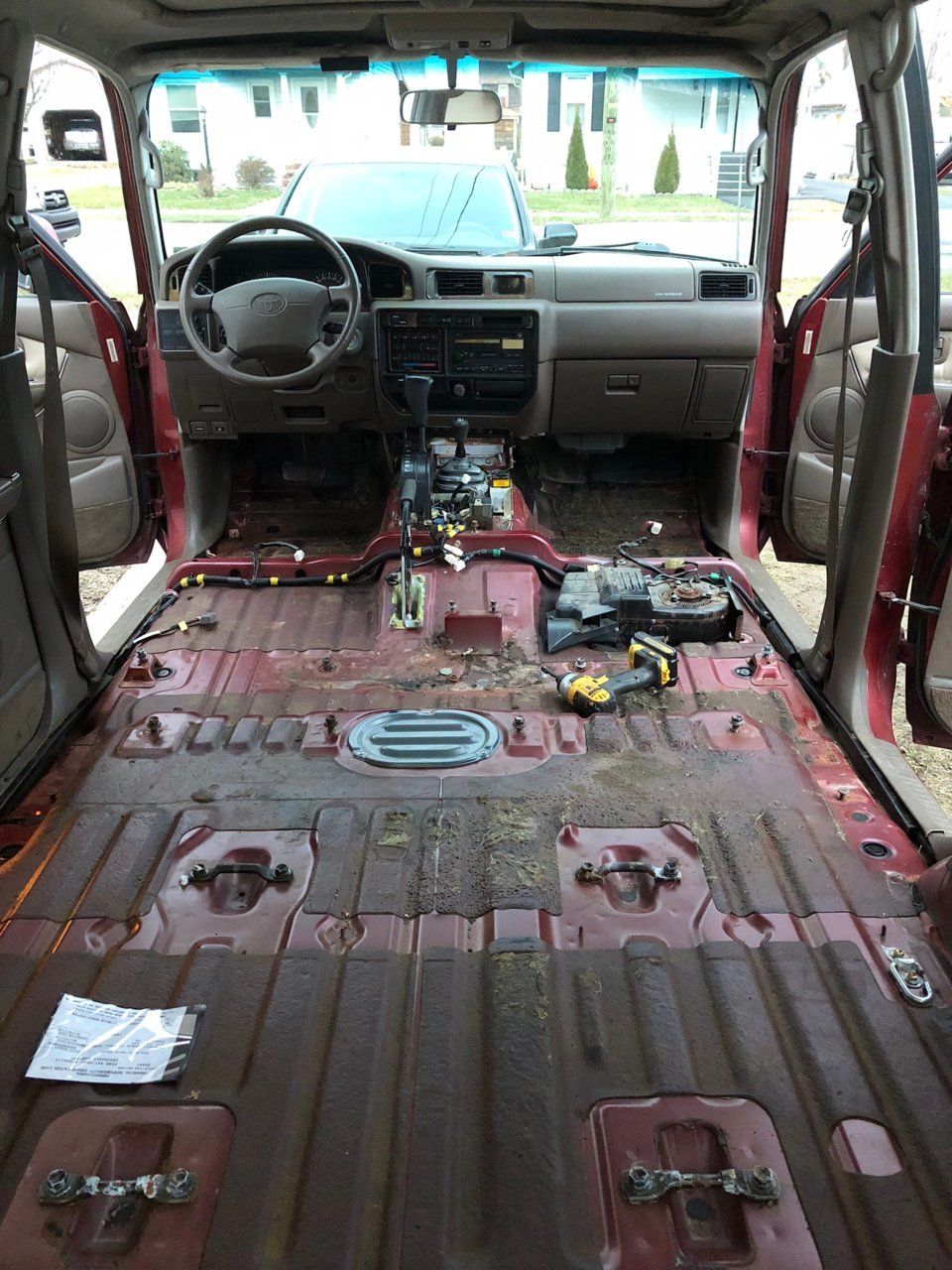

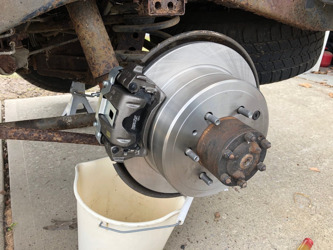

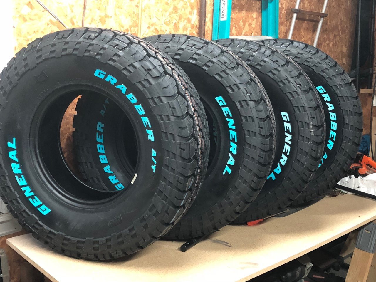

    So far rear brakes are installed, new generals in 285/75/16, and the interior is mostly out. The leaking sunroof and 10 years of sitting made a nasty mess inside. Hopefully the weather will cooperate this weekend and I’ll get all the interior cleaned and back in as well as get the front brakes installed. 1C052ED0-BD09-423F-9B8E-D2BCAEEFA571.jpgACAFFA2F-70BF-4D0D-B3E8-6C189112DD92.jpg
    I’m considering putting Monstaliner on the rockers and around the wheel wells so I figured I’d try some plasti dip first. Not sure I like to look yet..

    Holy crap that must have been quite the moldy headliner!

    It’s disgusting. I’ll grab a picture of it tomorrow to post. So far I’ve used most of a Clorox bathroom spray bottle getting rid of the mold on the doors, dash and seats.

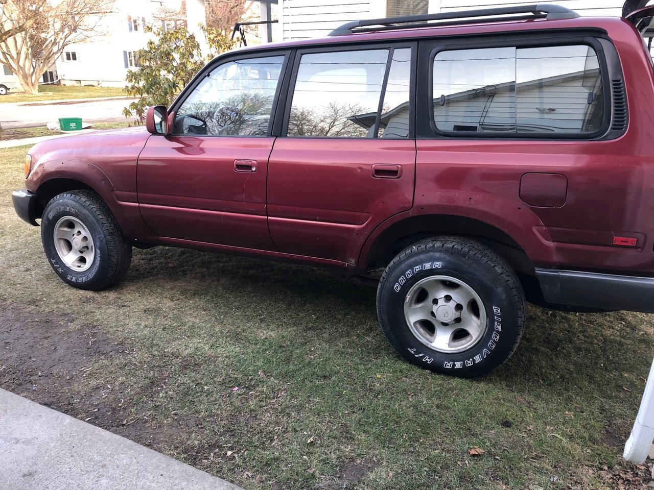

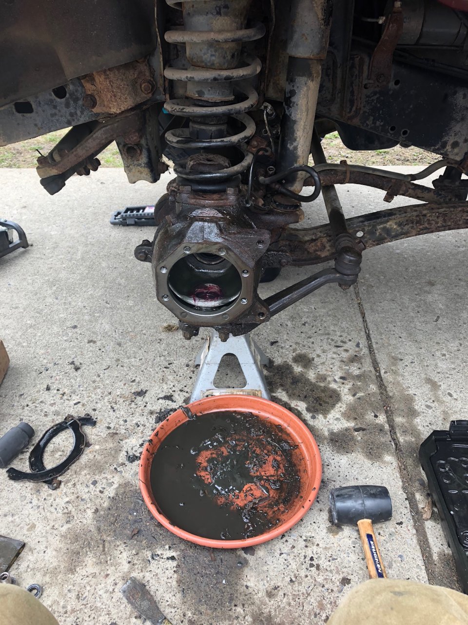

    Finally was able to get the cruiser inspected and on the road. Spent a weekend going through the front axle and brakes and then took it to a local shop for inspection. 0B162C25-F235-4A23-B86C-33631D70580B.jpgA073824B-FBED-4270-8293-B0ADC7DED986.jpg

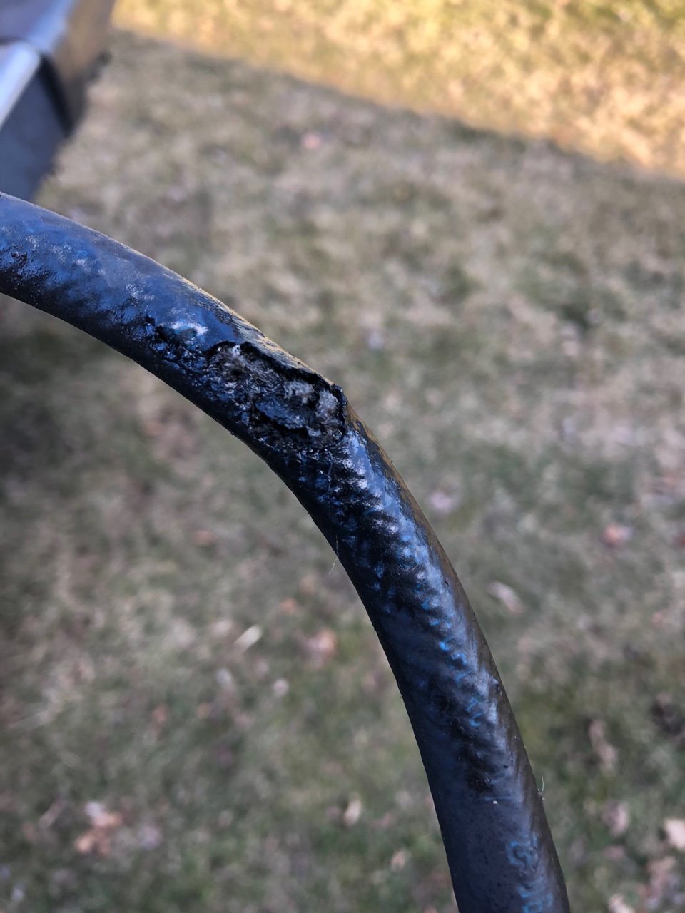

    I ended up changing the rubber brake lines, master cylinder, and vacuum booster before I could get the brakes to work right. It was a little more than I planned to do at this time but I’m glad I did. Similar to ever other rubber part on the truck, being parked for 10 years was pretty rough on it. D02B8336-66CD-4A2E-8242-17BC8A603B34.jpg

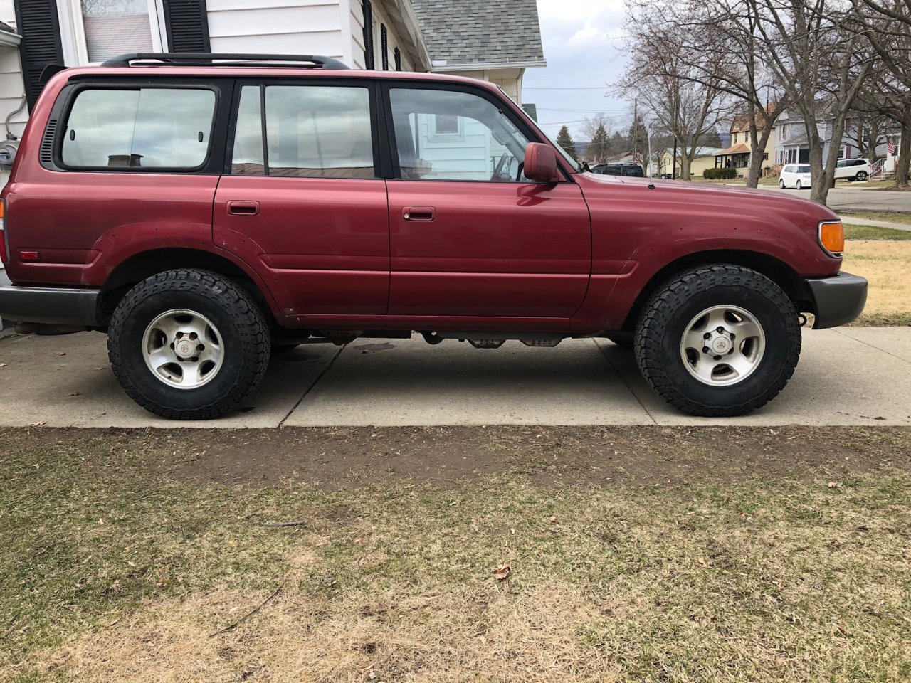

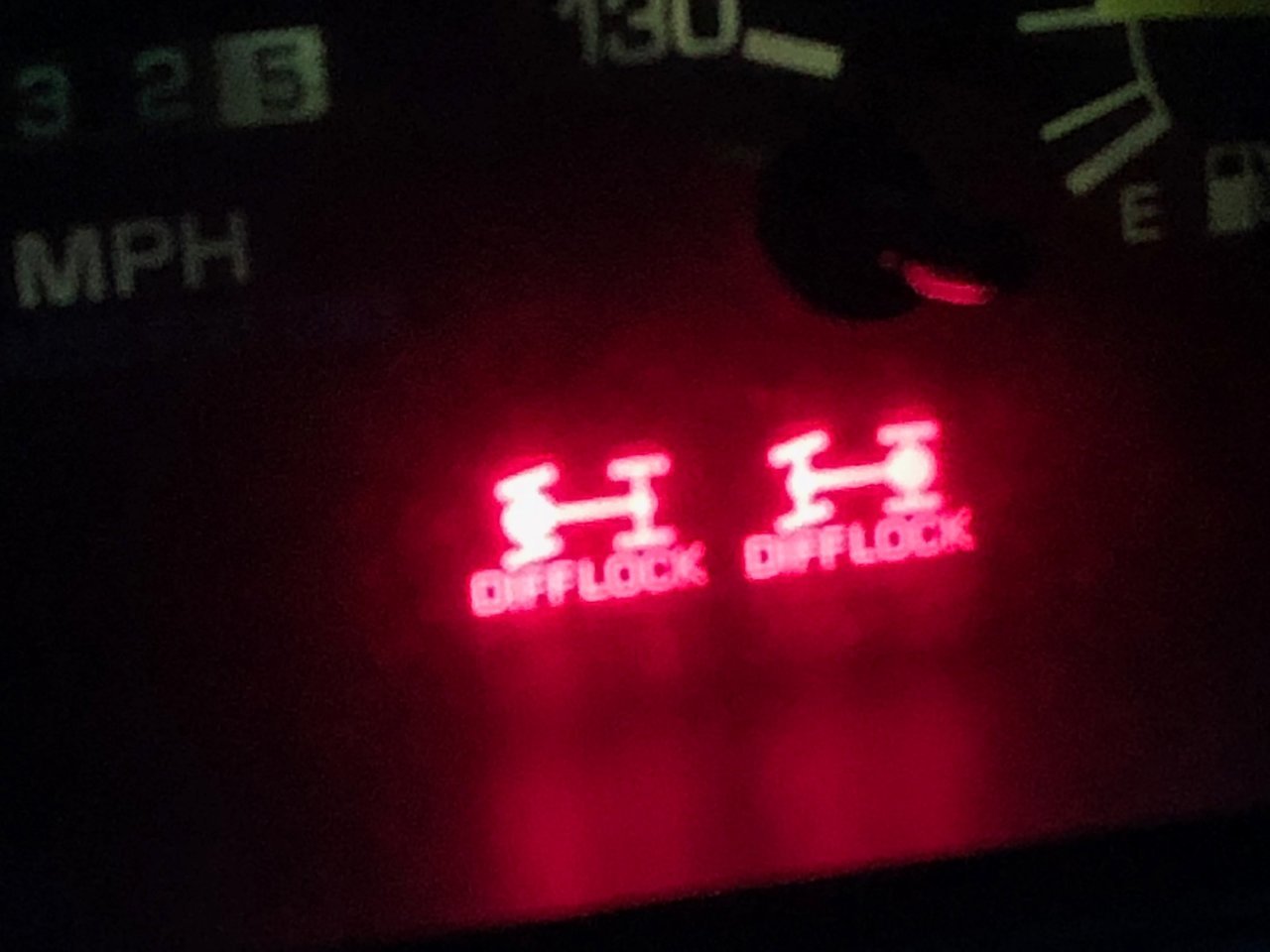

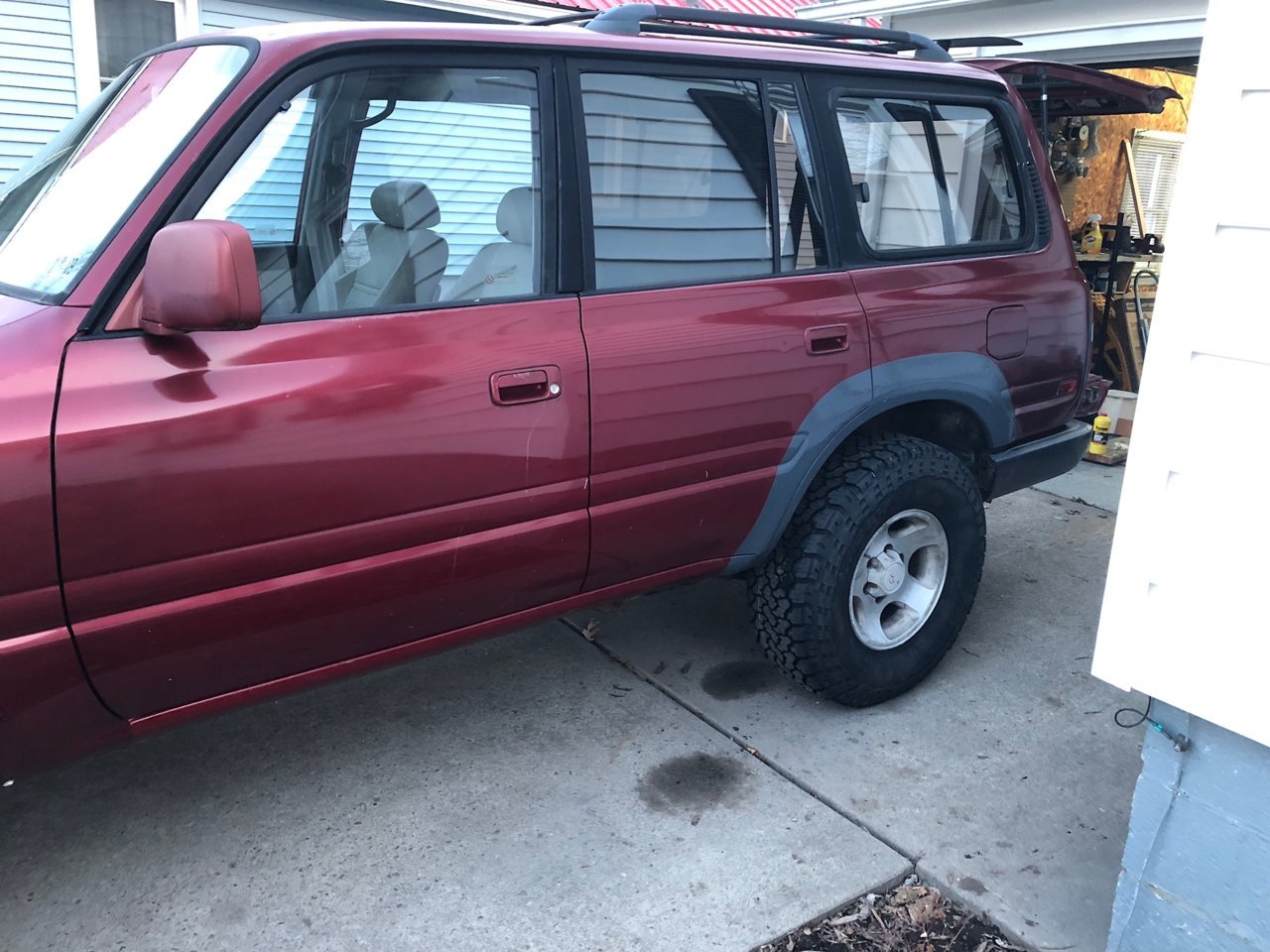

    Both front and rear lock engaged without any trouble.
