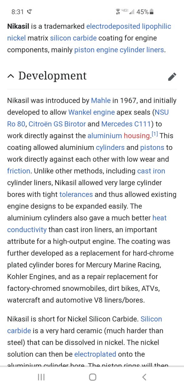

    I know that my Suzuki Hayabusa used a coating SCEM their name for it. Looks likes it's been around awhile.Screenshot_20211106-203125_Chrome.jpg

    I first heard of nikisil in the 1980’s when it was used in some 2-stroke dirt bike engines that could not be re-bored.

    The first gen NSK engine pretty cool too. It had ceramic impregnated liners for extended service life and to reduce internal friction. Not serviceable, but pretty cool technology for the late '80's, early '90's.
    Edit :Well if I had just read @tacotoe 's post I would have seen that it is the same technology. I guess that was the first time I remembered reading about it.

    There is a super small allowable tolerance Toyota doesn’t list. But Marc and some others have found you can take what’s literally next to nothing out to remove light Scoring and have no ill affects

    The liners are not sprayed on, they are cast in iron sleeves.
