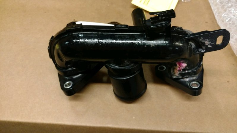

    Behind the rear of the heads there is a coolant pipe that transfers coolant between the two cylinder heads. The pipe seems to be molded from two pieces of plastic that are sealed together. The sealing area has developed coolant leaks of some of the tacoma's. Make sure you check it before your powertrain warranty ends because it's going to be a fair amount of labour to change it.

    I don't have the issue "yet" on my '18 but have seen it on two other 3.5's. Toyota super long life coolant reacts with oxygen and a small leak will appear as pink growth as it evaporates so you won't see it dripping under the vehicle.

    Not my pictures.

    The ones I saw were leaking along the seam of the pipe in the middle. It never gets to the point of running out. You will see a pile of pink growth where the leak is happening.
