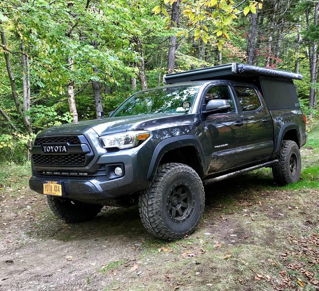

    Gotta be 255 85 R16’s on SCS Rims... ideal size on a Tacoma. IMHO of course.
    No CMC, OME Lift Installed.

    Sweet!! :bowdown:

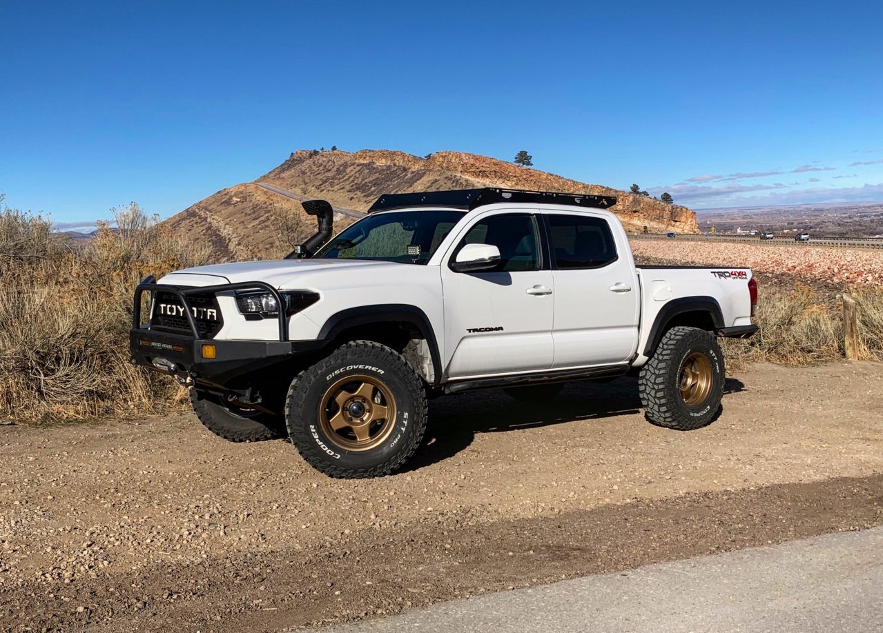

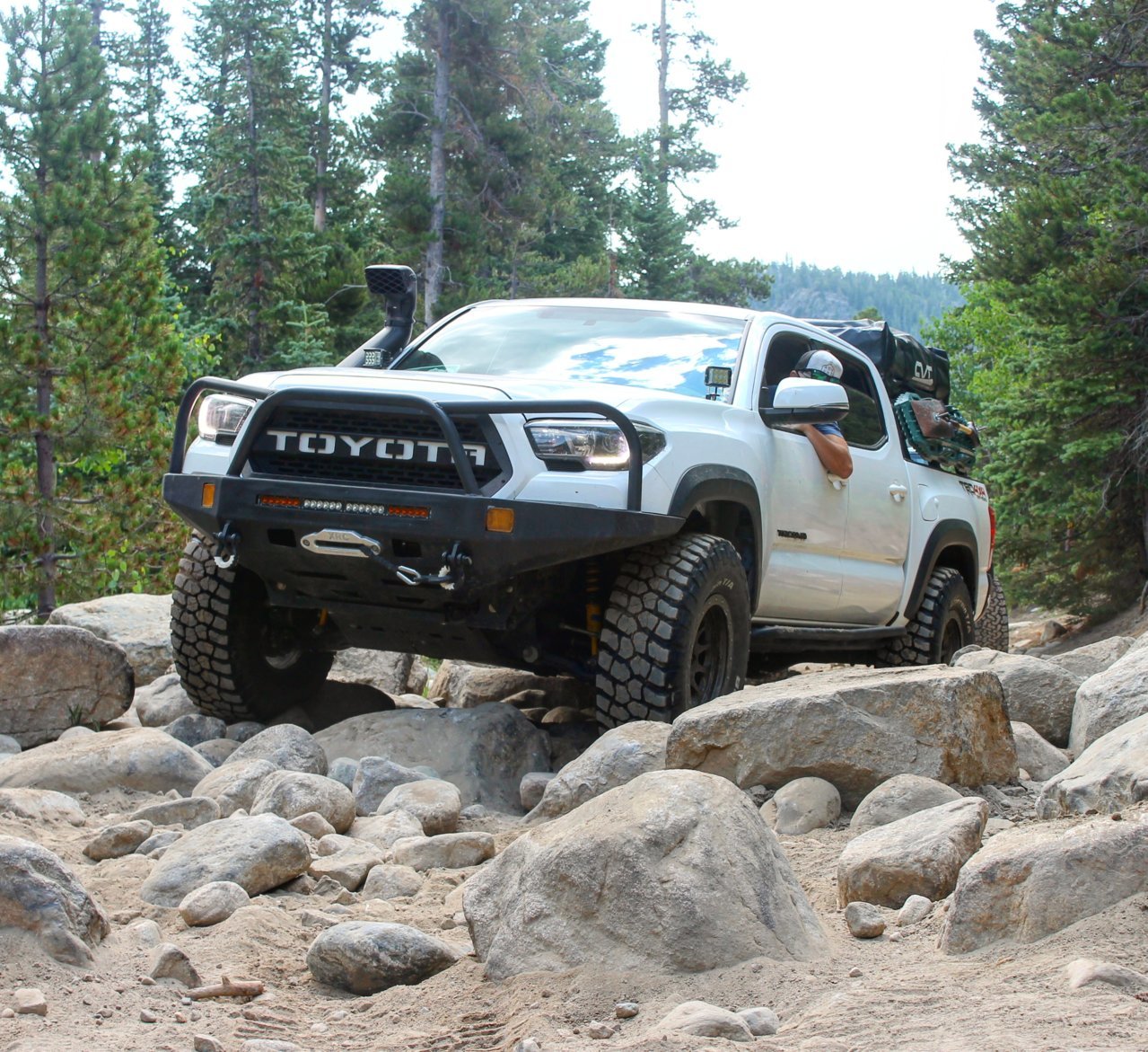

    958EE12C-41BE-4E88-BFFA-45DB4833D08C.jpg BB1FAC12-E5D9-4971-86E4-5BB1F2141ACA.jpg First pic (current): 315/70r17 on 3.5”BS
    Second pic (old): 35x12.50R17 on 4.3”BS
    The diff clearance is great. I’m only running about 1.5” lift in the front, and 2” in the rear, so there was a lot of chopping and smashing to fit them

    The 35s have now rolled into the thread!!! why only 1.5” in the front?? For more droop? Wouldn’t you want 2-2.5? For 35s? (I’m still learning all of this)

    With stock geometry and bumps, I have exactly the same travel as anyone running 0-3” lift (except the fox/king/etc extended travel coil overs, those have a little more droop), but like you said, I have less uptravel and more droop. I like to keep my truck low for cernter of gravity, and stability. Keeps me from getting too tippy, plus I drive a lot of canyon roads and don’t have a sway bar haha

    Damn tell me more!! Talk “dirty” to me!! What suspension did you go with? I’m very interested on how you fit those with minimal lift!! Front bumper removal a must? How much ‘smashing’ & cutting?

    I’m dumb so I went with the buy twice cry twice method. I’m running OME nitrochargers at the moment, and will eventually upgrade. SPC control arms help a lot, they allow you to push the wheels further forward, away from the fire wall. Then it requires a sever cmc, beat the pinch weld over, and then beat the firewall back an inch or two. I removed my fender liners, and beat the top of the wheel well up where I saw it was rubbing. Fenders are trimmed about 2.5 inches, and flares are trimmed about an inch. Definitely possible to do this with a stock front bumper, you just have to continue your trimming forward.
    Edit:
    In the rear I just removed the liners, and the bolts on the bottom of the flares. Not 100% sure that my rubbing is gone back there but it’s not damaging my tires or the bedsides

    Also, with the 4.3” BS wheels, there was an inch less trimming on fenders, and the cmc wasn’t as sever, and the firewall did not need to be beaten back as far. I’d say that’s the best backspacing for 35s and minimal lift
