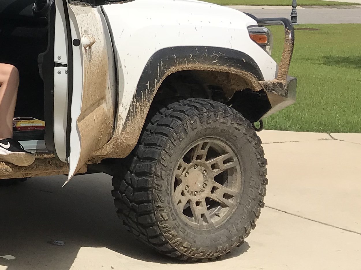

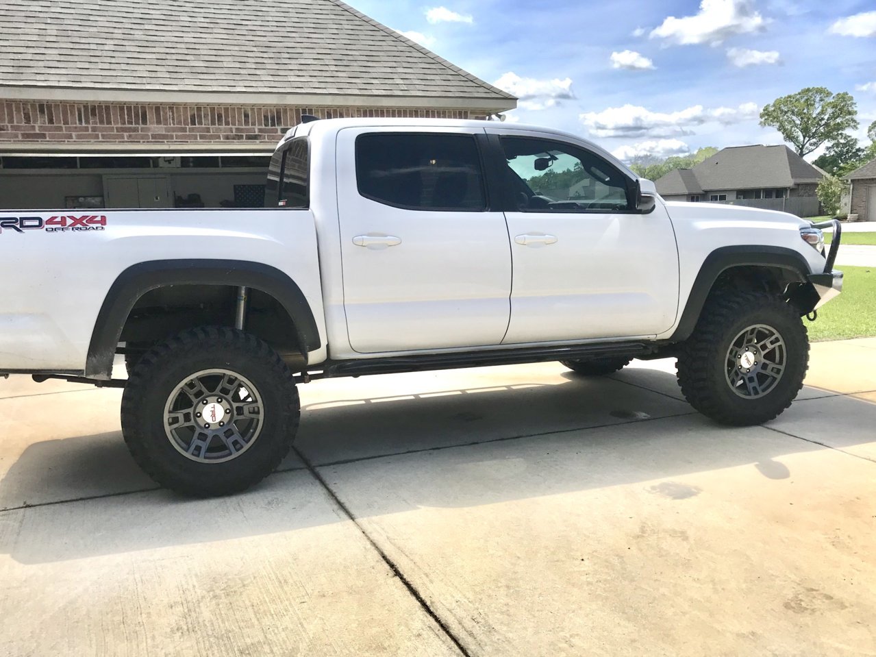

    I have 295/70/17.
    Had to CMC, beat pinch weld flat, trim lower part of the fender near the cab mount, and heated/reshaped the fender liners.
    Because I did a 63 swap and shock relocation in the rear, I had to add a 1” spacer so my tire wouldn’t rub the shock at full articulation. I probably would’ve had much less trimming without the wheel spacers. When I get funds, I need to just get new wheels with 3.5” backspace.
    I should’ve just gone with 315/70/17 the first time. Apparently I also like to buy/cry multiple times. Wheels, tires, suspension.....

    Looks sweet!! Spacers on all 4 wheels? Or just the rear? Oh and what’s the BS on your current wheels? Look like factory TRDs

    Thanks!
    All 4. I thought it would’ve looked funny with just the rear.

    Agreed.. what’s the BS on the wheels you have now?

    4.5”
