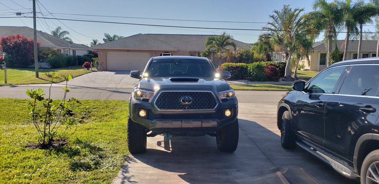

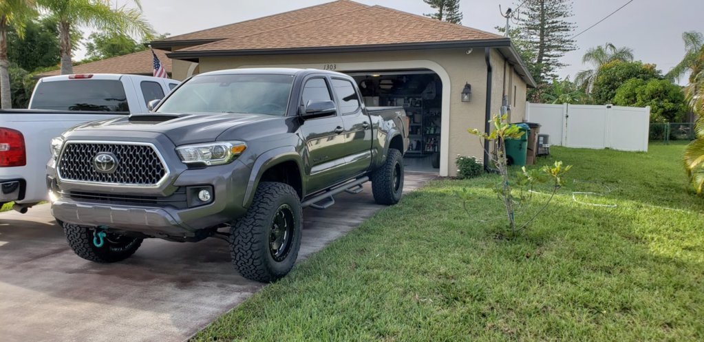

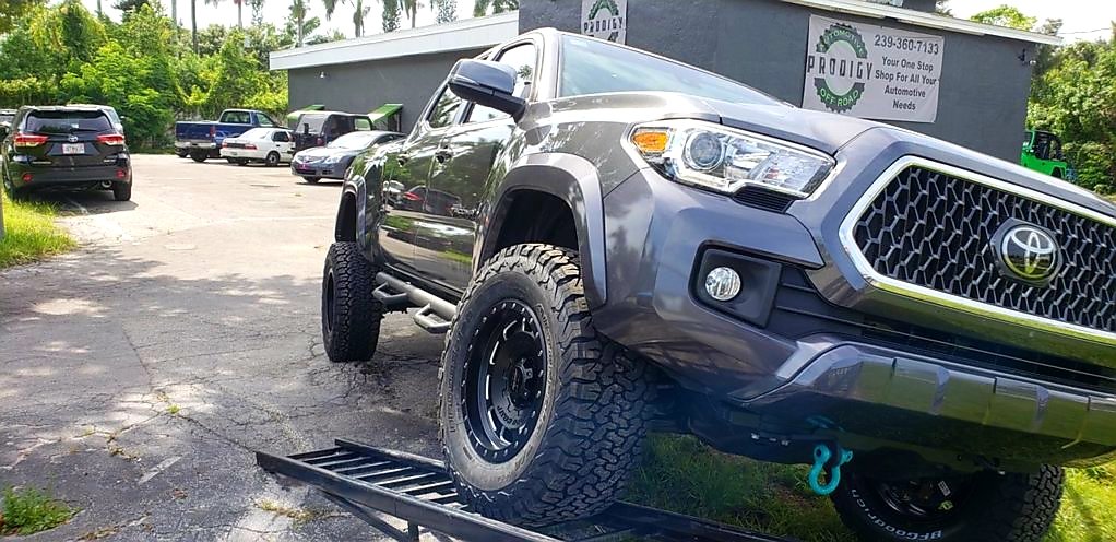

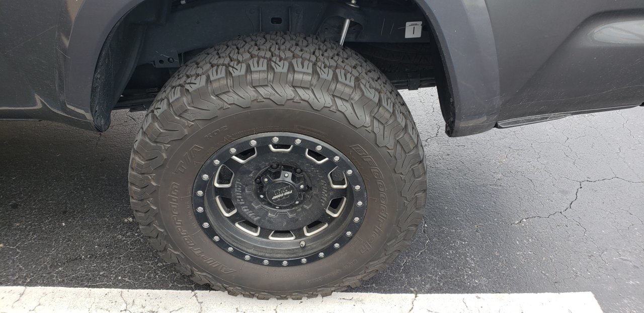

    305/65/17 KO2 on 3" leveling on front and 2" on the rear. The weight of these tires are killing the power and the ride at 63lbs/tire. Truck gets hungry for gas on the highway and constantly hunting for gear. (Used ECT, it helped a bit)
    Had I known they were going to bog it down, I would have chosen a lighter tire.
    Choices are limited at 275/70/17 . I think there is cooper and Kumho. So now I am considering 285/70/17 maybe a Bridgestone Dueler A/T Revo 2, to keep the weight in the 47 lb range or so.
    I am tired of that lousy ride. Don't get me wrong, the KO2s have a hell of a grip on the road and off road, but too heavy for the truck.
    Wheels are procomp 5160/ 4.5 backspace.
    20180725_222355.jpg 20181117_092549.jpg 20180723_182340.jpg 20180926_160039.jpg

    I’m on 285s with a leveling kit on my second gen and the ride sucks too.. I don’t have any gearing issues.. the ride is just uncomfortable and jarring
    Oh and about 13mpg city 18hwy

    I am maintaining between 17.5 and close to 19 mpg locally, but it's a menace on the highway. Coming back from NC to FL , I was getting between 13.5 and 15 mpg. Anytime the speed is over 65, the mileage is ruined.
    I am comptemplating bring it back to stock and put 265/70/17 where no lift or leveling needed.

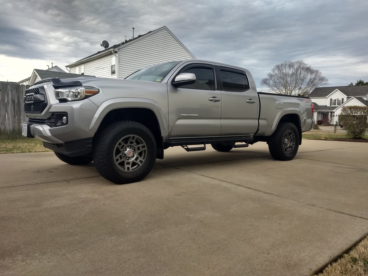

    Bilsteins 5100s on the top setting, 4runner Gray TRD Pro Sema wheels, 285/70/17 Toyo AT3s, Sumo Bump stops, TRD exhaust, ECGS Clamshell bushing, 1/4 shim for the lean and one inch rear block, OEM Pro grill and garnish OEM TRD Skid plate, TRD CAI, Demon Brackets, Rigid Industries Pro fog lights, OEM Trail Rails sidebars, Diode Dynamics LED SL1 high and low beam lights, OEM Roof racks, Clazzio leather heated seats, Remote Start, TRD Pro shift knob, tinted windows, Rockford Fosgate 4 channel amp for the headunit and sub and amp combo, OEM Puddle lights, OEM tailgate lock, OEM bed mat, LED interior lights, OEM blackout kit for letters, JLT catch can, upgraded 27F toyota True Start battery, Vleds led tail light kit with Pro tail lights, OEM Rave4 side mirrors with convex spotters,just to name a few mods.
    IMG_20181009_181855269_HDR.jpg 265/70/17 Toyo open country at2 SL. Up on some Bilstein 5100sIMG_20190101_121008363_HDR.jpg

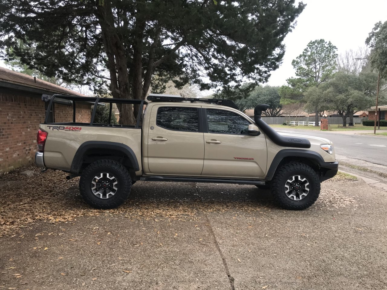

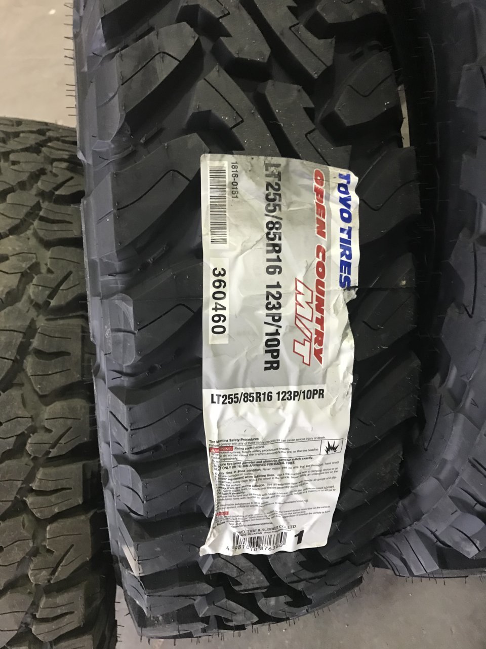

    255/85r16 Toyo MT
    No cmc required. No rub. Fit stock wheels well. Fit stock height or lifted. Pizza cutters FTMFW.17CCE6A2-27FB-47C4-AF18-D8D0DE8B0A36.jpg11651FCF-7883-4B2B-B792-7C45BDD5BE0F.jpg

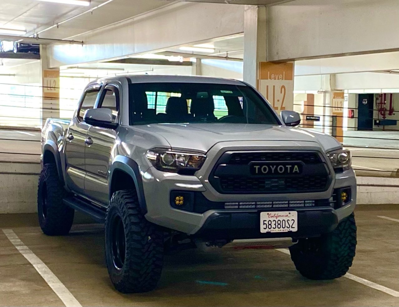

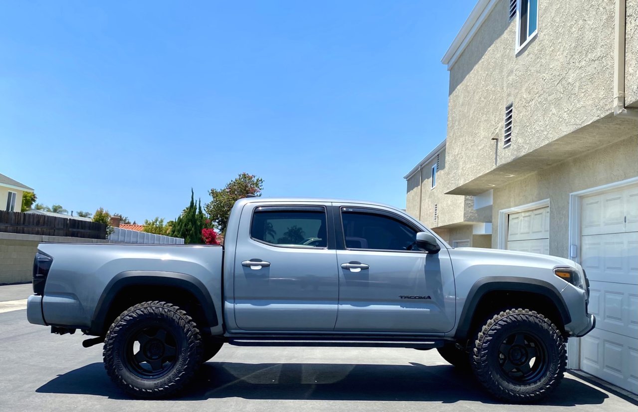

    17X9 295/70R17, 2/1 lift, CMC etc.
