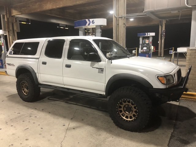

    Here’s my DCSB with an OME and 285/75/16 tires for reference. It rubs a little bit I believe that’s due to the 1.25” wheel spacers.
