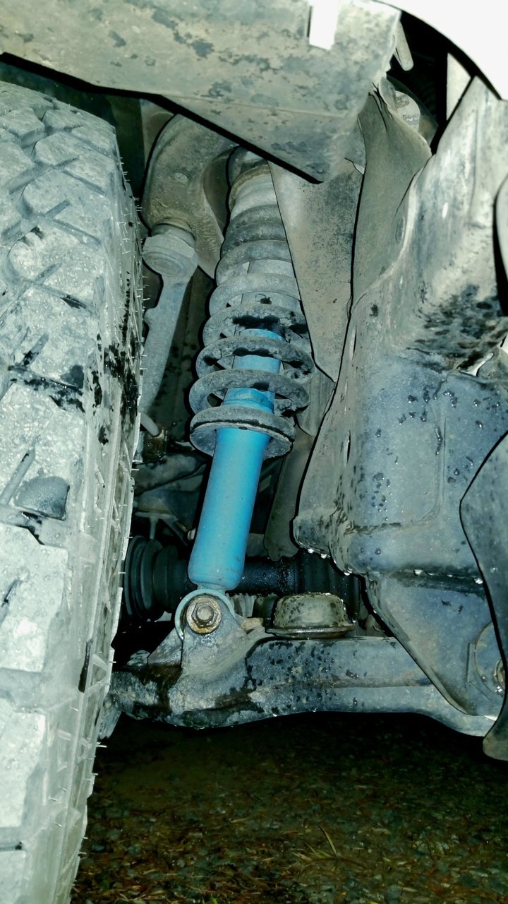

    Need a picture of the top of the front shocks.

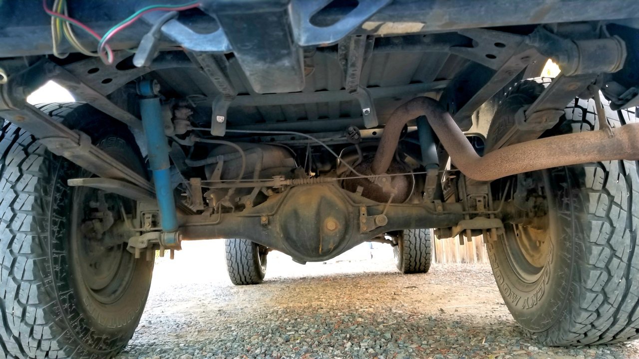

    Looks like you have a spacer in the front and a block in the back.
    spacers and blocks are really the same thing, just a piece of metal like this

    Nice truck OP. Personally I bump down a size from 285. Most gens it's an issue without some persuasion like :sawzall: or :smash: and sometimes much more much more. A pic of the mount of the front suspension from the should help you get more questions too as previously asked for.

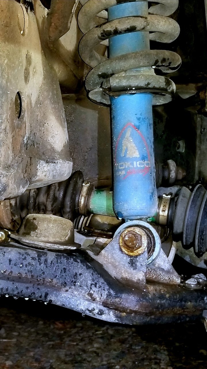

    You will need some new shocks soon.looks like the bushing on the front bottom is gave up.you can replace just the bushing if that's what ya want,if they aren'tt leaking any fluid.
    With the bushing calapsed like that you have lost a bit of front height...not a lot,but it is down on the bushings.

    You can just replace the bushings.look at were it attaches to the arm,front.....see the sag there....it will start clunking in the future....mine are a bit worse(no noise yet)I'm just going to replace my shocks(225,000)they are done...
    No need in spending 1000.00 bucks....just do the research,find a good set of bushings and have them installed.

    The blue (tokico) are used by toyota (my 2002 came with them while my 98 had bilstein). I dont believe 2001 came with them - I am thinking the truck originally shipped with yellow Bilstein shocks - could be wrong though. If you are looking to save some cash and want a basic shock on there that will perform well - I'm going to suggest Bilstein 4600s front and back. Not sure if the 4600s would require removal of the spacers/blocks - others can chime in on that. If you want to spend a more cash, then perhaps Bilstein 5100s in which case I doubt you'd have to change anything (blocks/spacers). Since I'm not really a fan of the spacer/block type lift - I'd vote return to stock ride height and go with the 4600s.
