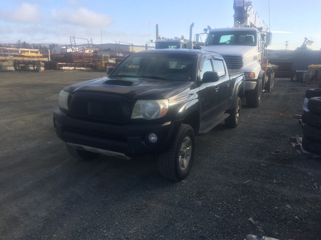

    Bit of filler on the smaller things i have done .....

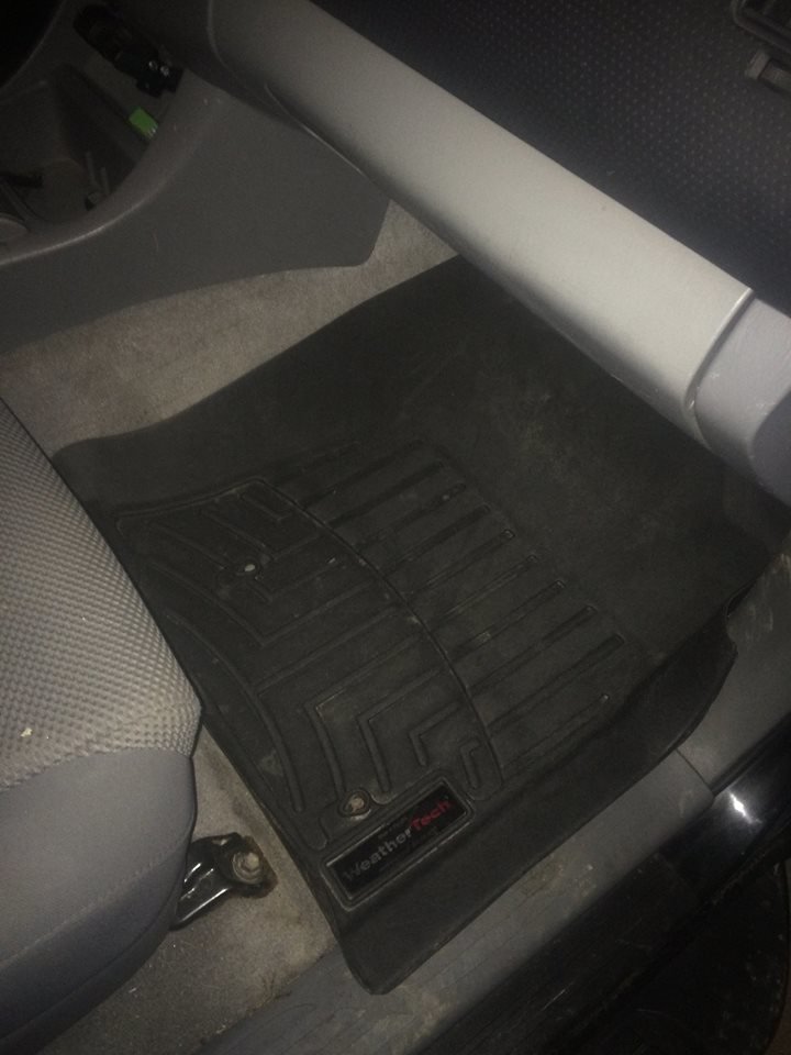

    Installed used weather tech mats, stressful job but it had to be done lol

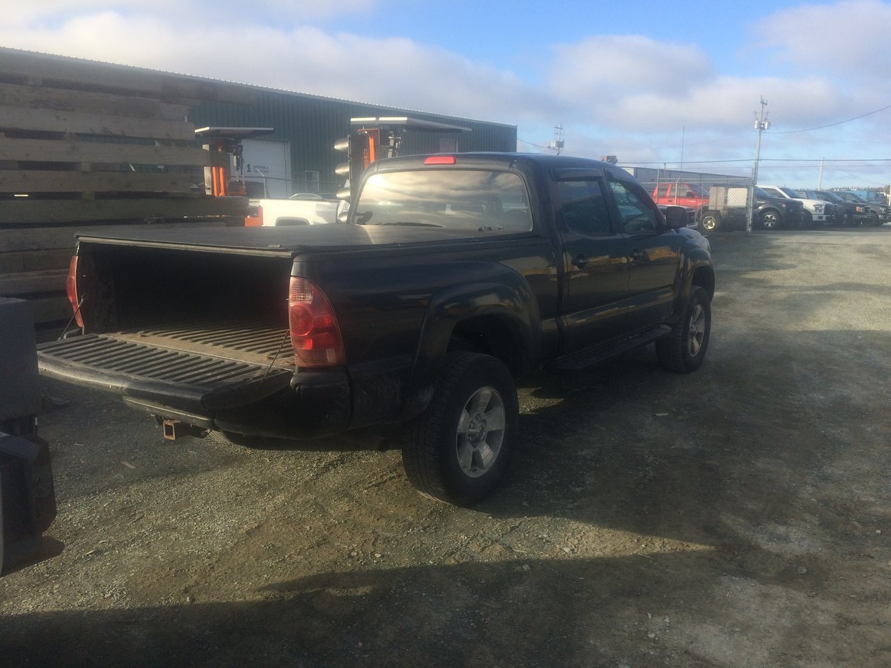

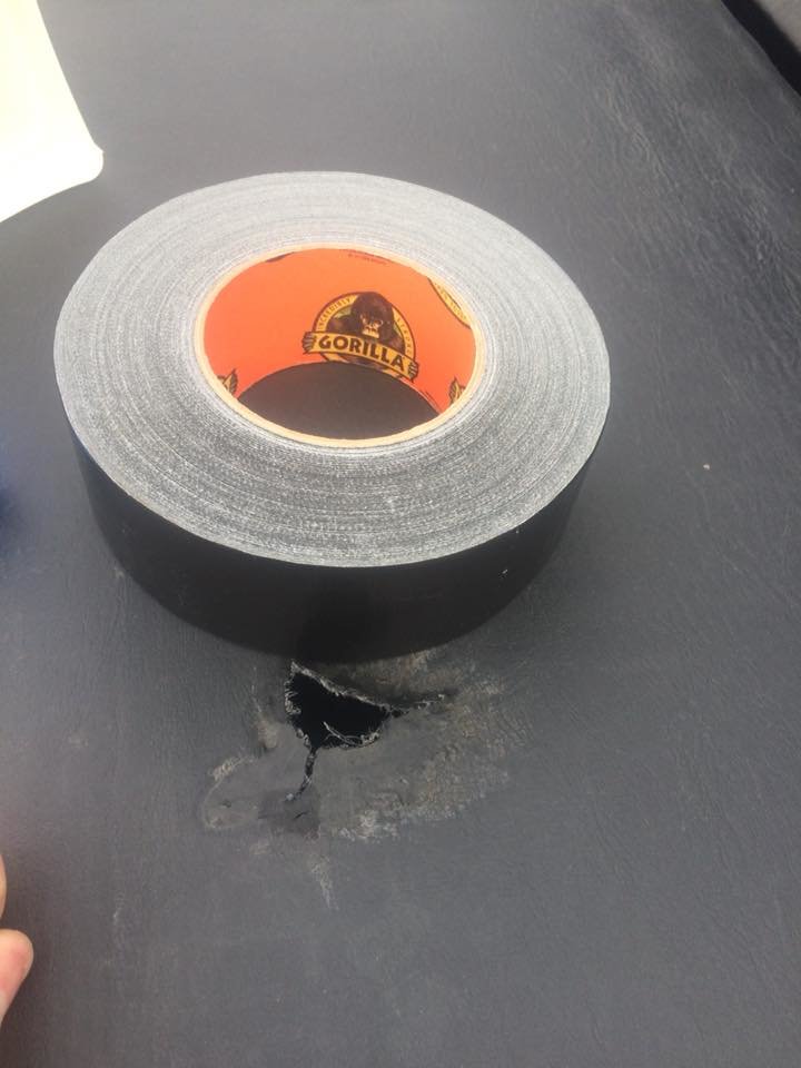

    Hate the cover on the bed of the truck, it will be removed once i put my sled or dirt bike in the back but until then Black monkey tape
    She anit preduy she just looks that way

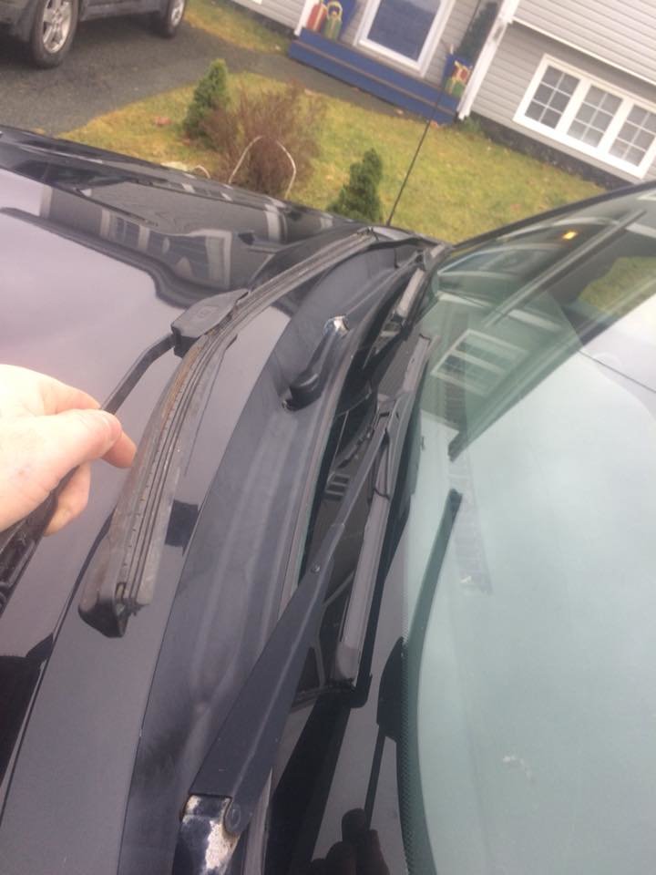

    New to me wipers that came from the $50 trip to the Upick all you can carry

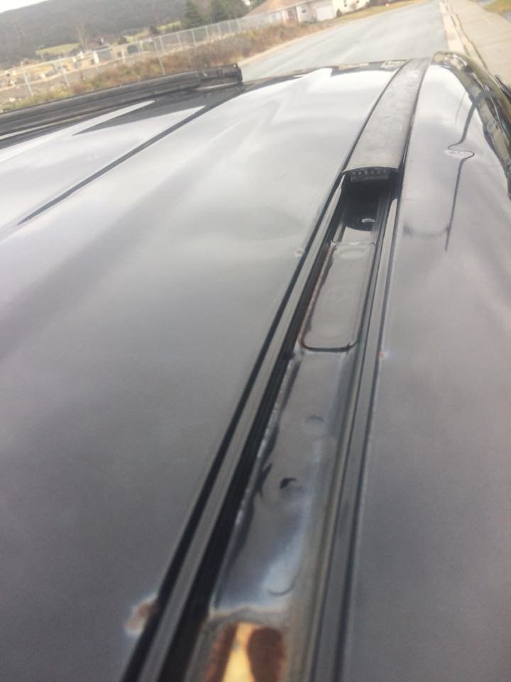

    Trim on the roof that was missing, got one off a acess cab at the upick cut the end off it, this will do untill i find a used one

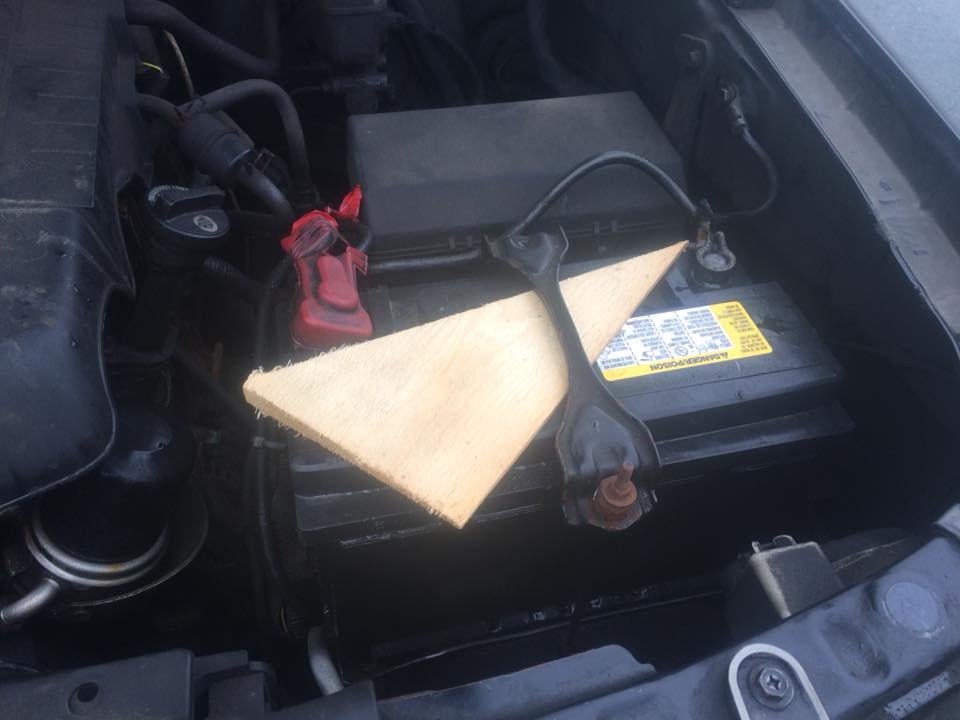

    The Previous owner installed a new battery and used a piece of wood siding as a shim ..... while i was rust checking EVERYTHING i took it out and made a proper rubber shim out of something i found in the garage. ( No Picture)

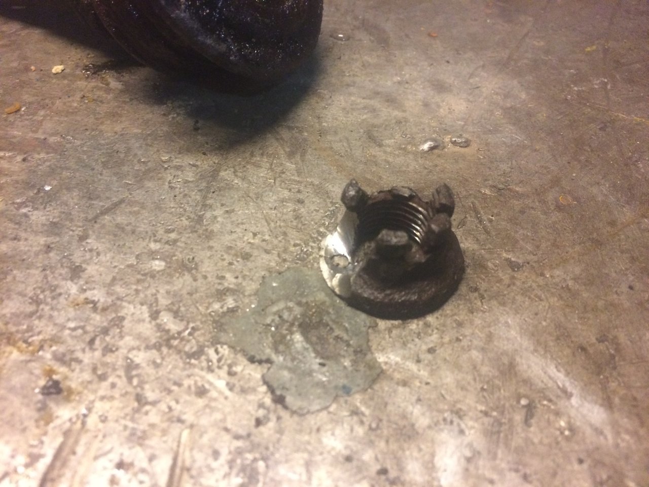

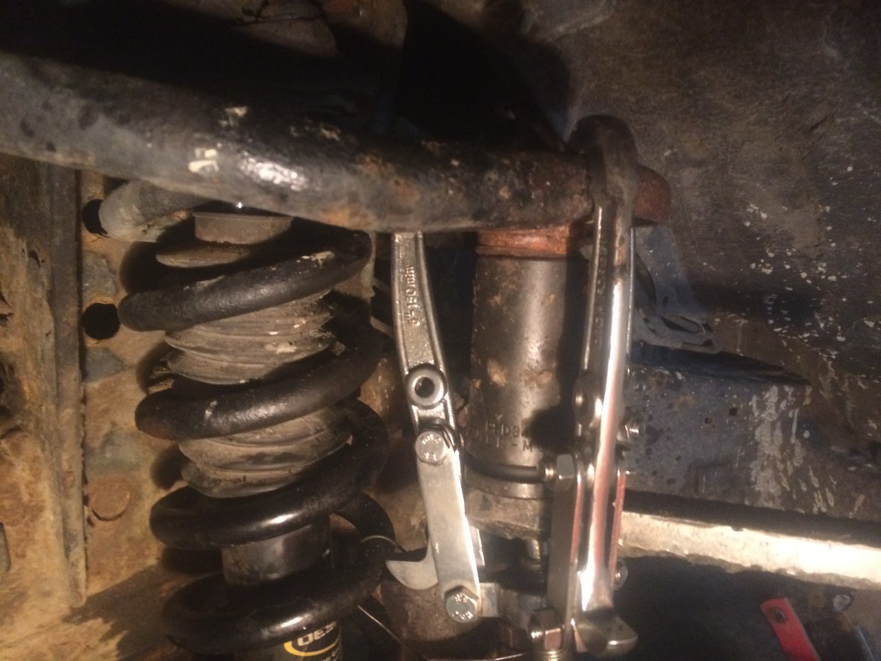

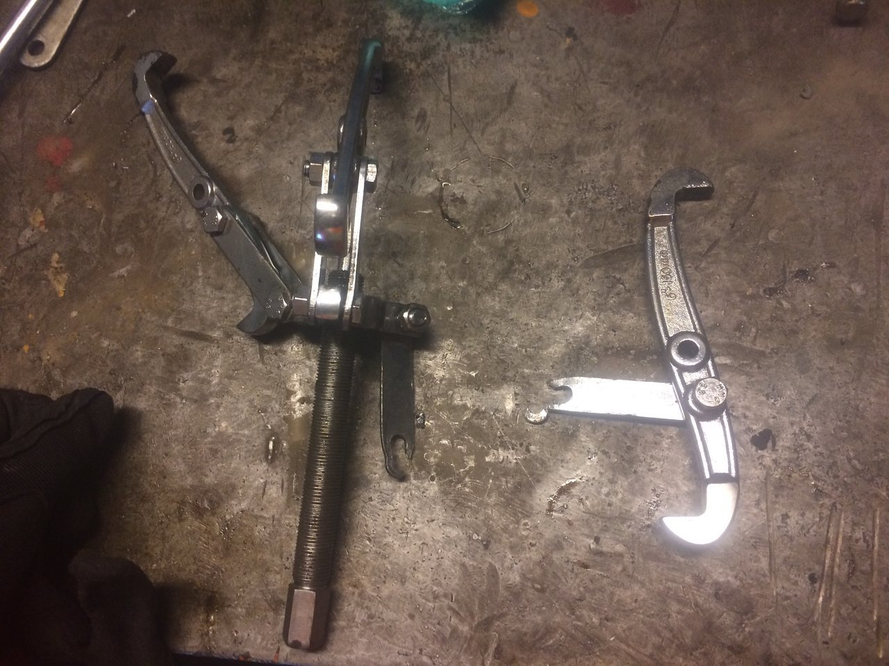

    Ok back to ball joint fun ....... Sunday afternoon i went back to the garage and started to do the drivers side ball joint. I could not get the nut off the Joint as the wrench had it rounded out so i took the grinder to the side of the nut, then removed it. More headaches the method i used to remove the passenger side was not working for the drivers side due to more rust ? anyways i spent the whole afternoon turning my two 3 jaw pullers into two jaw pullers ...... F IMG_6284.jpg IMG_6285.jpg

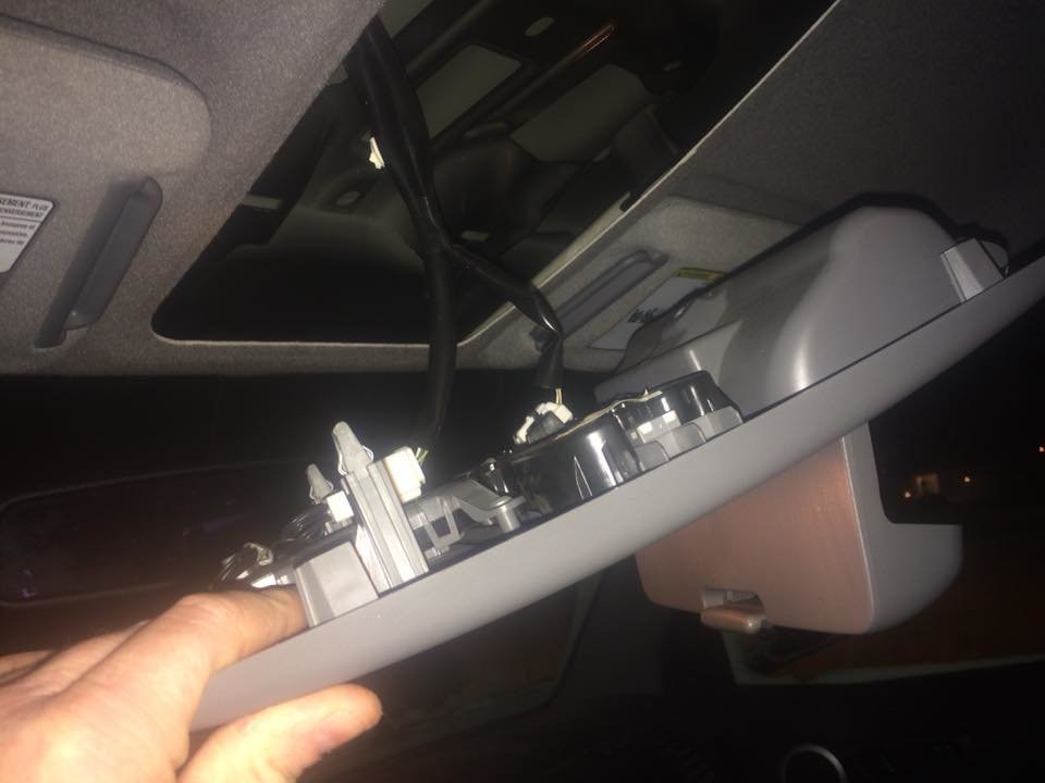

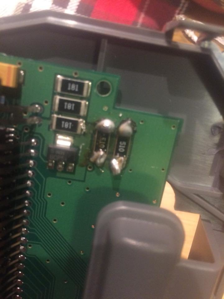

    Searched the interwebs for a fix for the overhead console
    Overhead compass / temp gauge not working check here easy fix !!! 25398797_10159519627550417_7680091354975490498_n.jpg 25353646_10159519629560417_6908689618551011495_n.jpg 25398887_10159519629975417_957384399611982810_n.jpg

    So few questions

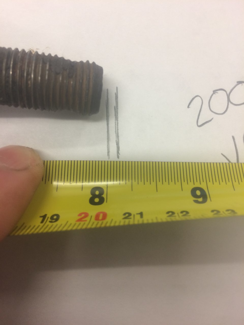

    1. What is the lug tread size and pitch ? I want to clean up the few grinder marks
    2. Can I change the temp measurements as I think it’s in f or broke as I only know C or I am broke and metric

    My plan is to do the map light mod while I have it down. Haven’t figured it out yet need to read up on it.

    Button under the display should toggle thru "off", "f*", "c*"

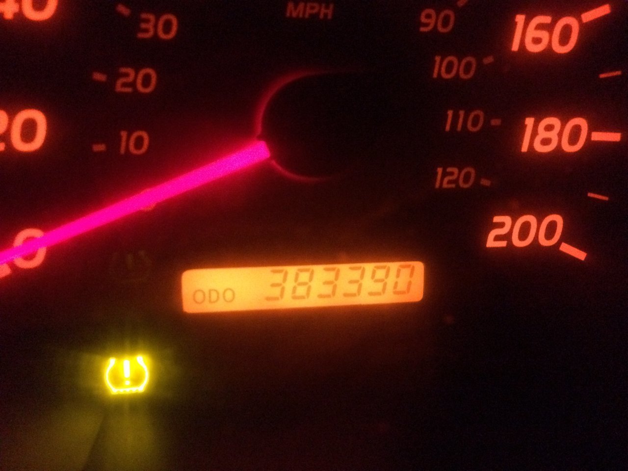

    Please tell me that's not right. That has to have an extra digit or something.

    Edit ..... Yikes

    Yikes, even without the extra digit it's still 238,227 miles, i'm not surprised at the ball joint if it's the original piece. That's quite a lot of distance that vehicle has traveled.

    Yes it does have high mileage, the previous owner owned a few business in different towns and visited them all once every week. That being said the body is in good shape, and Toyota putting a new frame under it, if the motor or trans gave up it would be worth it to change it.
