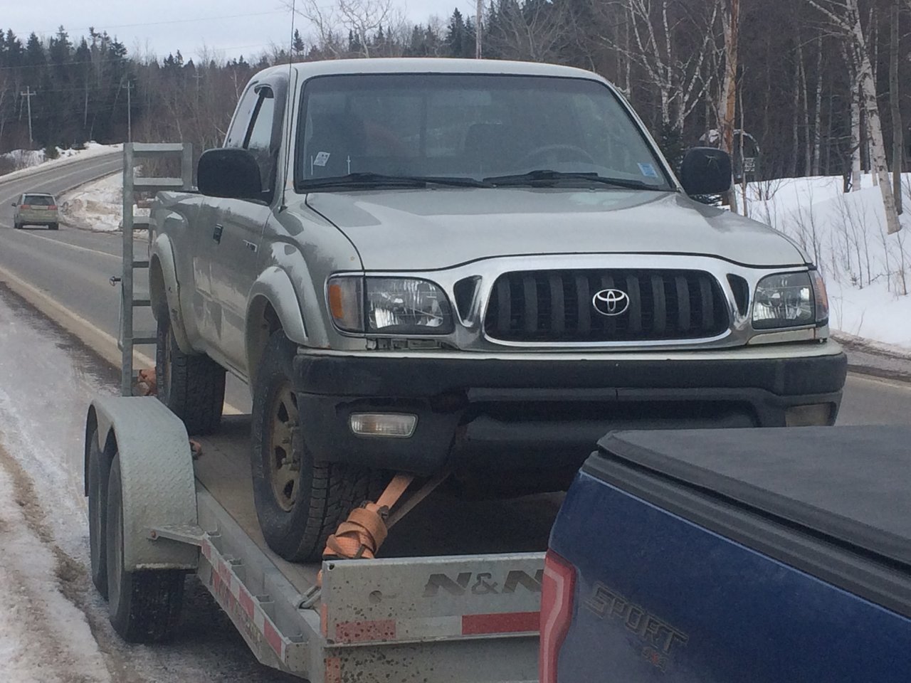

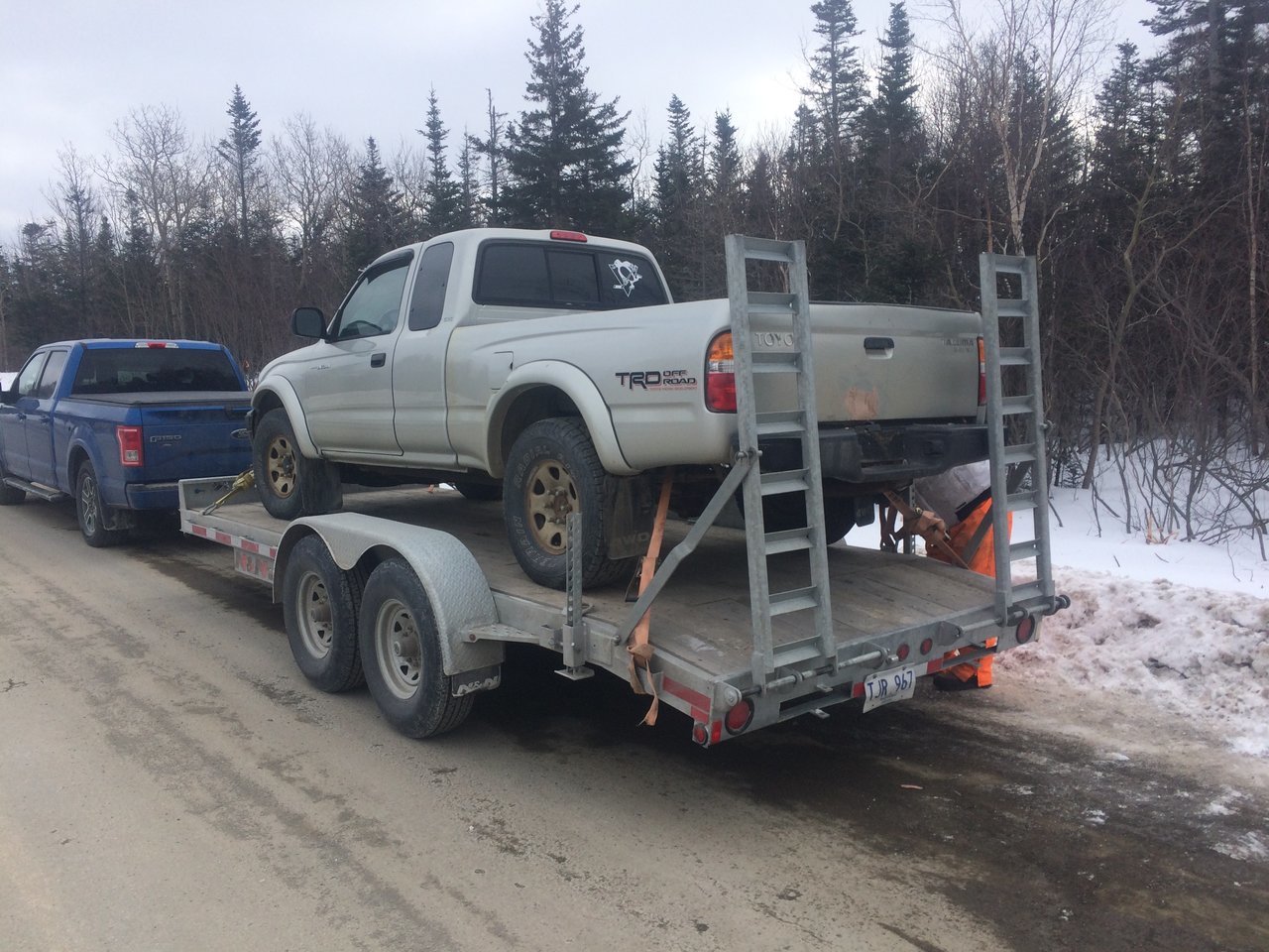

    I should also add in here that my plan is to keep my 2002 Tacoma as its in good shape to restore it to it previous glory. It had a new frame a few years ago under the recall. It needs some love but for me to do anything with it i would have to stop driving it in the winter as the salt around here kills everything. The box of the truck suffered some Major damage so i found a 2004 tacoma v6 trd that had a bad frame but the body is good, i am going to make one truck out of the two and use whats left over as my cabin truck with a flat deck.
    the 2004 parts tacoma story can be found here
    https://www.tacomaworld.com/threads/lets-find-that-lost-cylinder-5-out-of-6-aint-bad-right.475084/

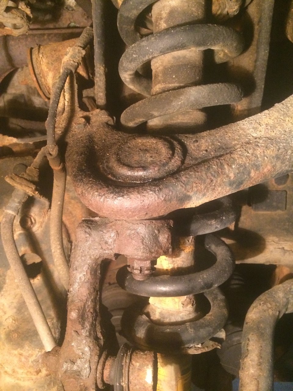

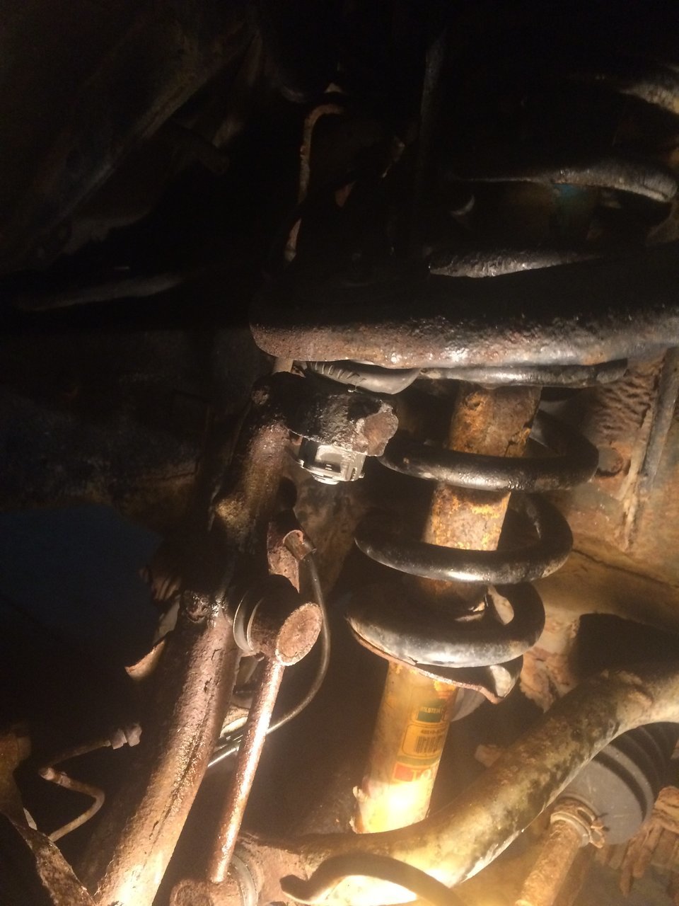

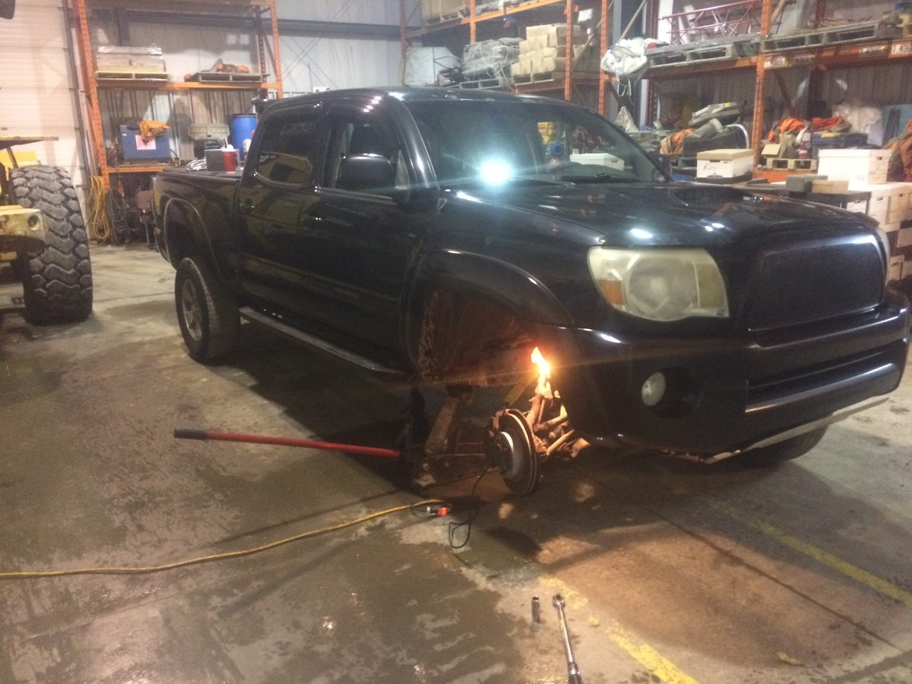

    This weekend i put the Family Taco in the garage at work to start knocking things off the list that is required by toyota to be done before they start the frame.
    First up is the passenger upper ball Joint, i used my 3 jaw puller to remove and install without any problems. IMG_6256.jpg IMG_6257.jpg IMG_6266.jpg IMG_6268.jpg
    And Done
    JUST a FYI i bought a master ball joint service kit from Princess Auto $199 ish CAD so thats like $900 US
    Not worth a F it is not suited for ball joints on imports

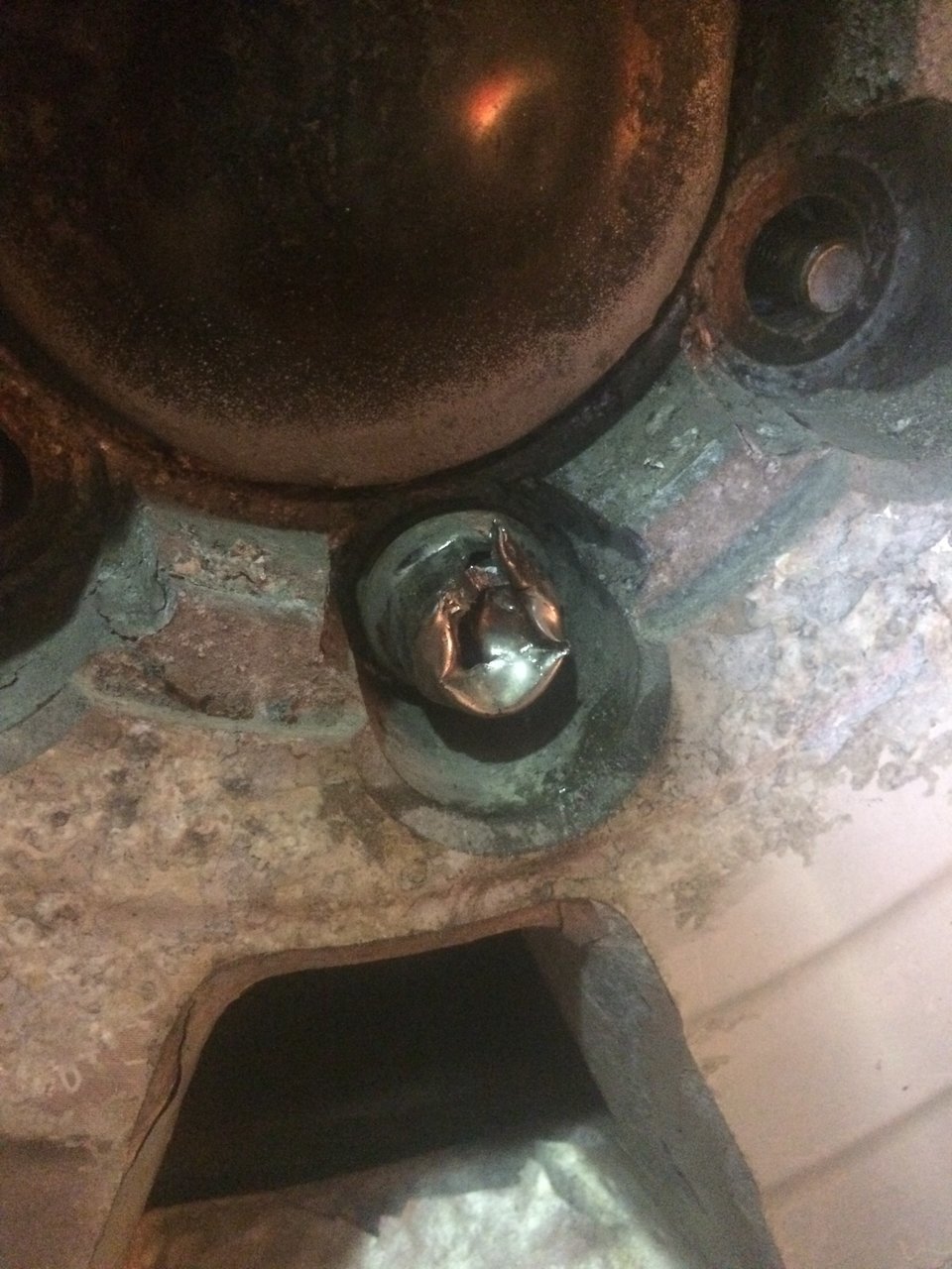

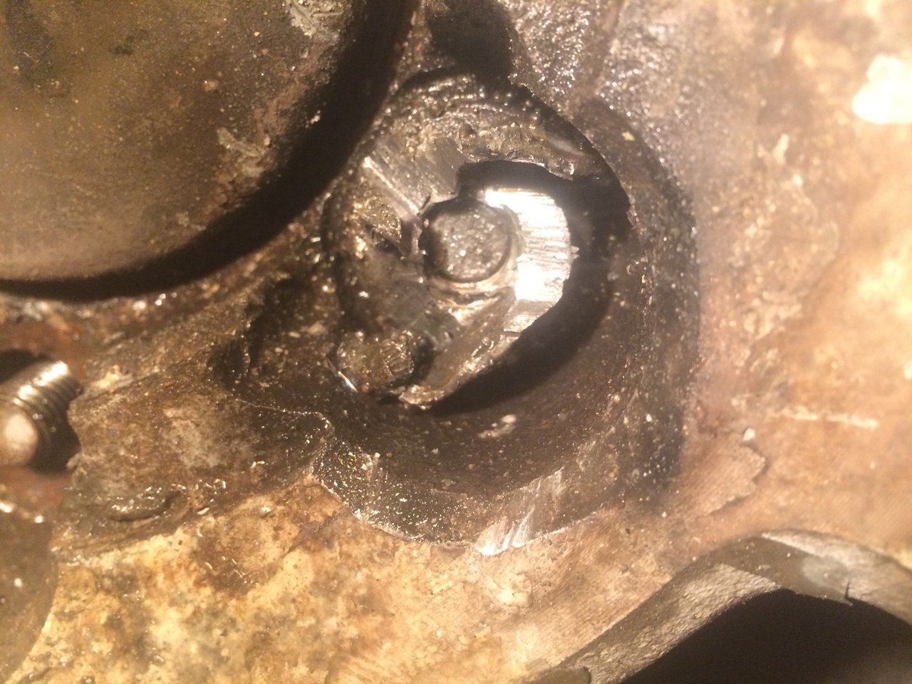

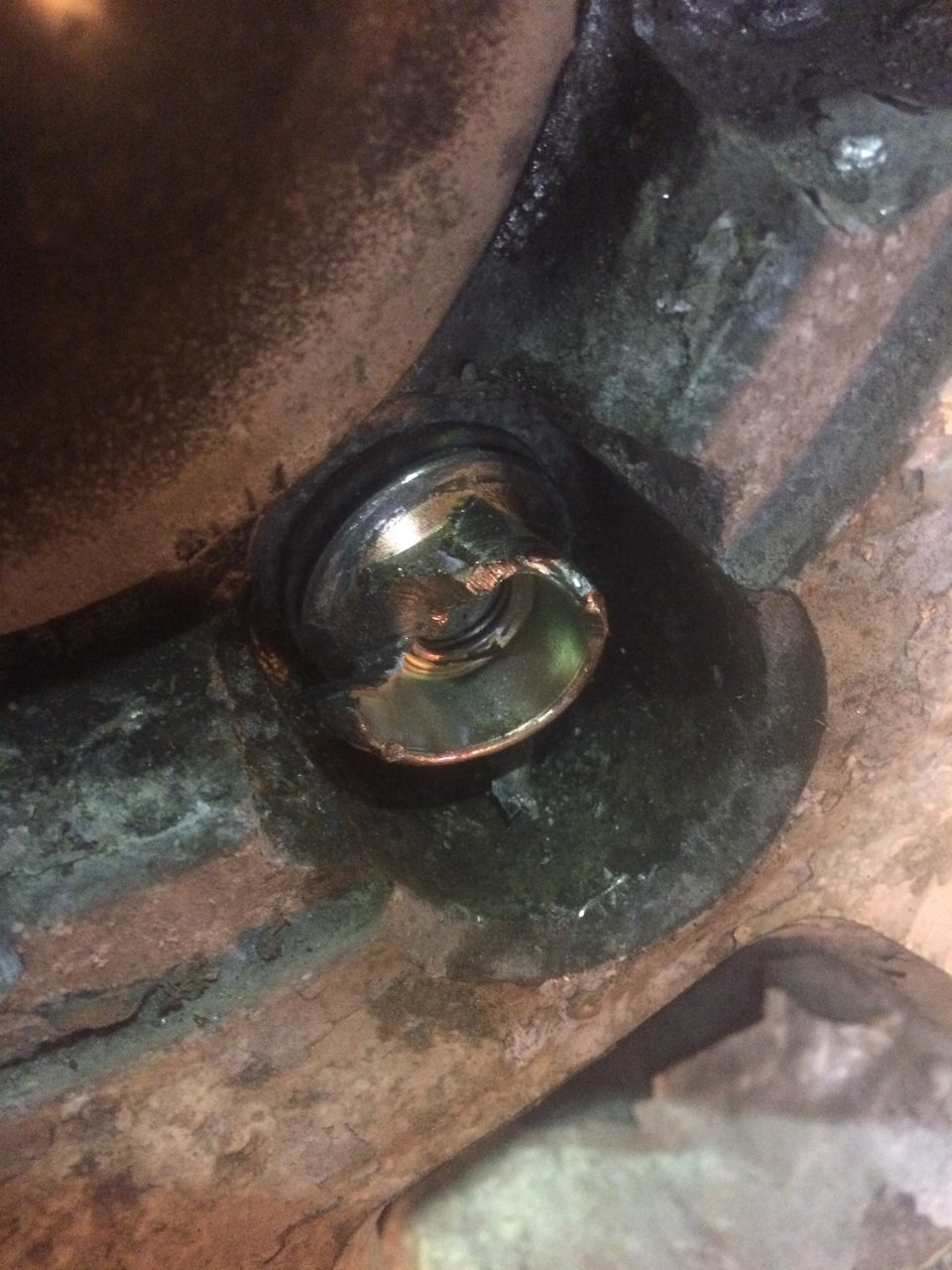

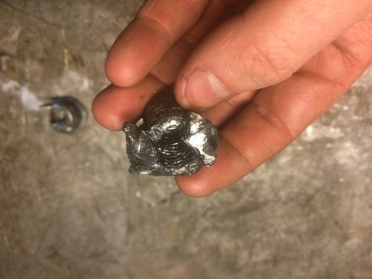

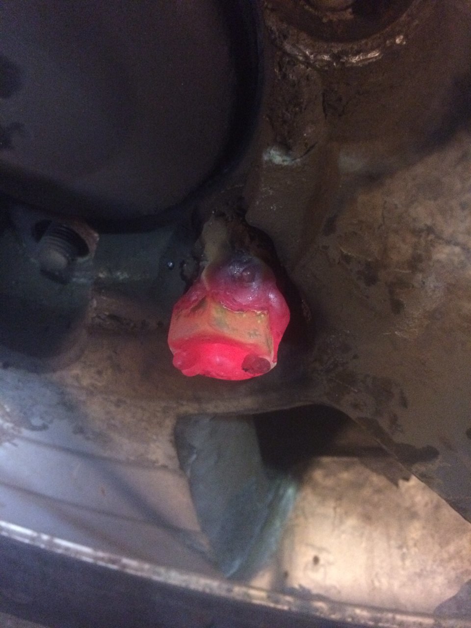

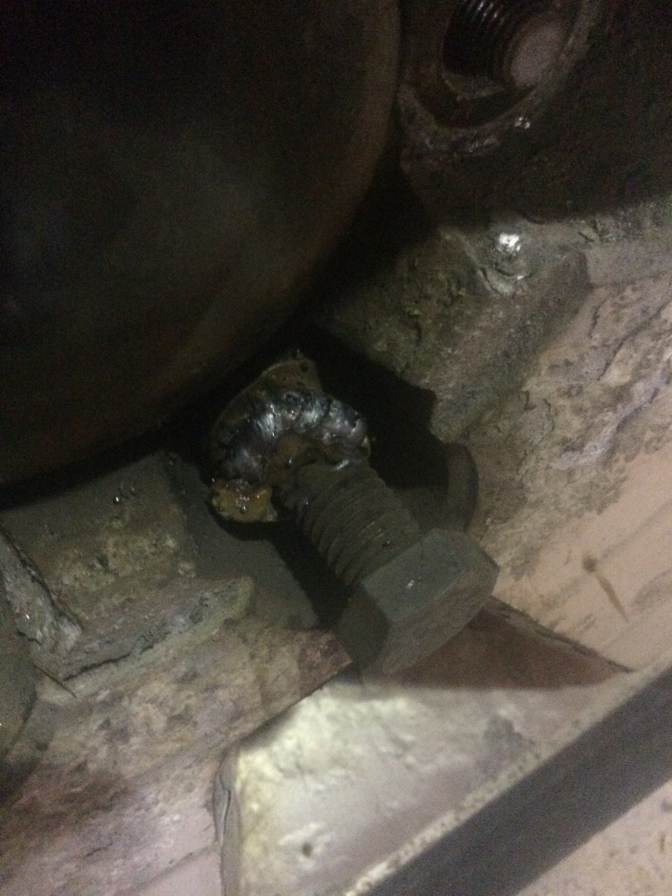

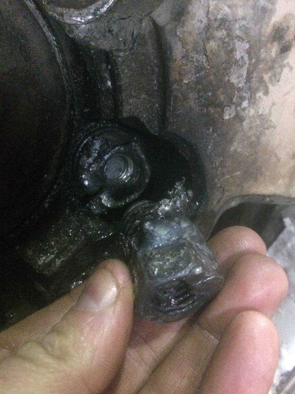

    Lots of time left Saturday evening so i started the drivers side. This is where it went down hill FAST, i got all the lug nuts off except one that the impact gun spun on. Tore the chrome cap up, hammered on smaller socket and tore it up more. Removed the chrome cap with a chisel to expose the steel lug with the side cut from the chisel. FFS ! Hammered, tried to back it off with chisel sockets swearing, looking at it real hard but nothing worked. IMG_6269.jpg IMG_6270.jpg IMG_6271.jpg
  14. Jan 8, 2018 at 8:25 AM
    Jon G
    Jon G [OP] Hoarding Tacomas one at a time,
    Jan 25, 2017
    #208594
    1,851
    Jon
    St John's Newfoundland Canada
    02, 04 & 07 Tacoma
    Magnaflow 2.5 Catback Exhaust K&N filter
    Out comes the glue gun, took a 3/4 bolt and hammered it into the open of the lug and welded it in, twisted off the bolt. Welded a nut on then quenched it with water, twisted it all off. Dont judge me for my welds :)
    so we are back to looking at the end of the stud.
  15. Jan 8, 2018 at 8:33 AM

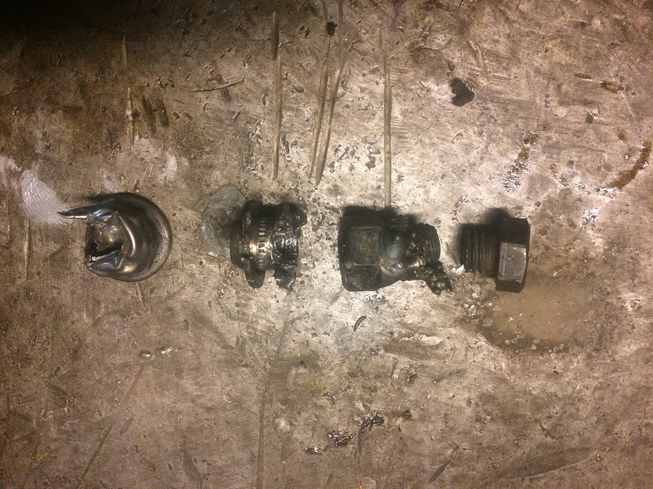

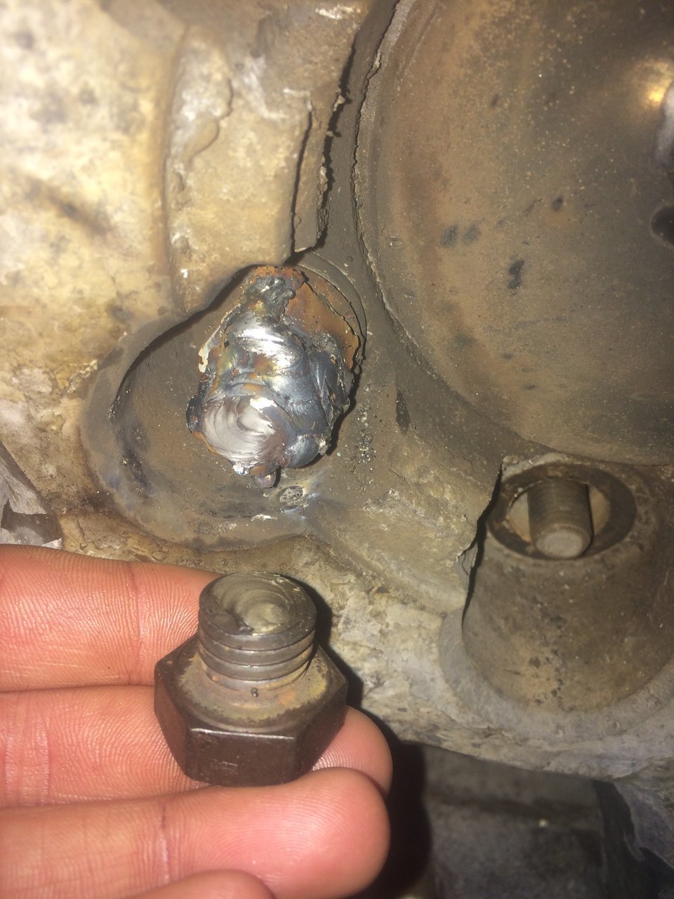

    Got it off. it put up a good fight !!!! I took a Pencil grinder and cut in to the remaining of the lug nut until I got close to the thread, stud. Then took a chisel in vice grips and a sledgehammer with the attitude of its f...Ed anyways might as well beat on it some more. It started to slowly move, penetrating oil and lots of backing it off by hammer and chisel
    Thinking about this after last night I am going to go back and put some anti lock on the shoulder of the lug nut that slides into the rim.
    The thing here is the difference between hub and lug centric rims. Toyota used lug nuts that have a shoulder on them that fit snug into the hole in the rim, making the rim out of aluminum and the lugs out of steel with a chrome cap allowed for the steel nut to rust swelling the chrome cap so it gets destroyed when trying to remove. Then the steel lug rusting in a aluminum rim made a bond. The shouldered nuts go into the rim and have a contact area of about 1/2’’ so the possibility for it to stick / swell with rust is more then with acorn nuts
    Say on my 02 tacoma and most other cars they have acorn shaped lug nuts that fit into dishes area on the rim where the surface area is only small less chance of sticking
