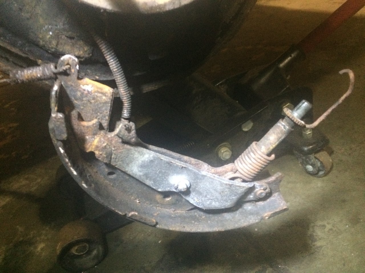

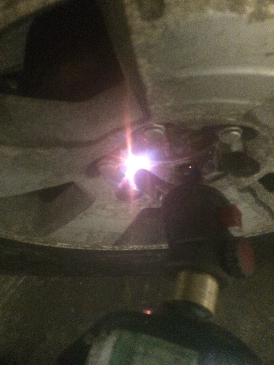

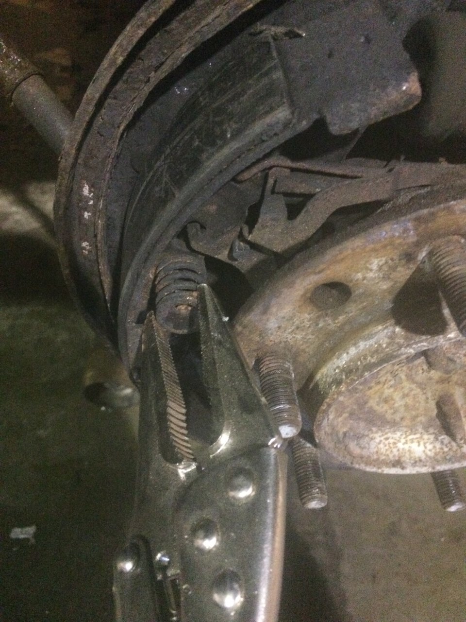

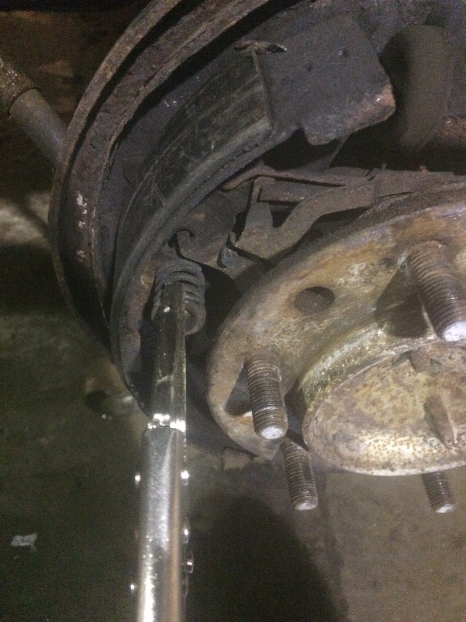

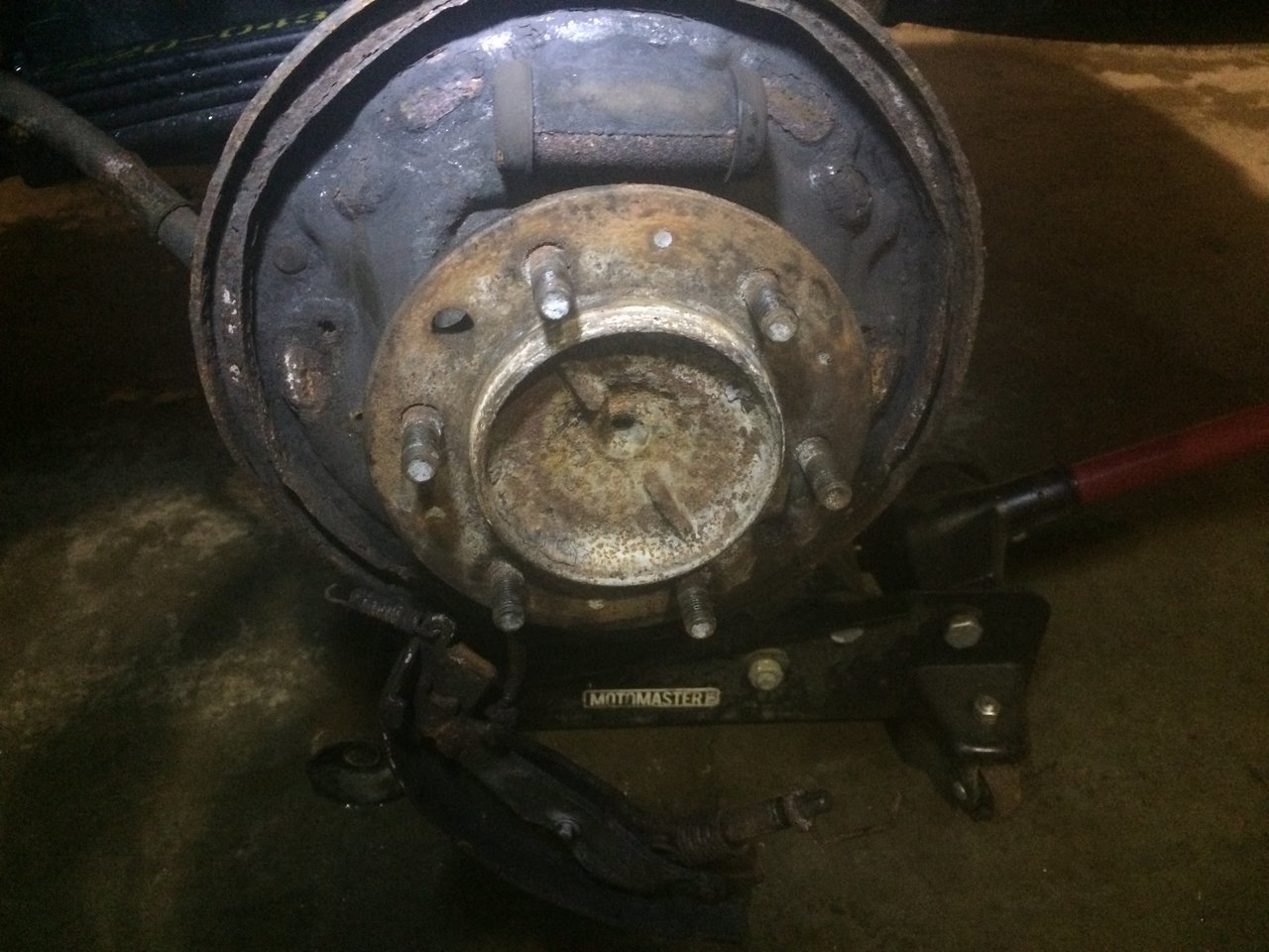

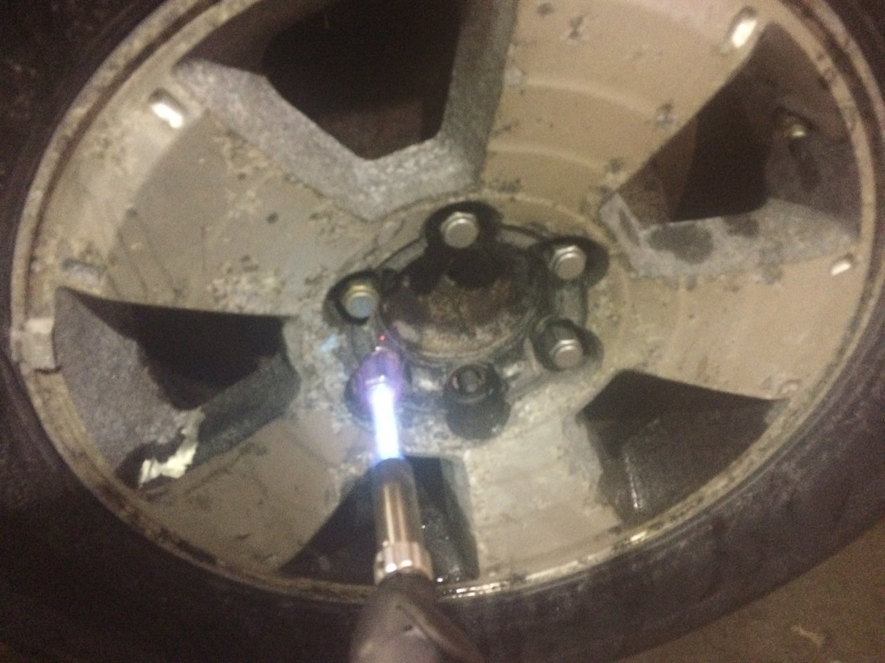

    Working on the 07 today rear brakes
    F f f f f f on those lug nuts had to heat the f out of every one and use a cheater bar to get them off. This is due to the rust on the shoulder of the nut. What a STUPID design Toyota. Drivers side brakes 100 pictures just for reference if anyone else need to k ow how it all goes back together, or me in two weeks
    I use needle nose vice grips for the hold down spring cups. Clamp them on press in slight twist and magic they are off. I do this with the news ones to put them back on. I was shocked that everyone does not do this
    And I am sorry for calling your design stupid Toyota

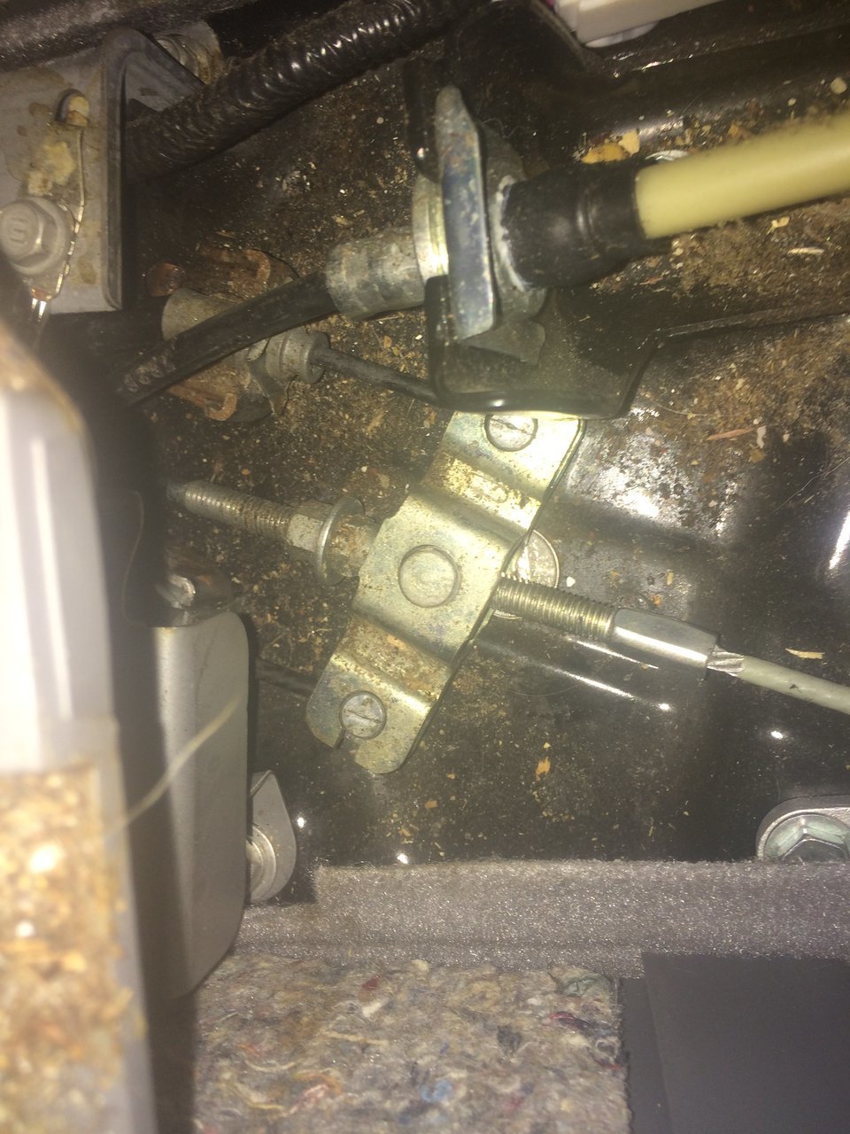

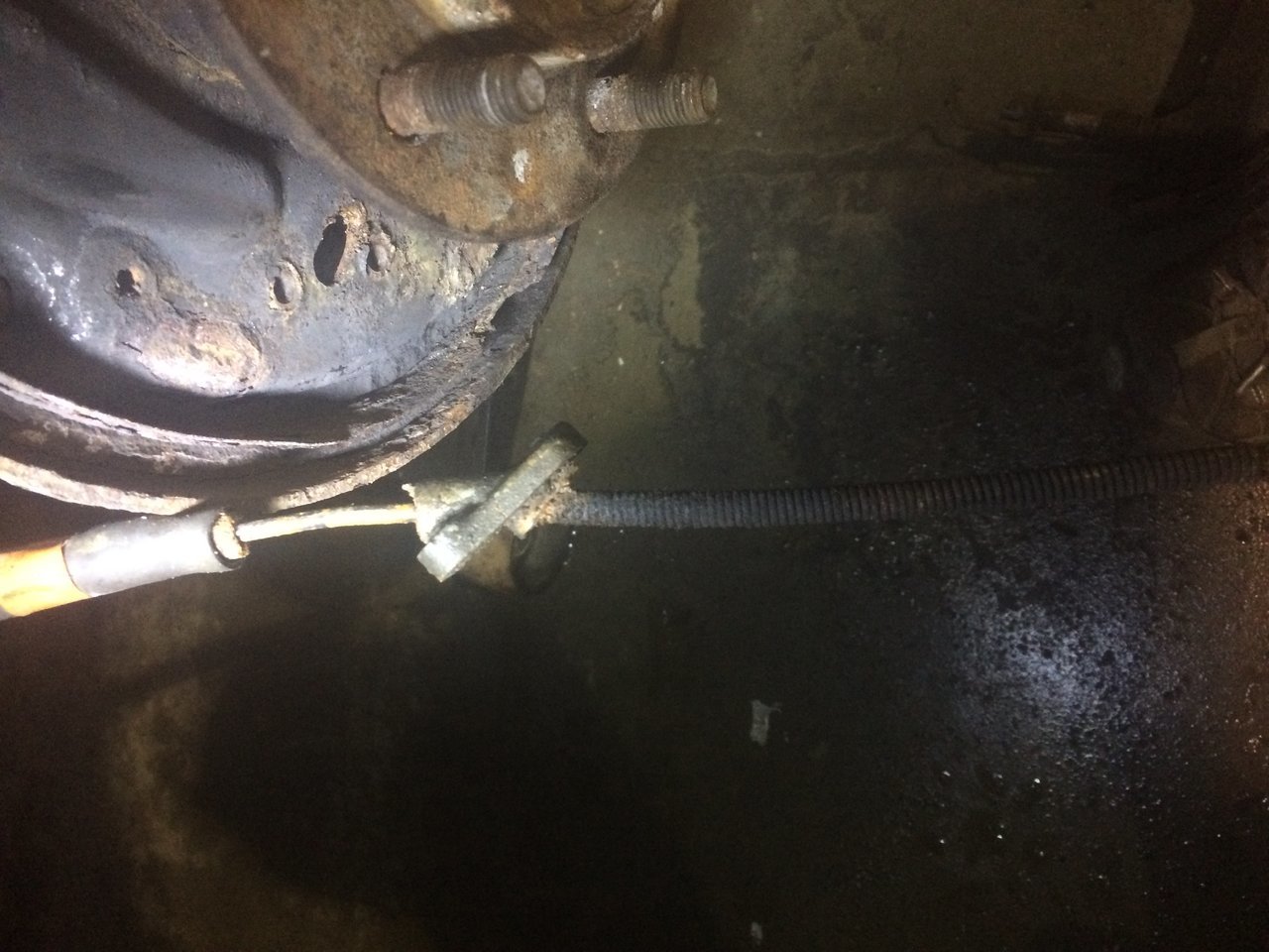

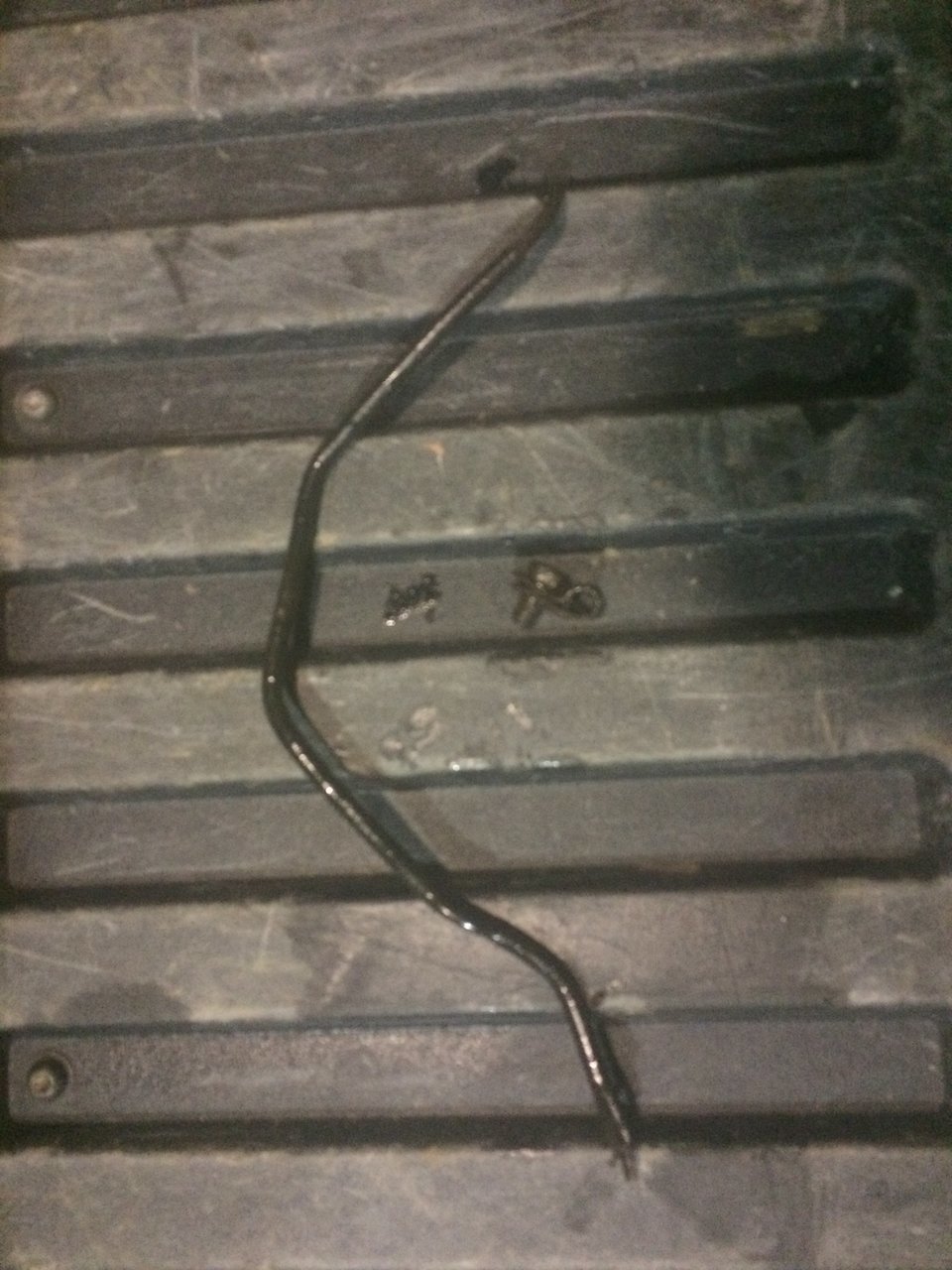

    The toy dealer said I needed a new hand brake cable as this one was seized and broken. I took the hand brake cable off the arm and pushed on the hand brake it moves but not that much. Must need a adjustment took the trim around the gear shifter off just pops out to show the adjuster. Took the cable out and poked it back through the floor of the cab and moved it freely. Further inspection down on the business end showed it was sized in the aluminum bracket on the backing plate and was snapped off. I did find $0.05 cad under the console worth $0.02 USA 6E933A85-8A50-4D04-9A79-51D2405A2FF8.jpg7CDE7A94-ADDD-4B30-861E-946449454313.jpg04D7CBA9-98E5-45C6-B05E-B15F981B9BCF.jpgBA9A4495-3CE7-4858-9FA2-BC2D04DCB652.jpg
    llamasmurf, Jorgy1, Tacotj and 2 others like this.

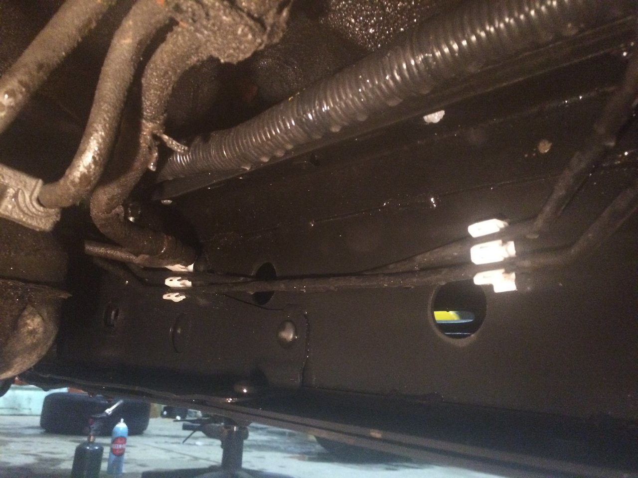

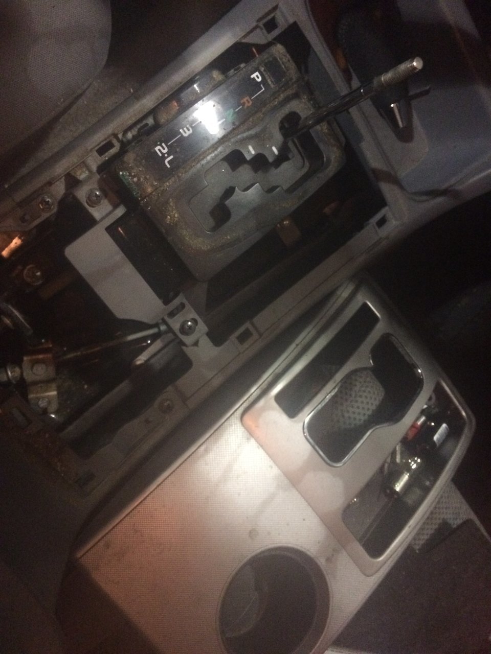

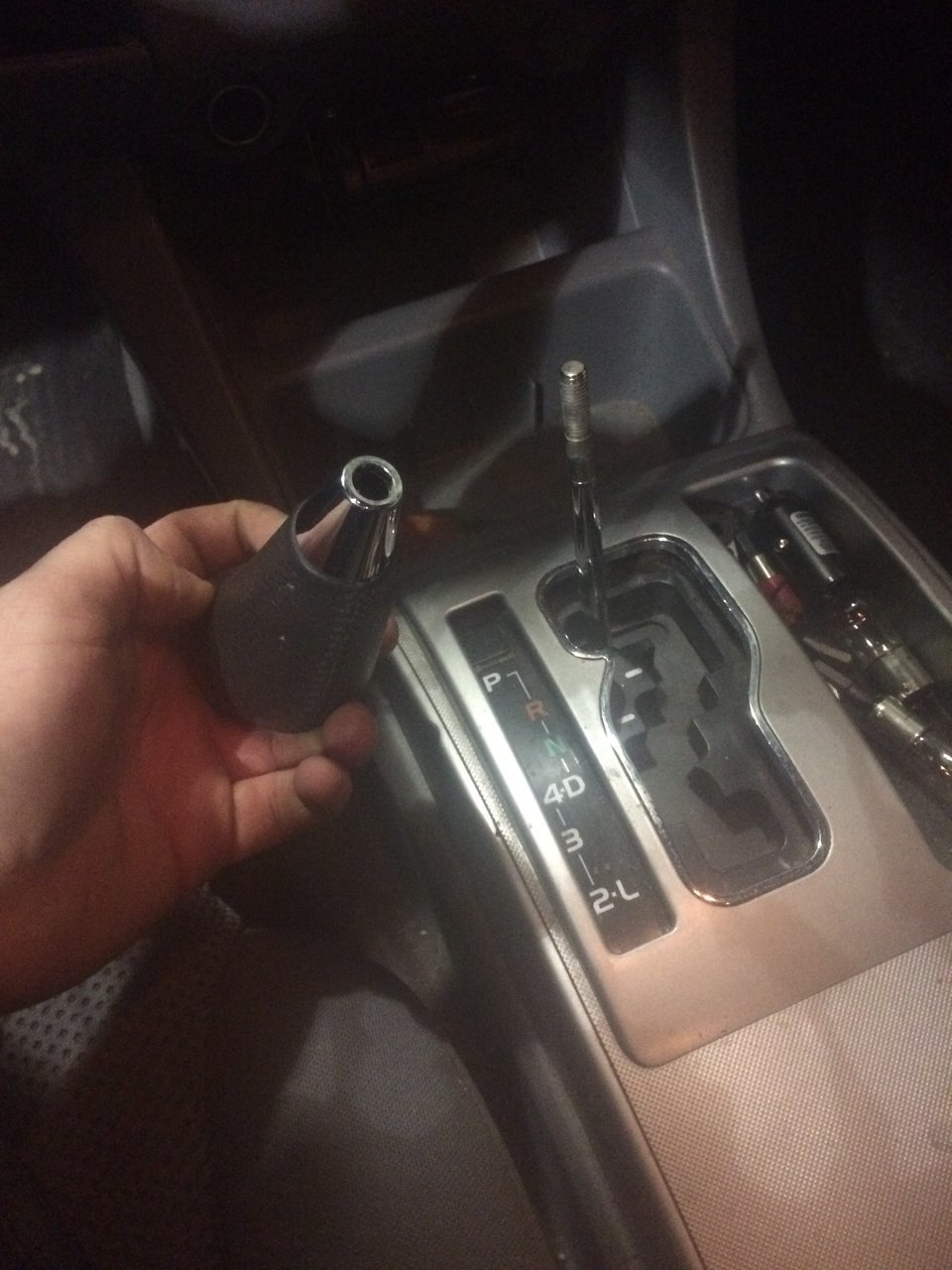

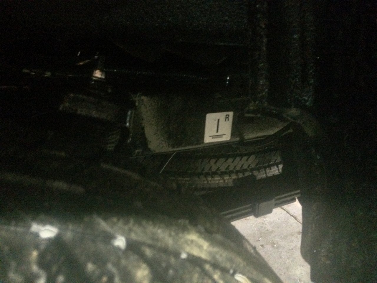

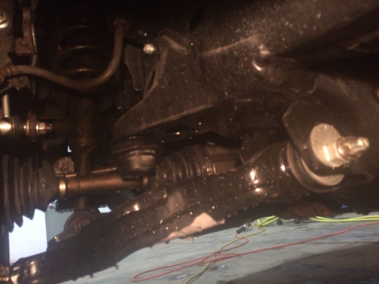

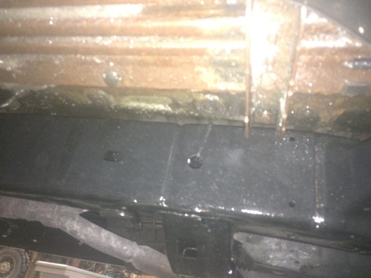

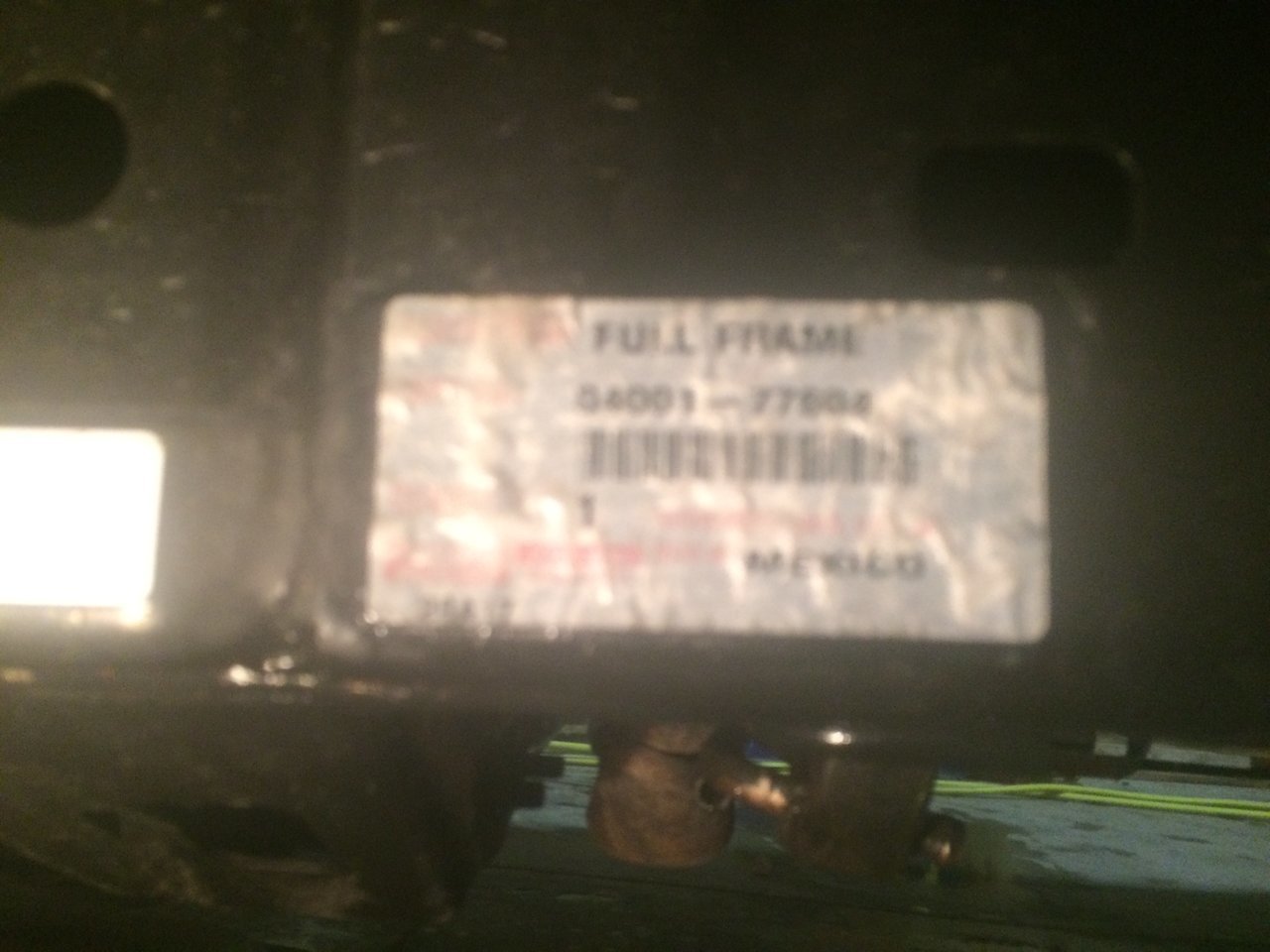

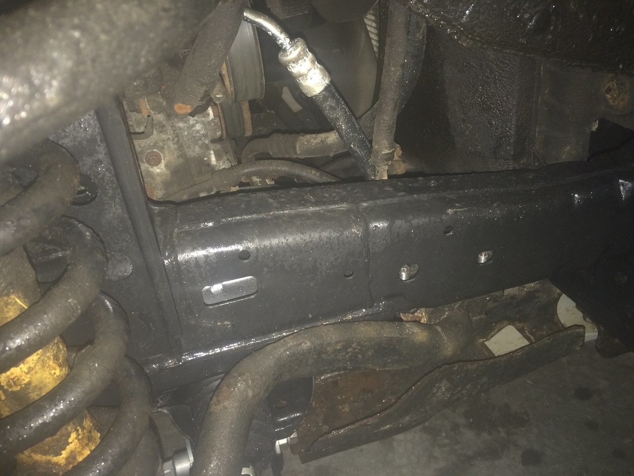

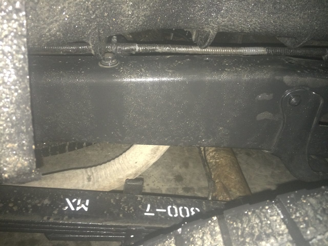

    It’s 5:40am Sunday morning just Finishing cleaning up from the last $hit storm that rolled in. Cry poop and eat.
    NEW FRAME PICTURES
    268A6AE0-6F37-4A55-AFE1-EB27A16D9836.jpg F2F3EA77-5A27-4C5E-A47E-57BC62583793.jpg B180FC49-2422-4542-B53F-8B7F80EE0B88.jpg 0AFB4FC6-92EF-42B3-BCFB-AD141A74BA9D.jpg

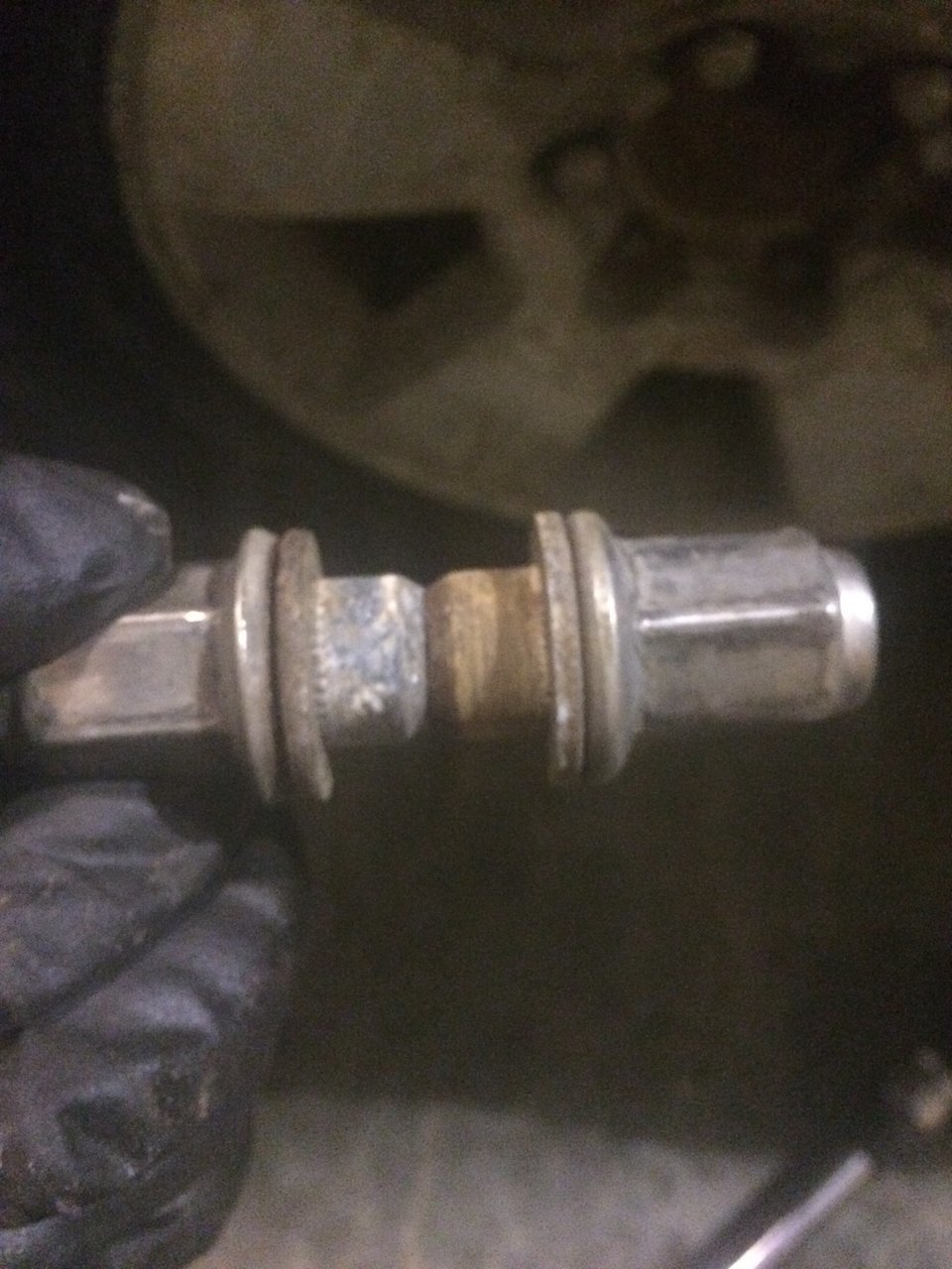

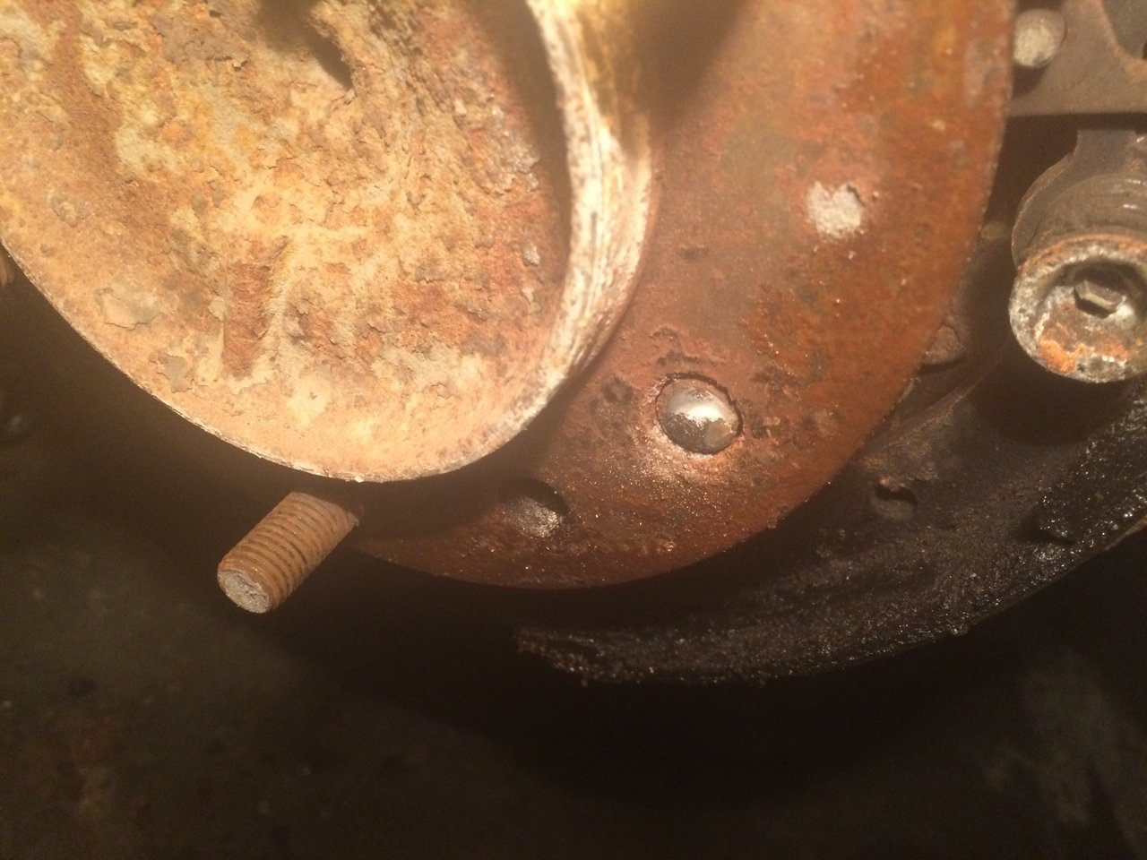

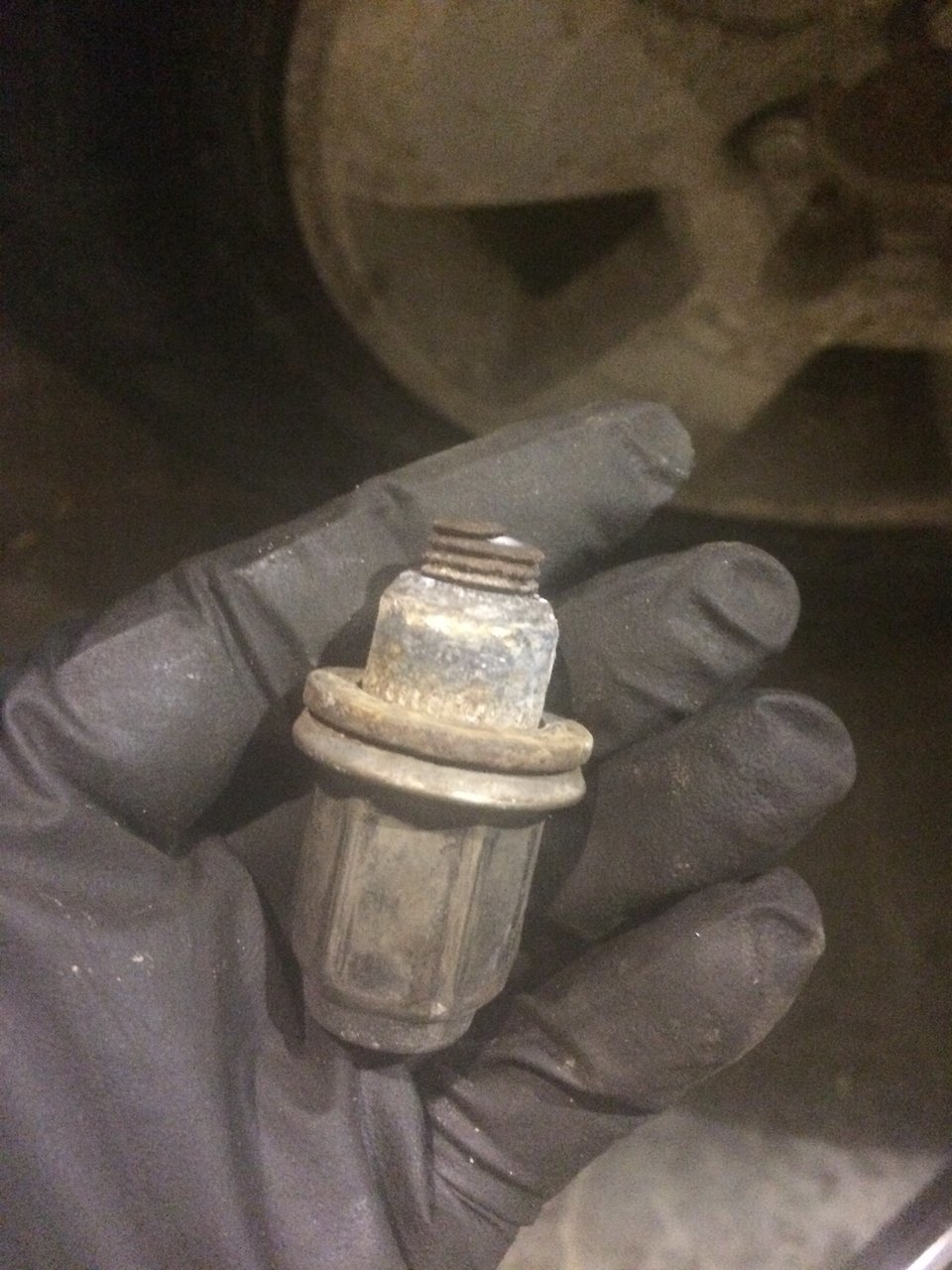

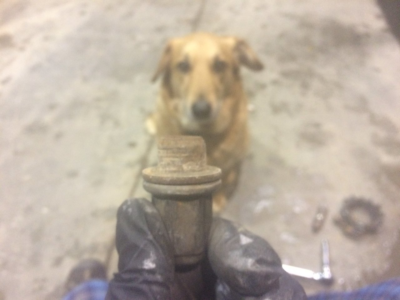

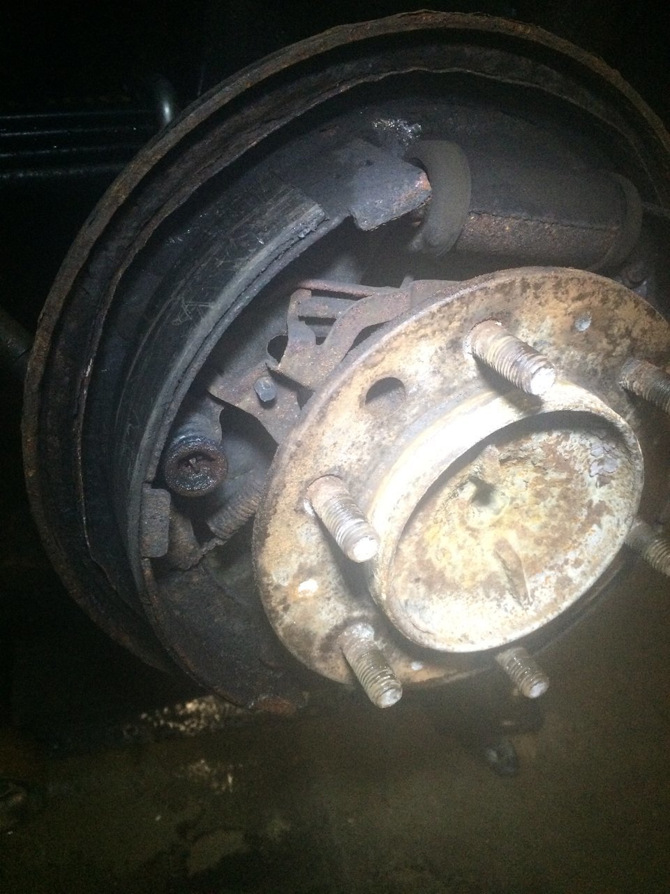

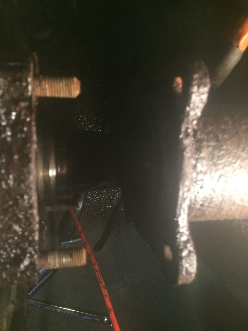

    Passager side was no different heat heat and heat cheater bar and snap of studs..
    Question what is the stud size for the front and rear. ??? Is this a Toyota only item ? C1E97419-92BA-451D-8EC6-FE8ED3DD02EE.jpg3B1E099E-39AB-4335-A277-49F890E66E4E.jpg9FF1CEE9-2409-4CE2-A8DF-250E8092F674.jpgC3A9503B-B5F8-46A2-9B5E-8797ECC23777.jpg

    God damn that does not look like fun hahaha

    It gets worse

    Honestly, at this point I don't doubt it :rofl: I'm surprised the wheel bearings still turn

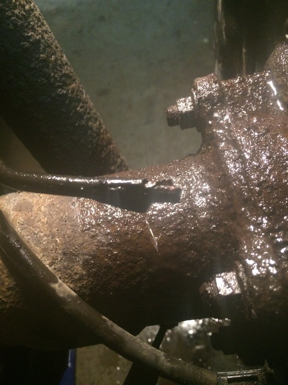

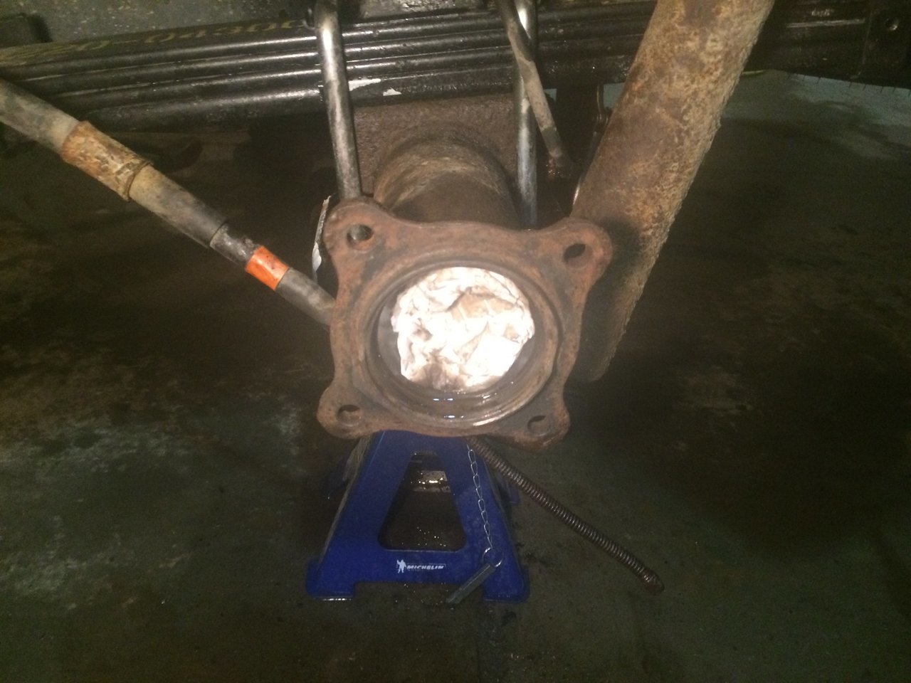

    In preparation for a real MVI (not like the one Toyota did) and for piece of mind I need to address a list of items that include.
    Abs light
    Hand brake light
    Quality of brakes

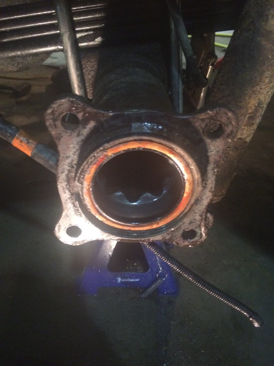

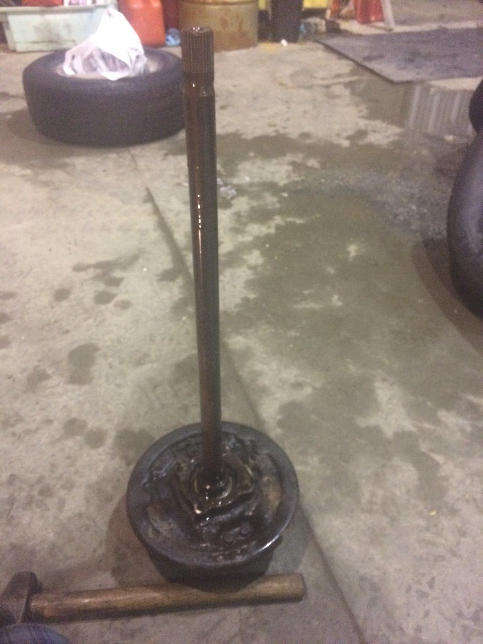

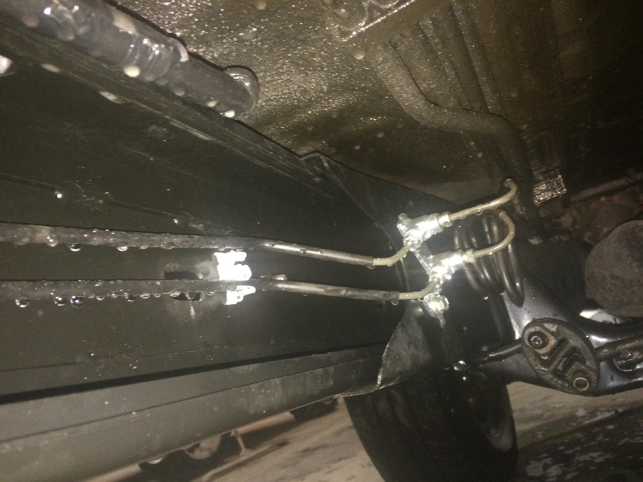

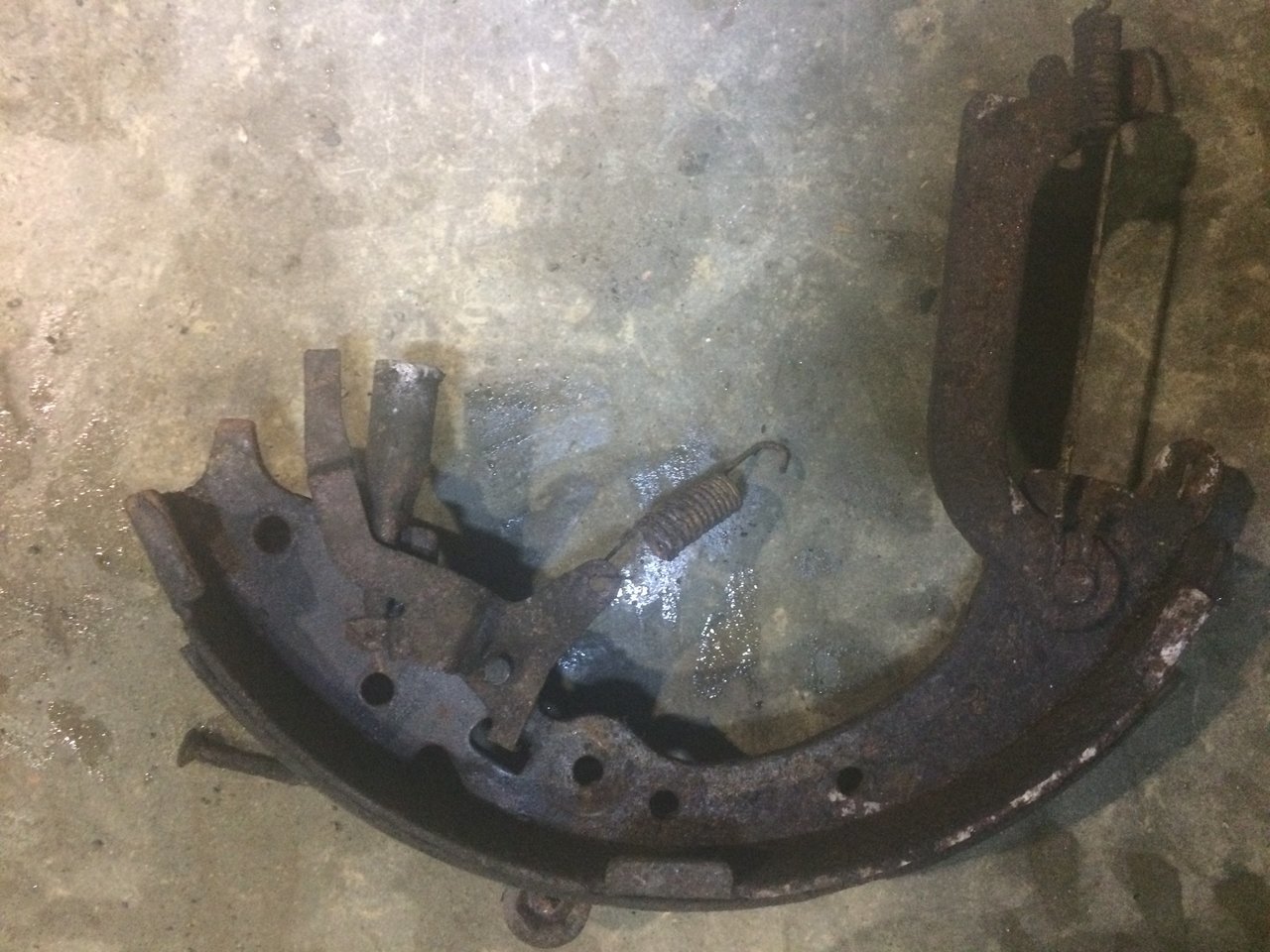

    I decided that I was going to go through the brakes to make sure they were working properly. As you have seen the wheels probably have not been off this truck for a long time. I have bought all new rear brakes shoes, drums, hardware kit, wheel cylinders, and side axel seals.
    If you looked at the pictures you have seen that the brakes were a mess.
    Off with the shoes, the hand brake hold down to the backing plate was broken. This was one of the major things wrong with the hand brake. This was a part I did not purchase.
    I took the leap while I had the brakes shoes off and decided to removed the side axel as I knew one was leaking so I want to replace the two of them
    To do this I needed to remove the hard line from the wheel cylinder and disconnect the abs sensor.

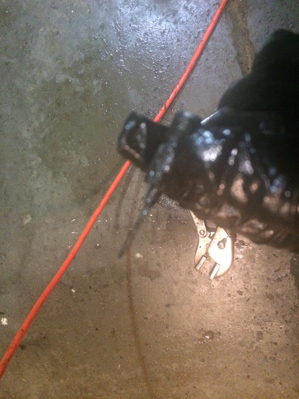

    The old hard brake lines were original and ran along the axel to the flex line these were not replaced during the frame rebuild.
    I heated up the line nut and got it free but it was not turning on the line so I Made short work of twisting the line off. Ok no problem took the line nut with about two inches of line and squat the line to put in the flex line so it would stop dripping. First picture
    Freed up the line nut (opposite end) and it would not come out of the flex line. Ffs
    So out come the vice grips

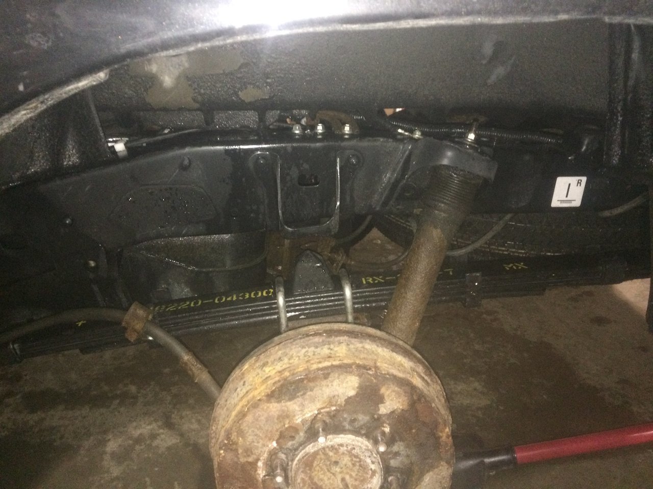

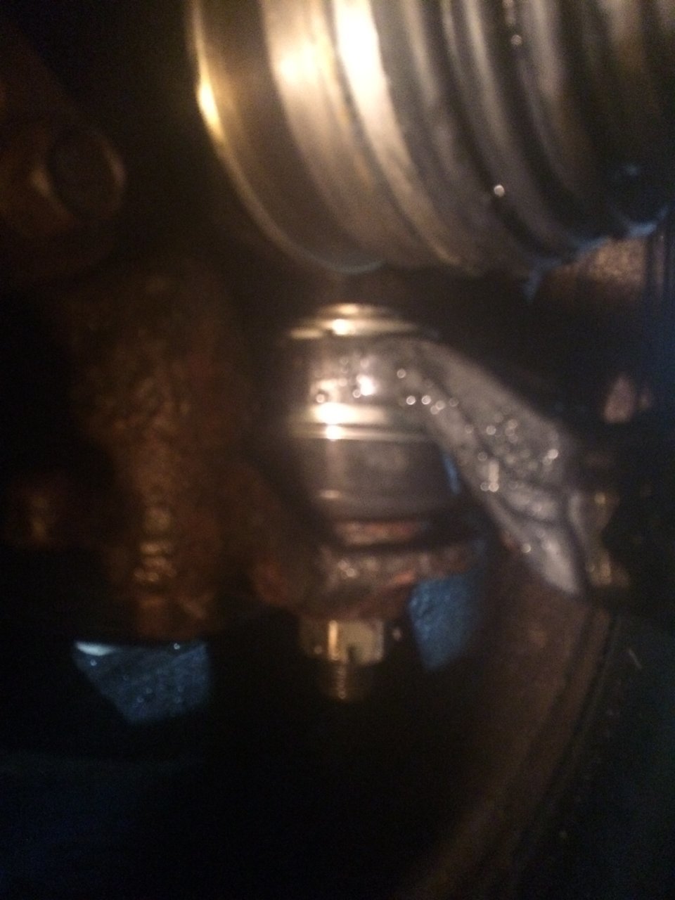

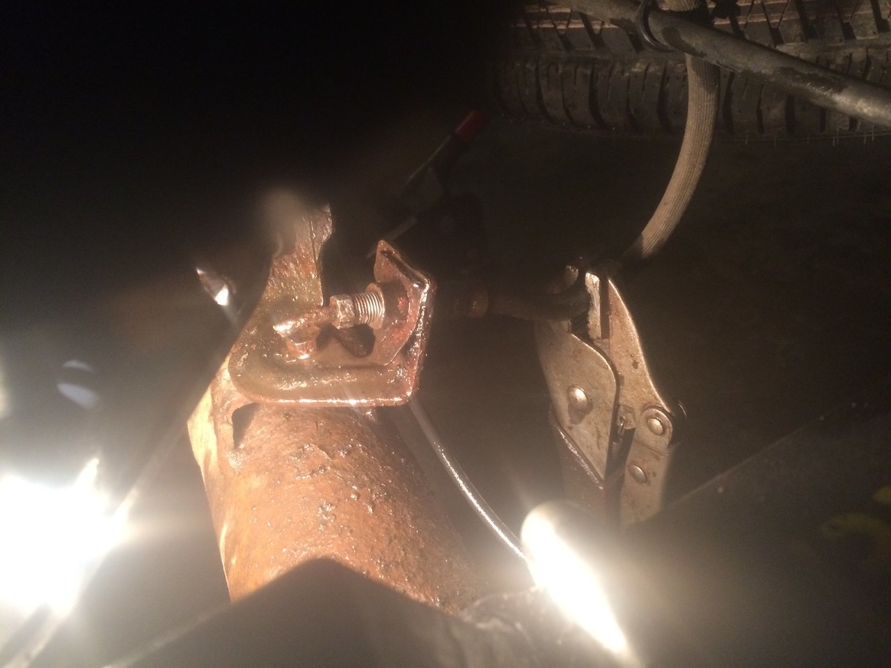

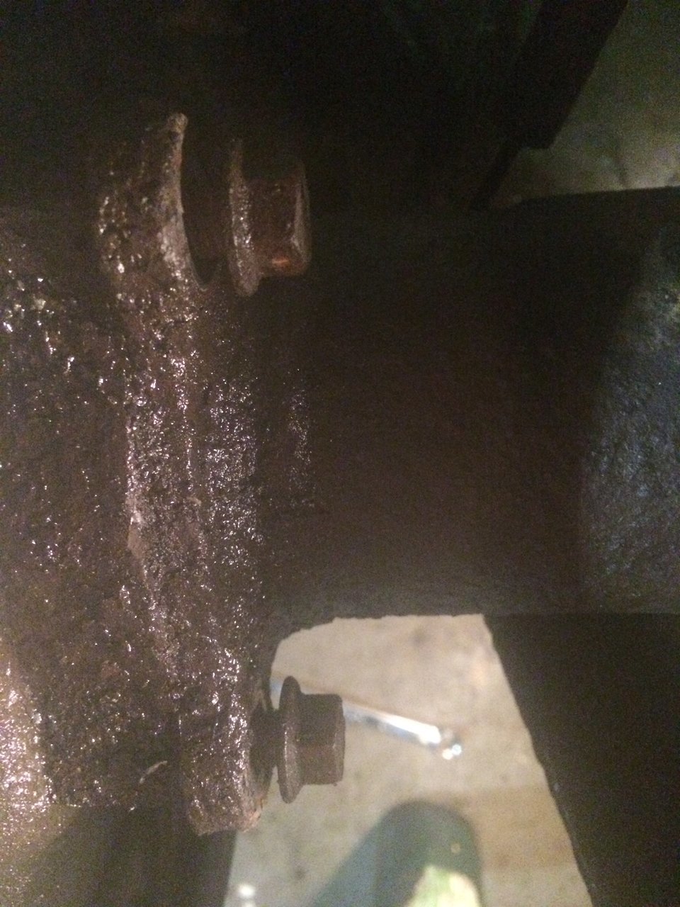

    So with works vice grips clamping the line for the next little while I moved on to the 4 nuts that hold the side axel in
    Heat heat and cheater bar they came off. Was not realy sure wat to do next as all the research I did said it will just slide out. Nop big clump of fing rust
    Hammer and cole chisel driven between the axel housing flange and the abs holder
    B2E5D887-C51C-476C-B8F4-C1DB0E149430.jpg 77614A99-ECEC-456F-88DE-D0A316731C40.jpg 6CE42A40-3D6C-4369-BDE5-3E68328E1D3B.jpg B35444D7-DFD9-4E7F-8D08-E11F6AF5987E.jpg FF0D67AF-80D4-4685-A8B1-499D3E060073.jpg
    Note see the size of my hammer :)
