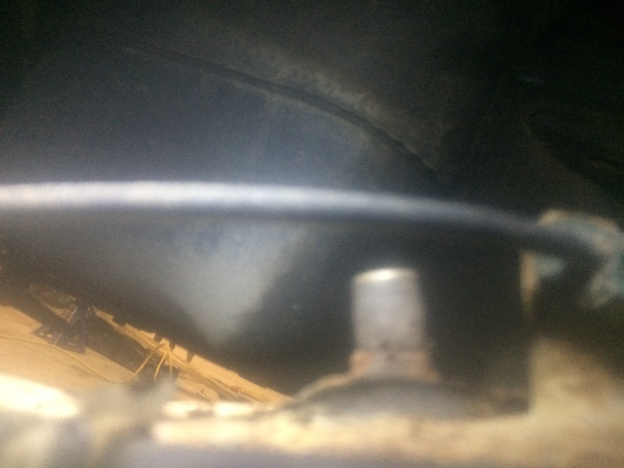

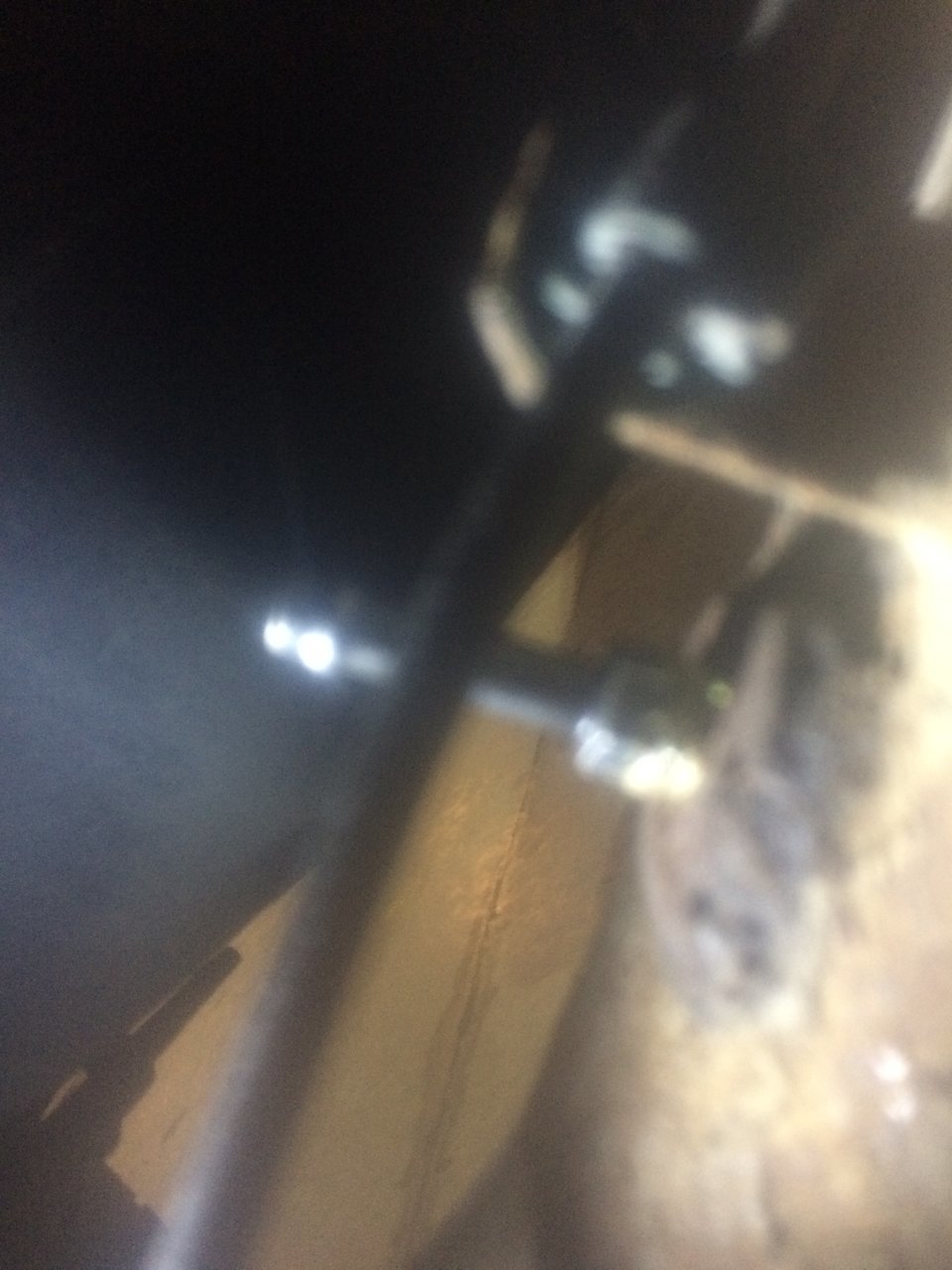

    SOoooooo i am one of the co founders of our local Toyota group you can find us on FB under "NL yota Trucks" if your interested have a look
    I write HOW TO's on things i have done to try and help out others and build our community
    REAR DIFF MOD That you need to DO Trust ME !!!!
    This is EASY yes you can do it with zero mechanical ability !
    Your saying ah i only use my truck off road a few times i don't need this YOUR 100% WRONG
    This applies to almost every 4x4 TOYOTA has ever made
    I have done this on my 1st gen tacoma and 2nd gen tacoma.

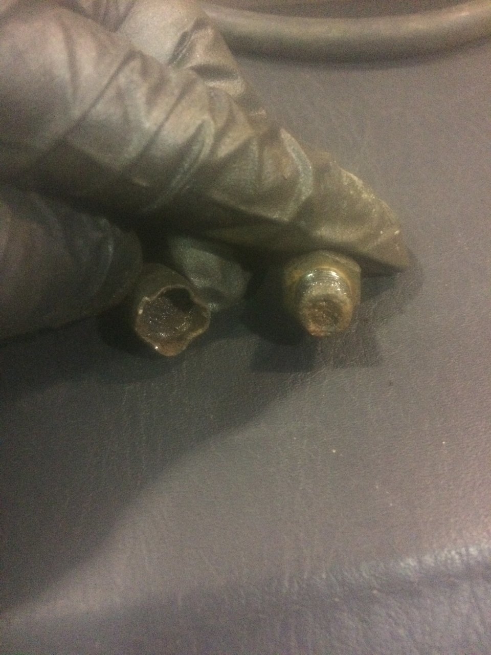

    This breather is like a metal check valve directly on top of the rear diff and is open to the elements. The spinning of the gears in the rear end builds up pressure and it blows off through this. The pressure pushes the ball in the check valve breather open allowing the air to escape then the spring pushes it back down closing it.
    This will rust and will fail, your rear diff will curate pressure in the housing as the breather is not breathing. This will blow out your side axle seal putting gear oil into your brake drum lubricating your brakes. If this happens there is no saving them once soaked with oil.
    This is the part # for the fitting for the 2nd gen Tacoma rear end. It replaces the clogged breather ontop of the diff and allows you to run a rubber hose up higher out of the elements.
    I like to use rubber fuel line that will run from this fitting up to a higher location usually behind the drivers side tail light. The location can vary but as long as it is out of the elements you will be fine. Once the rubber line routing is planned i zip tie it into place and put a inline fuel filter on the end to keep the elements out.
    and your done !
    EDIT .... few pictures

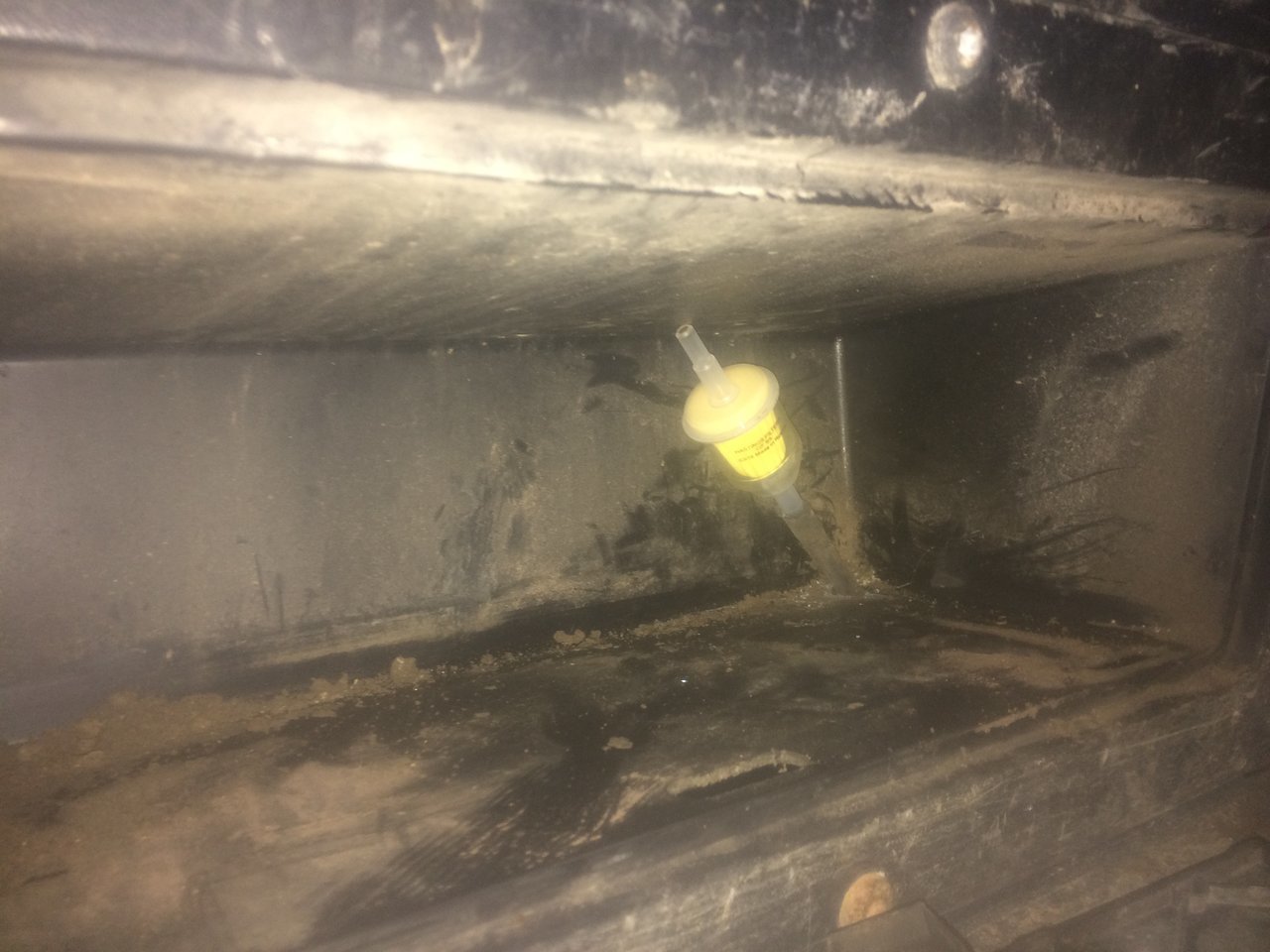

    1. part # needed
    2. location of the breather on the rear diff
    3. clogged breather
    4. New fitting installed in top of diff
    5. rubber hose ran from new fitting to side storage box with inline fuel filter. ( I bought a small one after from a snowblower) on my 1st gen the exact same thing is done but the filter is behind the tail light.
