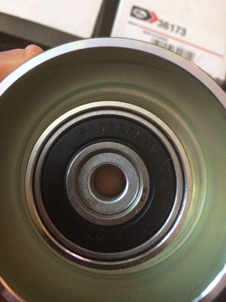

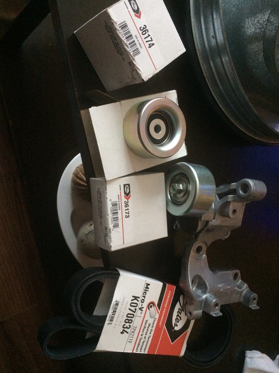

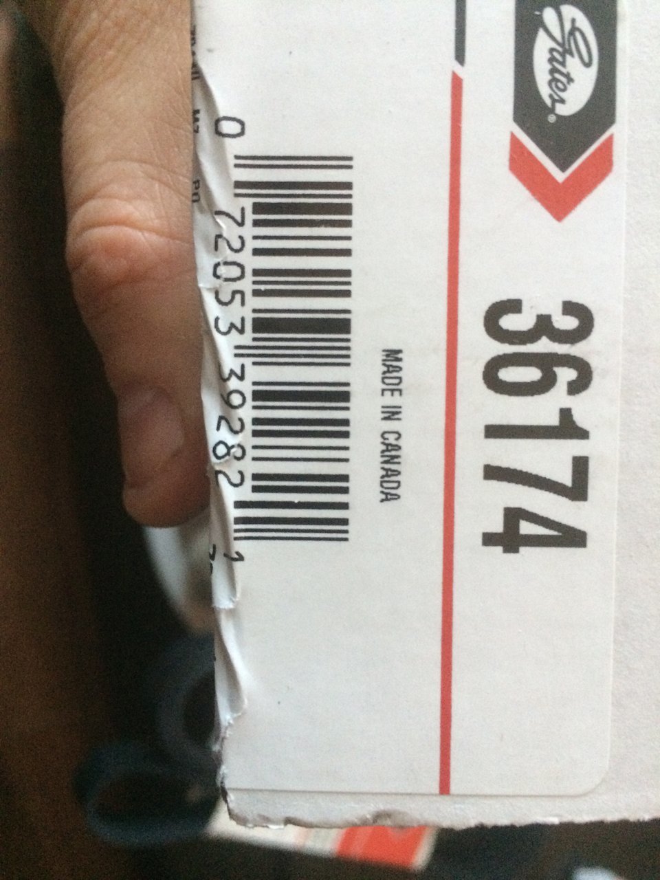

    Magnaflow 2.5 Catback Exhaust K&N filter
    188008AE-7C5A-4EB2-8434-8F389BDD31DA.jpg 27E99410-B237-44FF-BED4-5C55F9282D6E.jpg 1A730C46-F907-4EB2-BB20-C491C44E1D7D.jpg CFC3A10C-CE44-448F-8E7C-0EE4C4DF9BA9.jpg 92BDC3C3-E453-4968-8F7D-A5AC86972DB8.jpg
    Got my idler pulley kit today. All the boxes said made in Canada ffs and I could still buy it cheaper from rocauto online in the US than anywhere in Canada this included the shipping & exchange wtf !

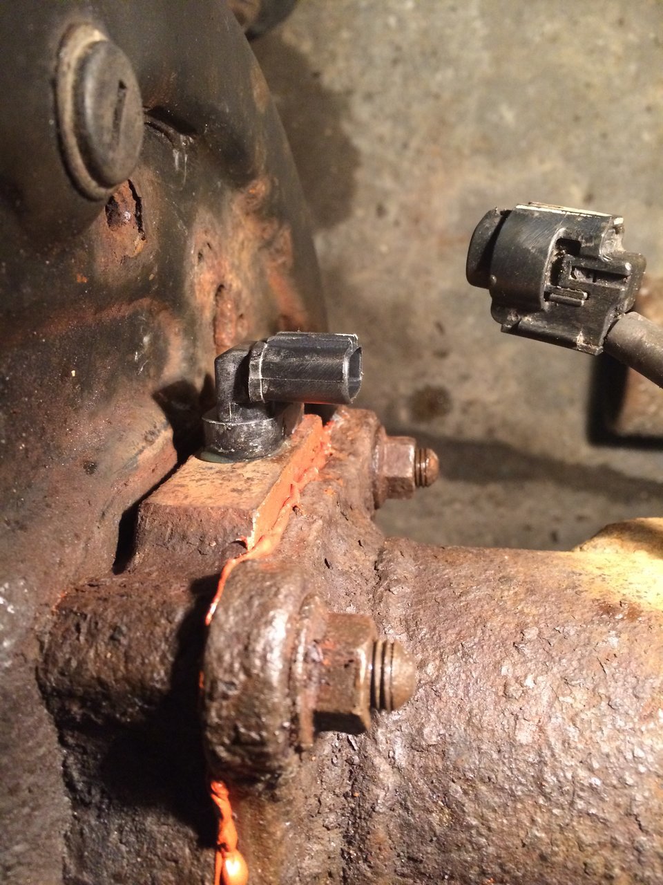

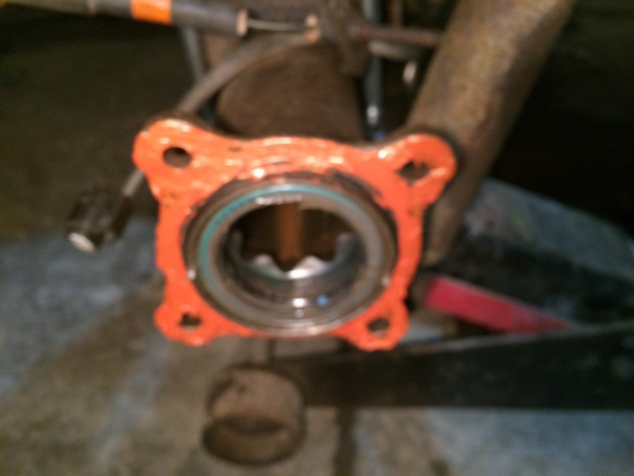

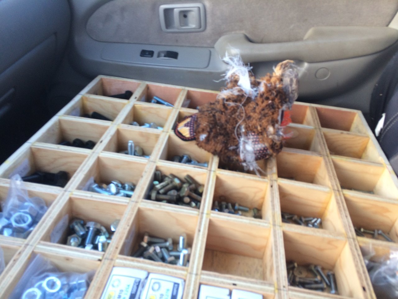

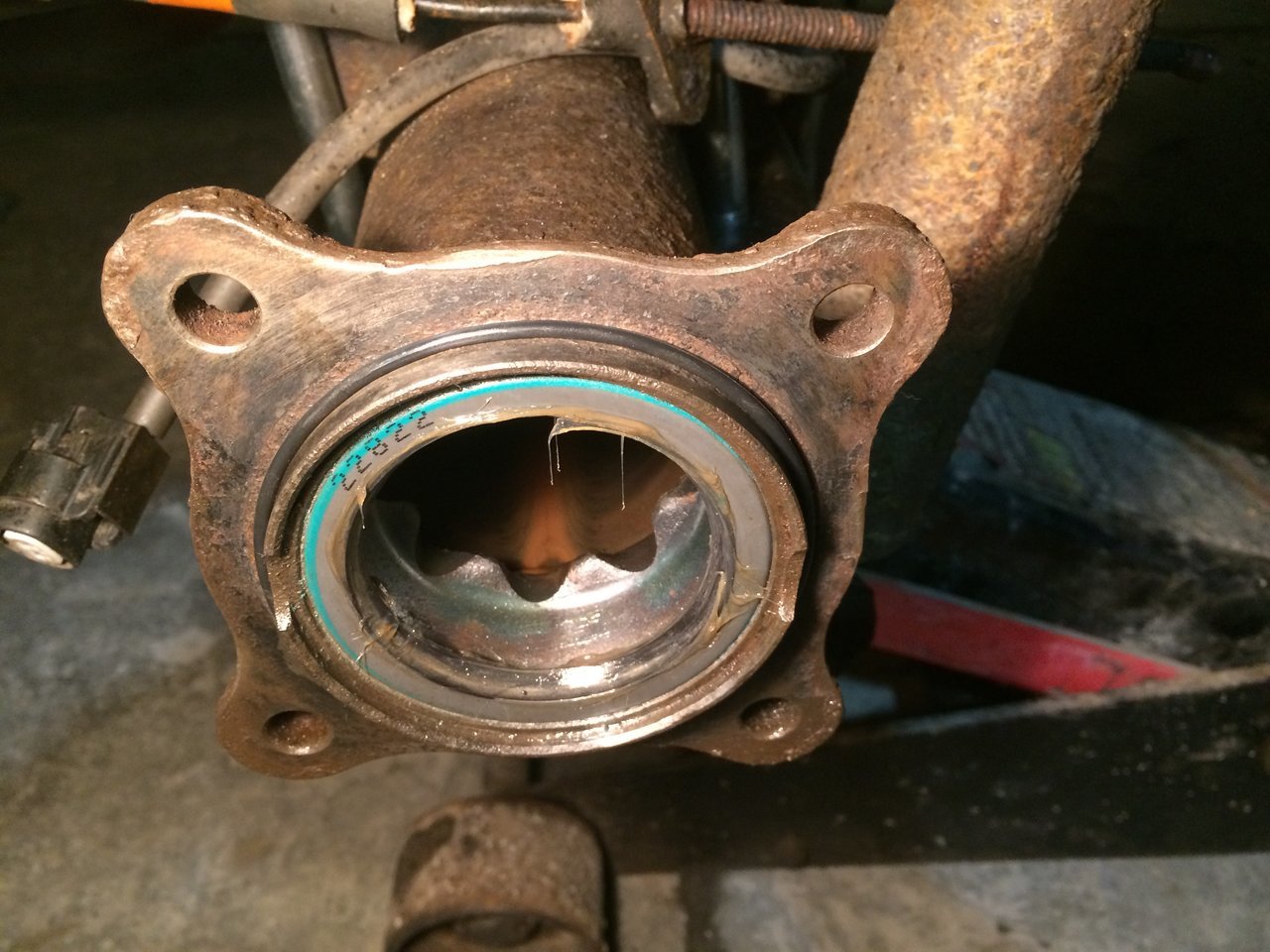

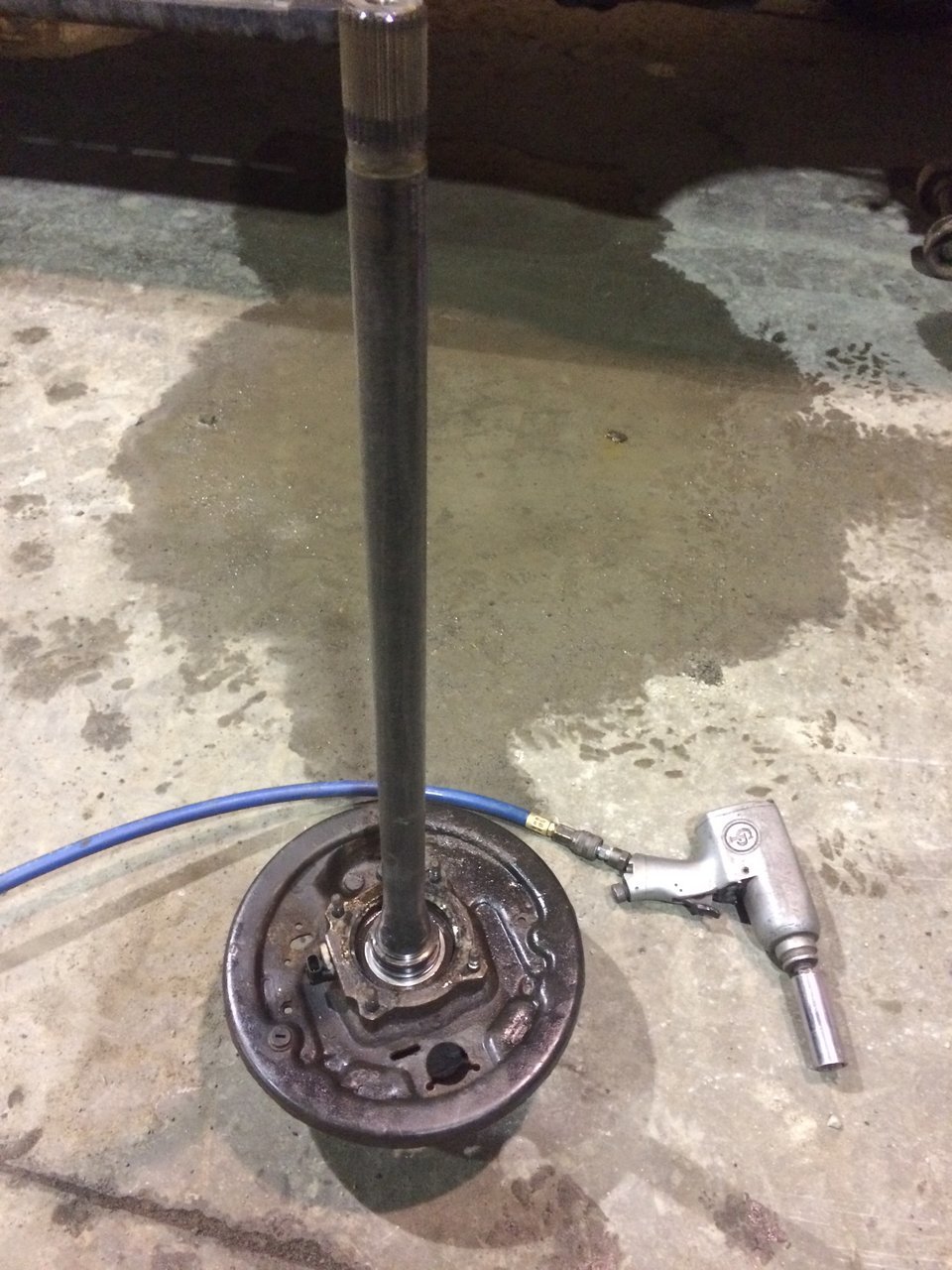

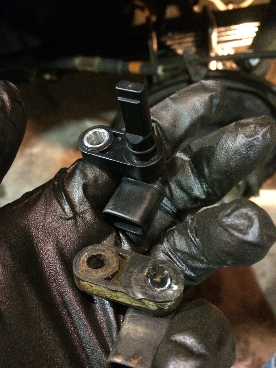

    2007 progress I think ? ... Terra took her well worn out toy to the Tacoma shop, I took my assortment of metric hardware. I had to disassemble rear axel again to put in the missing o ring, I also put gasket maker on it ultra copper used in high heat applications but it’s all I had. Installed ABS sensor with a thin coat of dielectric grease and some in the connector. ABS light is still on

    So i went out and did the test again to pull the codes for the ABS same code, so i did the steps to clear the ABS ECU and it worked cleared the code ........ steps were cross out #4 and #13 with a wire, start the truck, light will flash, tap the brake around 20 times and turn off, remove wire, restart and no light also cleared my (BRAKE) light. F ya
