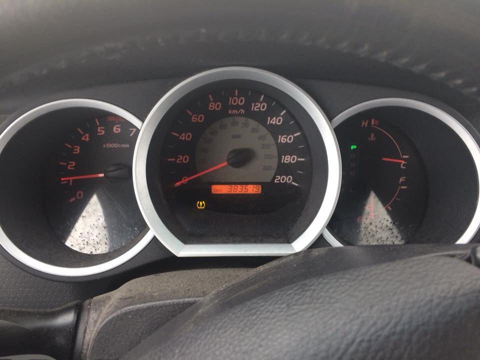

    Man this was a huge victory in clearing the dash lights !
    Only lights on now are the TPS and the low fuel light 1f642_2766b9899ee3629e5a09d5cce92b39232600d4ab.png29186203_10159900686545417_767056265435152384_n.jpg

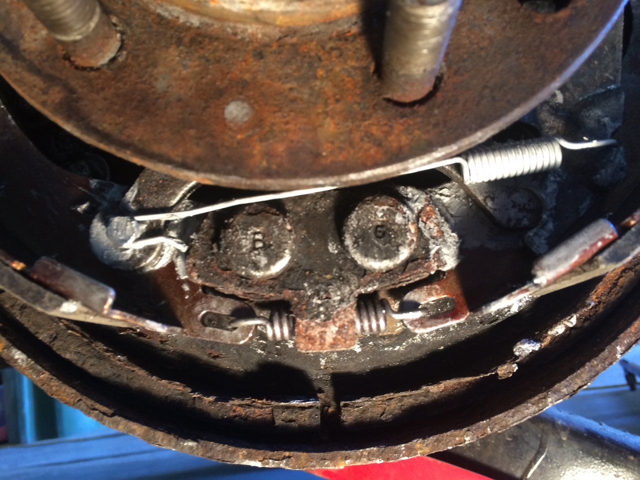

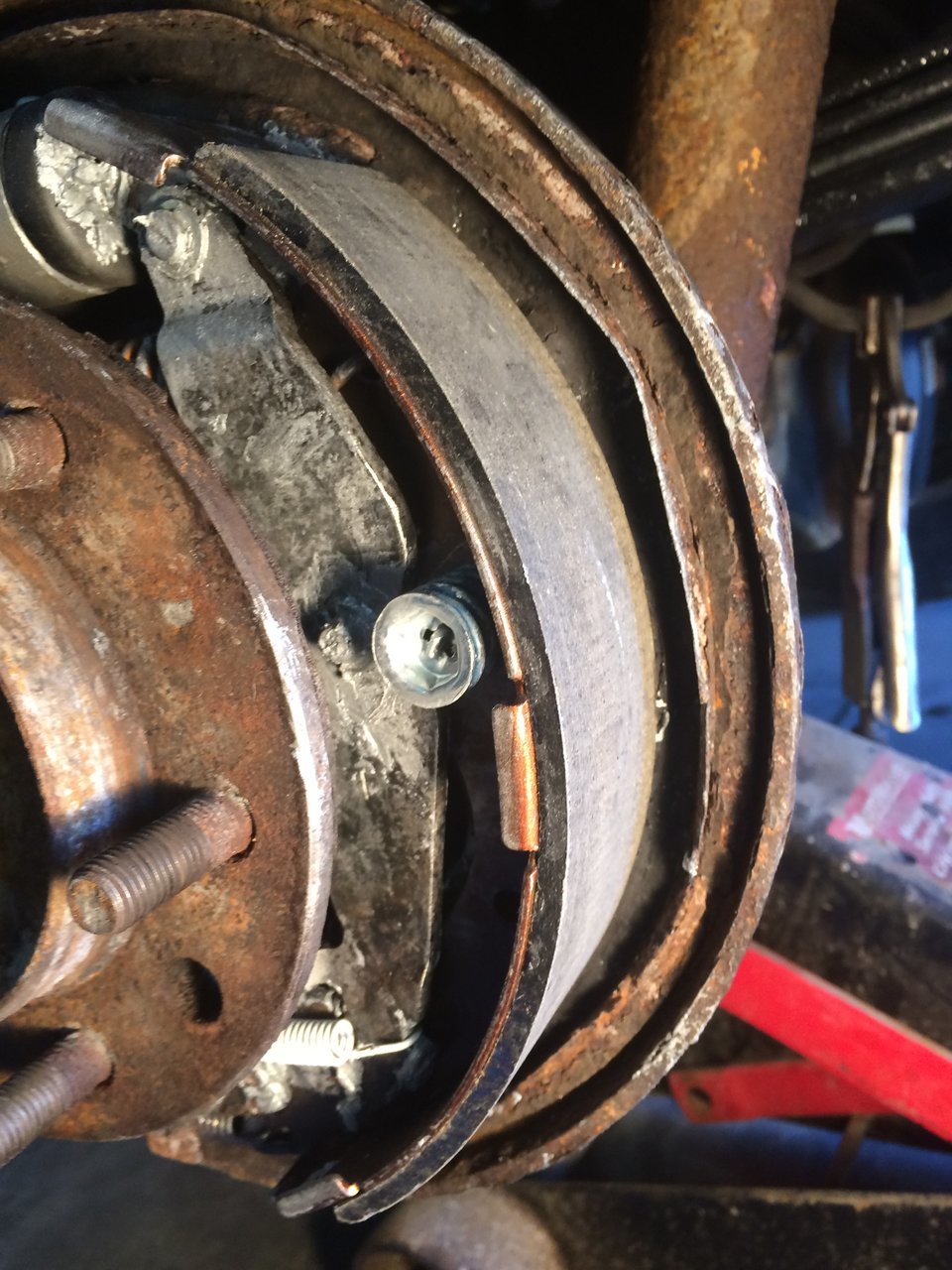

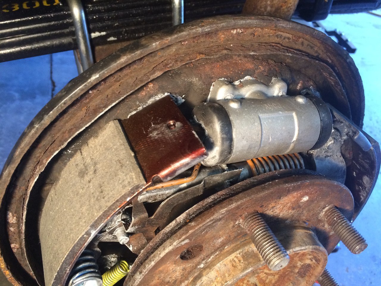

    7B96E42B-C9C3-4A92-8C86-F34316CA5D72.jpg B3A569AE-79EE-43AC-9D11-10805A83BE37.jpg 7106A40C-9747-4A45-A370-83D276584CEC.jpg 695A10BE-B50C-4580-8342-79BFF45C7F6C.jpg D3820F38-A352-4721-8697-3E5F7FEA4B50.jpg DD1BA261-33C5-4C0B-8D8B-EA45ABC34BD3.jpg D2613F76-BC83-4E30-9620-D3244C5D2A78.jpg 0B01B222-AAA6-429B-9BCA-24FDECBA9926.jpg CE669815-79DB-42A2-AF8F-B39F24055A62.jpg 2007 re build

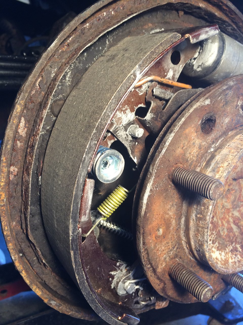

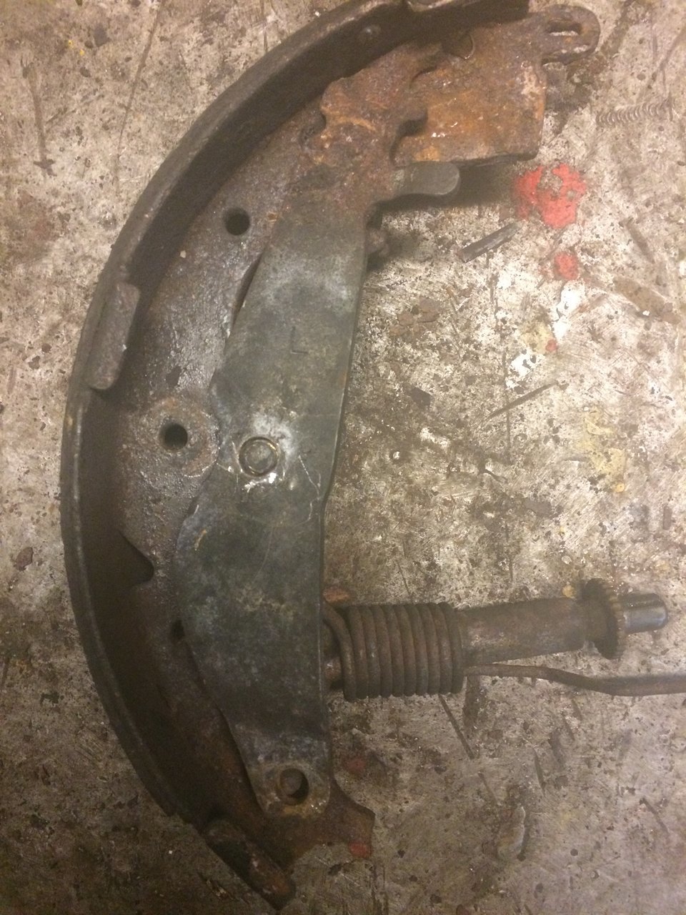

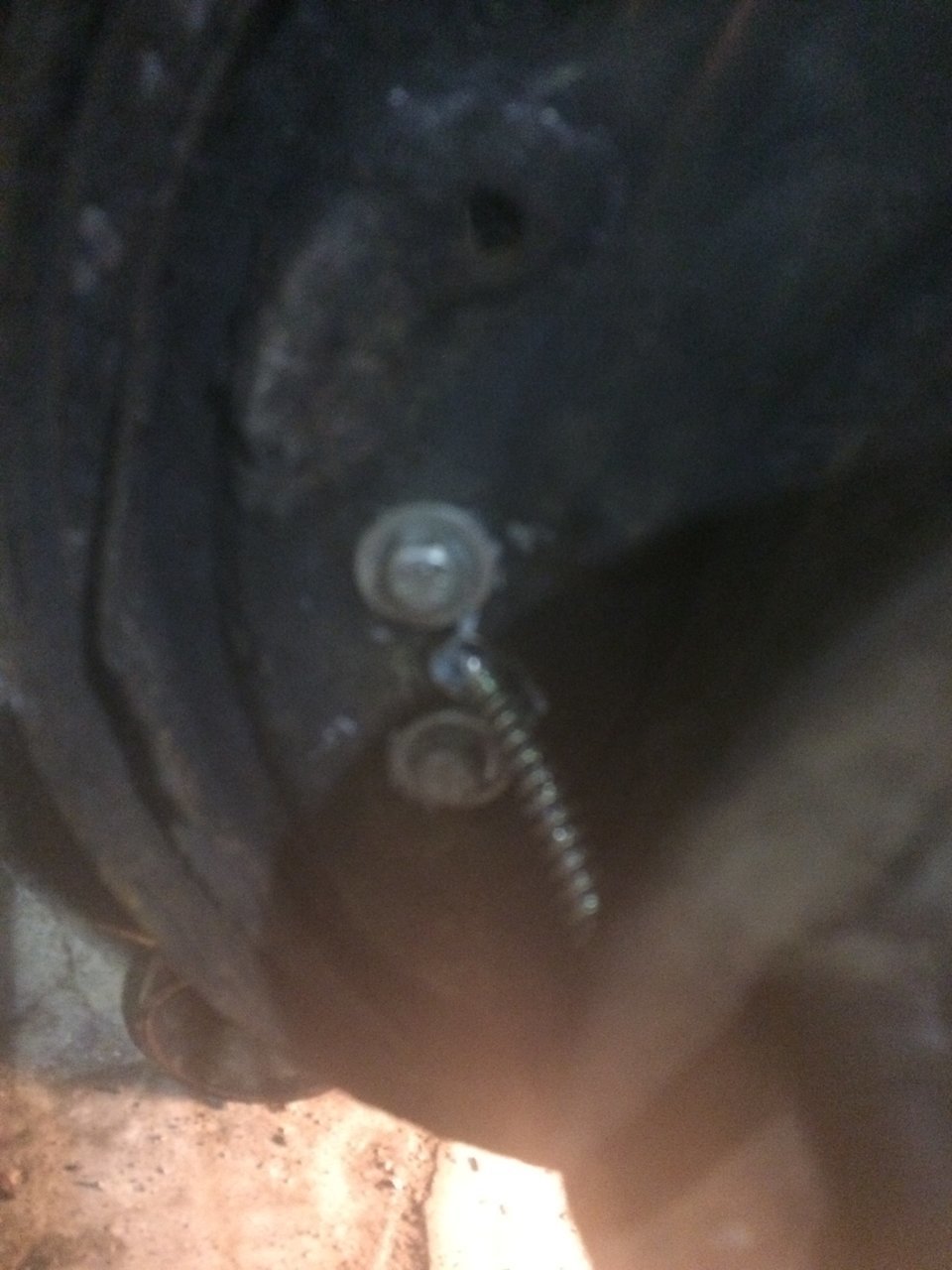

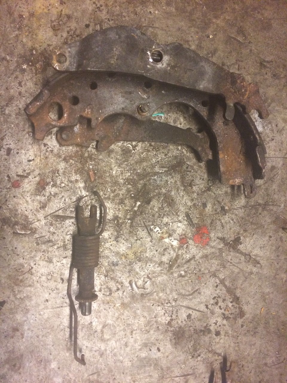

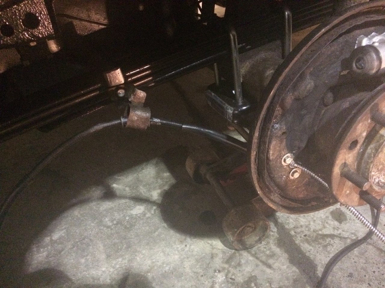

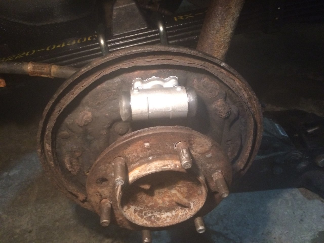

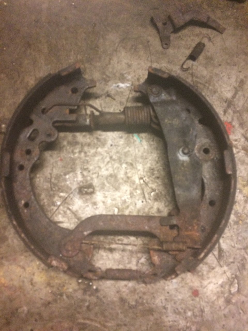

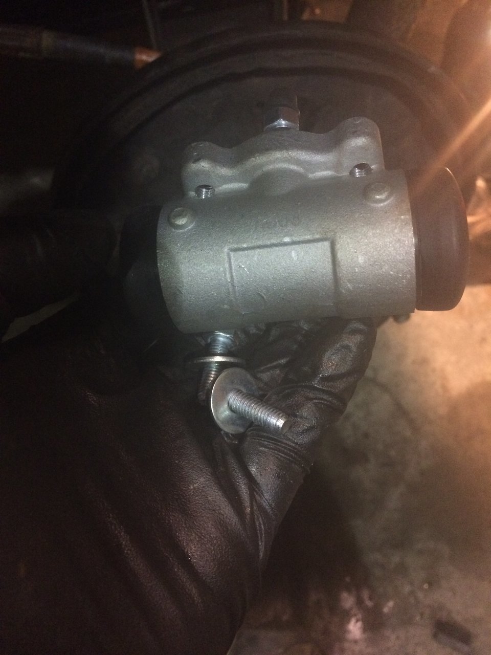

    New rear wheel cylinder, had to install new bolts and cut them to length. Put a nut on first and cut after the nut as this will clean the threads up backing the nut off.
    New hand brake cable installed and ran to cab, new cable had no brackets on it so I had to reuse the old ones. Few brackets were losse on the new cable. Slop will wear the housing off the cable and allow water to get in. So I took some fuel line and split it and warped the new cable.
    I cleaned up all the brake parts (no picture) there had to be no brakes on the back of this truck. Ran out of steam will have to finish brakes tonight

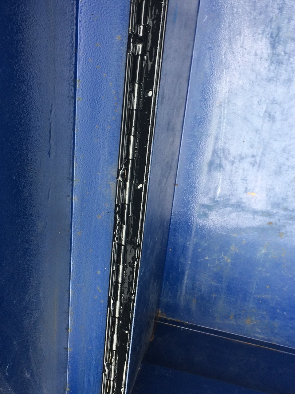

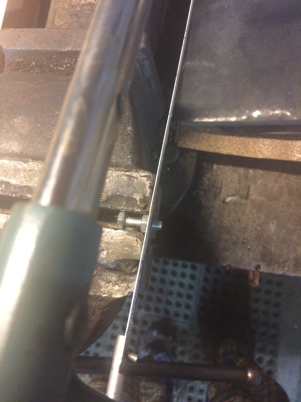

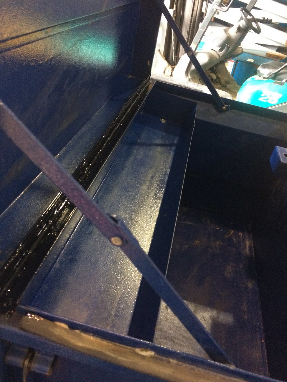

    Started with a bit of welding on a job box I got. The piano hinge needed to be tack welded back on the top and I gave the fresh welds a lick of paint.
    Added the tool tray back in and put it in the back of red tacoma. I filled up the back of the 1st gen with all the un needed 2nd gen parts and other crap I had kicking around at work.

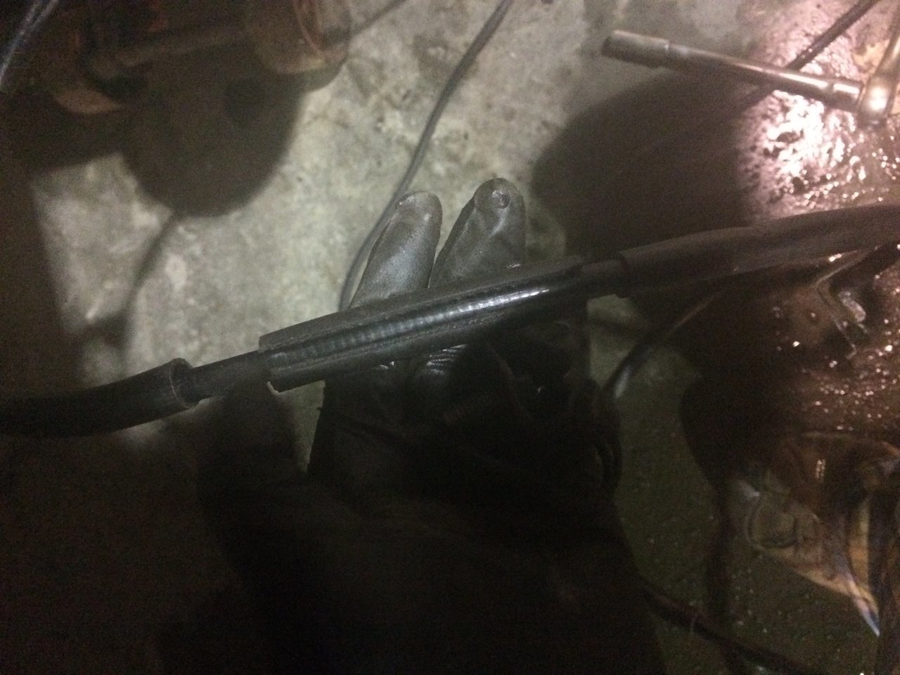

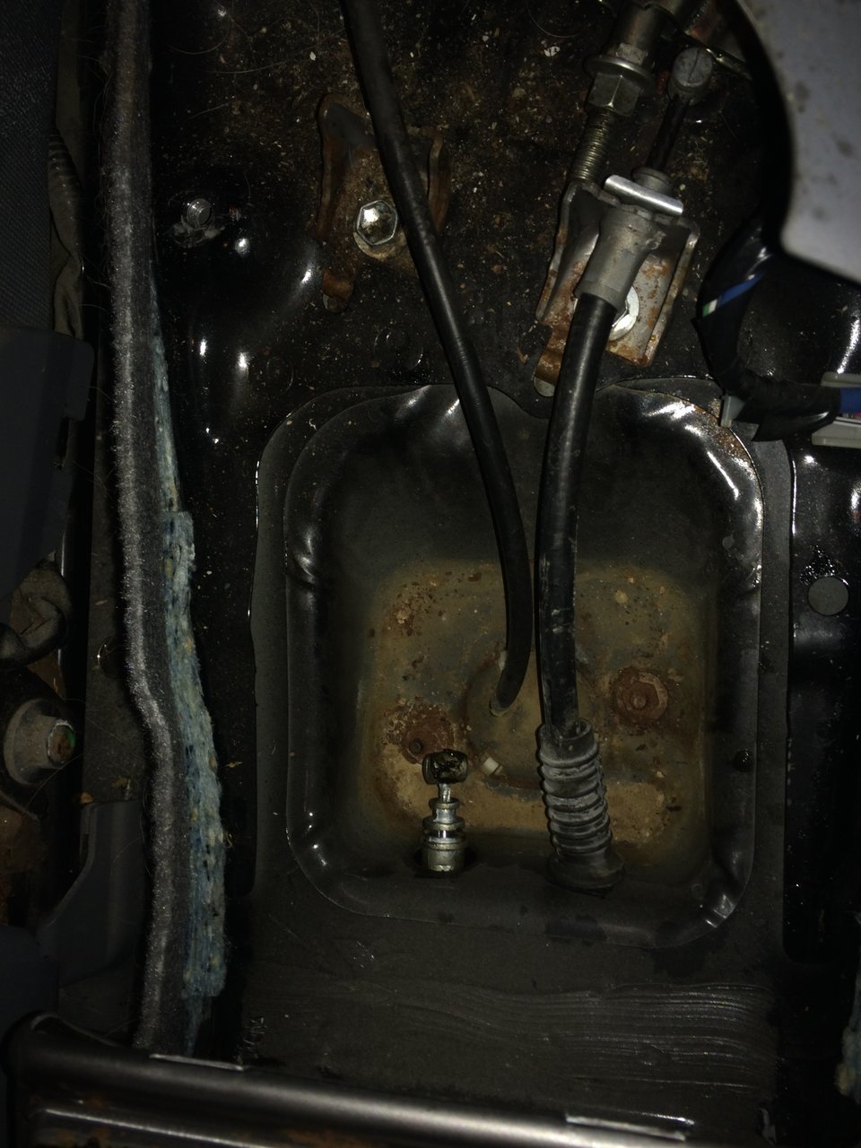

    Did all the dirty work cleaned up so I could finish off installing the hand brake cable inside the cab.
    Sweet f...ing potato’s
    The cable I ordered from parts monkey is the wrong length. Holy chocolate chips......
    Parts monkey is a online parts supplier but I called them to place the order to make sure I would receive the right parts.
    This gets better I flip out as the whole day is now shot and what I have done needs to come apart again. I call around to local parts places no cable in stock.
    Then I search the shop for the old one, ended up dumpster diving with a shovel digging and digging through weeks of garbage
    I guess throwing baby P full diaper genie bags in there so they would not stink up the house was NOT a good idea
