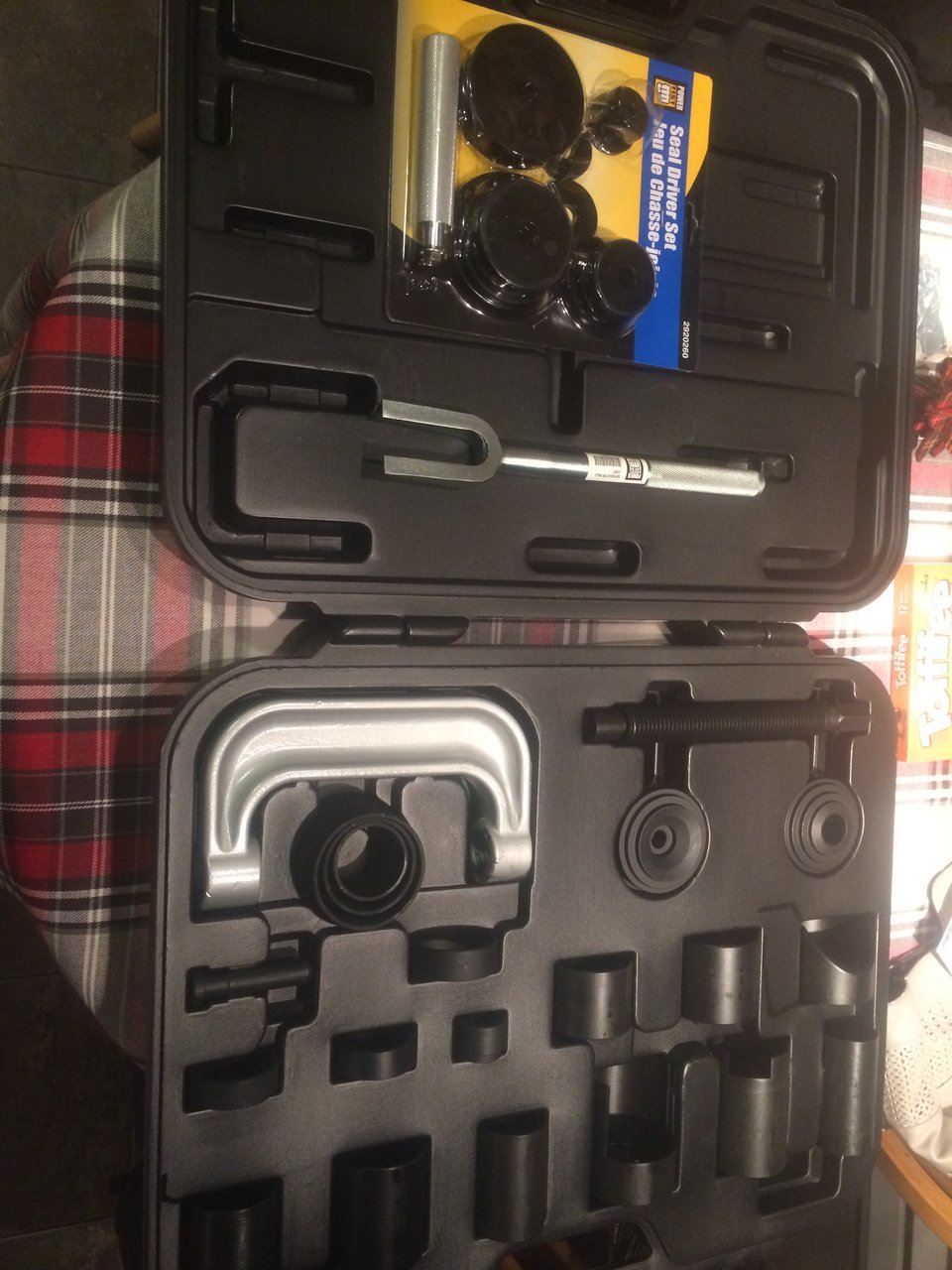

    Some do but I bought the master kit it was not suited for imports and could not the get the correct combination to work for the uni ball joint in the uca. 50EF1415-631D-45C2-866C-DB78EDE5AAA5.jpg

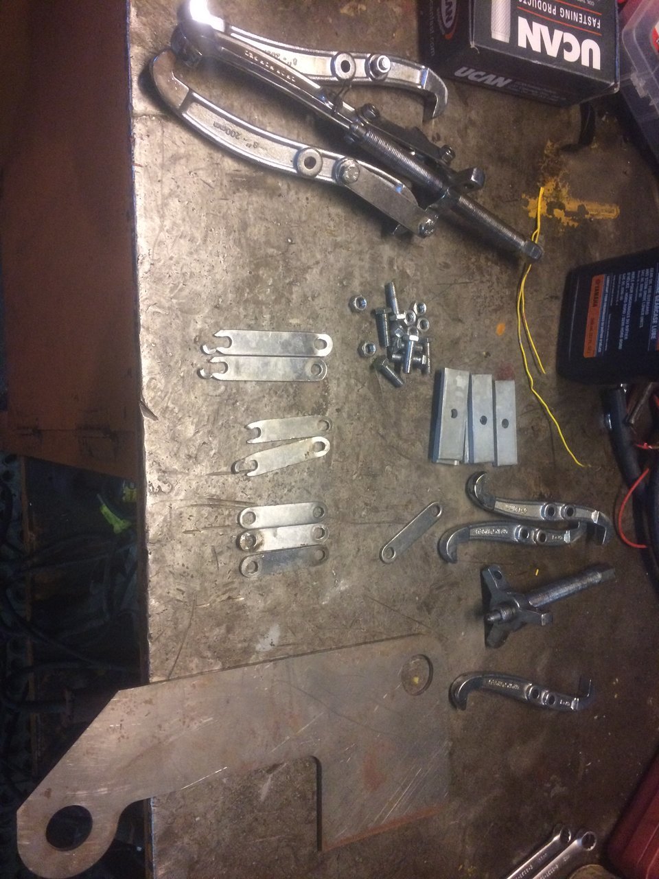

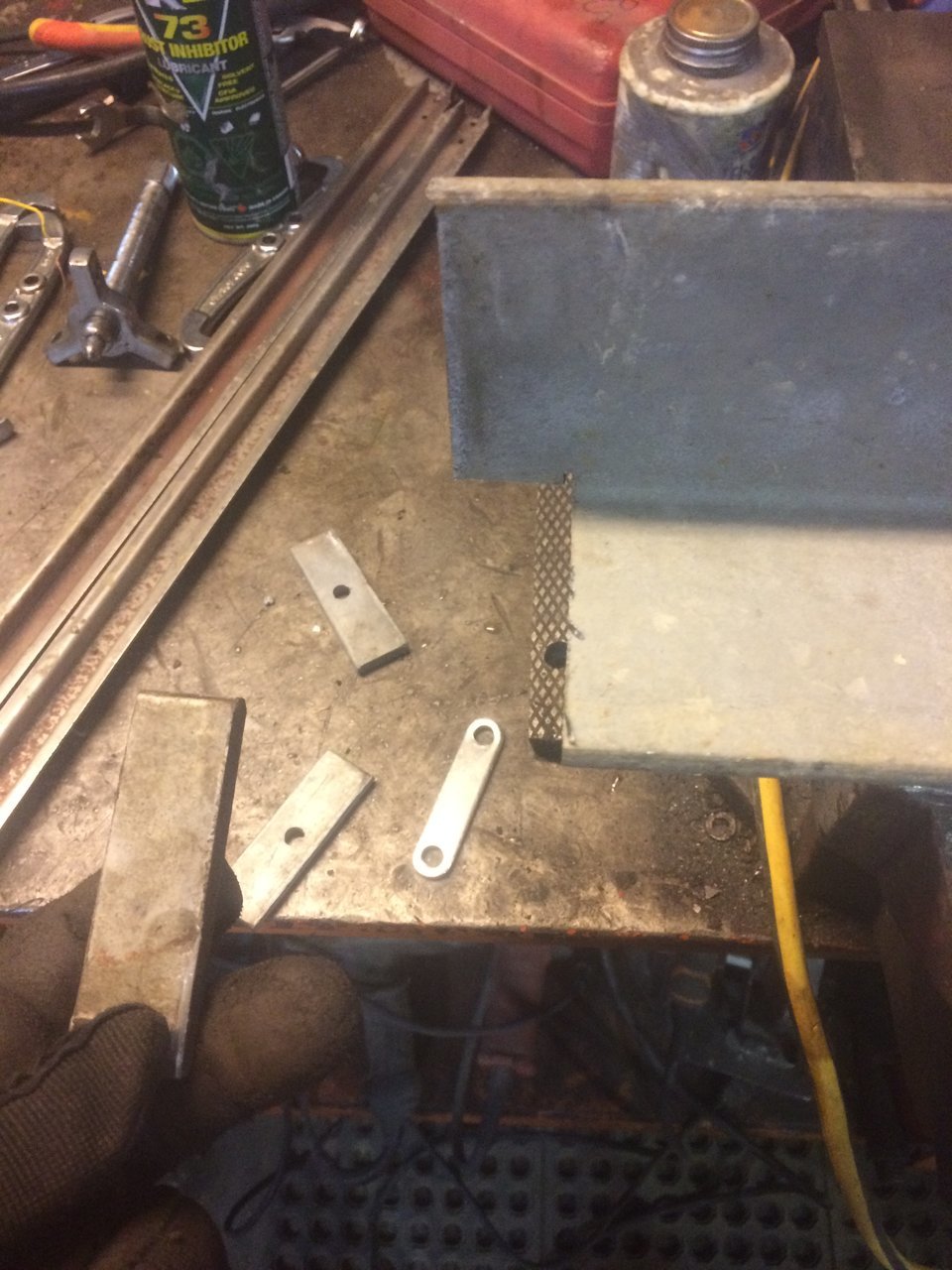

    So my two three jaw pullers broke, princess Auto would not warranty them due to no receipt. The offered me to give me the sale price on them. Ok $28 give it to me but I am going to make stronger plates and fix my old one and save the $ as family taco is on a major budget.
    7DB668A6-B5D2-4555-92B6-E111BDF3627E.jpg 3D591091-50F0-4615-8199-D64282C42E48.jpg
    I had all my plates cut and one hole drilled and then it struck me that $28 is holding up progress on truck. Ditched the plate idea for now and went and got the new one to start working.

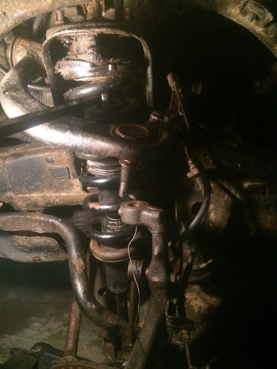

    Drivers side upper ball joint already had the nut lose, boot and snap ring removed so getting to this stage was easy. I support the spindle with re bar tie wire to keep it from flopping around. You can hold the uca down with a jammed pry bar. I found this easy to work on it this way
