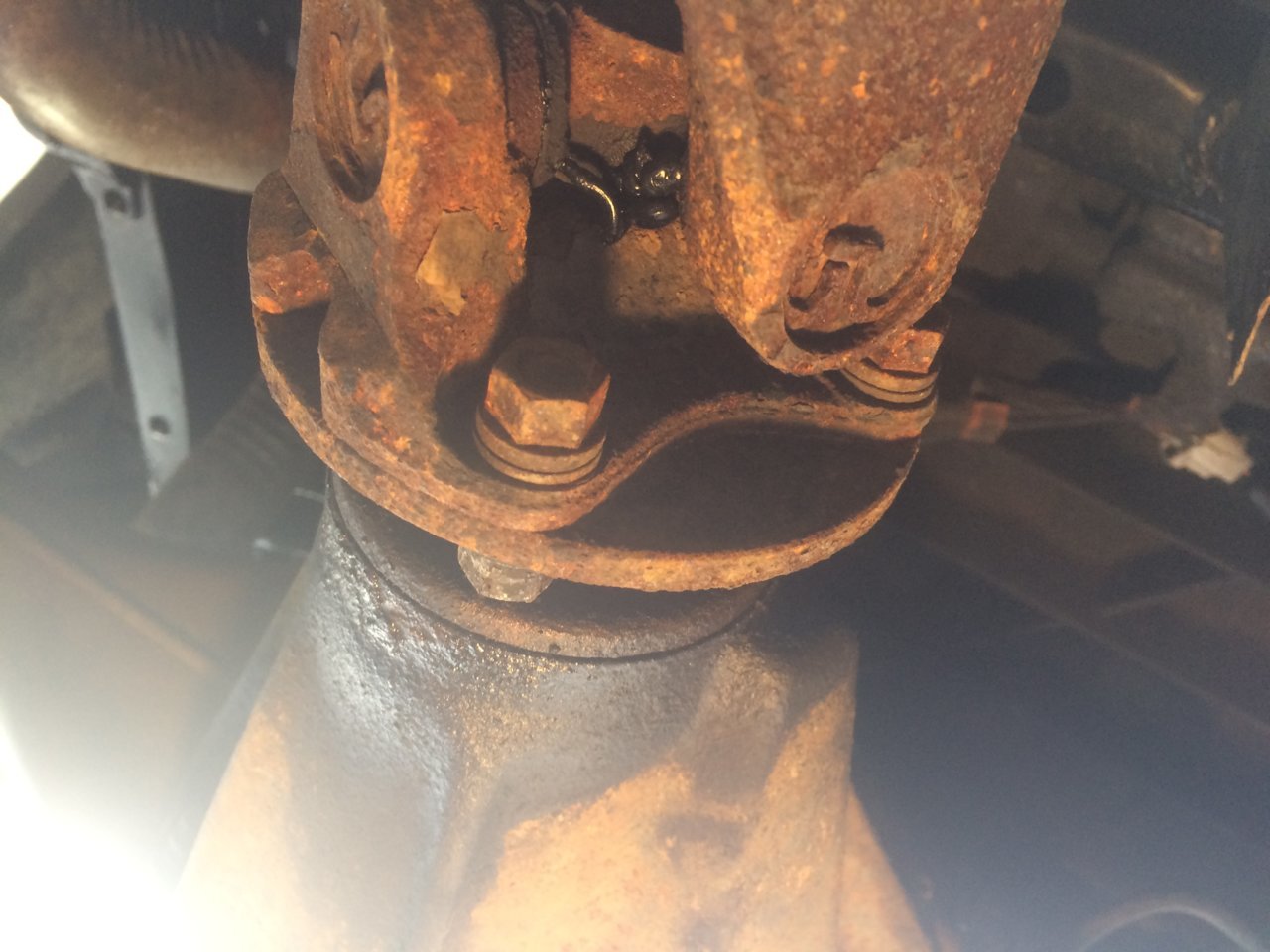

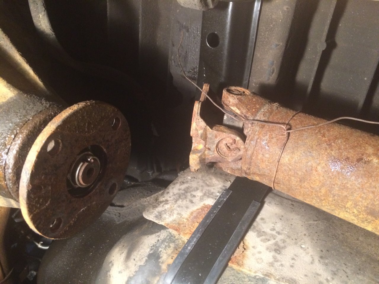

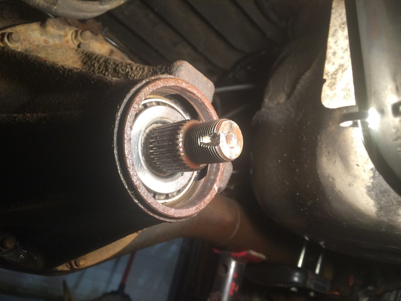

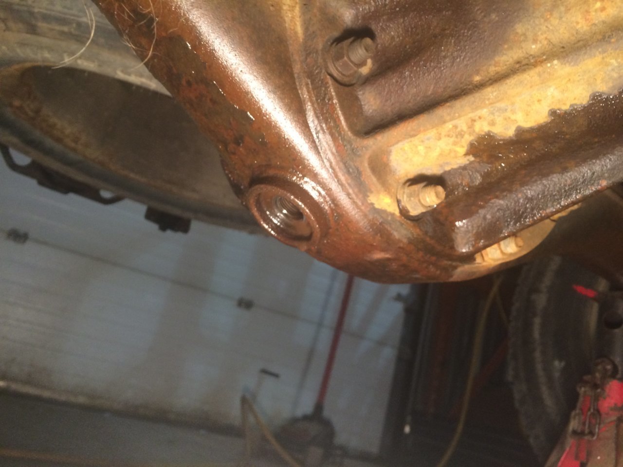

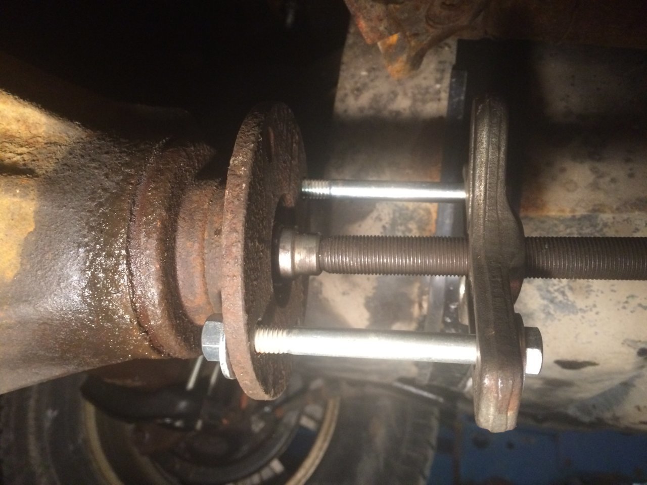

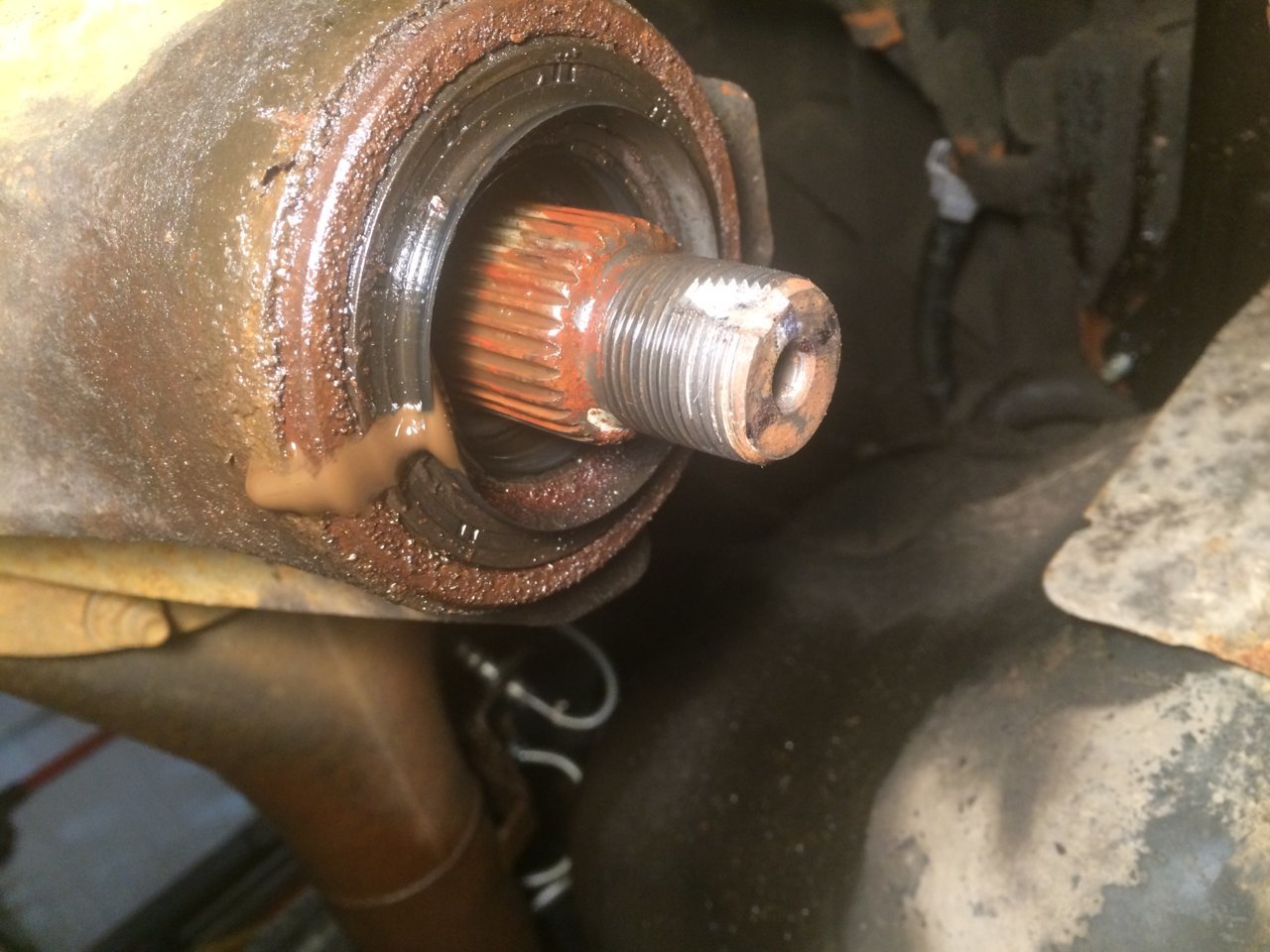

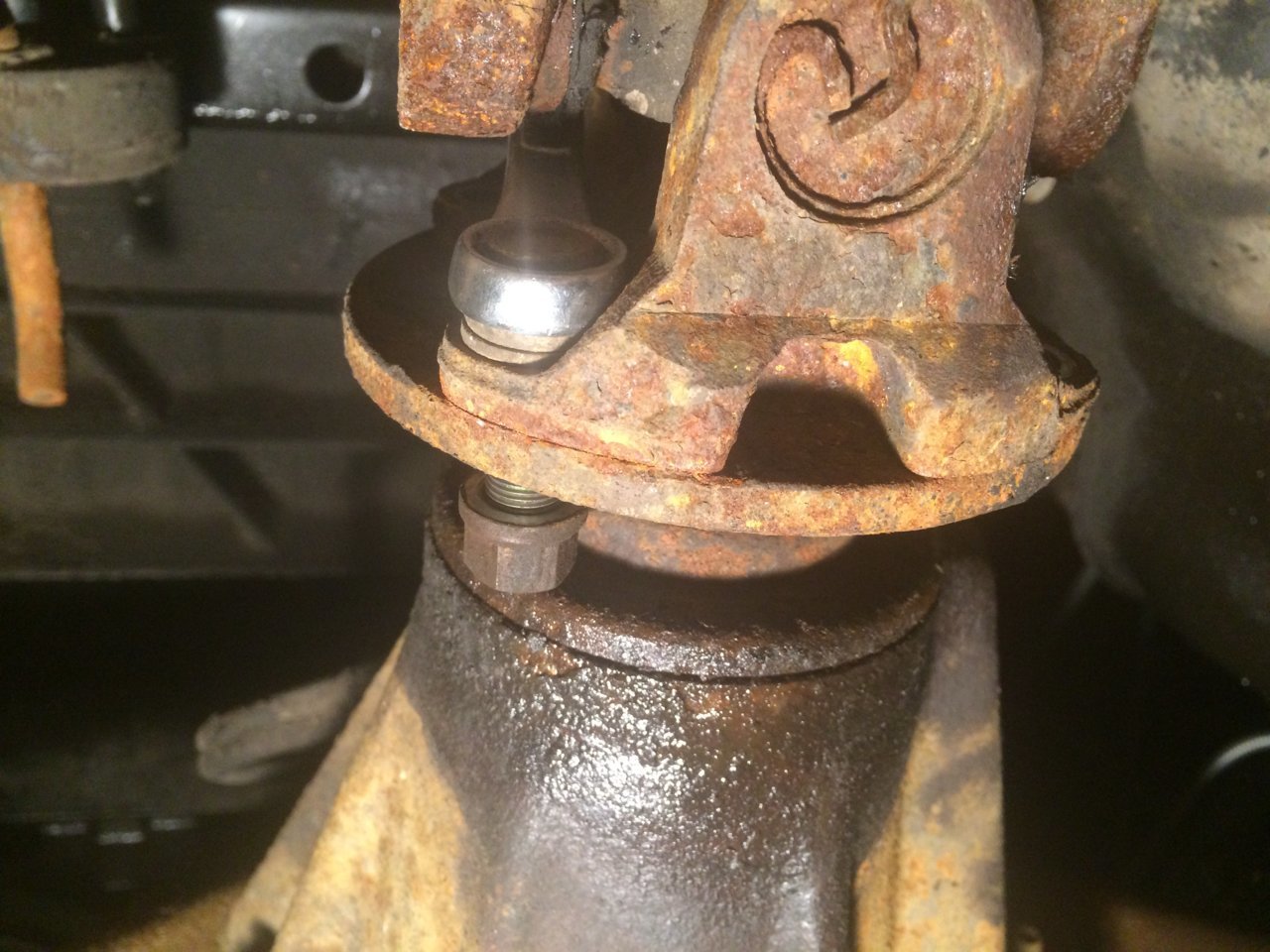

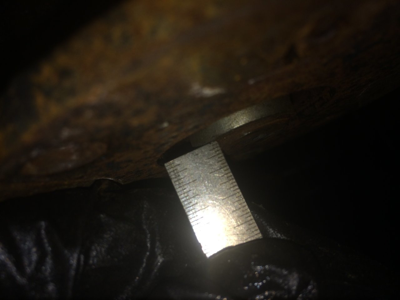

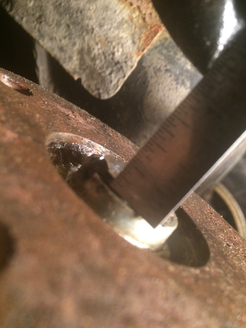

    Taco Pro wrenching adventure # 3429
    Its like the song that never ends
    Time to crawl under the truck and get that leaking Pinion seal fixed
    Tools needed two 14mm wrenches, 30 mm socket, punch and your favorite hitting device & some sort of seal remover and installer
    I marked the yoke and the flange so they went back together the same way

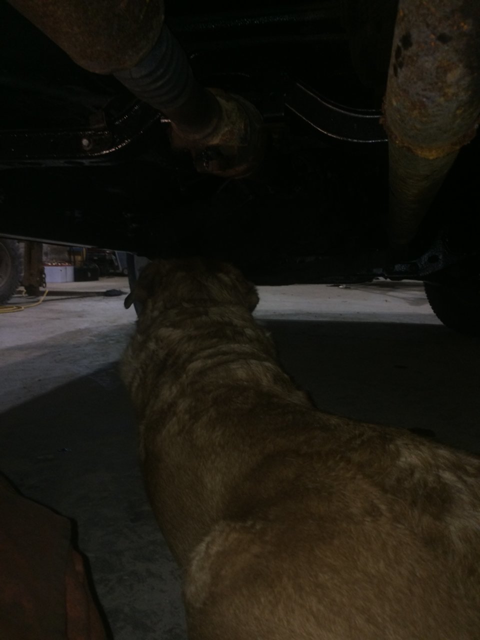

    When your dog has to be by your side 100% of the time even when your under the truck !

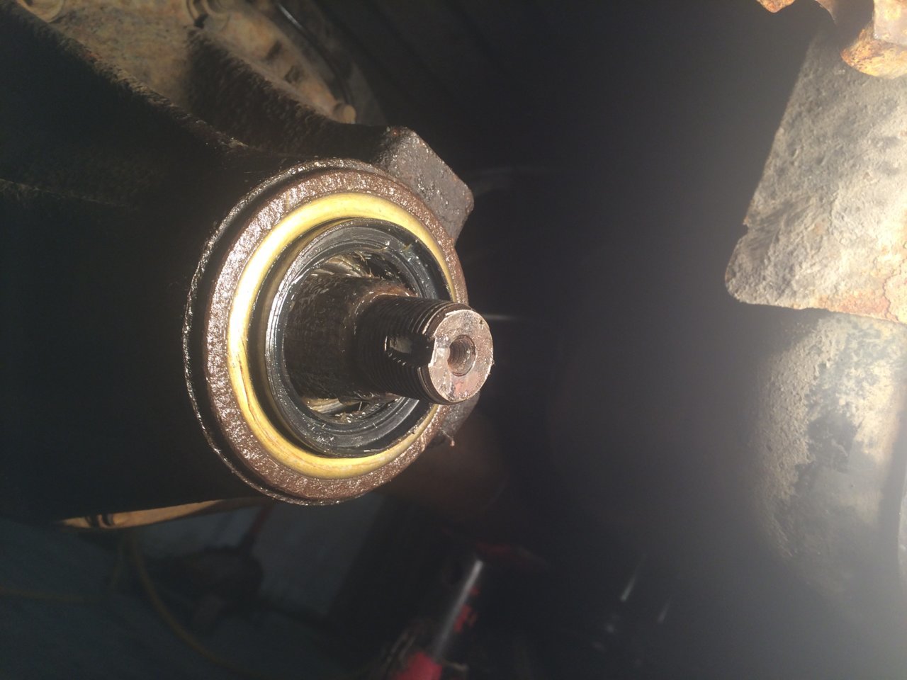

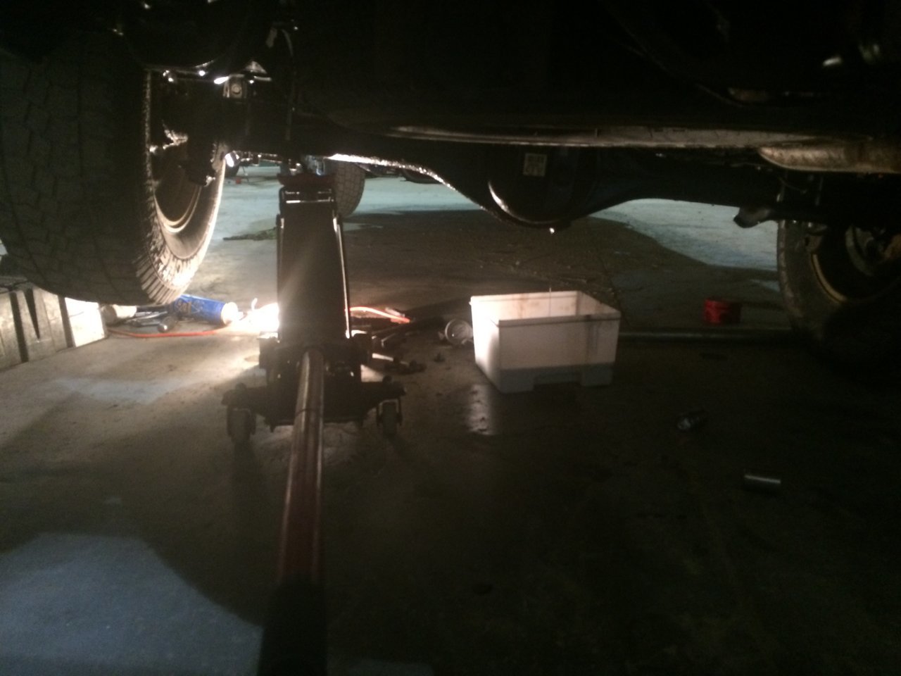

    Magnaflow 2.5 Catback Exhaust K&N filter
    IMG_8179.jpg IMG_8185.jpg IMG_8186.jpg IMG_8187.jpg IMG_8188.jpg IMG_8189.jpg IMG_8190.jpg IMG_8191.jpg IMG_8203.jpg IMG_8220.jpg
