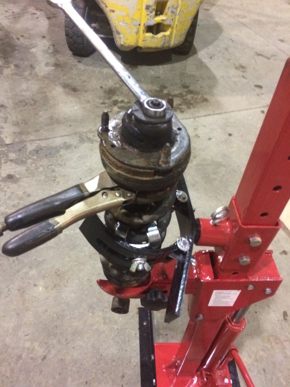

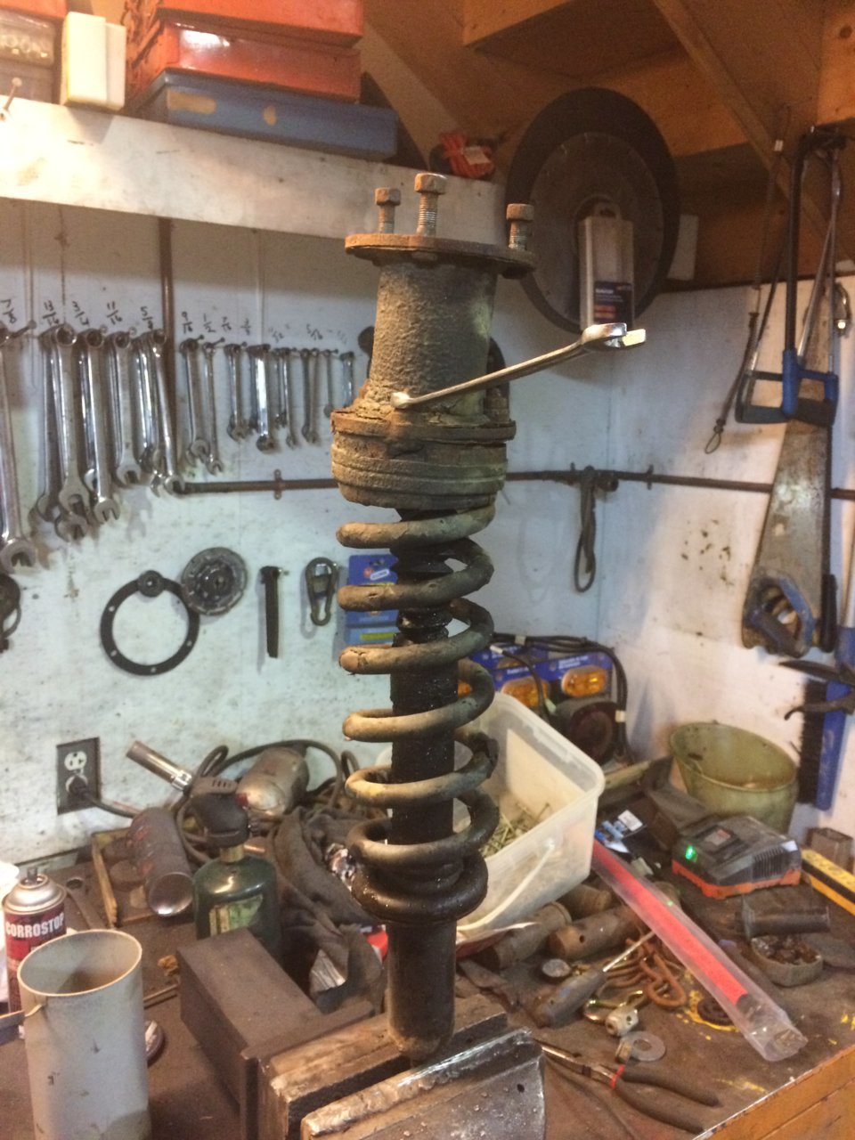

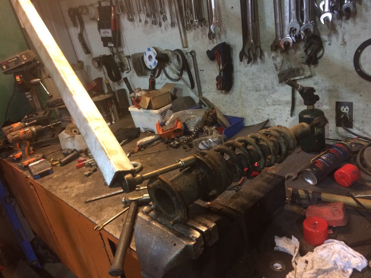

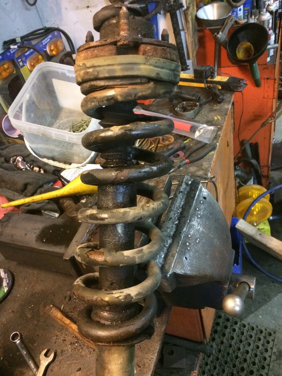

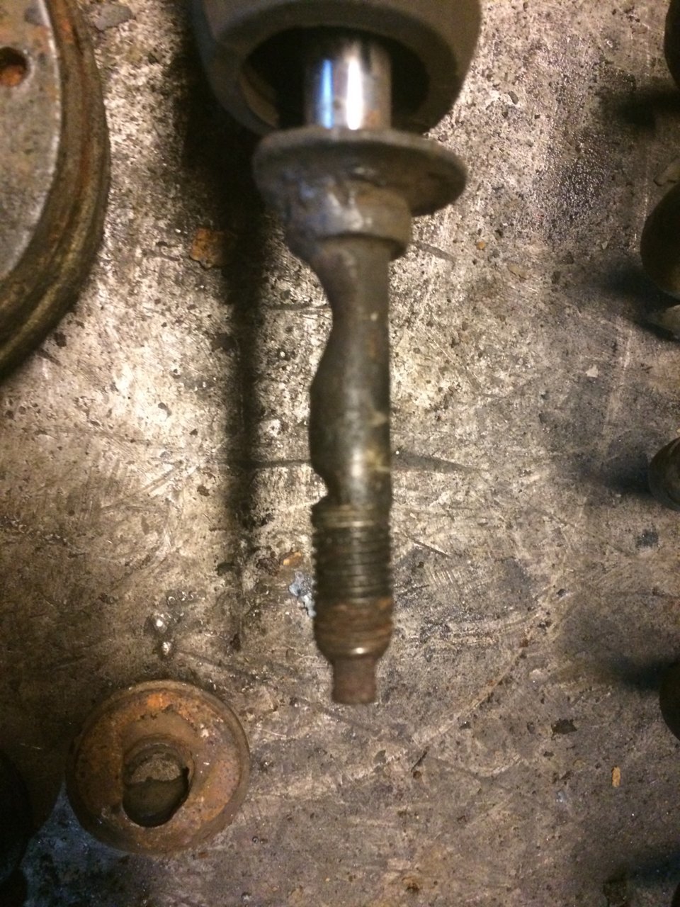

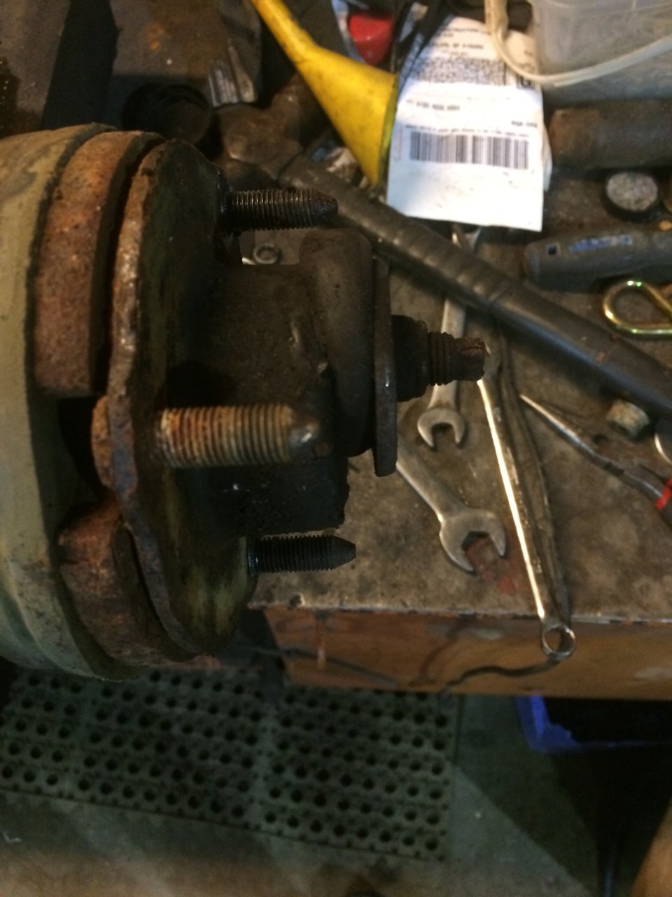

    Trying to help out a friend with his 05 Tacoma holy f look at them spacers part of a drop frame lift. Anyways fought to get the nuts off then my coil spring compressor was looking real sketchy when trying to compress the spring. The bolt was turning into a u so I bailed and going to go get a heavier spring compressor tomorrow. Notice how the shock is off center and the top bushing is all messed up.

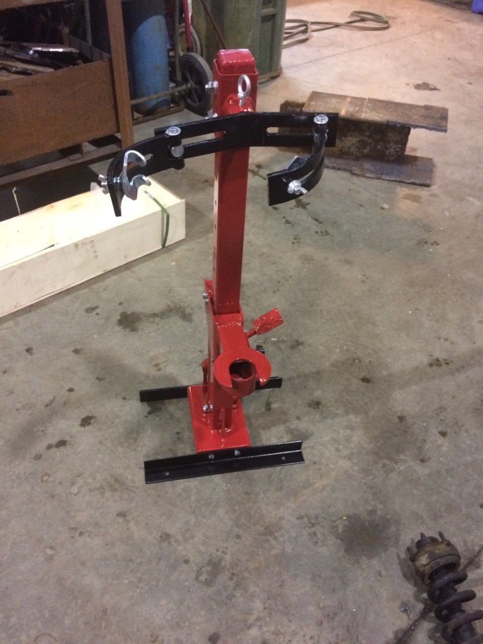

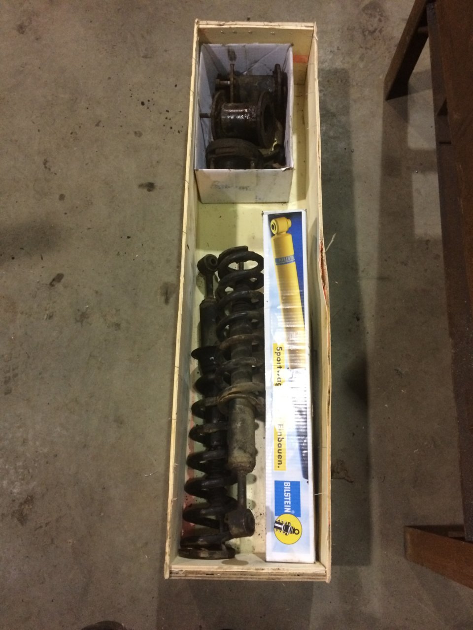

    Anyways moving on let’s play “what’s in the box”
  8. Dec 13, 2018 at 9:33 AM
    #828
    Juforrest
    Juforrest Dumb!
    Nov 23, 2015
    #170434
    5,928
    Justin
    Seattle
    Reformed Taco driver in a GX460
    How big is the box?
  9. Dec 13, 2018 at 9:38 AM
    #829
    Jon G
    Jon G [OP] Hoarding Tacomas one at a time,
    Jan 25, 2017
    #208594
    1,830
    Jon
    St John's Newfoundland Canada
    02, 04 & 07 Tacoma
    Magnaflow 2.5 Catback Exhaust K&N filter
    Weight & Package Dimensions
    • Weight (lbs) 77.0
    • Package (L x W x H) 47.0 x 11.3 x 8.8 in.

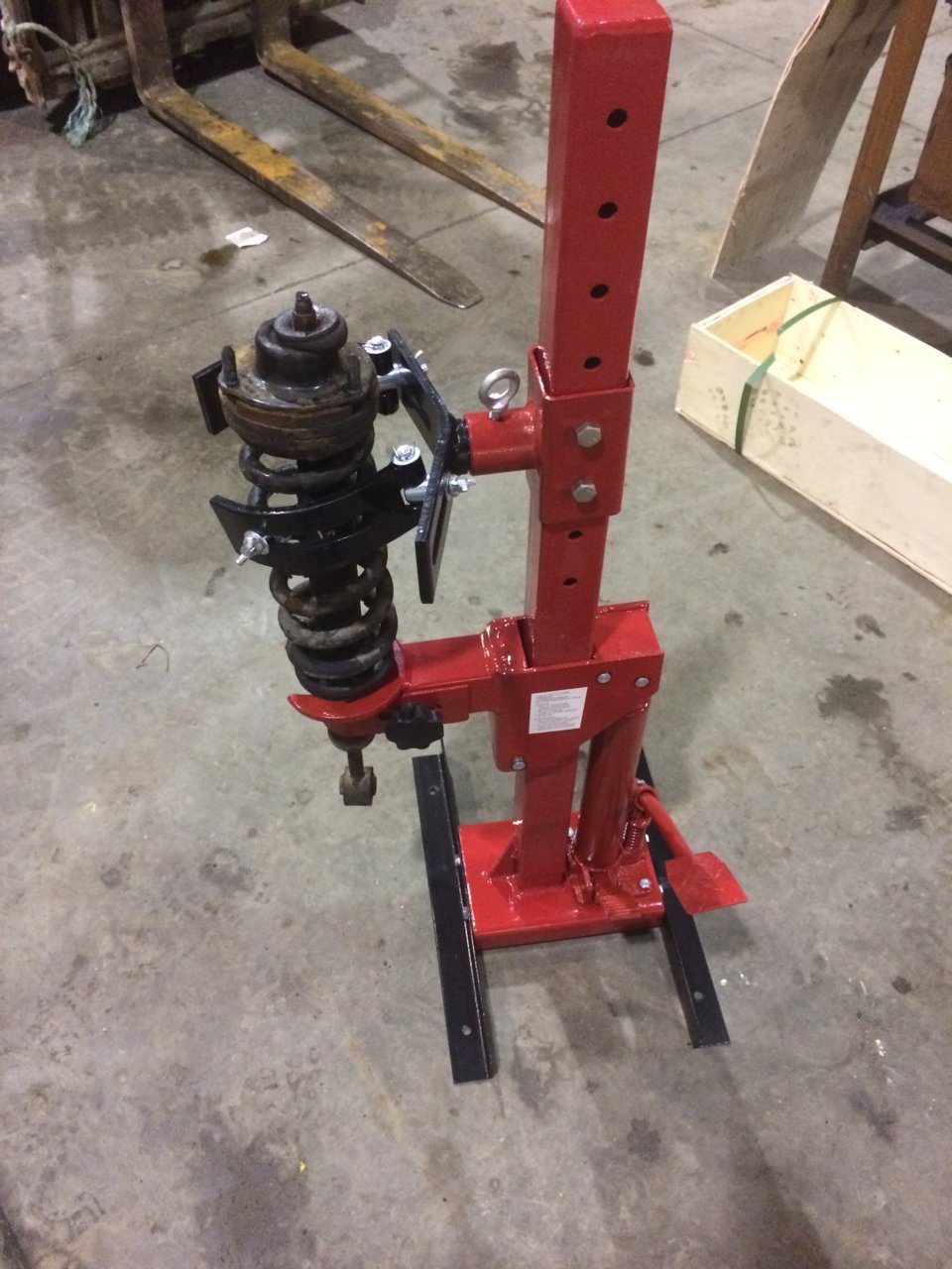

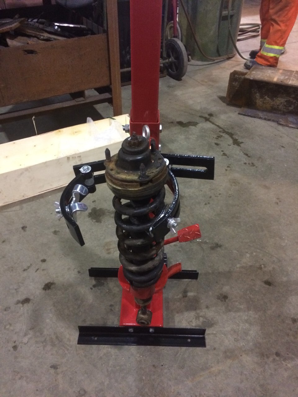

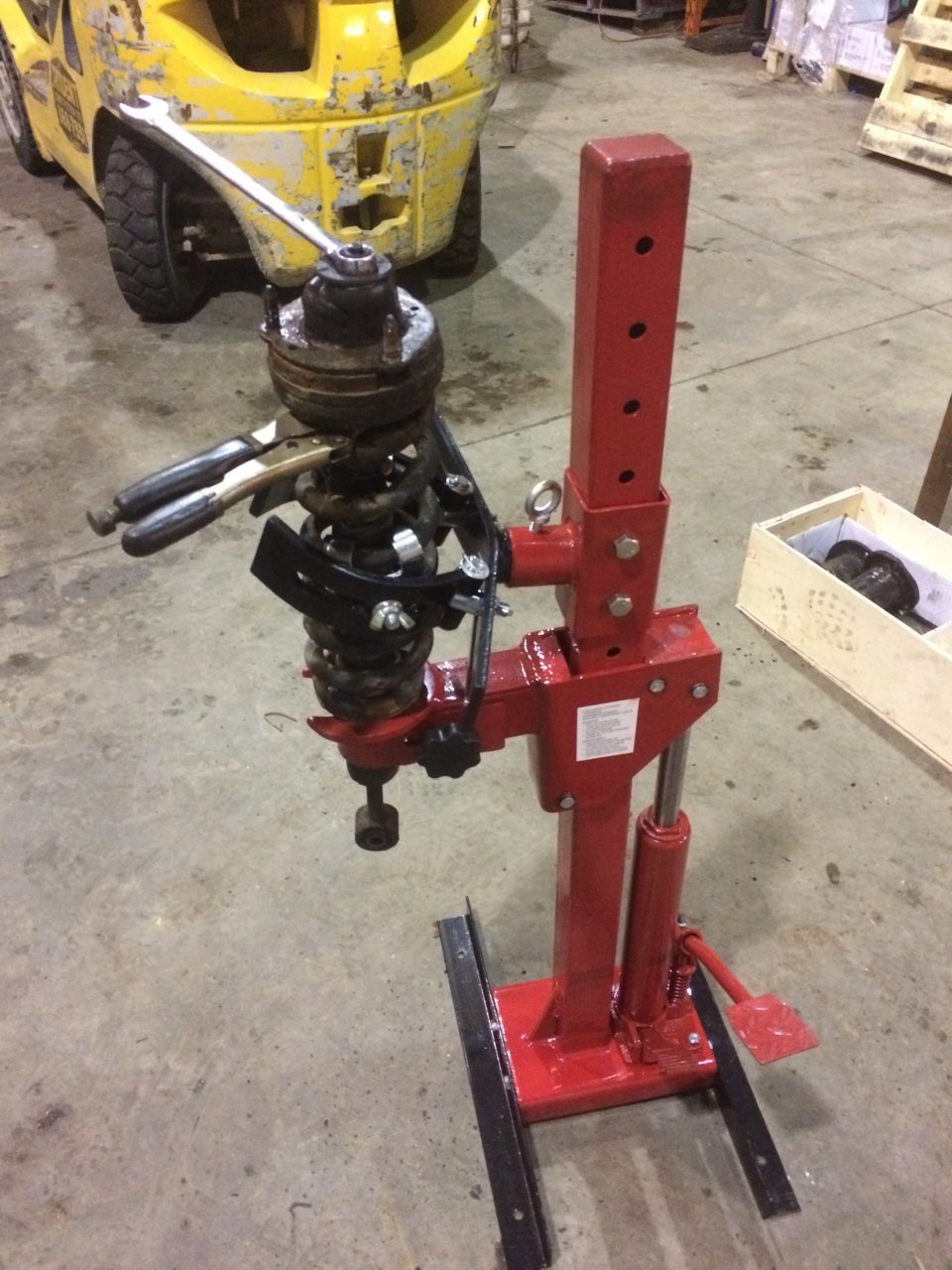

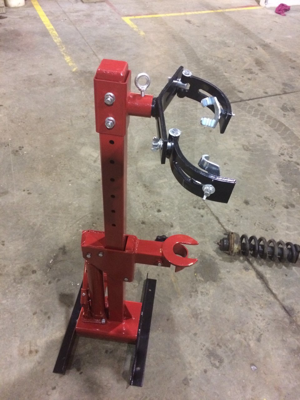

    A pony that has 1Ton worth of spring compressing capabilities
    F ya took back the Death trap spring compressor and bought this

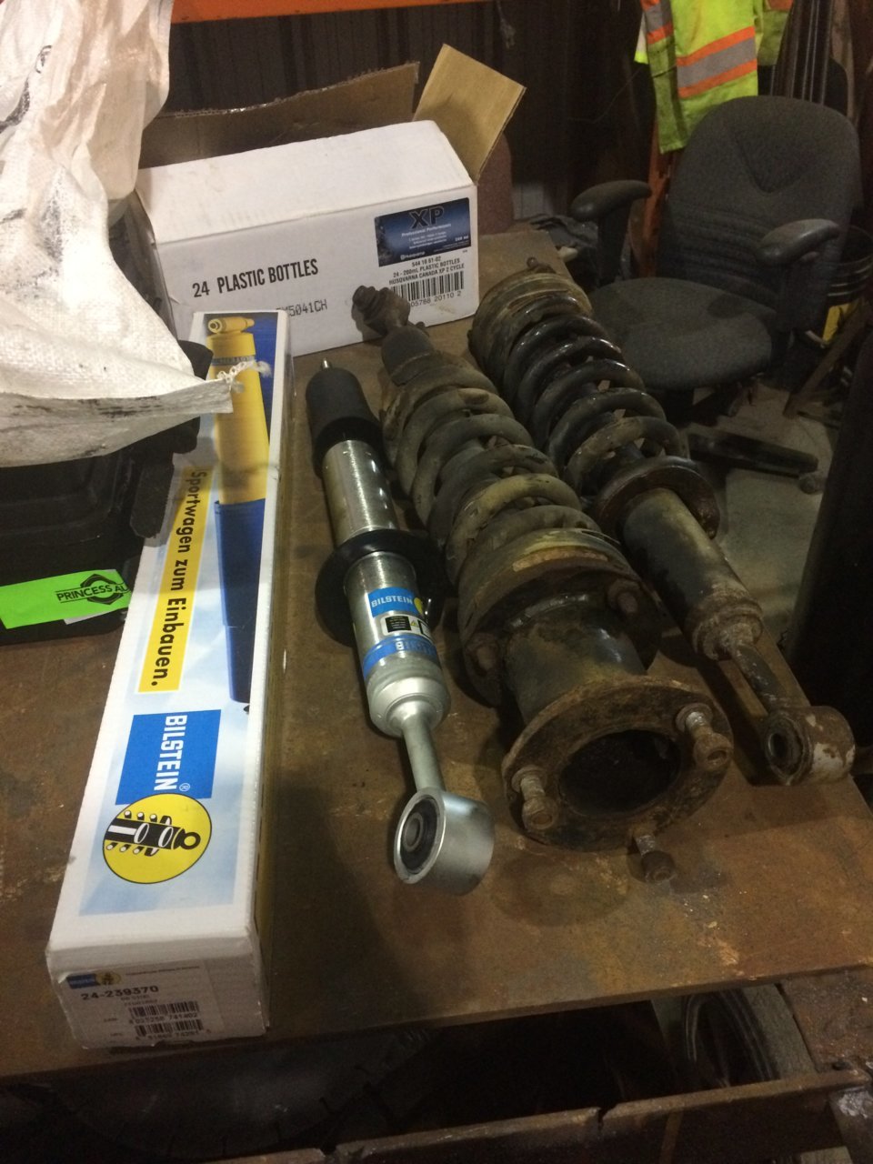

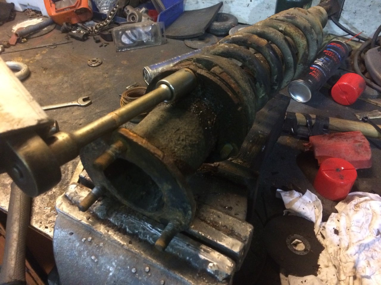

    The other shock was the same 46AD8226-E560-4A0E-86BC-F9A15D7296D9.jpg2A8567F9-B2B1-4283-A63B-8779B5B927A8.jpgB7CAC0D3-ED33-4AB6-9A35-6CB3924E8A14.jpg3985A831-CD69-4688-83CA-290D13D5AD11.jpg34FE3D51-173A-4CA9-B8E6-E333565CF055.jpg66897185-EC01-4905-BCEC-079F79D2119E.jpg404083C5-1B5F-4235-894E-366DC6978BB4.jpg4167F22C-E83D-4357-B862-1E6791C7BE03.jpgCABC3CBE-B636-4AC9-8550-D4DB730334A1.jpg

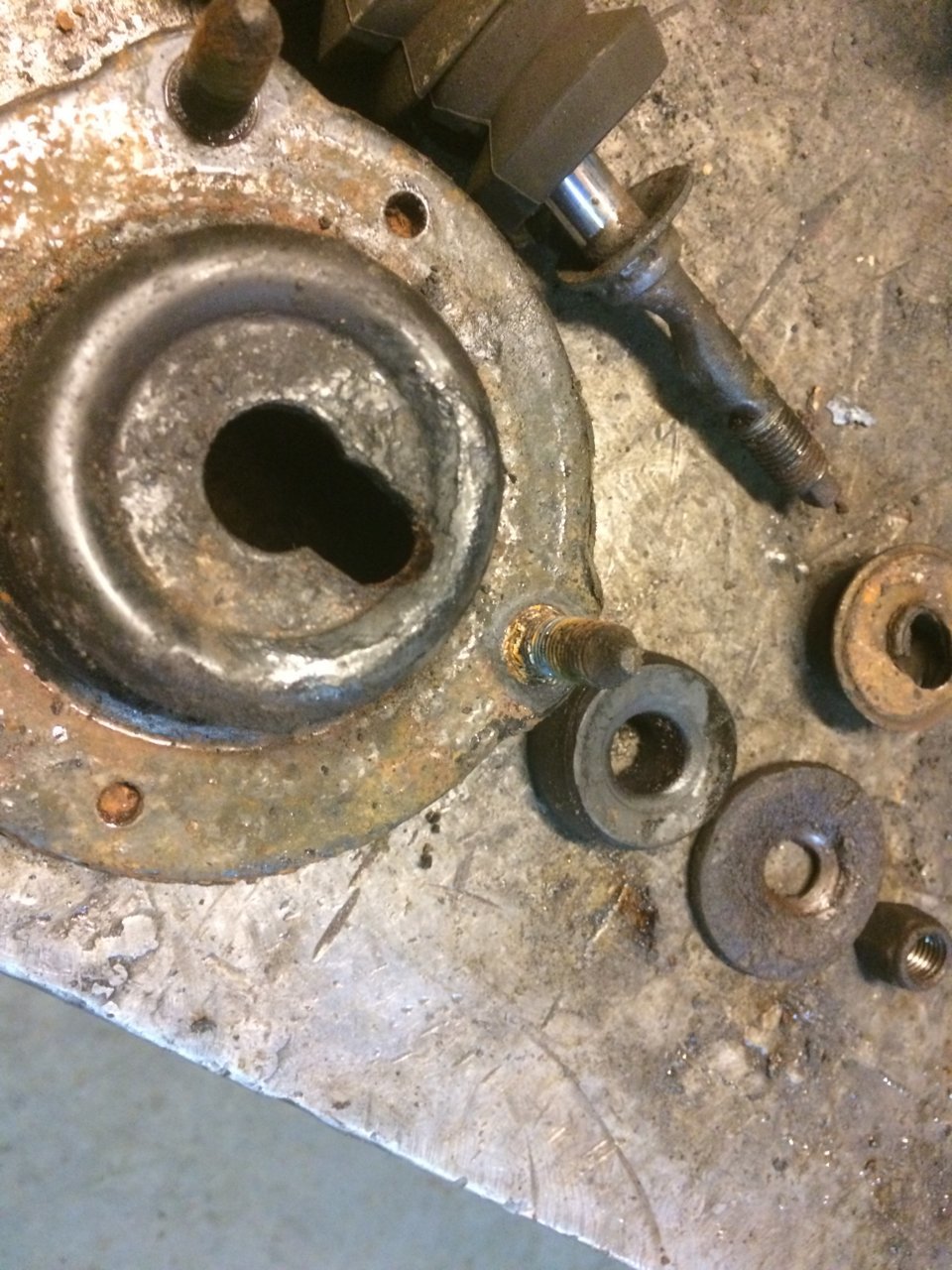

    AGAIN THIS IS NOT MY TRUCK I AM JUST HELPING OUT A GUY IN MY LOCAL TOYOTA GROUP
    BUT THIS IS IMPORTANT
    2005 TOYOTA TACOMA CREW 4.0L
    THIS TRUCK HAD A DROP BRACKET LIFT AND THE GEOMETRY OF THE SUPENSHION MADE THE SHOCK OFF CENTER IN THE SPRING AFTER TIME THE SHOCK SHAFT WORN INTO THE SIDE OF THE SPRUNG CAP AND BUSHINGS. THE HOLE IS NOT SUPPOSED TO BE OVAL !
    THE REASON MY FIRST SPRING COMPRESSOR COULD NOT COMPRESS THIS SPRING WAS TO THE NOTCHED SHAFT HOOKING INTO THE WORN SPRING HAT
    THIS GUY IS VERY LUCKY AS THIS SHAFT IS SEVERELY COMPROMISED

    This was $125 maples and they took back my other spring compressor and credited it towards this one tax in $109 maples
    I bought it at princess auto same as your harbour freight
