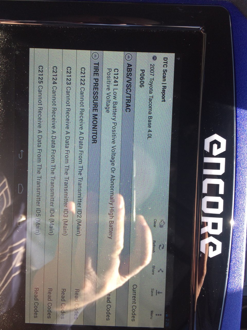

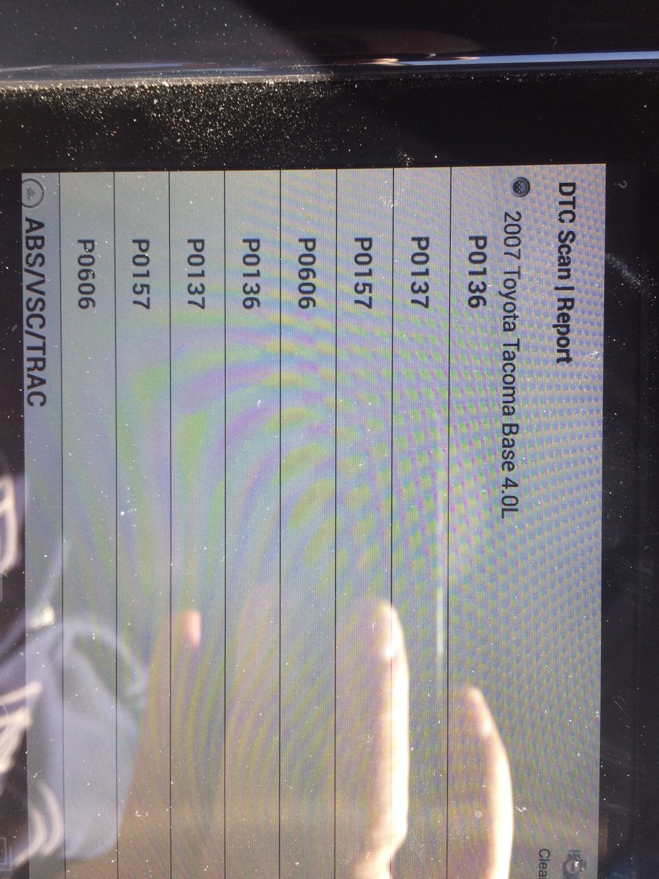

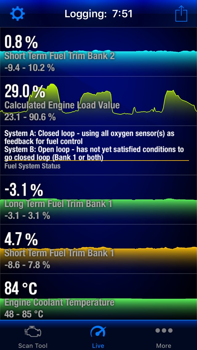

    So in our local Toyota group a friend posted this offer ! A free ODB2 scanner for allowing them to scan your vehicle

    p0606 code(PCM processor fault) = one of the rear o2 sensors is shorted out and back feeding in to the ecu
    P0136 code Oxygen O2 Sensor Circuit Low Voltage-bank 1 sensor 2.
    P0137 Essentially the same as P0136, P0137 refers to the second oxygen sensor on Bank 1. P0137 means the O2 oxygen sensor's voltage remained low for longer than 2 minutes.
    P0157 This code refers to a fault in the post-catalyst o2 sensor on Bank 2. First, a basic run-down of the catalyst: The Catalytic Converter is used to help control tailpipe emissions, to "clean up" the exhaust, if you will. The PCM (Powertrain Control Module) uses the signal from the heated oxygen sensor to the rear of the catalyst to monitor the catalyst's efficiency by comparing it to the o2 sensors in front of the catalyst.
    BUT THE MOST IMPORTANT ONE IS THE C1241 !!!!
    C1241 Toyota Description If there is a problem with the brake actuator assembly (Skid Control Electronic Control Unit) power supply circuit, the skid control ECU outputs the Diagnostic Trouble Code (DTC) and prohibits under the fail safe function. If the voltage supplied to the terminal is not within the DTC detection threshold due to malfunction in such as the battery and alternator circuit, this DTC is stored.

    The above information was what it pulled from the 007 Taco Pro :)
