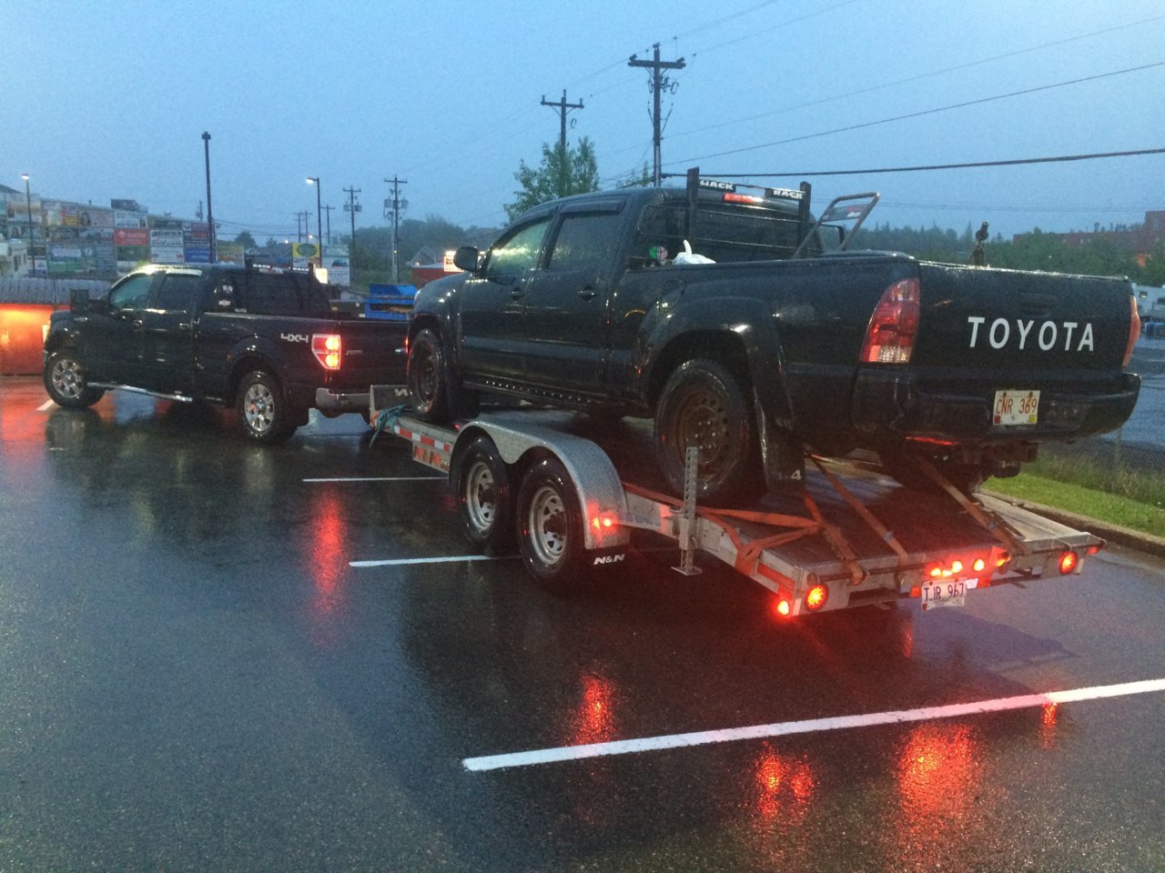

    007 Taco Pro never made it home under its own power after the :canada: Day long weekend.
    We started to smell gas after leaving the cabin, the gauge was dropping really fast but the truck was running fine. Stopped for supper and to investigate the smell of gas, looked under the hood no signs of leaking. With the truck off it’s not leaking, start it up and it is leaking really fast. So this tells me there is no hole in the tank as it would leak with the truck off. Once running the gas pours down the side of the tank, but truck runs fine. So this would mean it is a fuel line issue or a sending unit. With the truck running and not starving for fuel it would be the return line to the tank or the fitting has the problem
    Brother in law came and rescued me and a fellow cabin owner towed my trailer in for me :)
    So expect to see a flood of 007 BS and me swearing in the up days
    I could NOT take the chance on driving it back spilling fuel with my family in the truck and Baby P in the back. He LOVES the z50 !!!!
