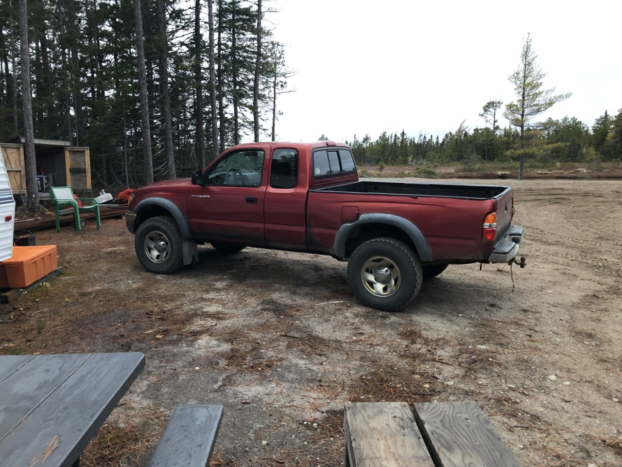

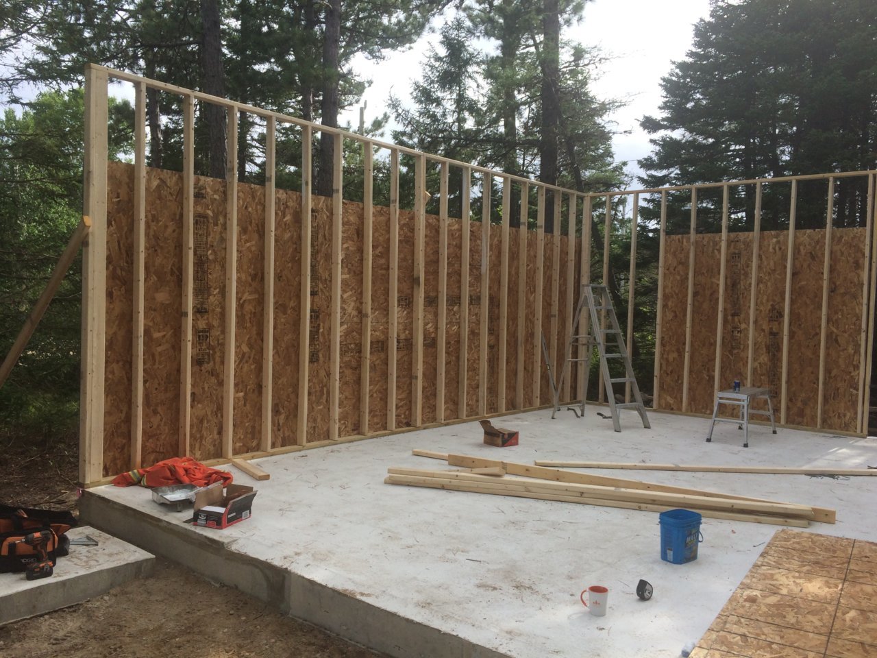

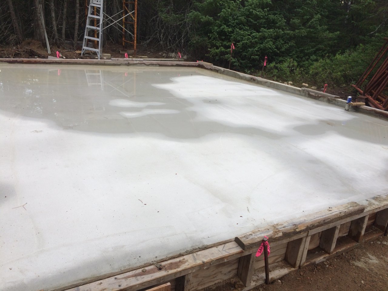

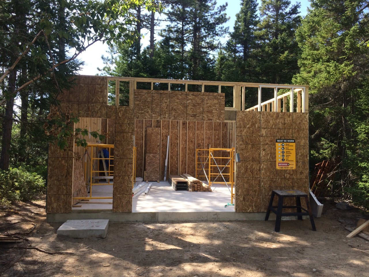

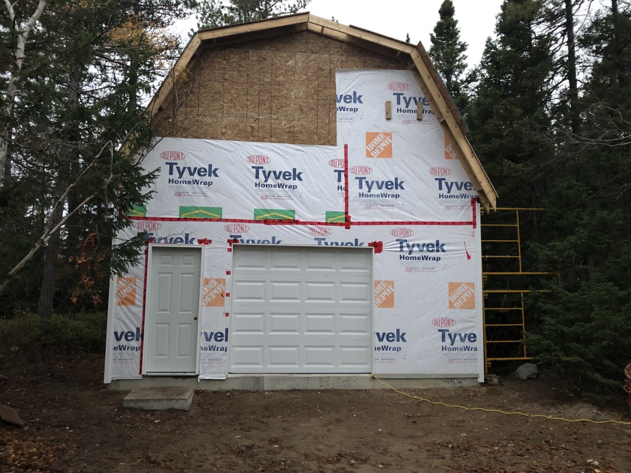

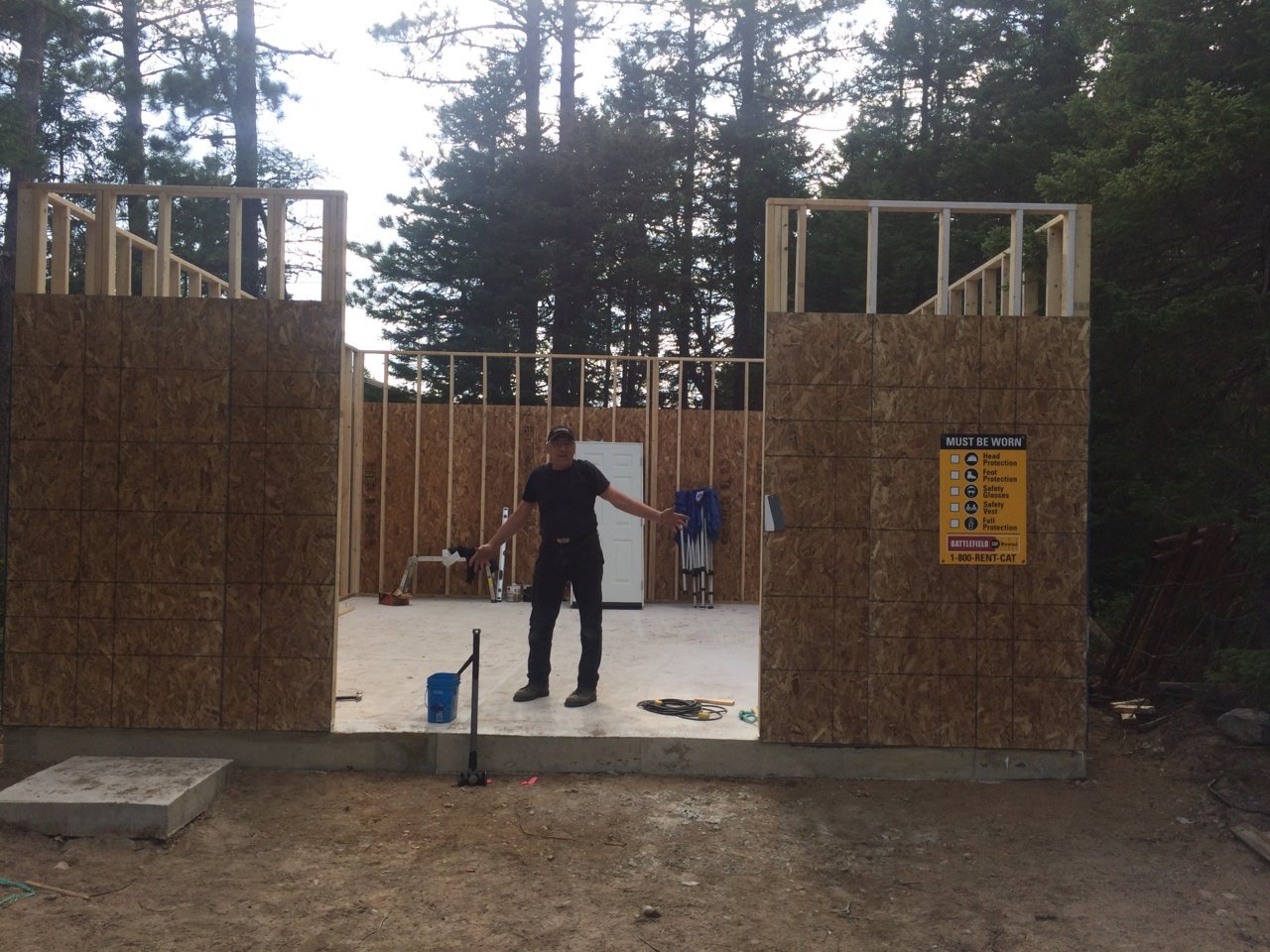

    This is where my 20x24 garage at the cabin is as of today :) still lots of work to be done before winter
    I drove my 2002 Tacoma after sitting for two years three hours to store in my new cabin garage so I can slowly restore it. 929705B8-6DCF-479C-8AAA-E6B5990B50BA.jpg2E245D37-C61E-4121-B301-77CA05FFDF78.jpg

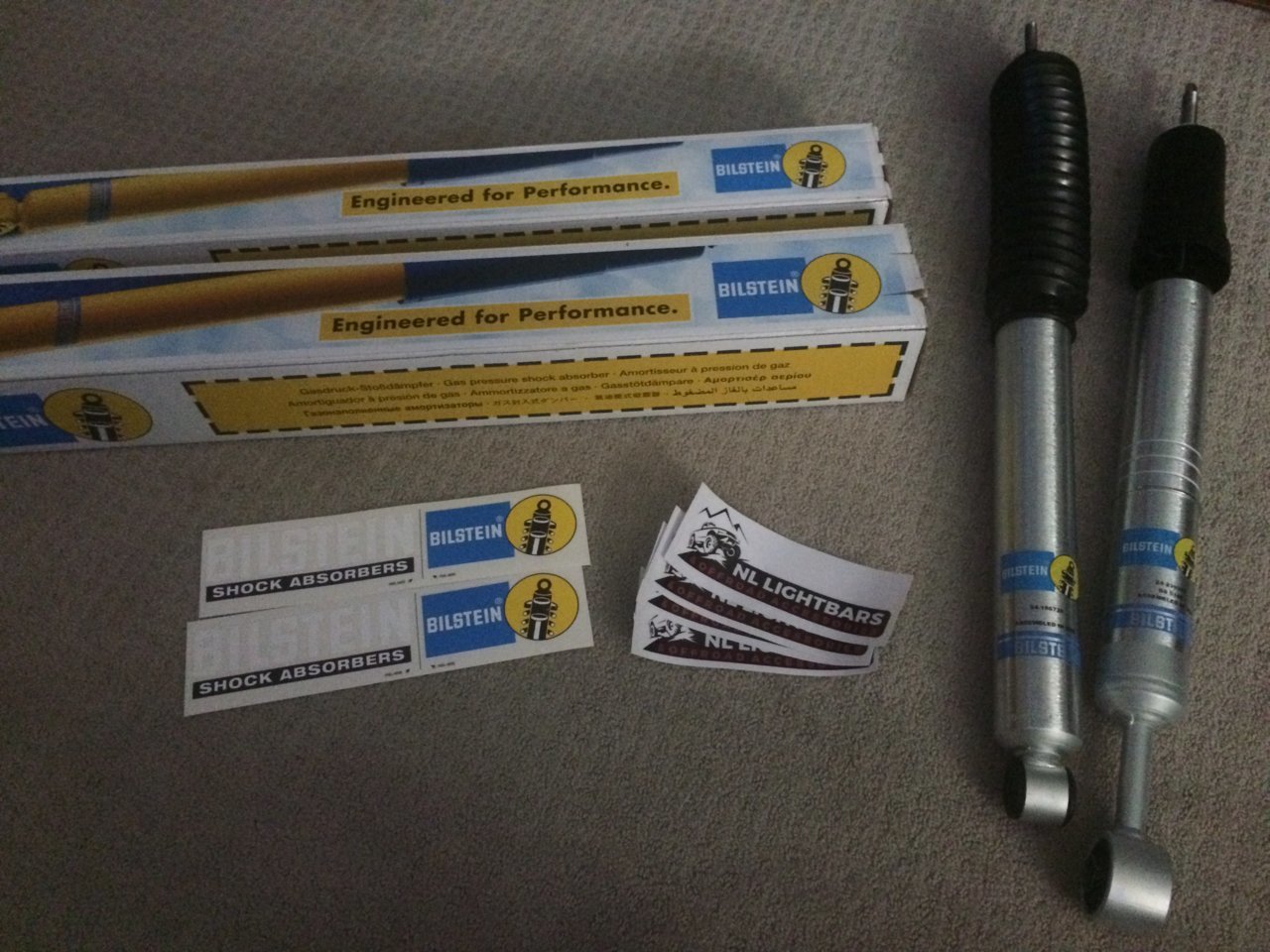

    5100 billsteen set to 2.5”

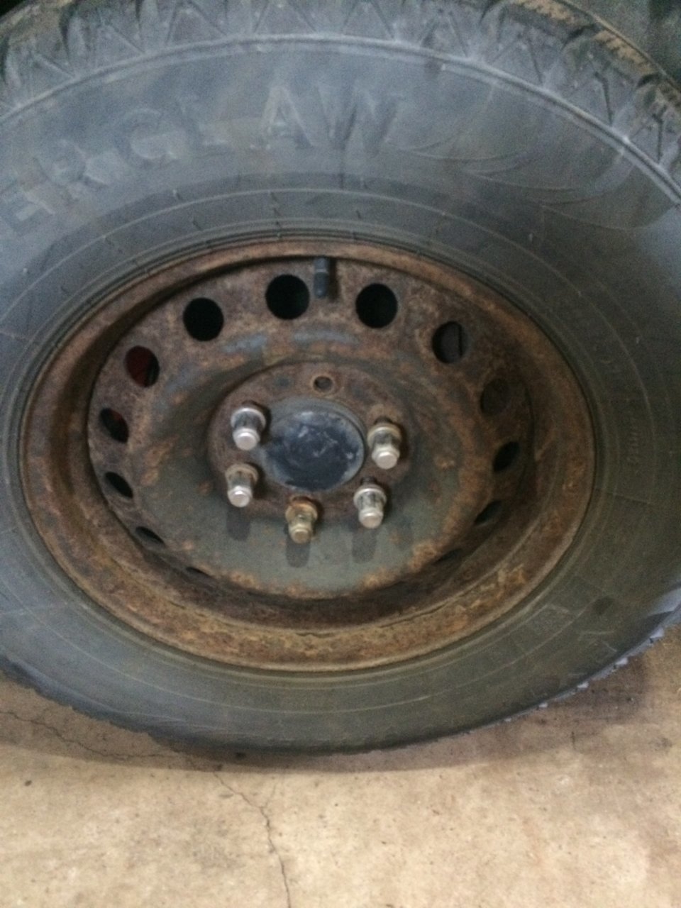

    Rear billsteen 33AFDEAF-3B38-4F73-B156-09EE53A05447.jpg838923AF-8FEF-43B3-BB88-9EA42D7137DF.jpg78CD05A5-AB63-403C-99C5-7E9C931948C6.jpgCB406D46-274C-489C-A66F-B06EB23E8BAE.jpg

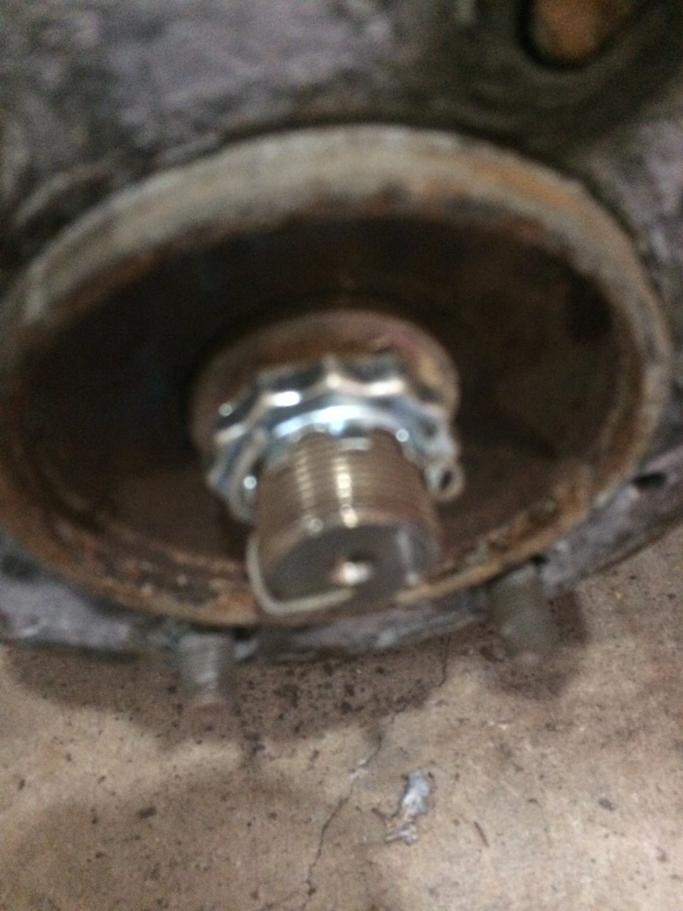

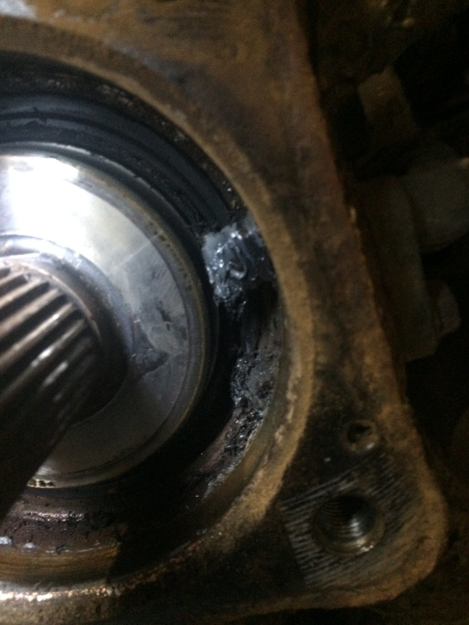

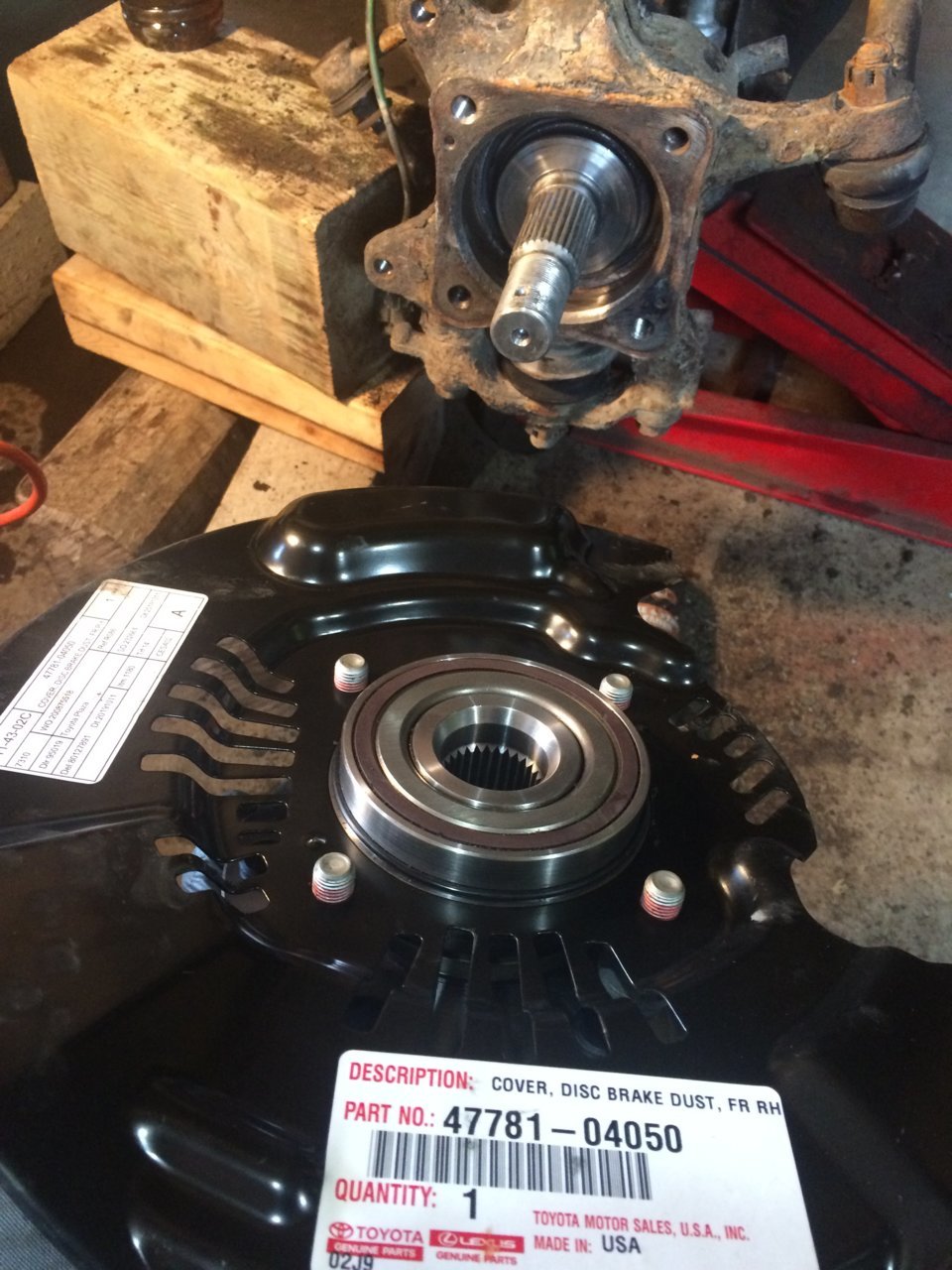

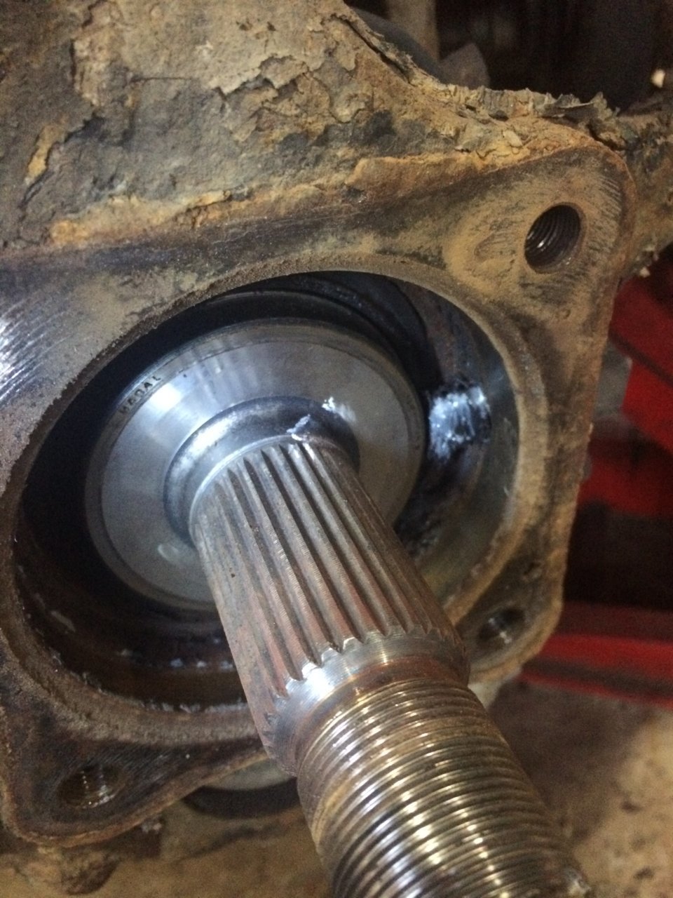

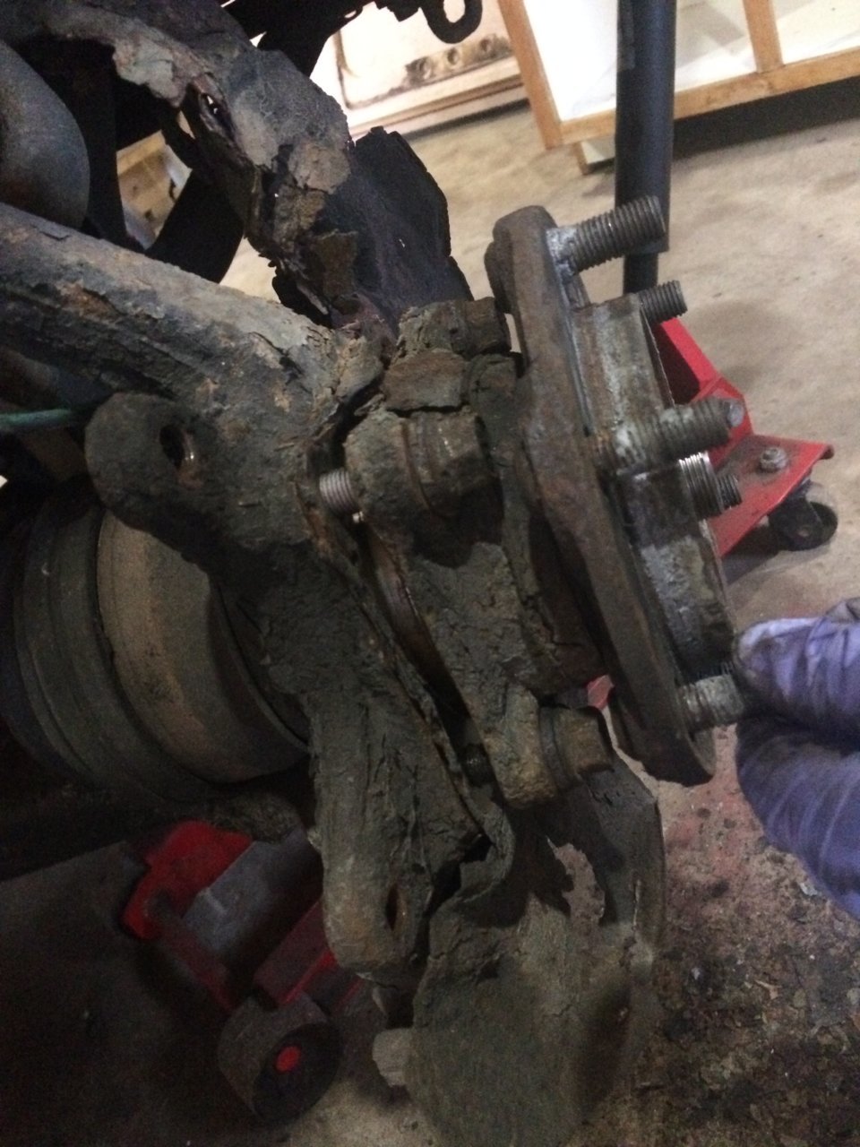

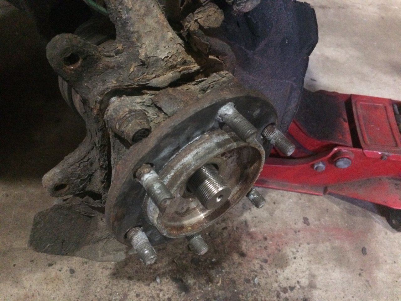

    Bearings were growling and the geese had come out onto the abs wheel sensor. Bought a bearing hub kit and I would recommend doing this over pressing in a new bearing

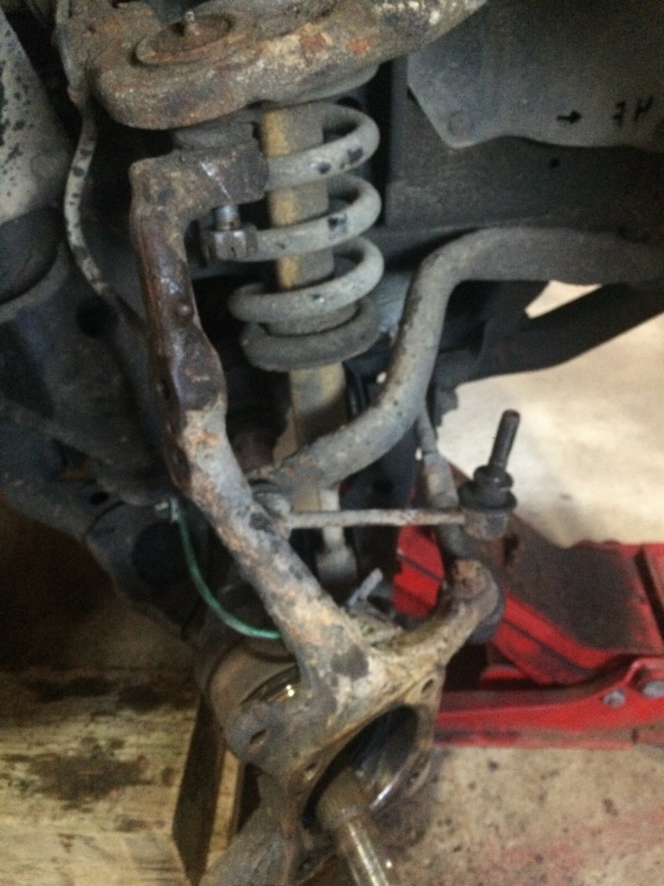

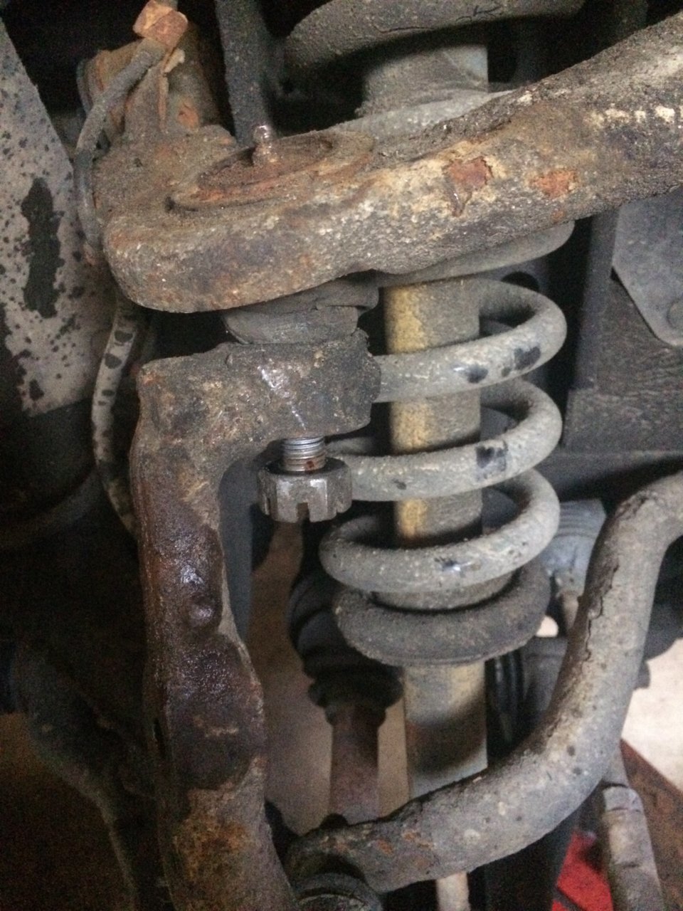

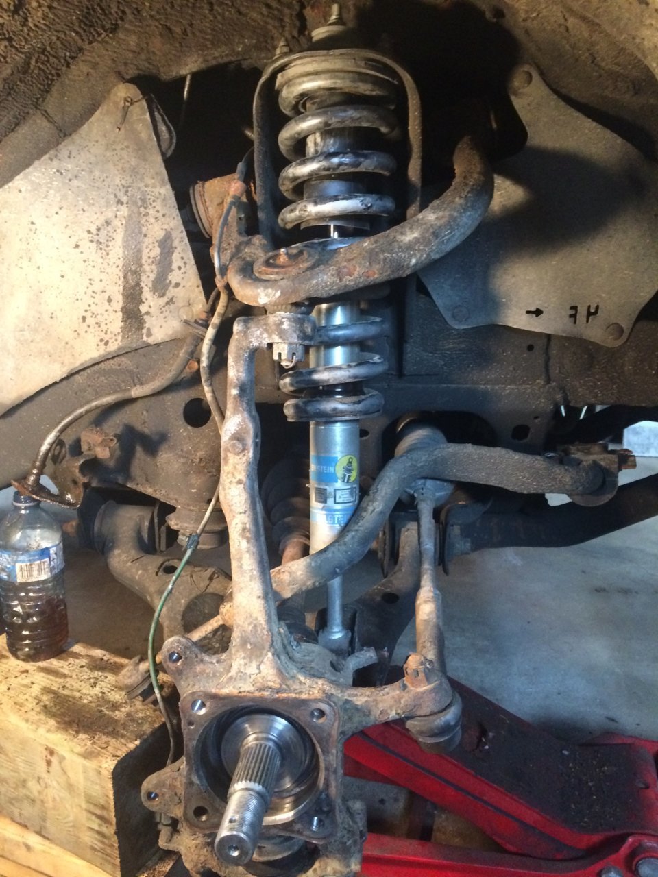

    D440B8A2-3D31-4761-9F19-D38ADA730520.jpg 788D8470-AE0E-43CD-B2DA-693030BCE091.jpg A98037A9-DEE6-433D-8237-778B2A55F202.jpg 6555CEAD-4ECD-4BD8-AA13-42F36DD2F4D4.jpg AC9C753E-38FE-434B-928D-EEF2F868ABD5.jpg
    Tacotj likes this.

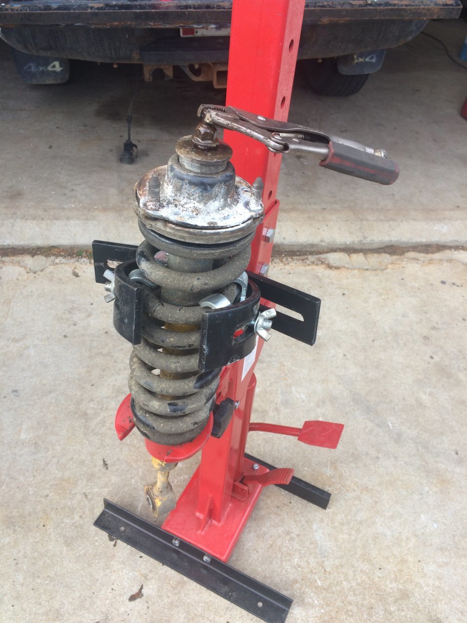

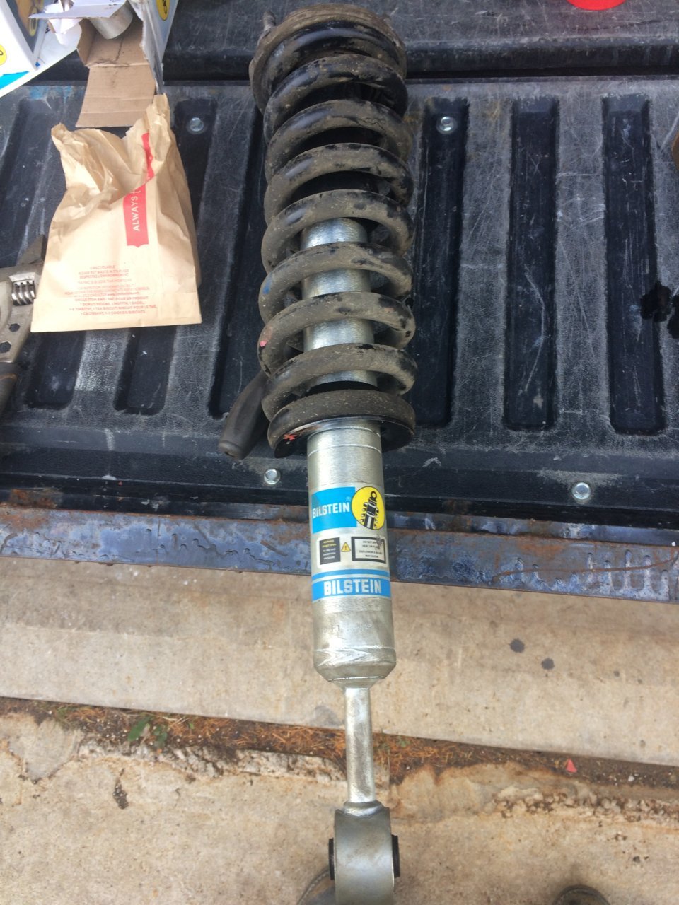

    I separated the upper ball joint and took the sway arm links out to gain easy access to the shock. Once out I compressed it in my princess auto (harbour freight) for Canada strut compressor. Installed the new 5100 set at MAX lift and reinstalled. I put new seals in the spindle poked the cv axel back through and reinstalled the ball joint

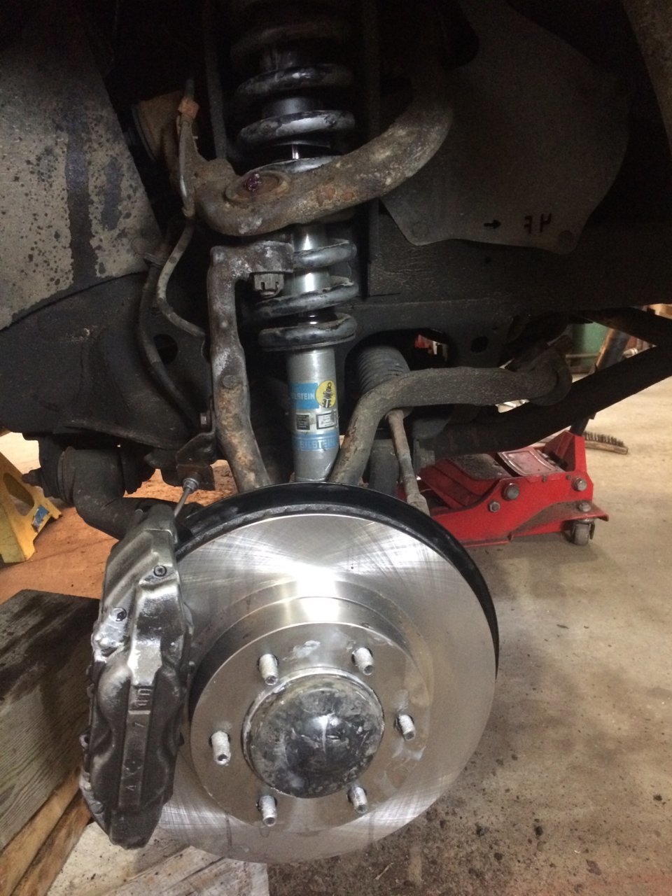

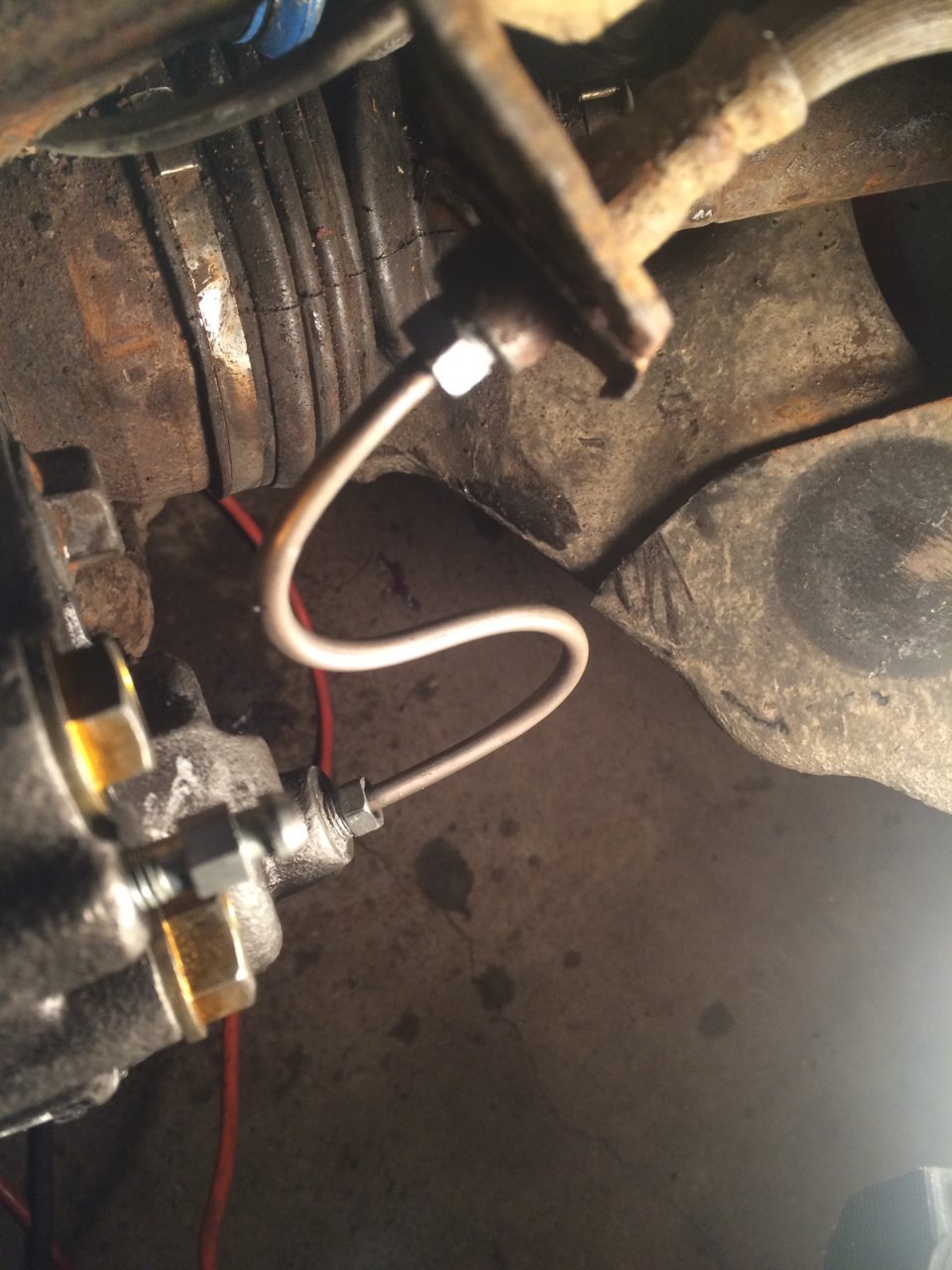

    New bearing and backing plate, install cv axel nut and install new brakes
    Had to bend up the stupid hard line
