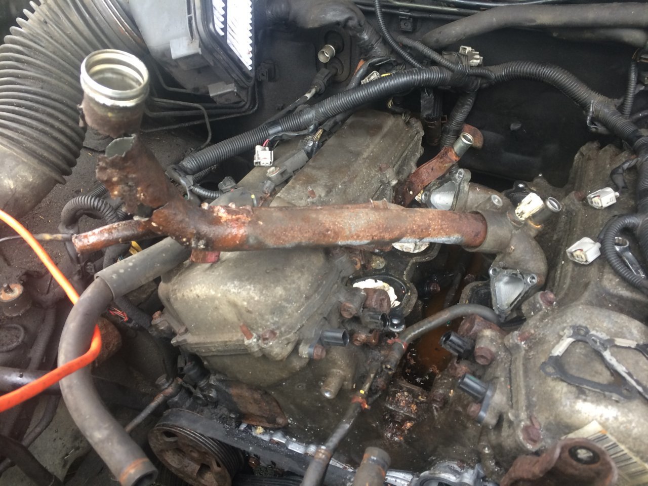

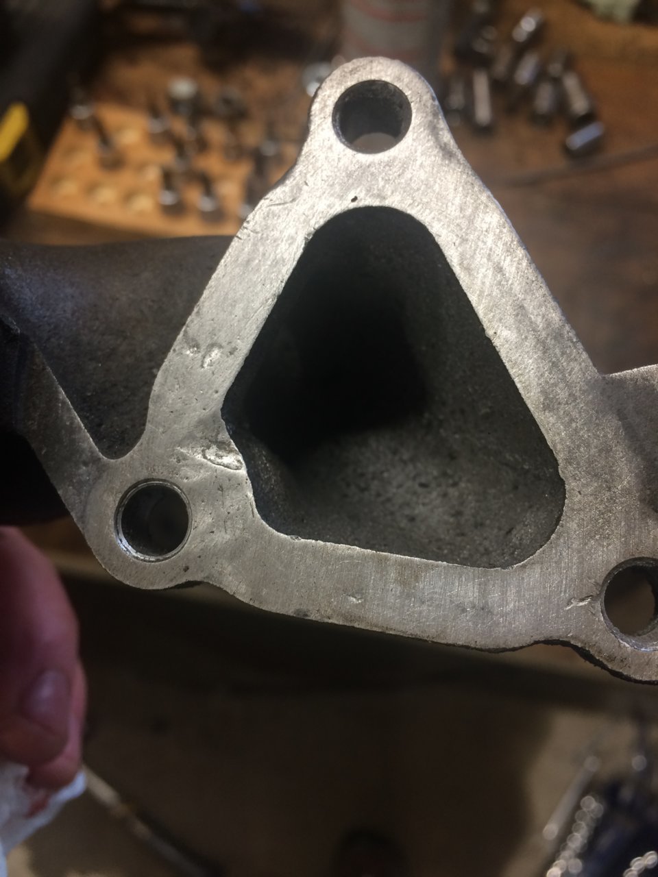

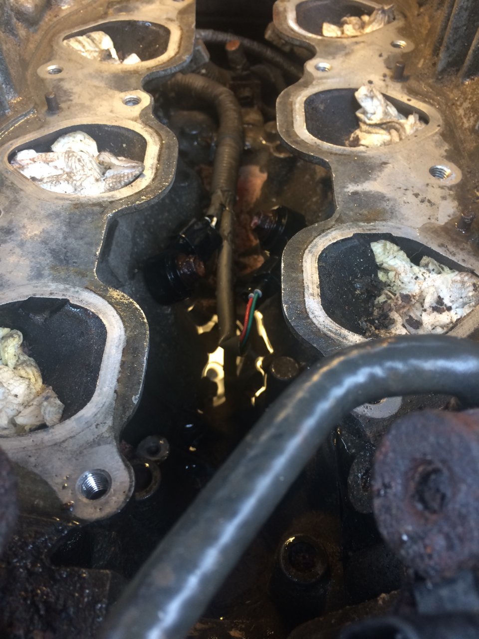

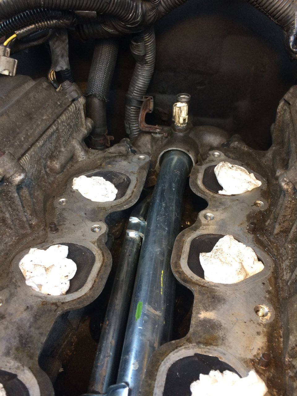

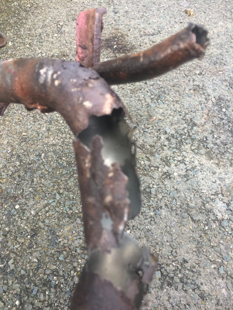

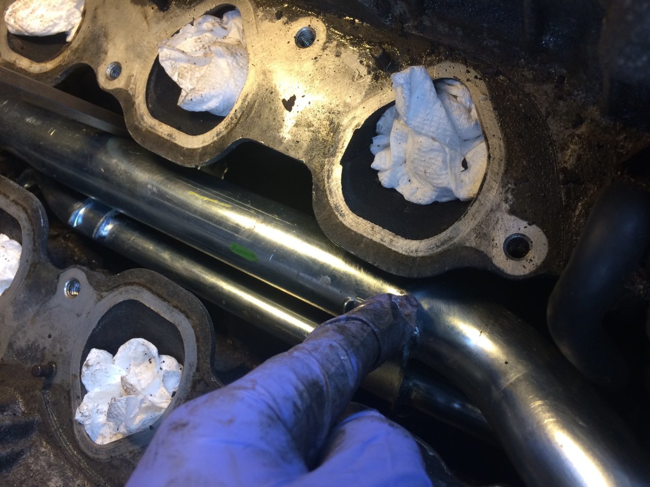

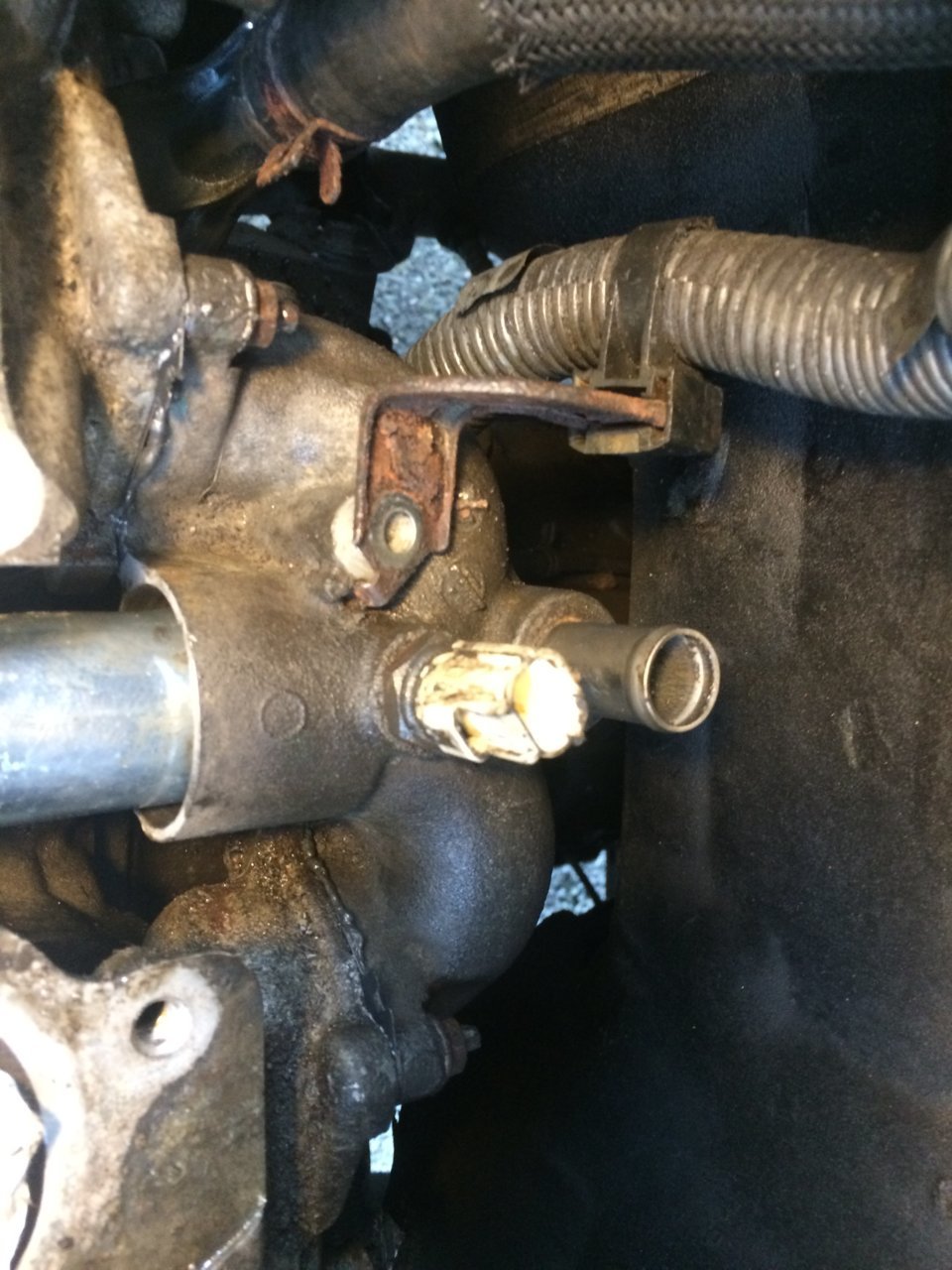

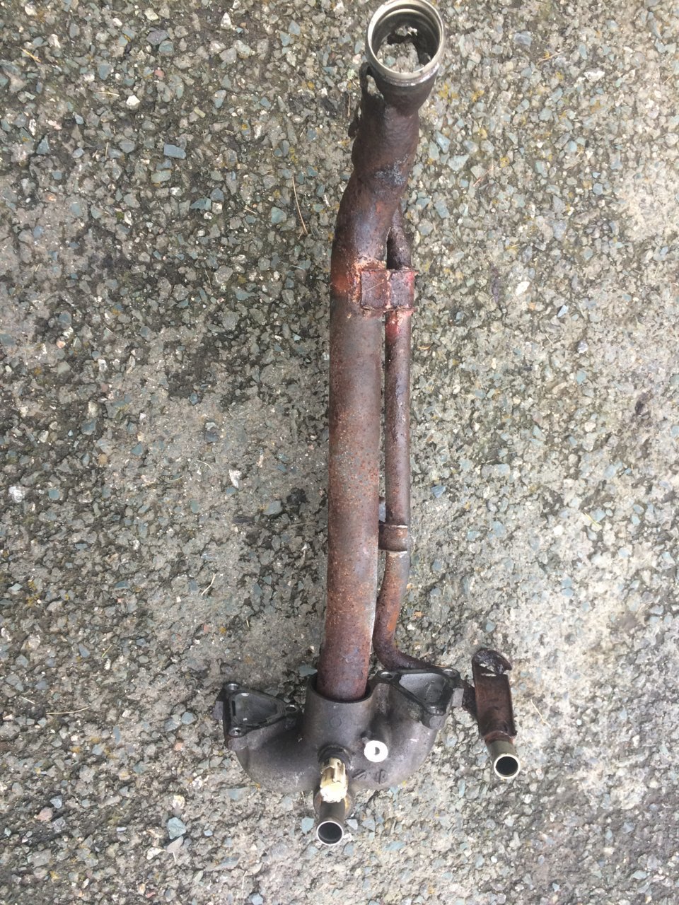

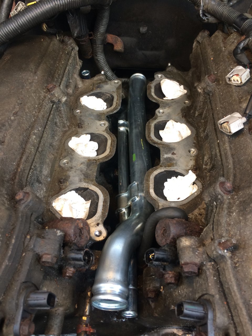

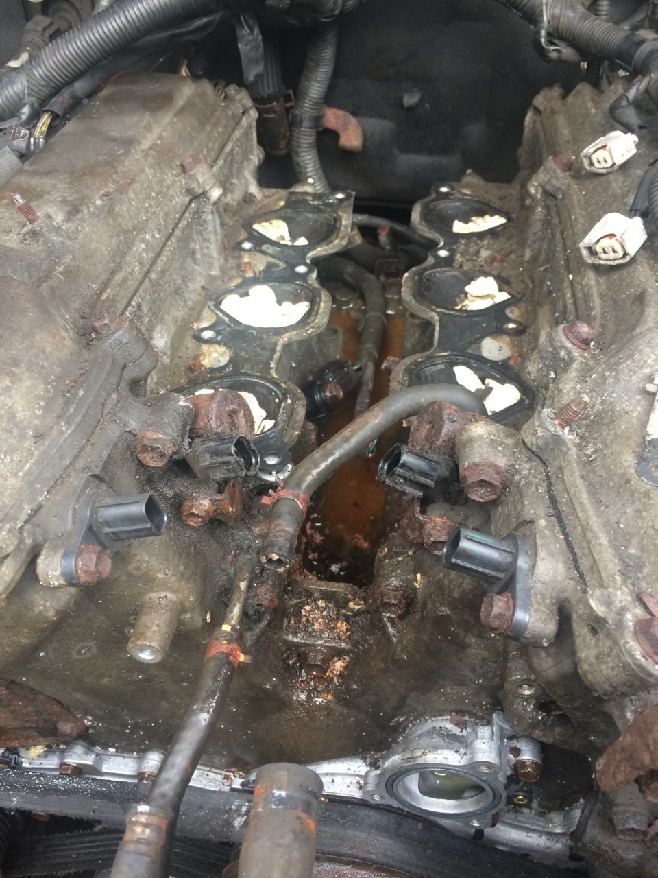

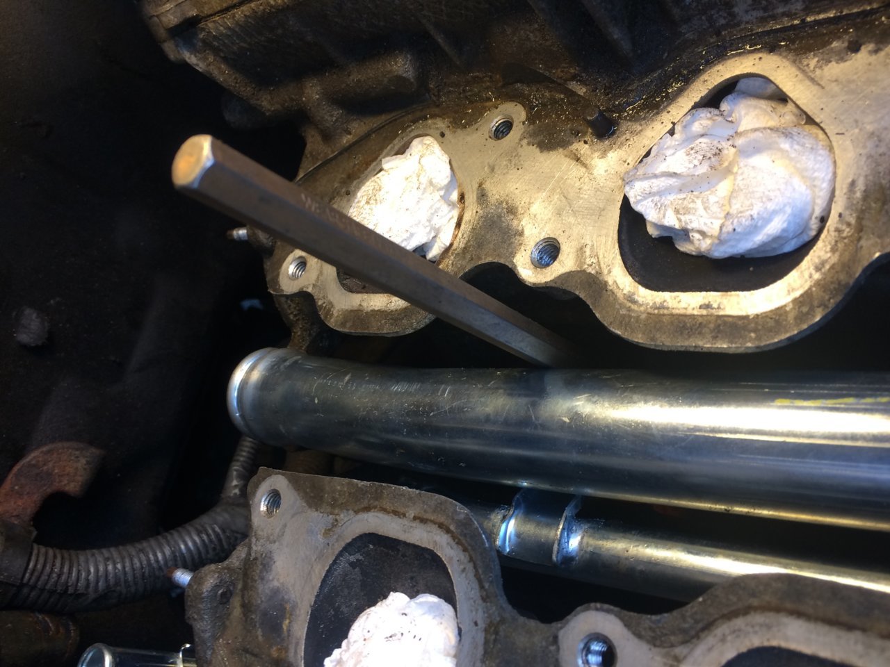

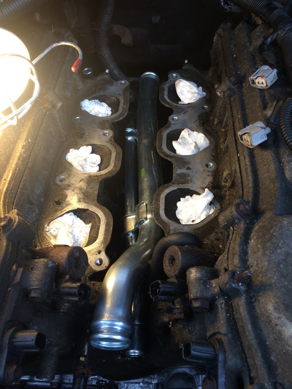

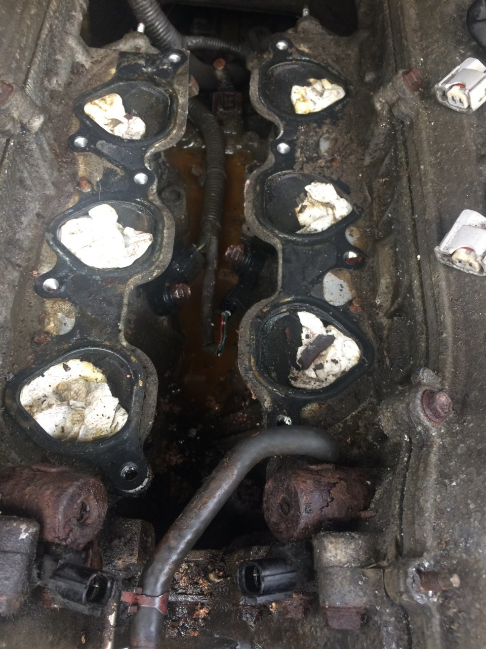

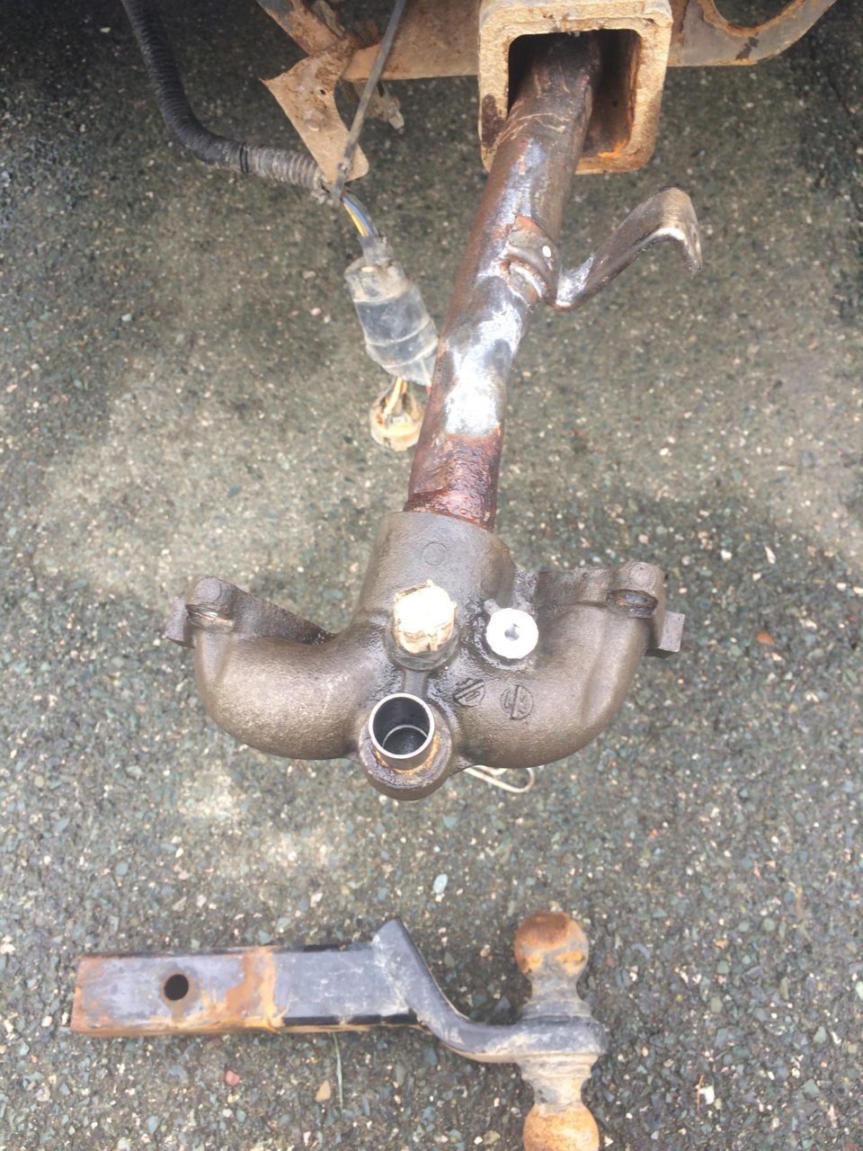

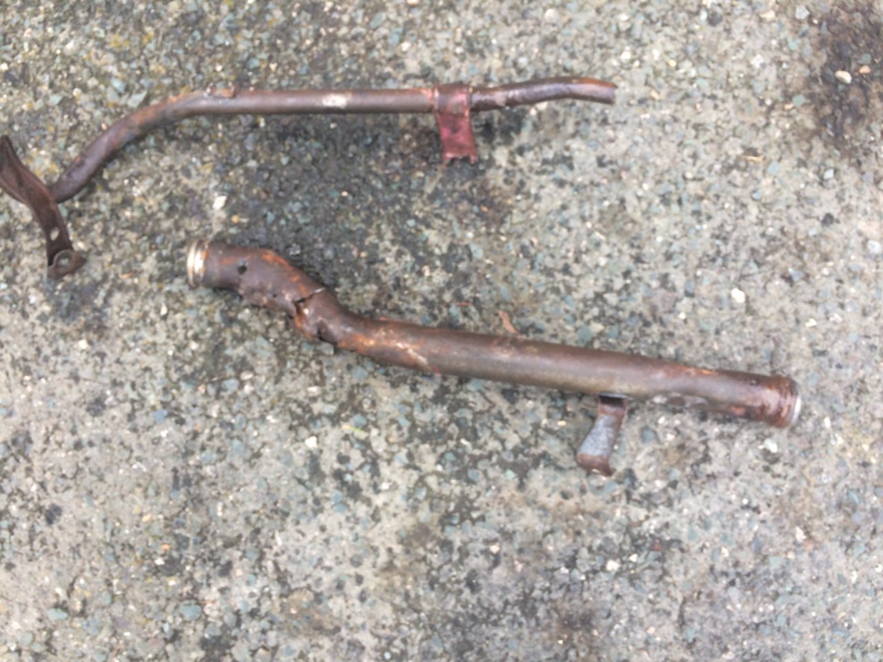

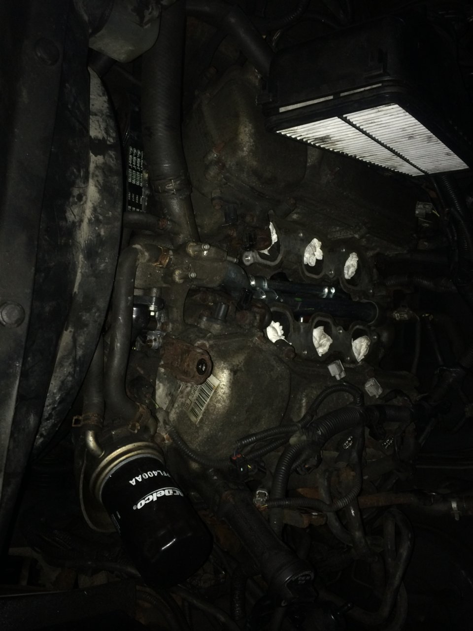

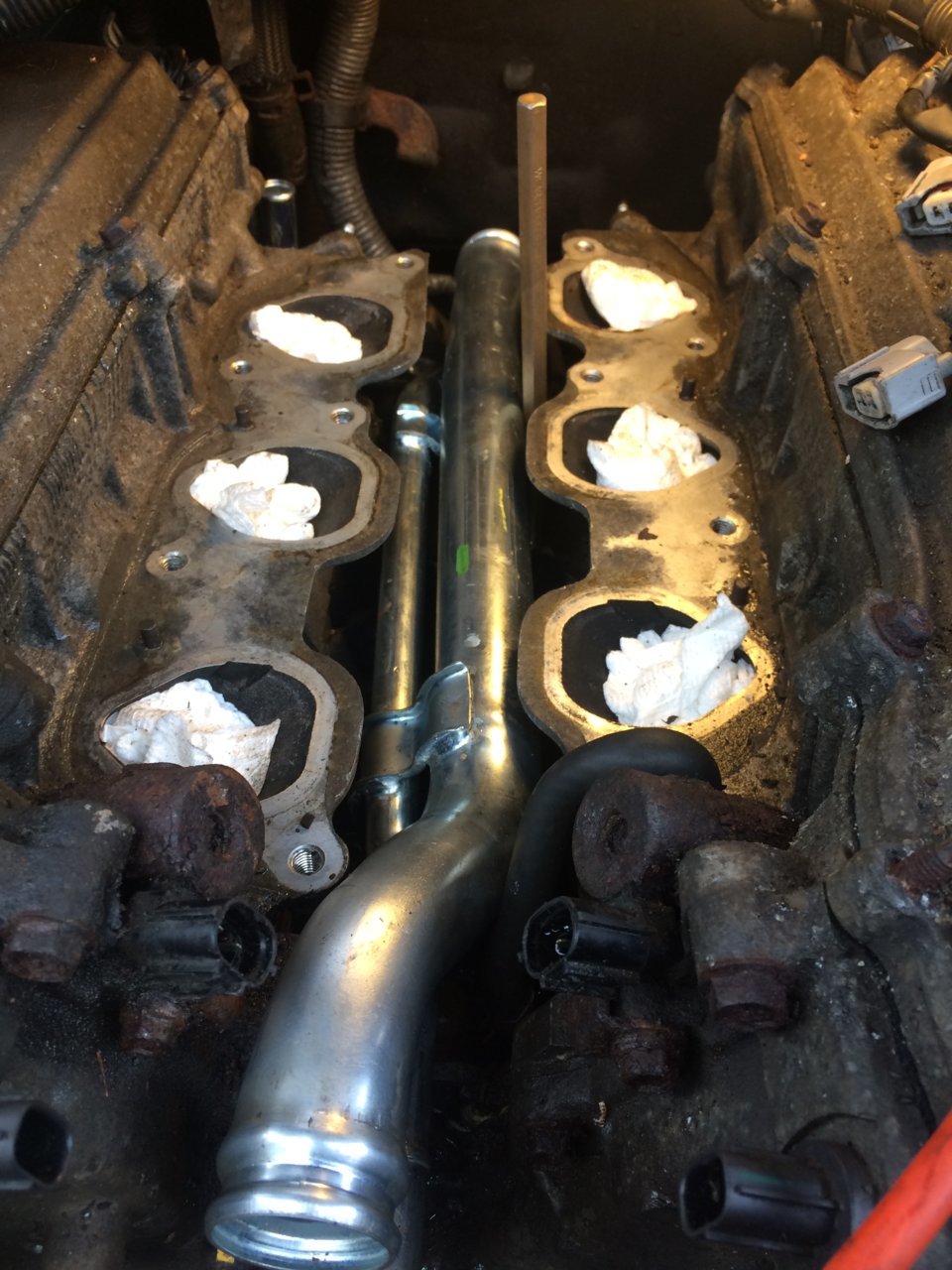

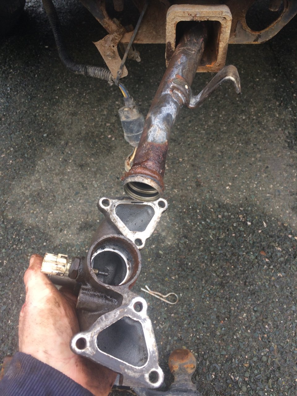

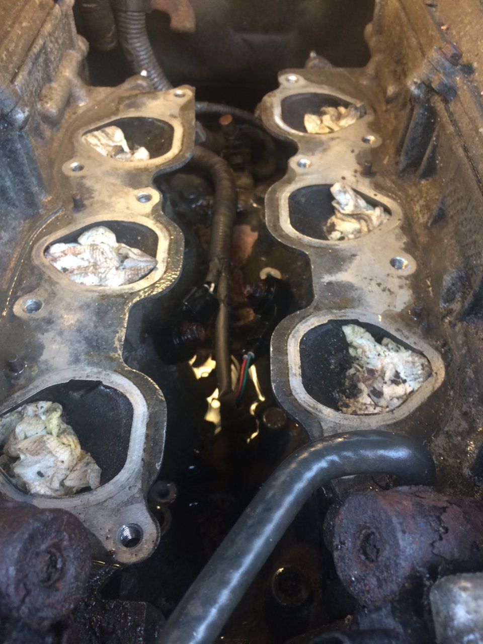

    The Fsm says you need to remove the head and to do it 100% the right way
    But this was not a route I wanted to go down as it is a huge job as most of if not all the components on the front of the motor need to come off as the timing cover needs to come off for the chain. Then the cam then the head and with 436000km it would turn into a can of
    My pipe was so rotted that I took the bolts out and was able to twist it to get it out. I stuck a pry bar in the pipe and bent it the old one.
    Putting the new one in is tricky I bent the mounting tabs to allow the pipe to be placed in. I also used a pry bar to finesse it into its location. This put a small dent on the new tube under here [​IMG]
    If I had my time back I would of bent the small pipe closer to the big pipe on the front as a hose only goes over it. Do not deform the ends just a light bend
    I used a punch to put in the hole of the bent bracket to straighten it to the proper location and slid the punch into the bolt hole in the block.

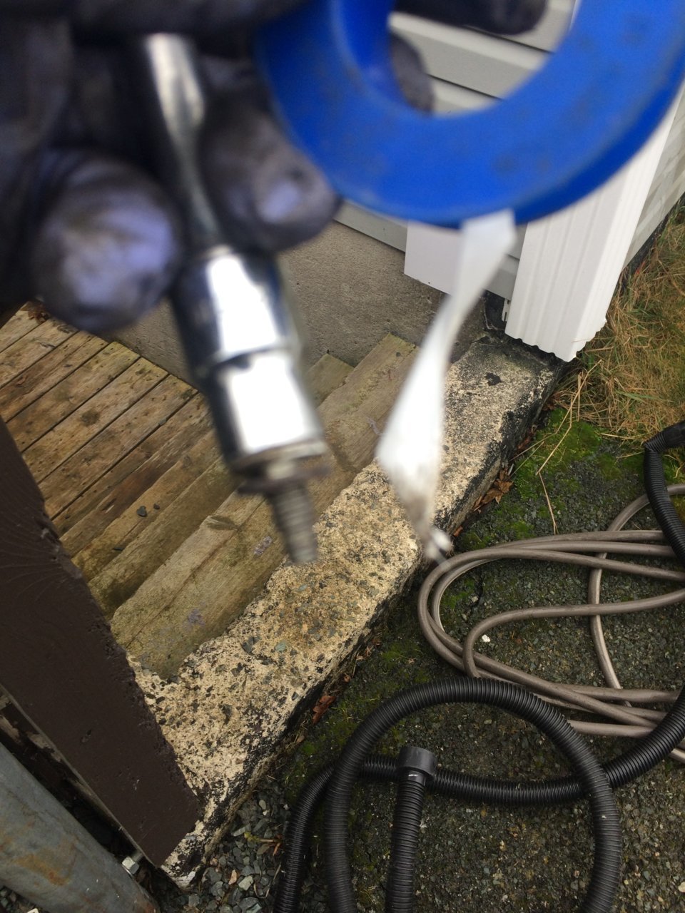

    I also used some plumbers tape to wrap the heads of a few bolts so they would stay in the socket
    Would I do this again 100% yes !

    Nice work. EF41940E-A64D-4D4C-8E80-952D2855A812.jpgThat’s how I would do it.
