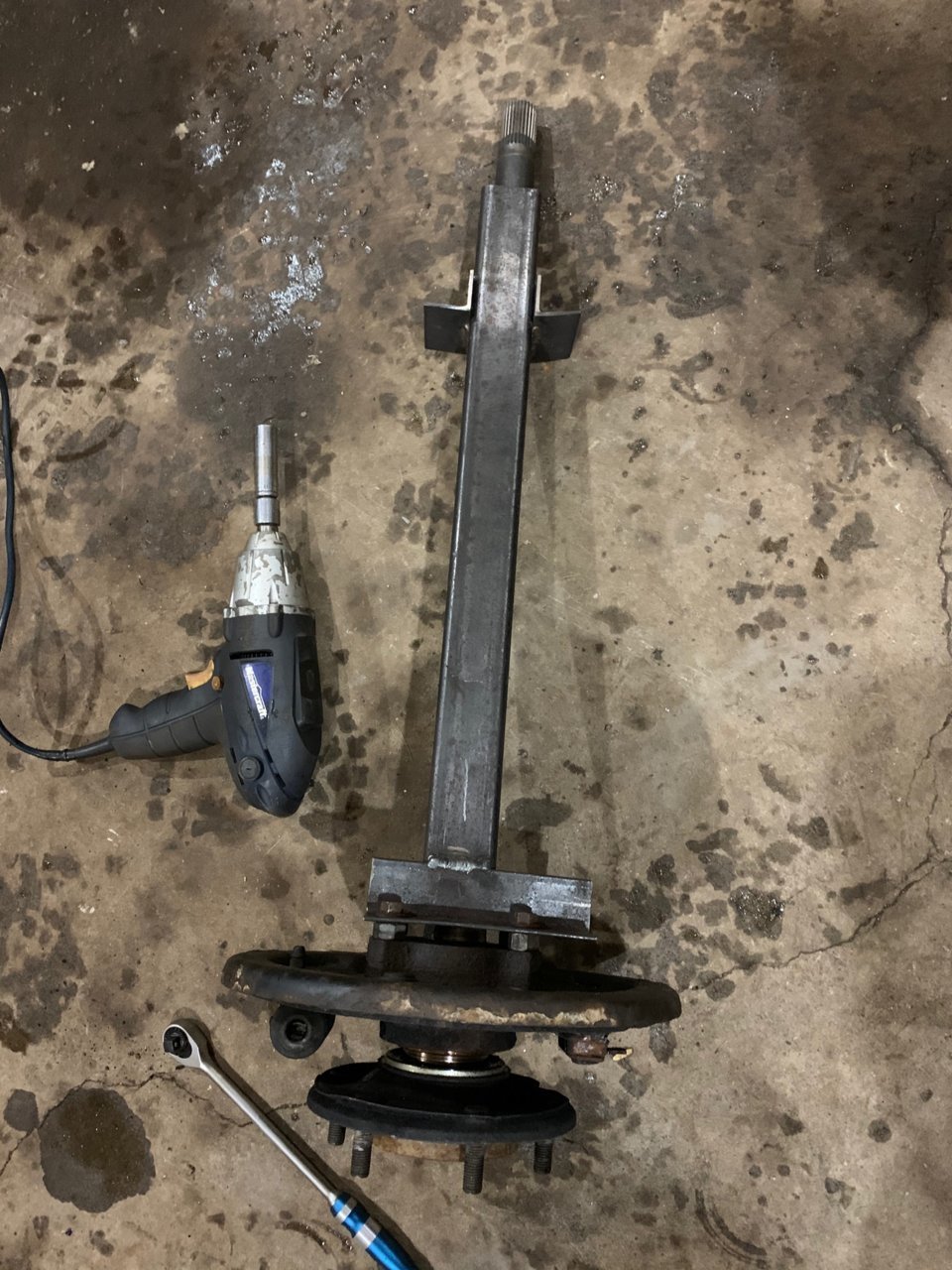

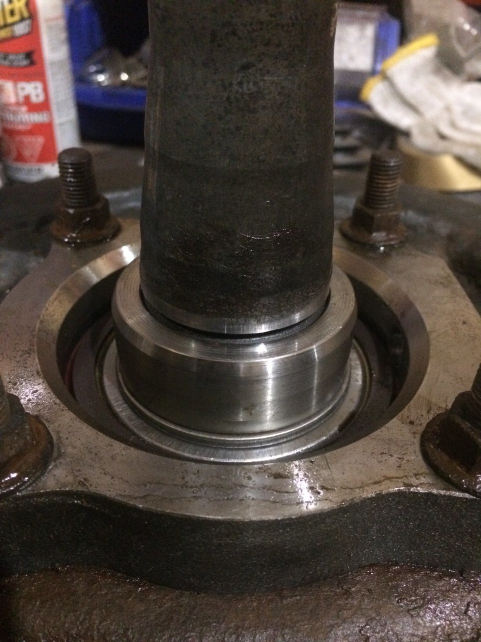

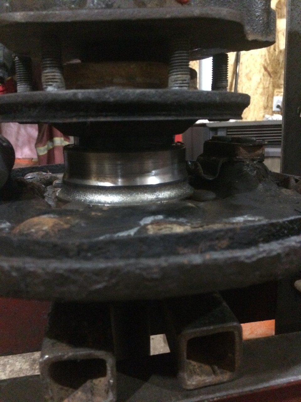

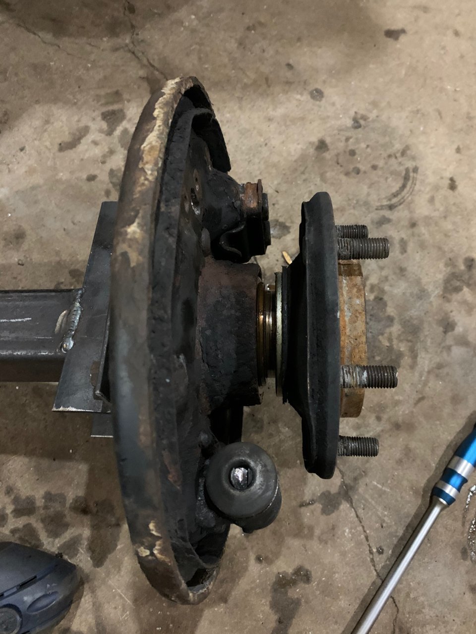

  8. Dec 17, 2020 at 7:55 PM
    #1208
    Jon G
    Jon G [OP] Hoarding Tacomas one at a time,
    Jan 25, 2017
    #208594
    1,851
    Jon
    St John's Newfoundland Canada
    02, 04 & 07 Tacoma
    Magnaflow 2.5 Catback Exhaust K&N filter

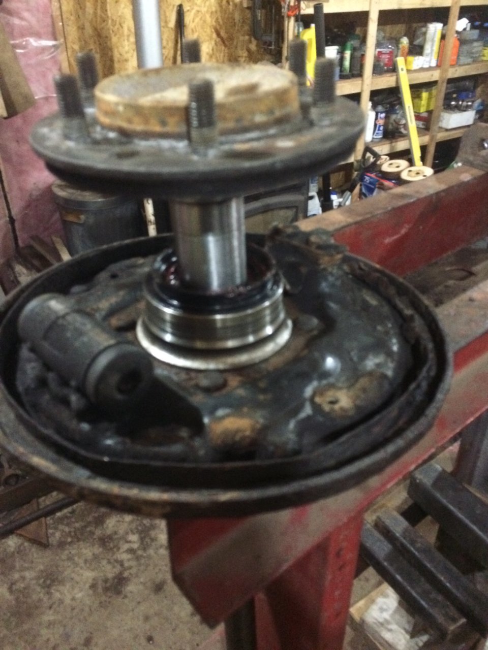

    Bearing washer convex goes away from bearing, sleeve otter taper away from bearing, bearings are side specific due to abs sensors. Drivers abs is in-front of axel, pas side abs is behind axel.
