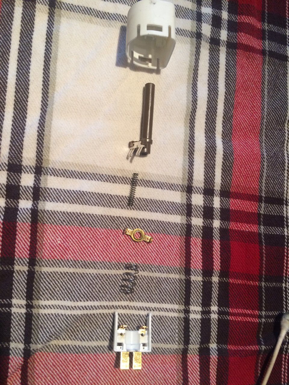

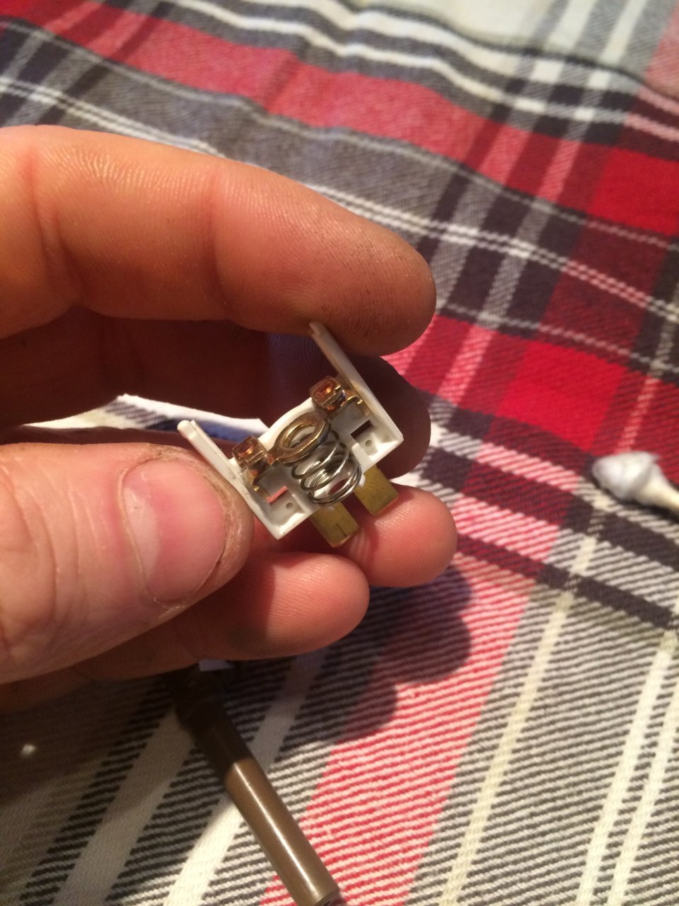

    soooo
    I bled the brakes 3 times with a fair amount of driving in between every time. Got air each time. I think air gets trapped in the abs unit. Will bleed again in a week or so. Pedal is way better.
    My abs light is on I pulled the code and need all new sensors
    My red brake light is on fluid is topped up and hand brake is off. I disconnected the fluid sensor and the hand brake but the light did not go off. It’s possible the Sensor float is stuck.
    The loss of throttle is still happening so when it does happen I pull up on the brake pedal and throttle comes back. I took the brake switch out and cleaned up the contacts.
    Fingers crossed

    Don't know if it will help but try this,
    get up to 35,40mph on a slippery road or gravel and stomp on the brakes making the ABS cycle to try and push the air out. Then bleed again.
    wasn't a fix-all but helped when my brakes were messed up.

    Did you get this throttle issue cleared up with cleaning the switch? I am having throttle loss too and my brake lights stay on at time until I wiggle the pedal.
    Jon G[QUOTED][OP] likes this.

    @Micatom33
    It hasn’t happened since knock on wood !

    @Micatom33 very simple to do let me know how you make out with it

    Well got to drive about 80 miles today and no throttle loss issues after adjusting the switch;)
    Jon G[OP] likes this.

    @Micatom33 did you take it apart or just adjust it ?
  19. Jan 7, 2021 at 6:19 AM
    #1239
    Micatom33
    Micatom33 Under the Truck with Beer!
    Jul 17, 2013
    #108443
    1,673
    Santa Cruz,CA
    2008 BSP DCSB
    just adjust also ordered a new one just in case
