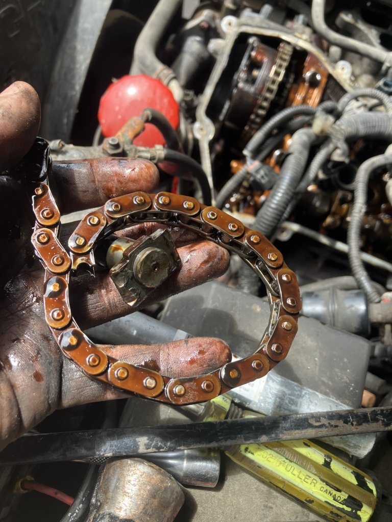

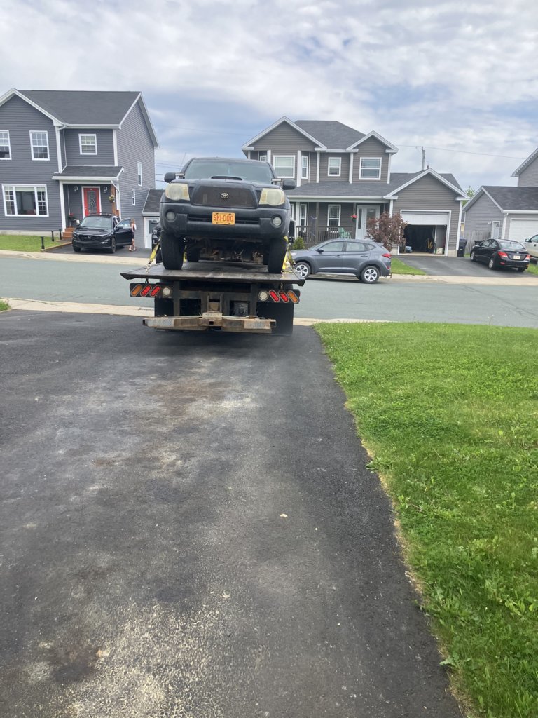

    It goes down hill from here :( IMG_7694.jpg IMG_7703.jpg IMG_7705.jpg IMG_7707.jpg IMG_7709.jpg IMG_7712.jpg

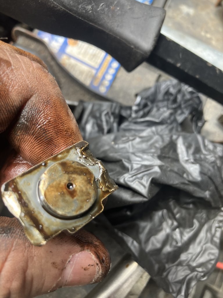

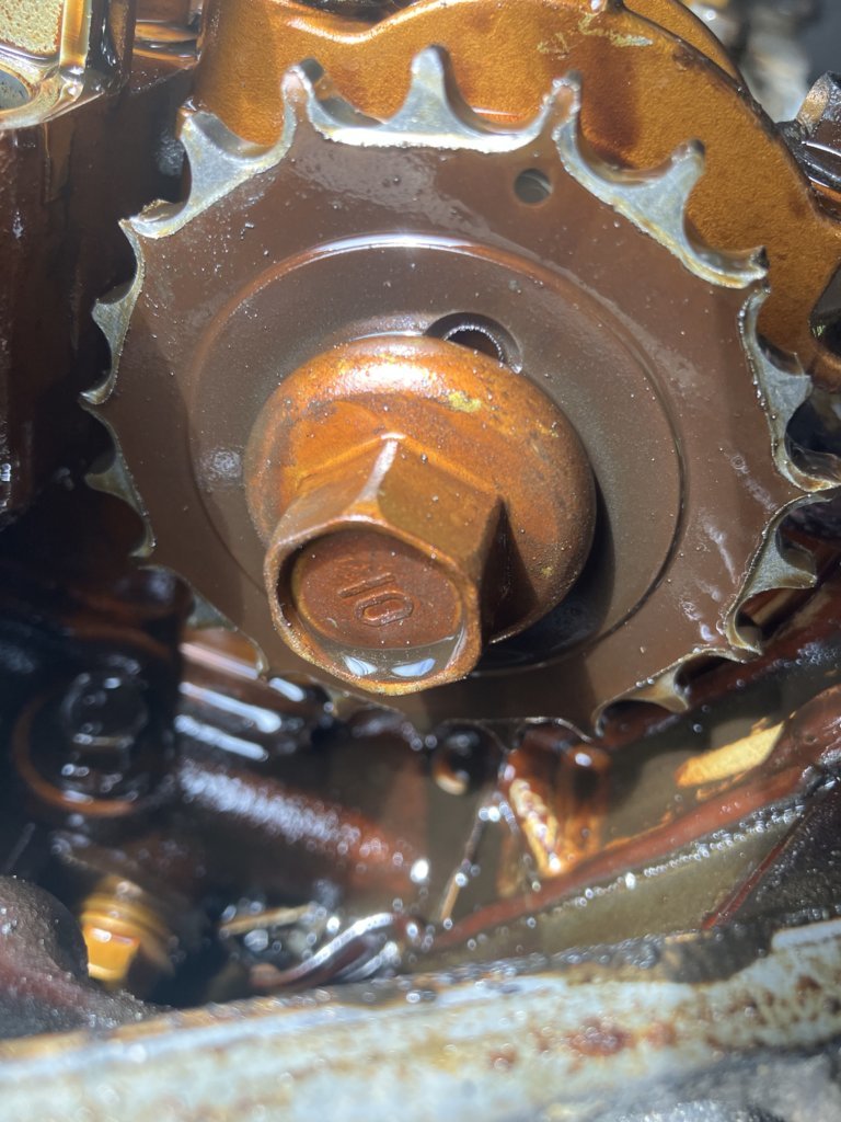

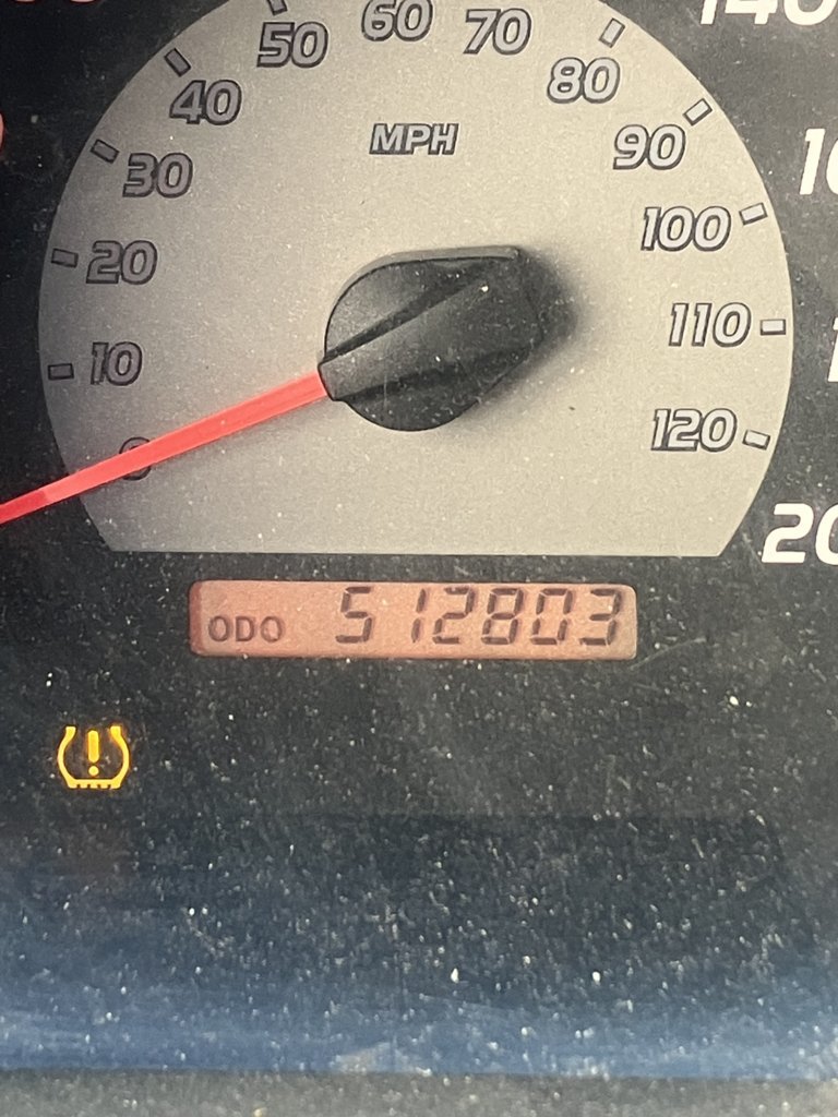

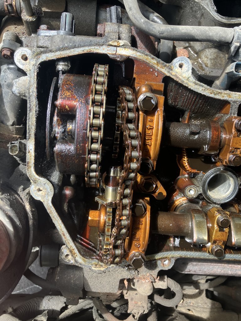

    So with 512803 km the motor finally packed it in. There are three cam chains on the 4.0L motor one main, then two small ones on each bank of cylinders that goes from the intake cam to the exhaust cam vvt phaser. There was always a tick on the drivers side of the motor, this tick was the lack of telflon on the hydraulic cam chain tensionor and the chain riding on it.

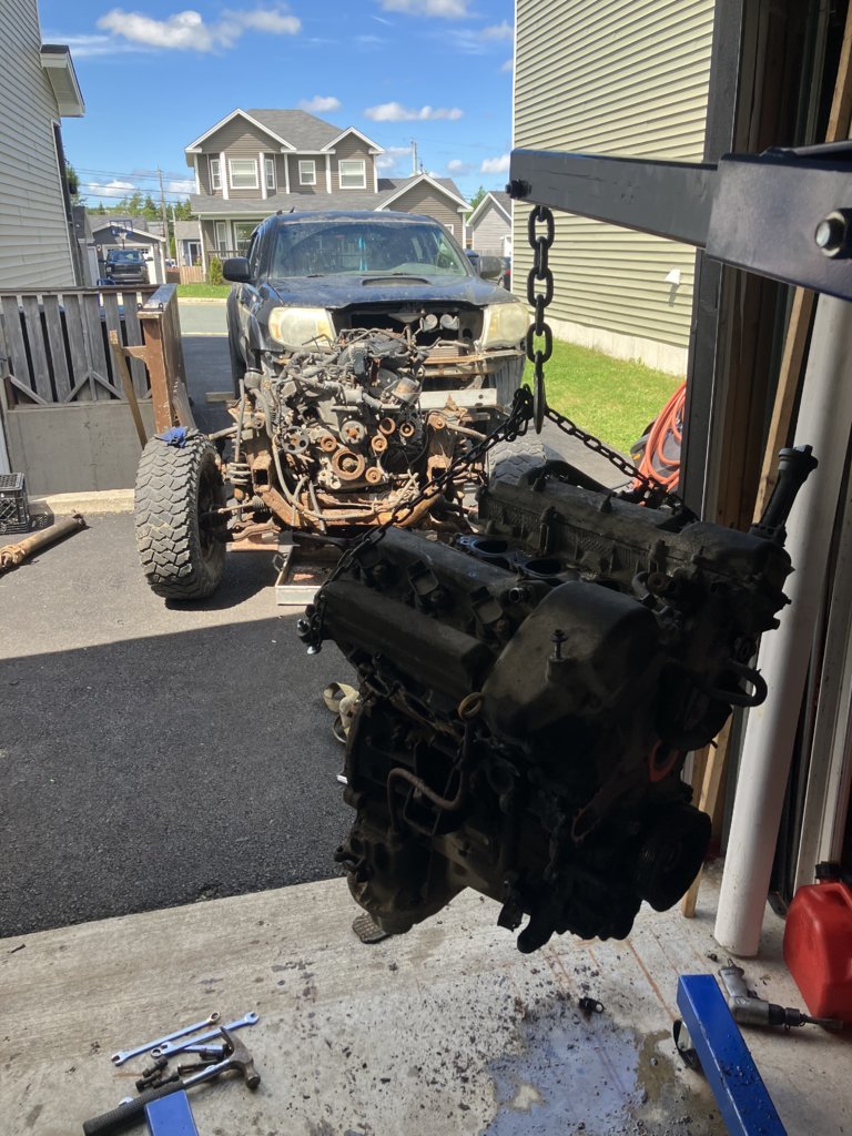

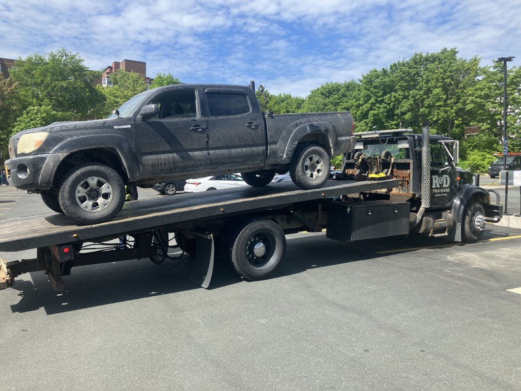

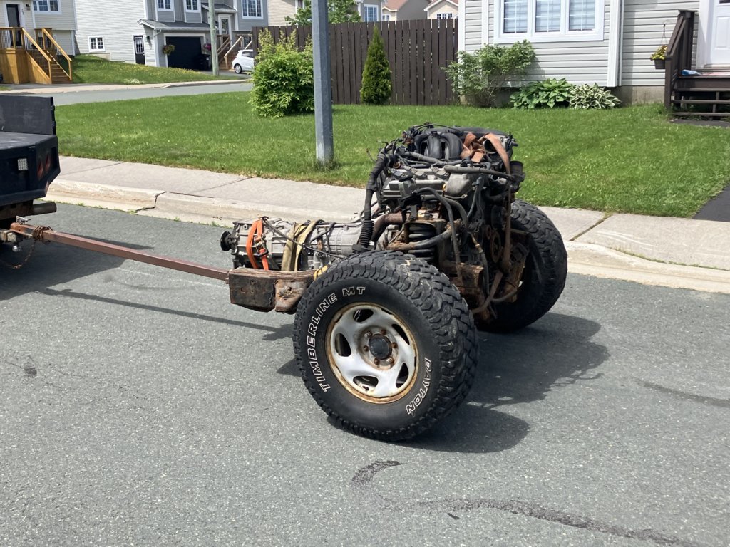

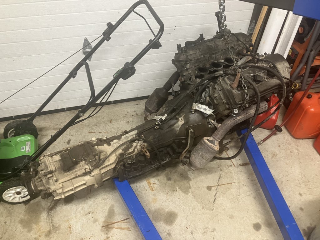

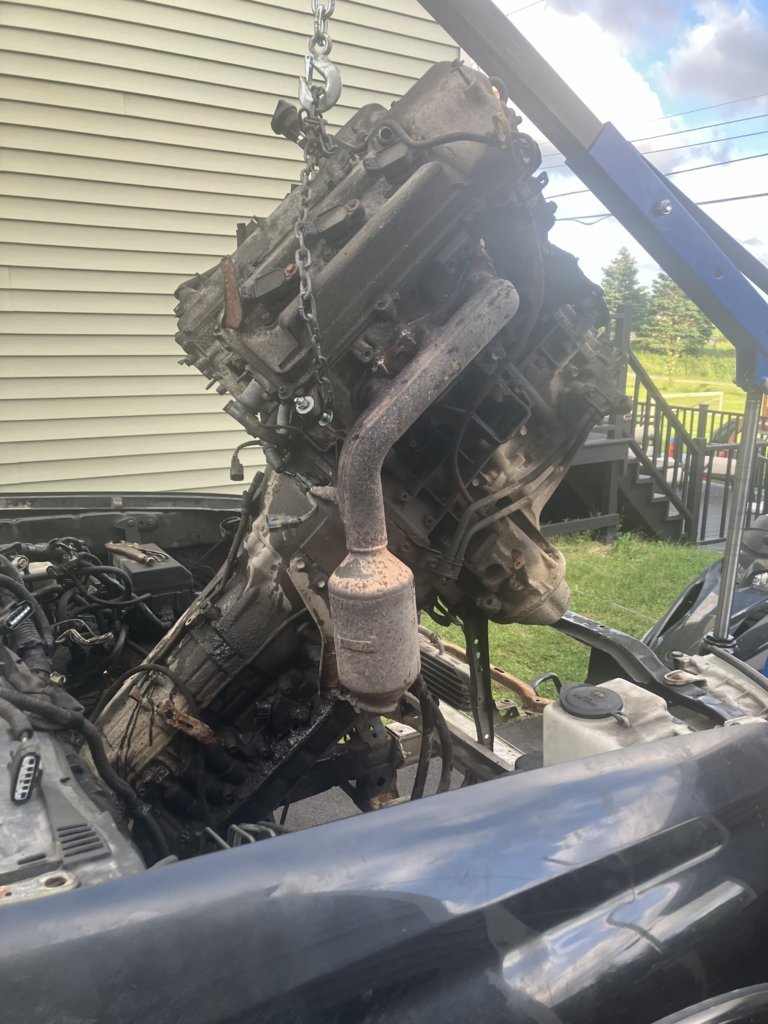

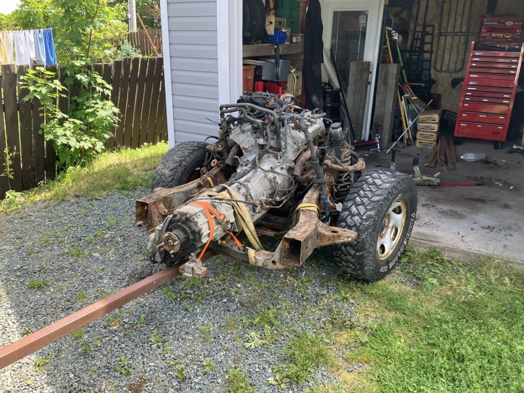

    Few years ago I scrapped a 4Runner and kept the motor, cut the frame off behind the trans. Strapped a trailer hitch to the motor and towed it over …… IMG_7954.jpg IMG_7958.jpg IMG_7968.jpg

    You swap in the whole unit motor & trans?

    lol it’s not :(

    I needed a truck for work and could not find anyone willing to do this swap. So I pulled out the motor trans and t case as one ☝️
    the T4R is supposed to have 150,000km on the motor so I put the motor and transmission in. The T case is different as the T4r has awd mode

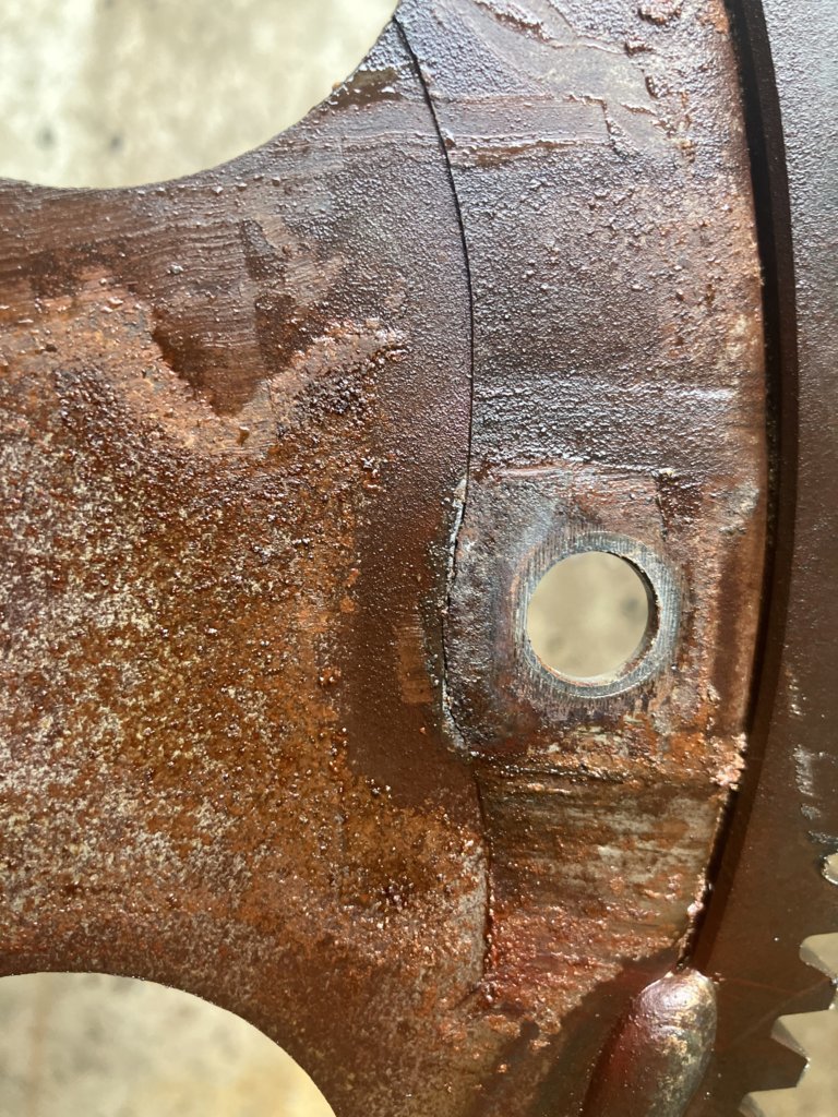

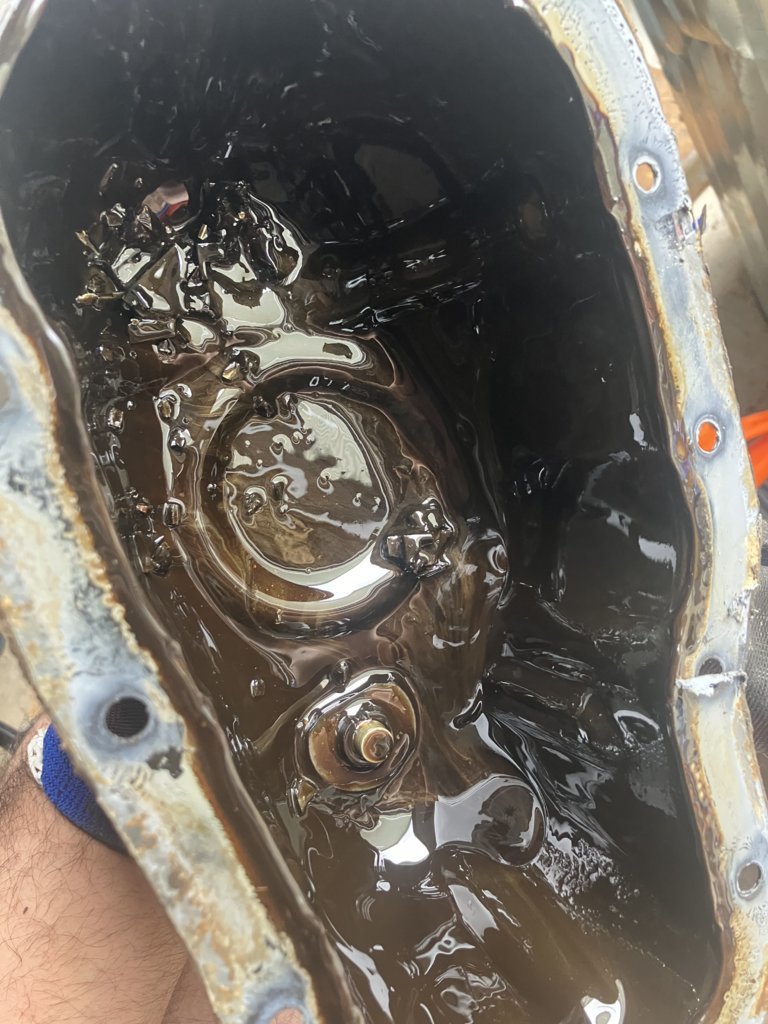

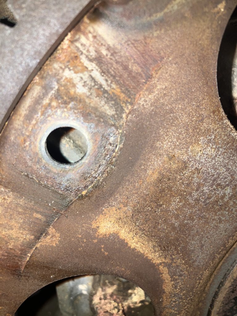

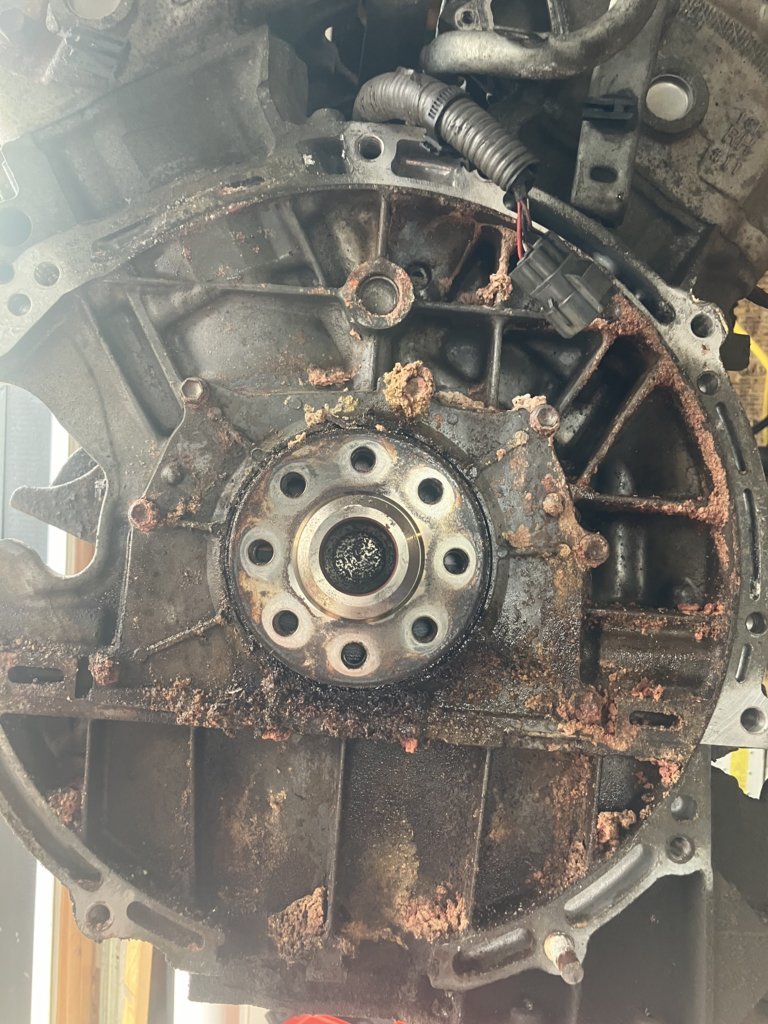

    Cracks in the flywheel
    Motor parts in the base pan
    Crystal antifreeze from leaking crossover tube
    And removal of newish IMG_7975.jpg IMG_7997.jpg IMG_8006.jpg IMG_8007.jpg IMG_8014.jpg crossover tube that was installed a few years ago

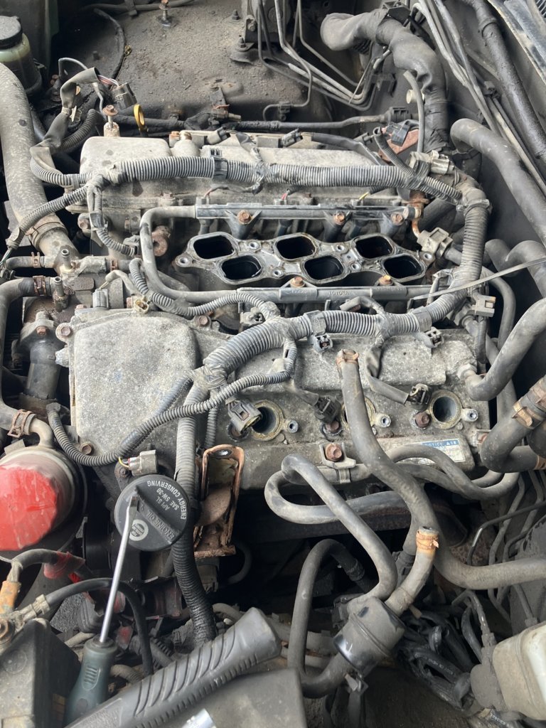

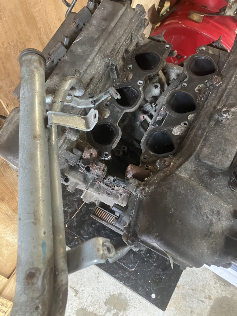

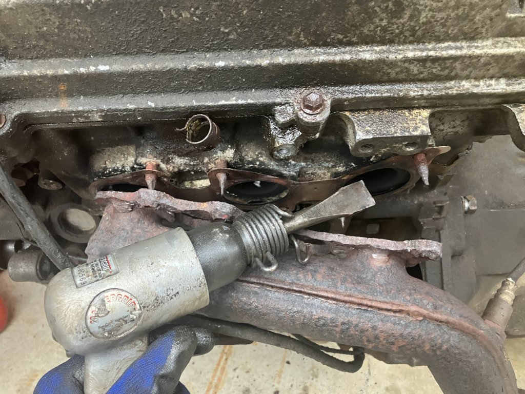

    old motor manifold removal and oil pickup
