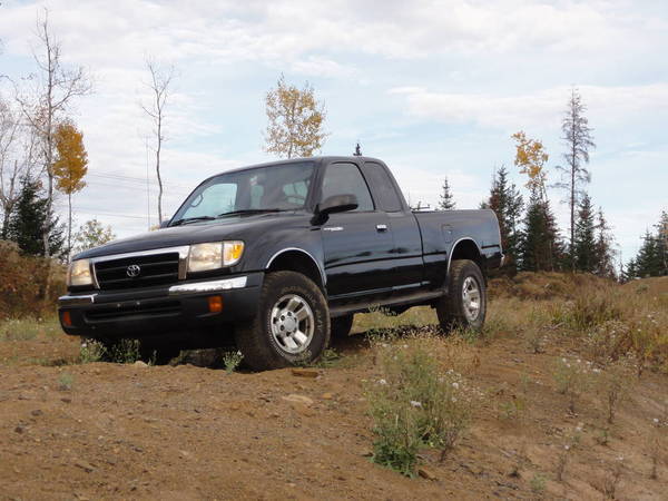

    Started out with this about a year ago in October 2011..
    2000 Tacoma sr5, standard, v6, 4x4, 132000kms, safetied for $7500.
    Took me about a month of driving it to figure out I wanted tires and a lift for it, started getting the plans together and found these new tires on used rims for a steal and picked them up, Procomp Xterrain 33x12.5 on procomp 15x10" steel rims and a spare.

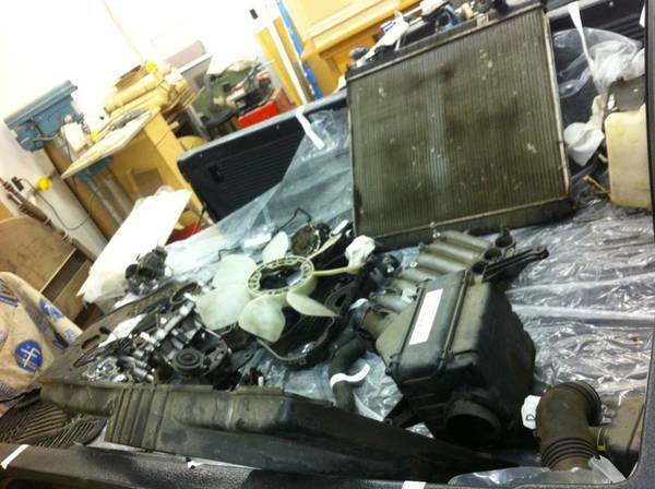

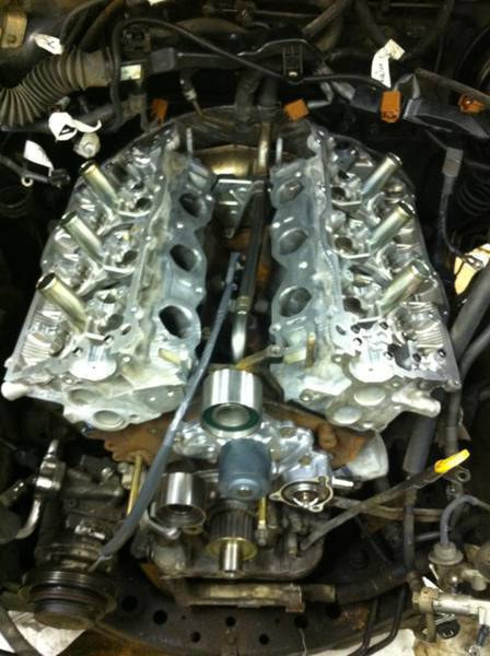

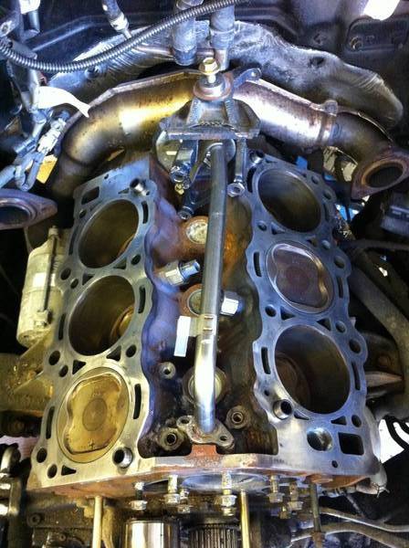

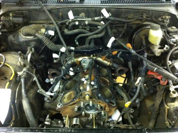

    A couple weeks after I picked up the tires, I was checking my fluids and my coolant was full of oil. Blown headgasket. Lift was put on hold, started ordering parts to do a rebuild. Parked the truck and drove my car from january until april when school was done for the summer so I had time to rip the engine apart.
    Got these parts, plus the rebuild gasket kit. Waterpump/timing belt replacement kit.
    Finally started the engine in april
    Mess
    Parts!

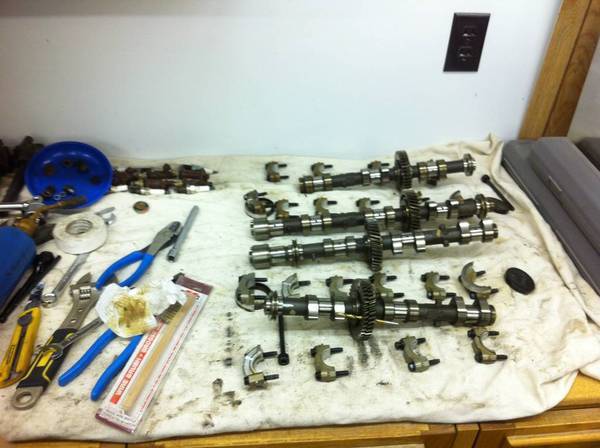

    Cams
    Block all cleaned up
    Shiny new engine parts

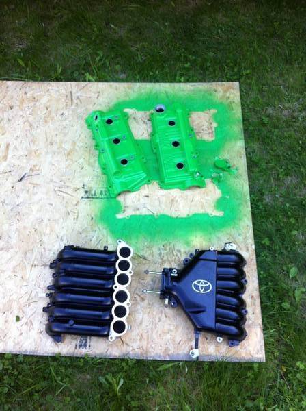

    Painted up the intake and valve covers while they were off

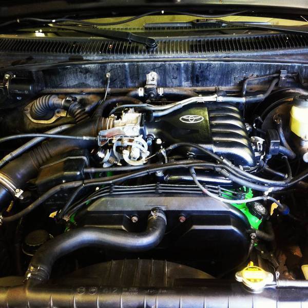

    Quickly did the deckplate mod and tossed in an AFE pro-dry filter
    Back together, she runs

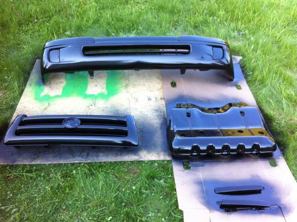

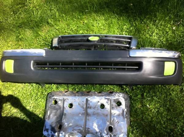

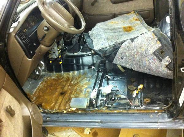

    While the truck was off the road I decided to do something about the chrome and grey faded plastic on the front and back and saved my rusty floor pan with some POR15

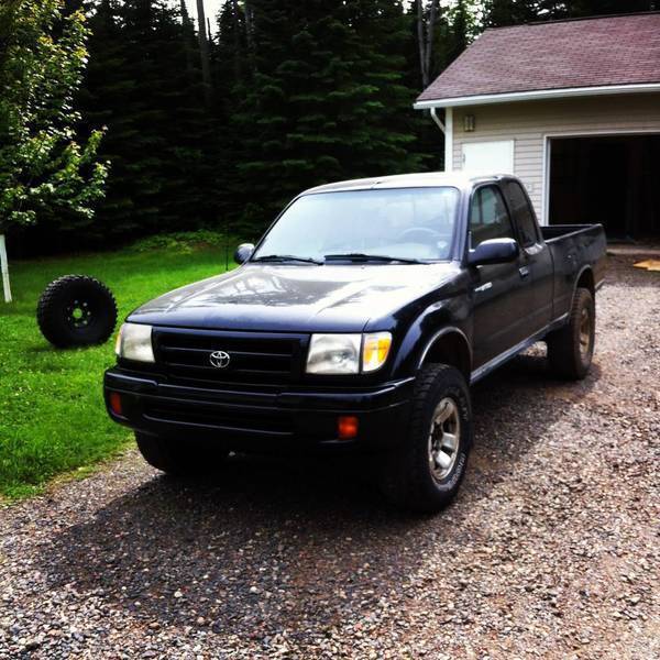

    Pulled off the running boards, and drove it out of the garage with the new painted front end.
    Truck and car

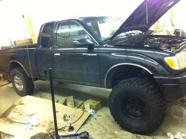

    After the summer I finally decided what I was doing and made the big order. Picked this stuff up in middle of november and started working on it again.
    Full list includes:
    Bilstein 5100 adj shocks
    Eibach Coils
    OME Dakkar 2.25 leafs
    Bilstein 5100 rear shocks
    Bushwacker cut out fender flares
    Flowmaster Super 44
    Powerstop front brake kit
    New front calipers
    and all the little parts to go along with it
    Missing some pics of the install cause they are on my old phone
    Decided to do it up nice and paint the UCA and spindle with POR15 to match the new parts
    http://www.tacomaworld.com/gallery/showphoto.php/photo/293277/cat/500/ppuser/66204
    Sketchy ass spring compressor, it was so tight we put an impact gun on it lol, still have my hands surprisingly. To anyone else doing this, bring it to a shop, i did the install on a sunday so i couldnt bring it anywhere
    New parts
    Brooo lean
    Almost done
    Finally finished, didnt have time to do the flares. those will be going on soon

    Looks sweet man. What did u paint your front bumper with?
  3. Dec 10, 2012 at 11:16 AM
    00tbaytaco
    00tbaytaco [OP] Well-Known Member
    Oct 31, 2011
    #66204
    47
    Thunder Bay, Ontario
    2000 xtra cab v6
    Self etching primer, color matched spray cans and clear
