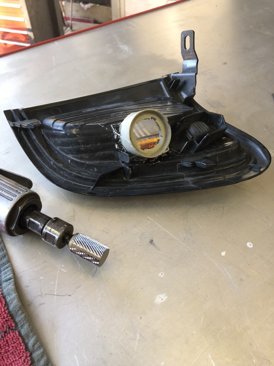

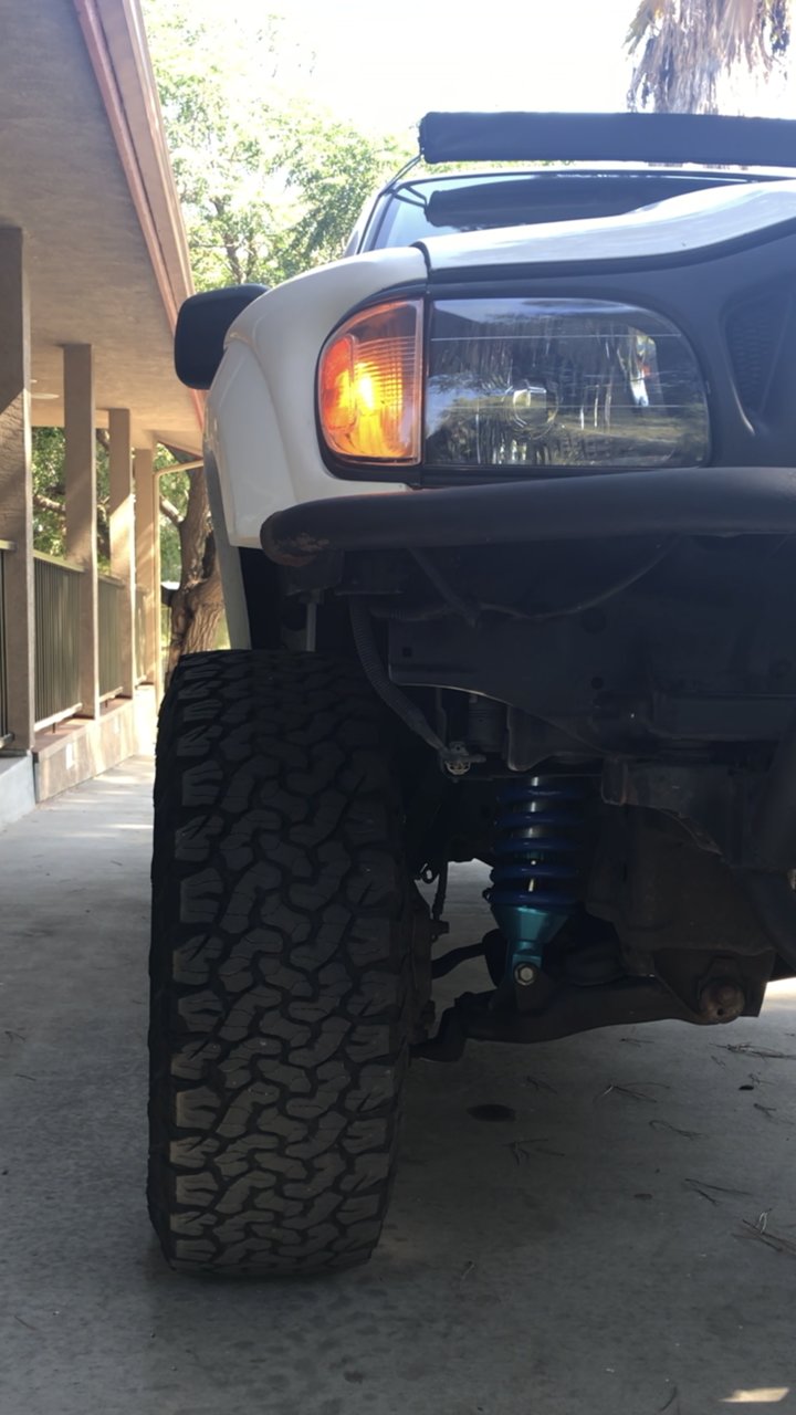

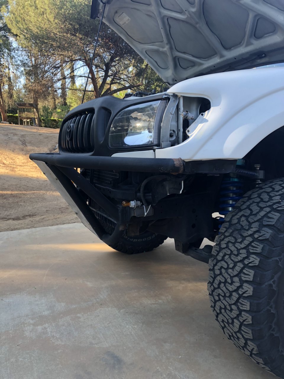

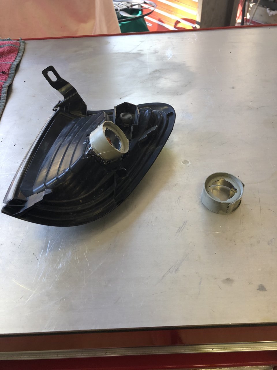

    Here’s a couple pics of when I did mine.
    Before:
    After: :cool:
    Much better.

    If by nerf you mean cut in to it essentially making it useless to go back to the original housing than yes. You drill out the smaller bulb housing and glue in the larger housing that fits your blinker bulb from the fog lights
