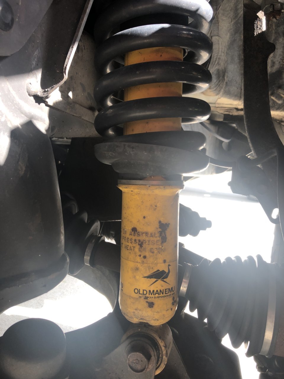

    So I recently installed a OME Front suspension/rear leaf pack for 3" lift on my 01 Tacoma. I noticed a big lean going on the driver's side on flat surface.
    Is there a key to fixing this?
    (Rear OME 2.5 leaf packs are in the correct order)

    I just ordered ome ,and it has the taco lean built into them

    The driver side set up has more lift built into it

    They're the same length on what I have.
    Where'd you read this?

    The web site i ordered mine from ,bilstein lifts .com

    I know the rear has one side that's stiffer then the other. Does it state what one goes on what side

    The fronts yes

    No I haven’t installed one yet. And it goes over the Coilover

    I know the fronts. Do you know how to identify what one goes where?

    Mine were both the same size. I ordered the shim to be installed on the struts by Wheelers and it wasn't enough. I had to install a spacer like the one in the second response.

    Did you order that same one? That one doesn't fit my yr Tacoma. (1st gen) if bychance do you have a part number? Thanks

    No, mine was from Wheelers.
    I think this was it. Measure how much thread you have showing to see if you need longer upper studs on the top plate. You'll have to disassemble the struts if you do.

    On the drivers side coilover, you’ll see a 5mm shim that they refer to as the “trim packer” which will be between the coil bucket and the lip on the strut.
