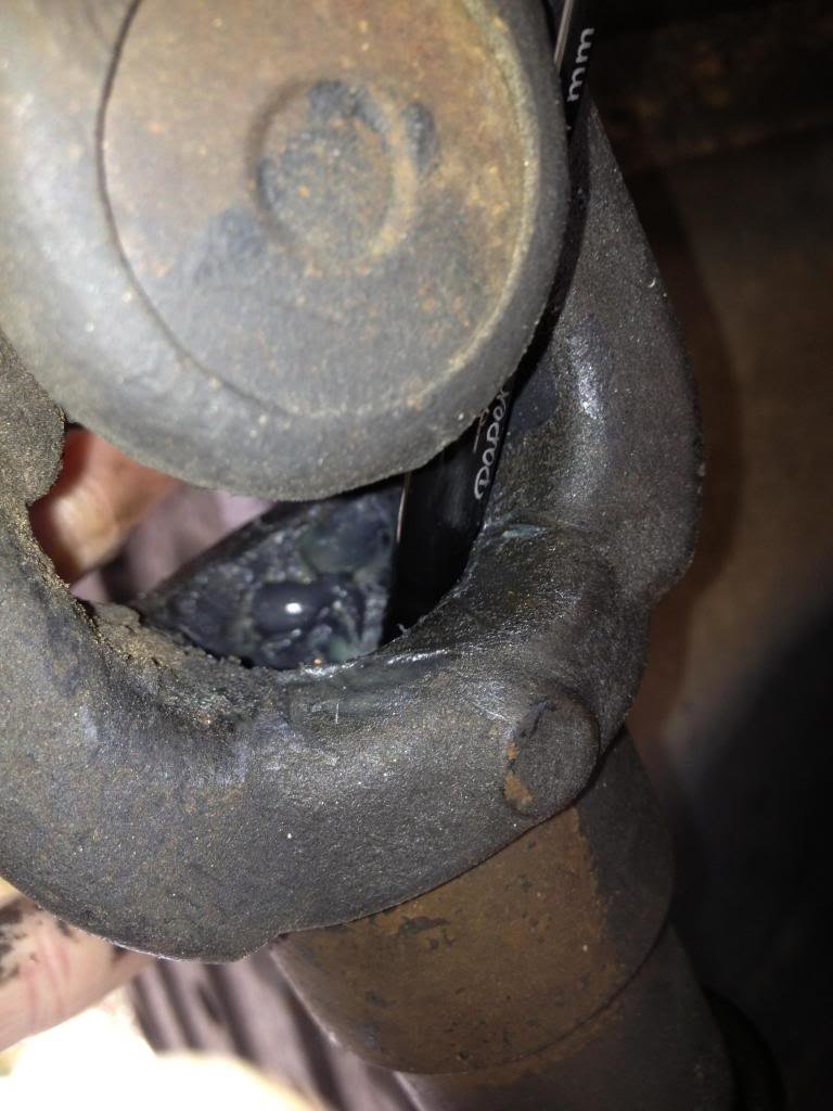

    This is the slip joint/yoke on my tacoma. I put the mechanical pencil there to show how its completely open.

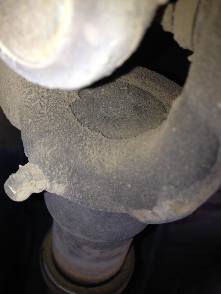

    Here is how I think it should be. Its a pic from my dads 2000 4-runner.
    So it looks like i'm looking for that plug. I've heard it's called a freeze plug but does anybody know the size?

    I see what you mean now. That plug holds the grease in the slip joint. No idea on what size it is though. Hopefully you can just pull the shaft out and pop a new plug in and not have to get a new yoke. If you got a new one it might throw the drive shaft balance off? :notsure:
